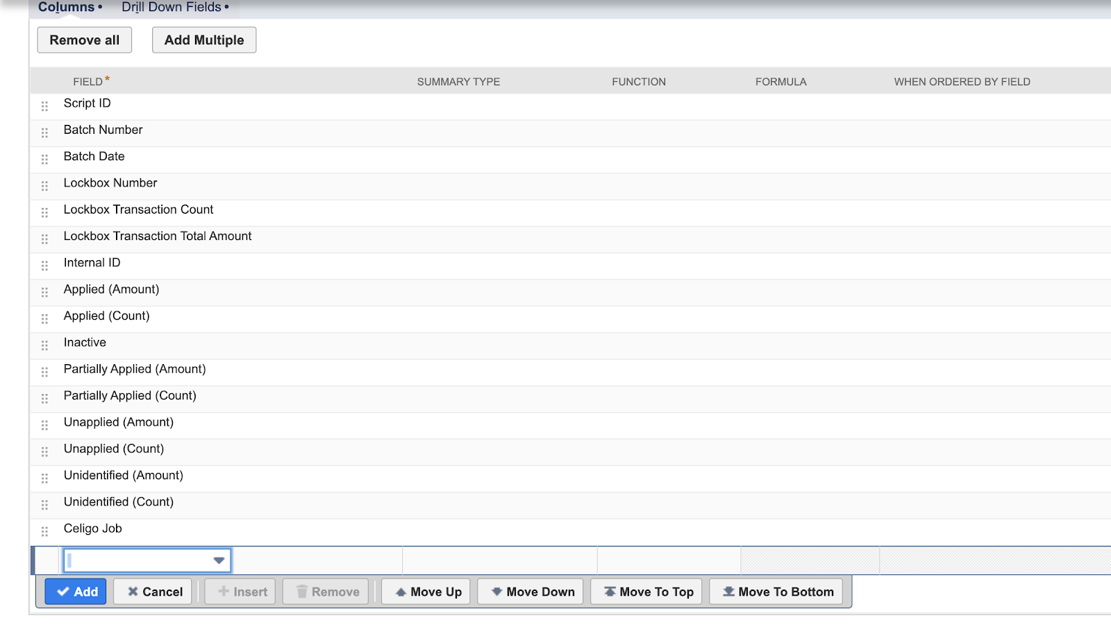

Celigo CashApp Batch

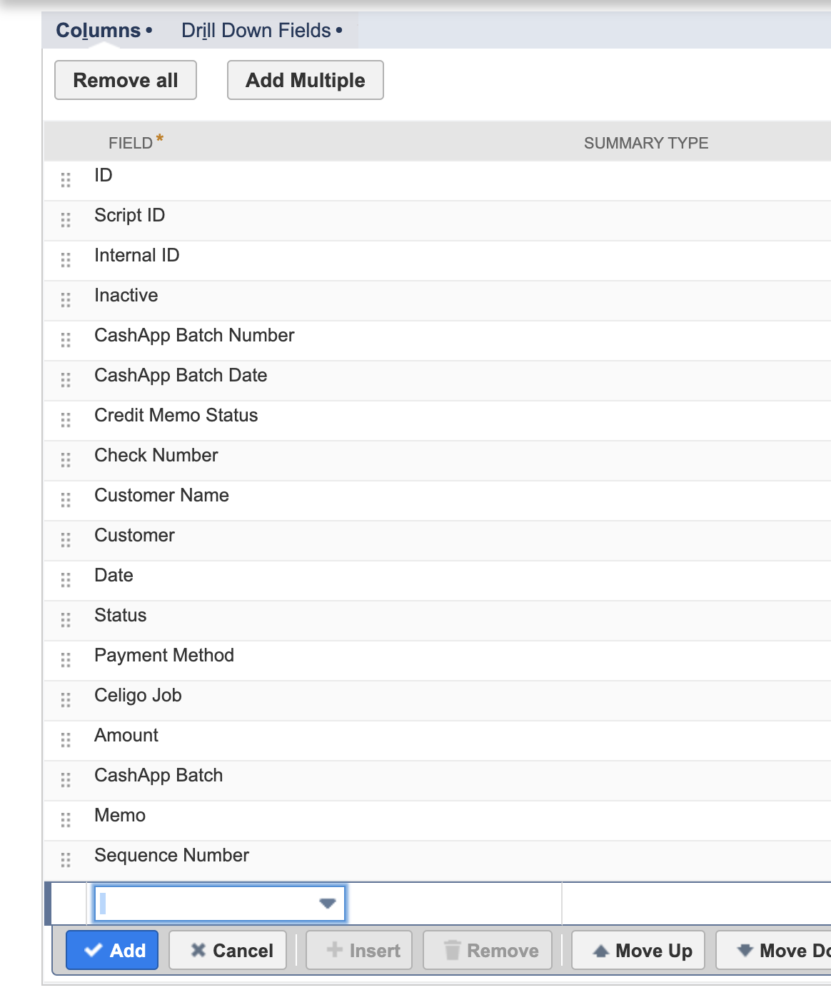

Celigo CashApp Transaction

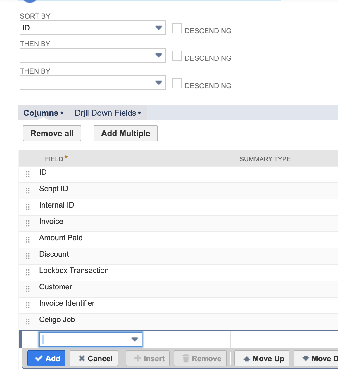

Celigo CashApp Invoice

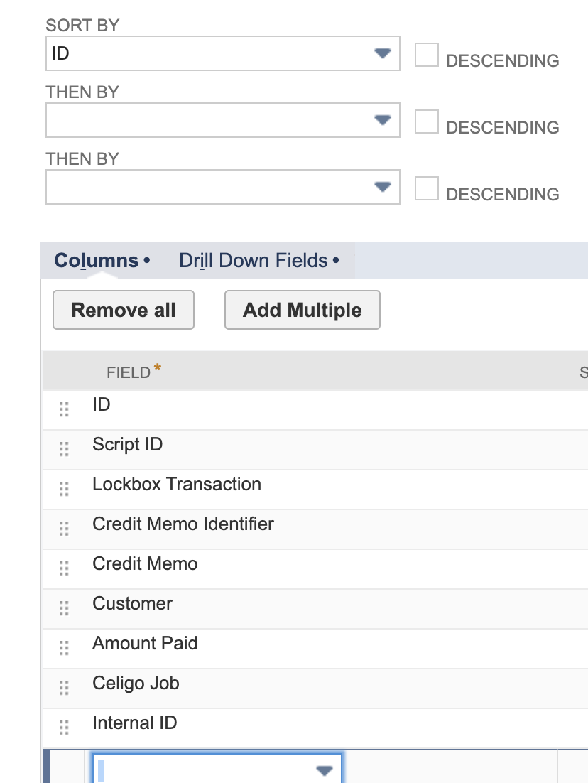

Celigo CashApp Credit Memo

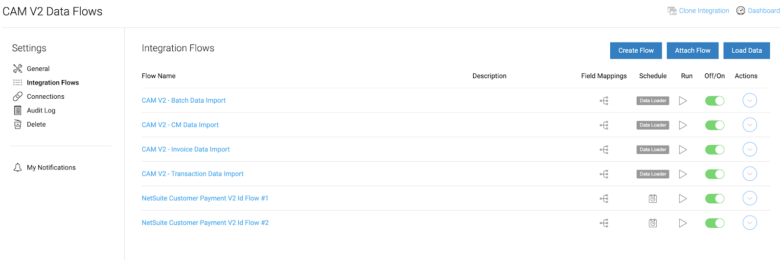

Step 9: Install the supporting template provided in the IO account and configure the NetSuite Connection.
A template with 6 flows in total (4 Data loader and 2 DIY) should be installed in the Customer’s IO account and these are used to reload the data of v2 records.
Step 10: Load the V2 data to Batches, Transactions, Invoices and Credit Memos using the IO flows provided in the Zip (4 data loader flows)

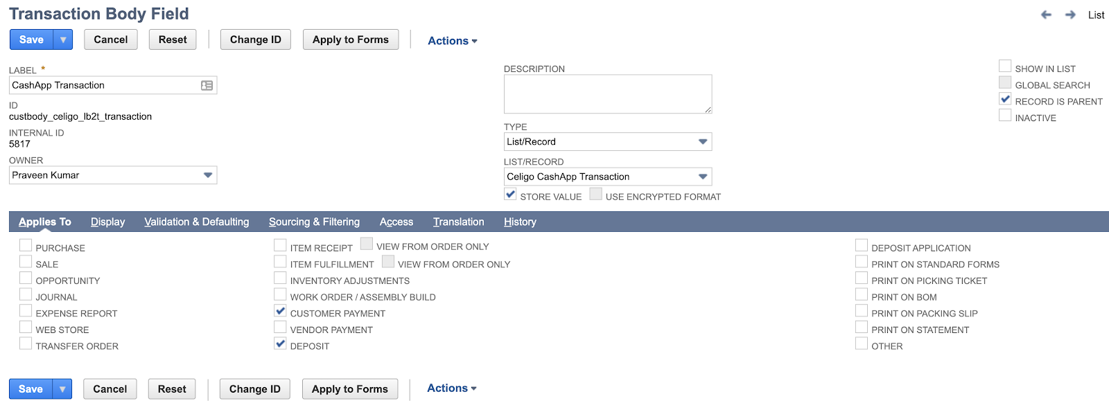

Step 13: Under Transaction Body fields, update ‘CashApp Transaction’ field type
  1. Update the ‘ CashApp Transaction ’ field under Transaction Body fields to point to the newly created Celigo CashApp Transaction record. [Look for space]
  2. You will see a warning when you try to change this. You can still go ahead as this will delete the content in the field and we already backed up the data in another field using the ‘NetSuite Customer Payment V2 Id Flow #1
