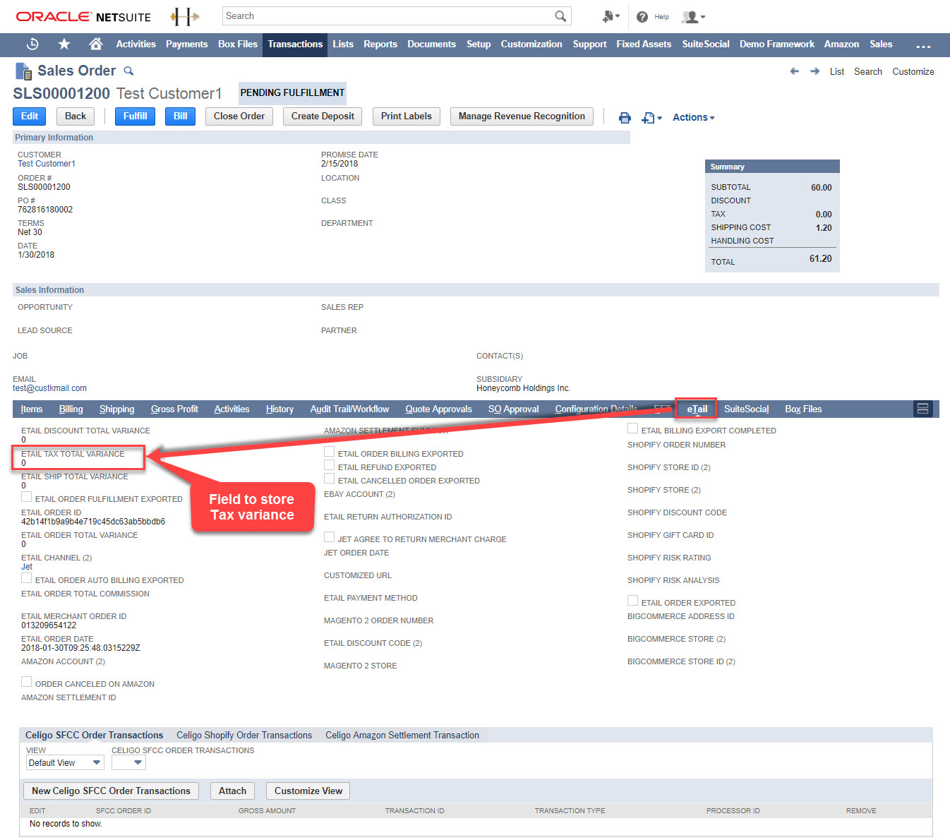

NetSuite has its own native tax engine for handling tax associated with an order. At times you may run into situations where the calculated tax within the NetSuite is different from the tax details shared by BigCommerce. It is possible that the tax total might not match between the two systems if information such as tax tables between both the systems do not match. This could become a major hassle for your accounting teams to match the sales tax for each order and be able to remit the correct amounts to the respective states. After each order is imported into NetSuite, the Integration App immediately compares the calculated tax totals with what was sent from BigCommerce. If there is a difference between the tax values calculated by NetSuite and the values sent from BigCommerce, the difference is stored in the ETAIL TAX TOTAL VARIANCE custom field on the sales order. You may report on these fields in NetSuite on a periodic basis and adjust your G/L with a journal entry if variance values exist.

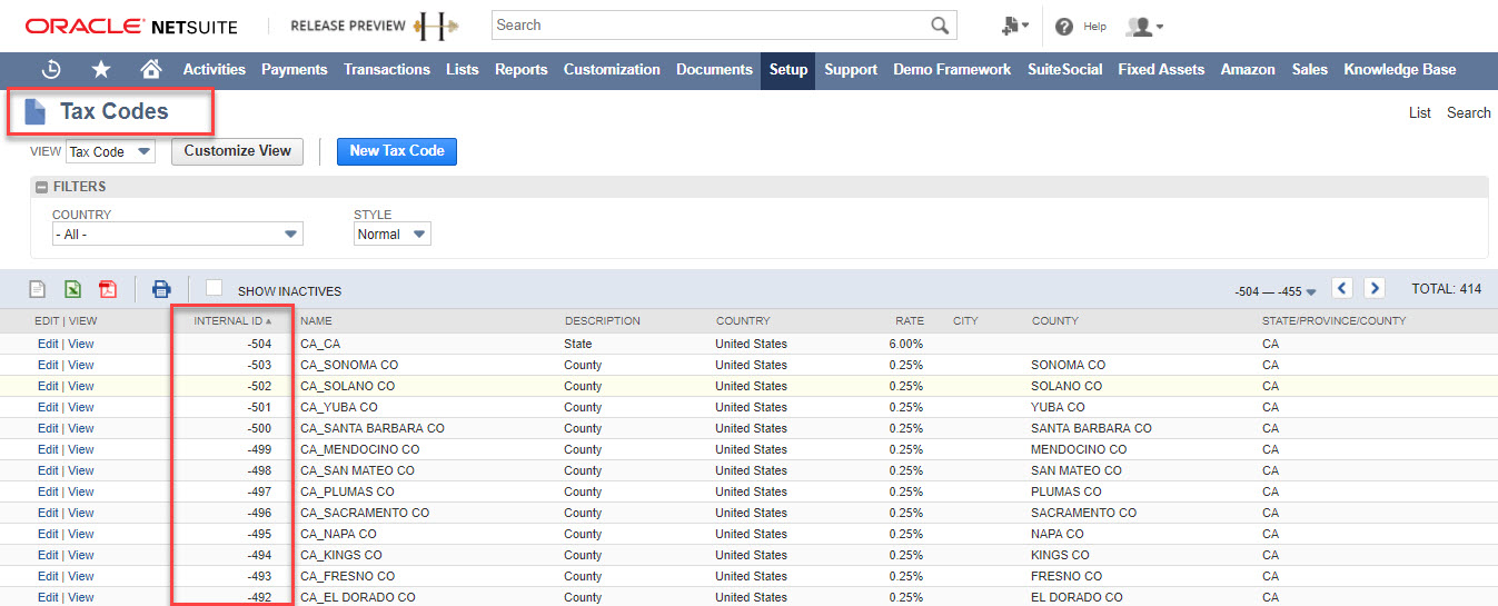

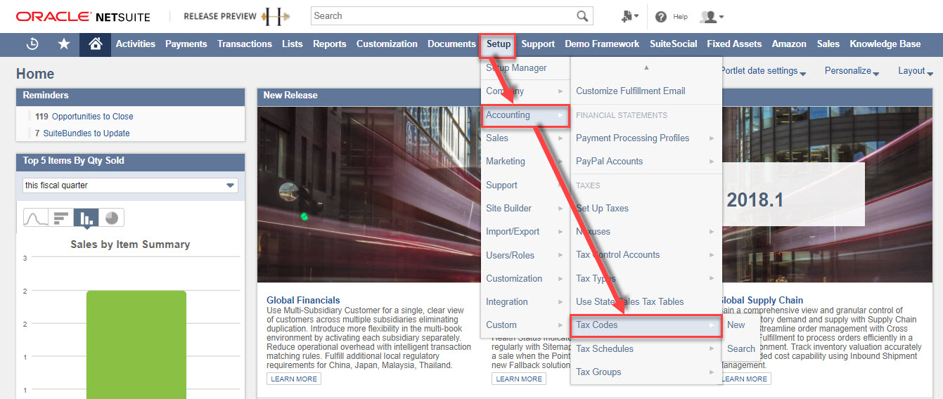

Use the following steps to find the internal id of a tax code:-
In NetSuite, navigate to Setup > Accounting > Tax Codes. The Tax Codes page is displayed.
Select the internal id for an existing tax code that you wish to use in the Integration App or create a new tax code to be used when NetSuite fails to find a tax code corresponding to the shipping address on the order.

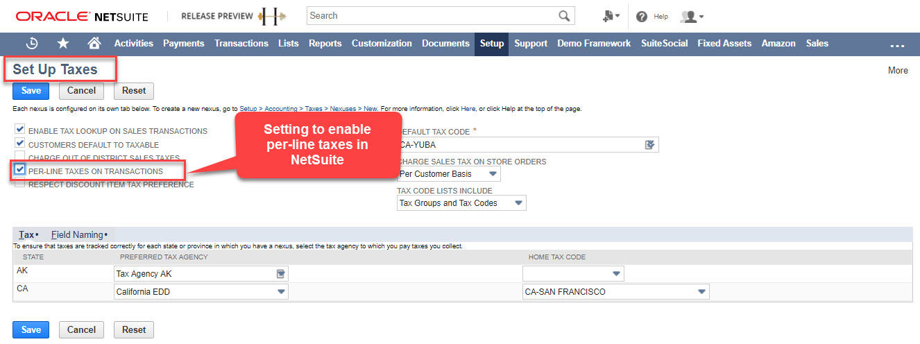

Per-line taxes on transaction enabled in NetSuite

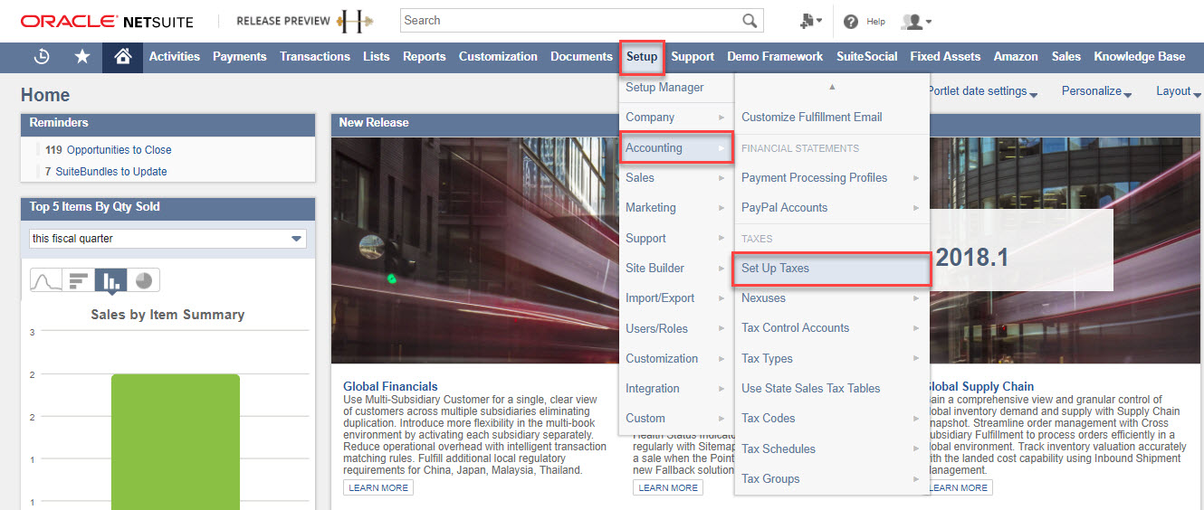

Enable this setting if you want the tax code and tax rate to be displayed at the line-level for every item associated with the sales order. You must only enable this field if taxes are enabled in NetSuite at the line-level. To enable this setting in NetSuite navigate to Setup > Accounting > Taxes > Setup Taxes.
The Set Up Taxes page is displayed. Select the Per-Line Taxes ON Transactions field.

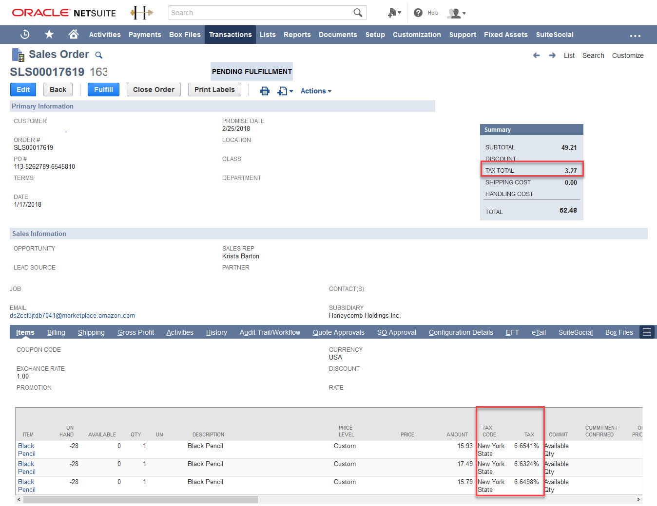

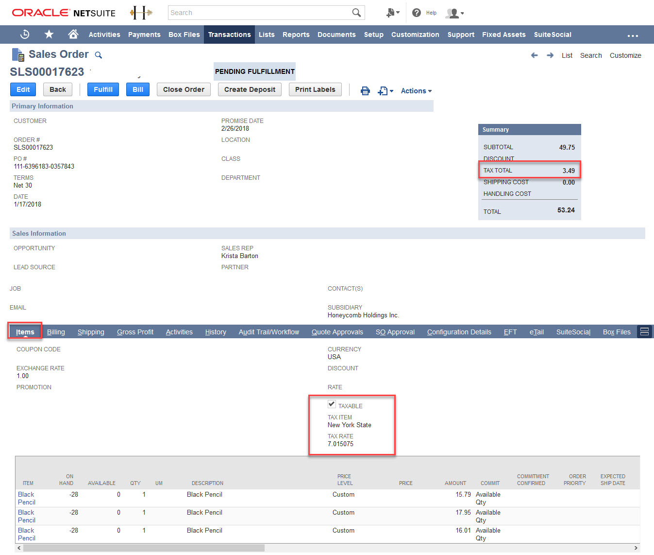

When the field is not selected:
The total tax is calculated for the entire order and one tax code for an entire order is applied as shown in the following screen:
The total tax is calculated for every item in an order and individual tax code and tax rate is displayed in every line as displayed in the following screen:
When the field is selected:

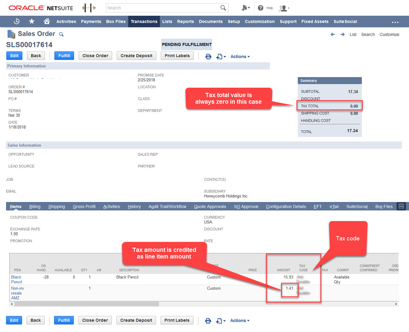

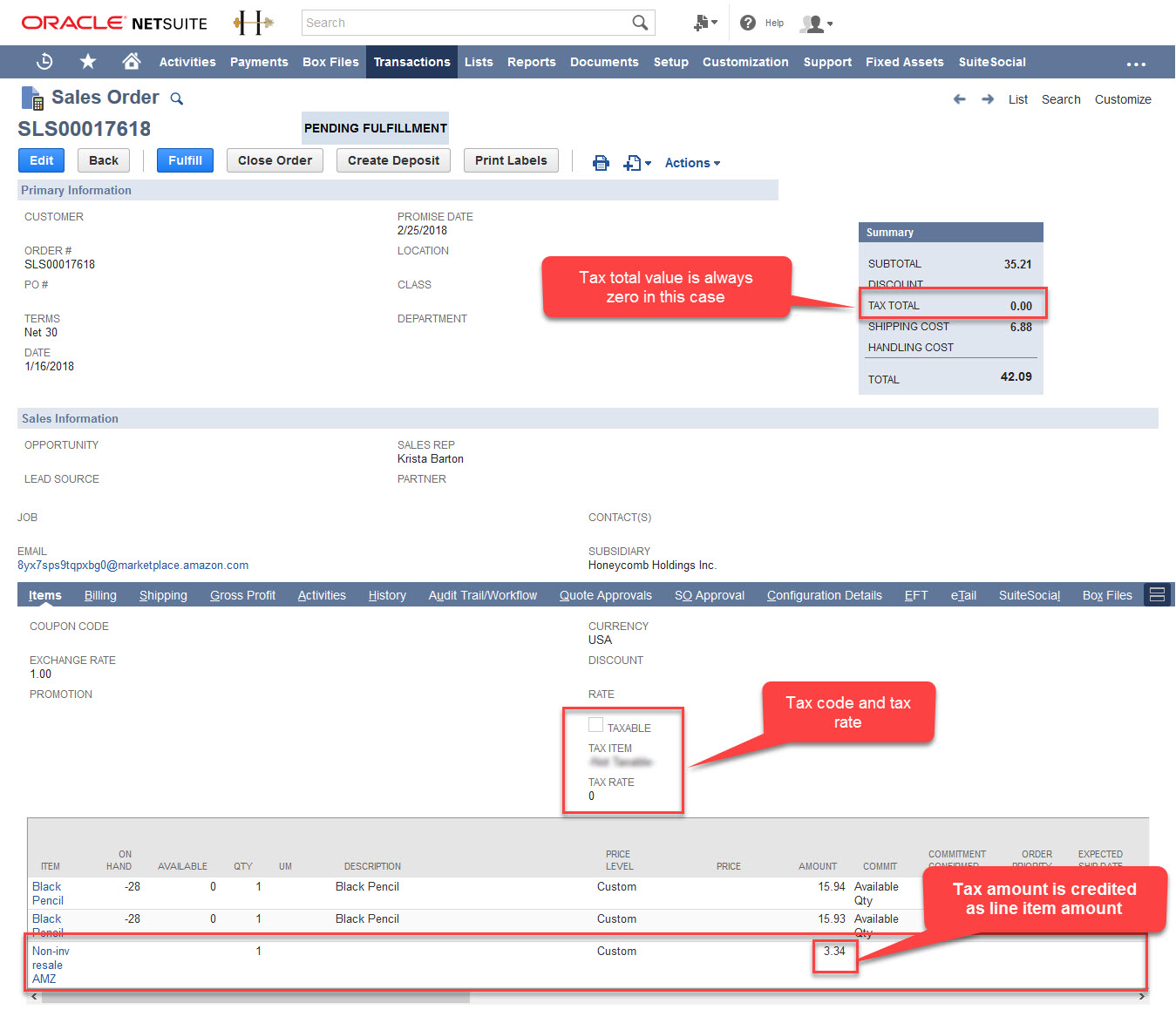

Option 3: Add total tax against a single line item on the order
When you select this value in the How would you like to bring sales tax into the NetSuite drop-down list, the following new fields are displayed which allows you to control the way tax information is updated in NetSuite:
NetSuite item to track the BigCommerce tax amount as a line item
This is a mandatory field. Select the non-Inventory type NetSuite item to track total sales tax in BigCommerce against a single line item on the sales order. The selected item is used to create an additional line item record within the Sales order and the tax amount is then updated in the Amount field of this new line item. The tax rate is always zero in this case. -
The total tax is calculated for every item in an order and the total tax amount is updated in the Amount field of the line item. The tax code and tax rate are displayed at the header level in the sales order for an entire order as shown in the following screen:
The total tax is calculated for every item in an order and the total tax amount is updated in the Amount field of the line item. The tax code is also displayed in the line item record as shown in the following screen:
