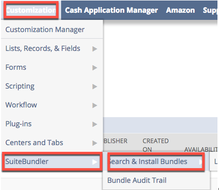

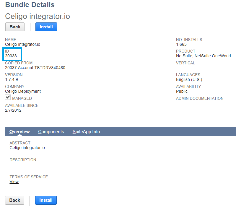

Install integrator.io bundle in NetSuite
  1. In NetSuite, go to Customization > SuiteBundler > Search & Install Bundles.
  2. In the Search bar, enter "Celigo integrator.io". Find Bundle ID 20038.
  3. Click Install.

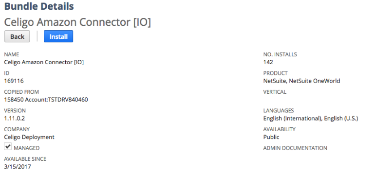

Install Amazon Bundle in NetSuite
  2. In the KEYWORDS textbox, enter "Celigo Amazon Connector [IO]" and click Search Find Bundle ID 169116.
  3. Click Install.

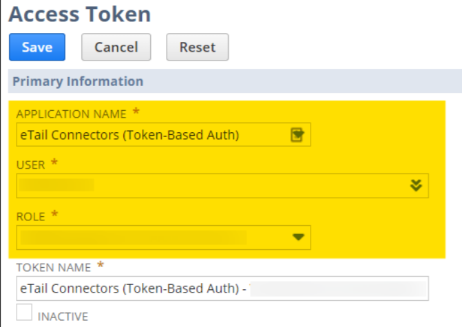

Generate NetSuite Access Tokens
  1. Log into NetSuite as an Administrator.
  2. Go to Setup > Users/Roles > Access Tokens > New.
  1. In the APPLICATION NAME drop-down box, select eTail Connectors (Token-Based Auth)
  2. In the USER drop-down list box, type in the NetSuite user that you designated for the Celigo integration in the "Create a custom role in NetSuite" step or search for the user.
  3. In the Role drop-down list box, select the role that was assigned to the user.
    The TOKEN NAME populates automatically. Modify the name as needed.
  4. Click Save.
  5. Token ID & Token Secret will be displayed. Save the tokens in a place where you can copy it into your Celigo connection as described in the next section.
Token ID and Token Secret are only displayed once & cannot be retrieved. We recommend that you save them in a secure location if you need to reference them later

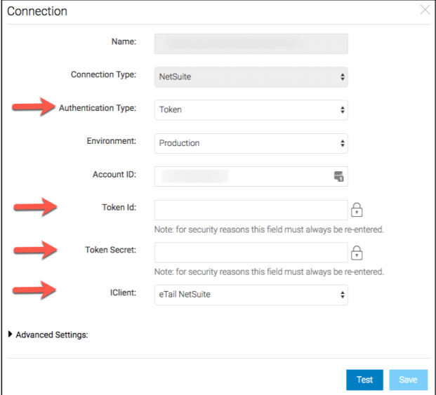

Change NetSuite connection to Token-Based Authentication
  1. Log into your integrator.io account as either account Owner or Manager.
  2. From the home page of integrator.io, access your Amazon-NetSuite Integration App integration tile and click Settings (settings_gear.svg​).
  3. From the Setting section on the left menu, select Connections.
  4. If you see two connections called “NetSuite Connection (Amazon Integration App)” and “Secondary NetSuite Connection (Amazon Integration App)”, perform steps 4-10 for both connections. Select Edit (pencil.svg) for the NetSuite Connection.
  1. Change Authentication Type to Token.
  2. Make sure Environment and Account ID are correct.
  3. Enter Token ID and Token Secret that were generated in NetSuite.
  4. In iClient drop-down list, select eTail NetSuite.
  5. Click Test to verify if the connection is working.
  6. Click Save.
