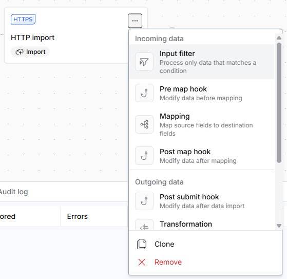

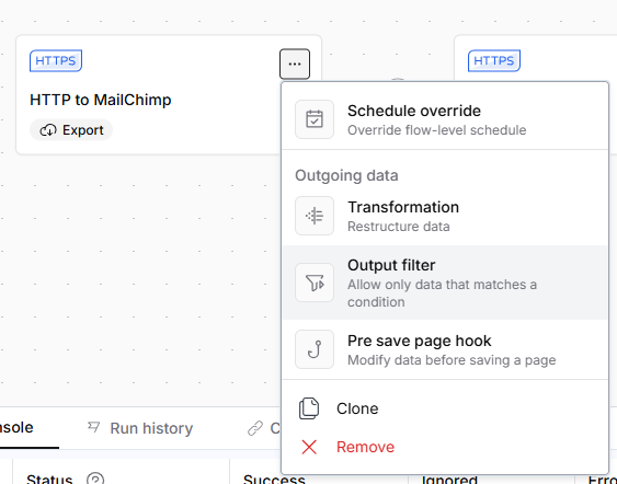

Create filters
  1. Open Flow builder.
  2. Click the ellipsis (...) on a flow step to add a filter. You can add an output filter to an export (or an import/lookup with subsequent flow steps). You can add an input filter on an import or lookup flow step.
  3. Click the filter option appropriate for the flow step’s context: output (filterOut.svg) or input (filterIn.svg)
  4. The filter editor displays.

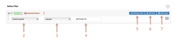

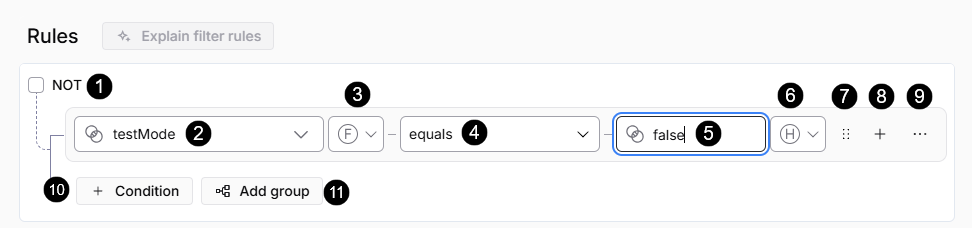

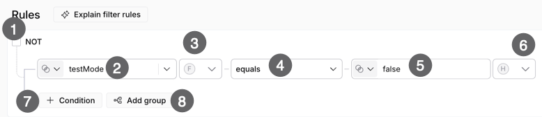

Navigating the filter editor

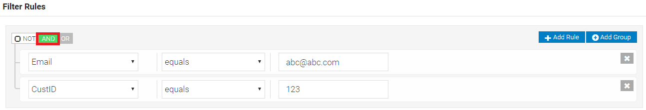

  1. Logical operators: You can use any of the following logical operators to define rules for data:

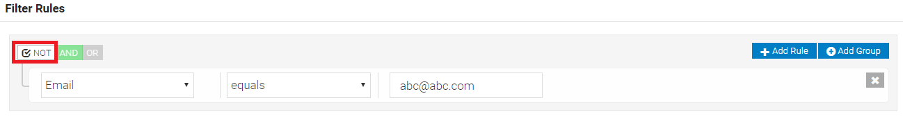

    • NOT: Select the checkbox if you want to use the NOT operator. NOT excludes any data that meets the criteria you define in the rules. If the checkbox is not selected, the filter includes any data that meets your defined rule criteria.
    • AND: Select AND if you want data that meets the combined criteria defined in the rules.
    • OR: Select OR if you want data that meets any criteria defined in the rules.
    Notice
    If you want to exclude all records that belong to a subsidiary company, select NOT. You can also select AND or OR to create filters that combine multiple rules for your filtration criteria. AND filters records that fit all listed rules in the group. OR filters records that fit any listed rules in the group.

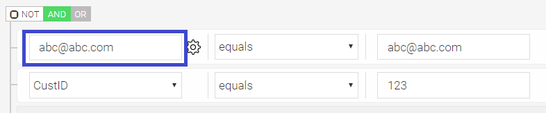

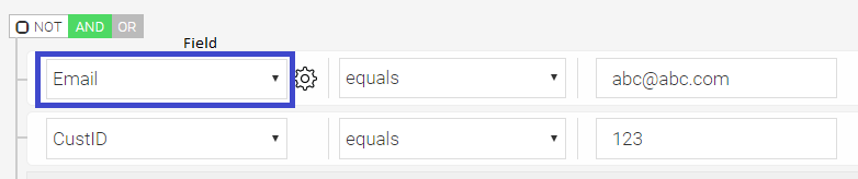

  2. Field name: Flow Builder allows you to select any field from your data record from this menu. Choose the relevant field for your filter. By default, a drop-down list contains all available record fields. You can also use a value or an expression instead. Click + Add field at the bottom of the list to add a new field. You can modify existing field names in the Input text box of the filter editor. Once the field exists in the sample record, it will be available in this drop-down list.

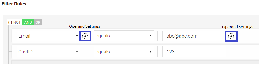

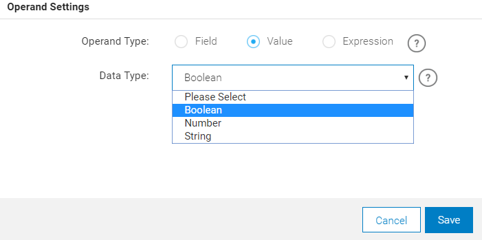

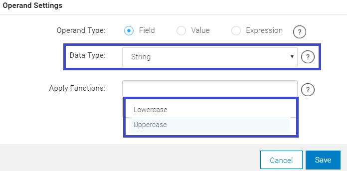

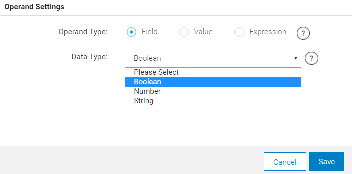

  3. Operand type and Data type: Operand types can be:
    • Field: The first field in a filter rule. Use the drop-down menu to select any field from your sample record.
    • Value: Enter the number, string, or Boolean value to use as the filter criterion. Select Value as the second field when the filter rule is based on a specific value.
    • Expression: The expression to compute or transform values. Expression supports two kinds of operations:
      1. Basic calculations – Use this syntax to perform Add, Divide, Multiply, Subtract, or Replace calculations for the filter rule.
      2. Handlebars expressions – Starting from the 2026.7.1 release, use the double-curly brace syntax {{}}to manipulate data and keep filter logic inline and maintainable, without using scripts. You can use Handlebars expressions to transform values before comparing them. For example, to trim whitespace, change case, compute a date offset, or format a number.
      Caution
      Before the 2026.7.1 release, filter rules treated values within double-curly braces {{ }} as literal {{...}} text. Starting with 2026.7.1, filter rules automatically interpret and evaluate {{ }} values as expressions.
      If an existing filter rule uses {{ }} to represent a literal, hardcoded value, the rule may no longer work as expected. Review and update affected filter rules to ensure they produce the intended results.
    Data type is available only for field or value operand types, for use in defining the format as a string, number, date-time, or Boolean.
  4. Operator: This list allows you to apply conditional operators to the filter. This menu has the following operators:
    • equals: equal to specific date or numeric value.
    • not equals: not equal to a specific date or numeric value.
    • is greater-than: greater than a specific date or numeric value.
    • is greater-than or equals: greater than or equal to a specific date or numeric value.
    • is less-than: less than a specific date or numeric value.
    • is less-than or equals: less than or equal to a specific date or numeric value.
    • between:  falls within a defined range. Specify the start and end values.
    • ends with: ends with a specific string of characters.
    • contains: has a specific string of characters at any point in the field value.
    • does not contain: does not have a specific string of characters at any point in the field value.
    • null: has no value in the field.
    • is not null: has any value in the field.
    • matches: has a specific value in the field.
  5. Value: Enter the appropriate value according to the selected operator.
  6. Operand type and Data type: see step 3.
  7. + Condition: You can add as many conditions to a filter as you need. Click + Condition after you’ve defined one or more rules for your filter and are ready to add one to another field.
  8. Add group: Click Add group to create filters with a set of rules that use multiple Boolean conditions. Groups allow you to segment your filtration logic for complex circumstances. For example, you could use one rule group that uses the NOT Boolean operator to exclude records that were created before a certain date, then create another rule group to include records that use the AND or OR operator.
  9. Condition handle (only visible on hover): If you have multiple conditions that must be organized in a specific chronological order to accurately filter your records, click and drag the handle (drag-and-drop.svg) to rearrange the order of the conditions .
  10. Plus sign (+ ) (only visible on hover): Click to add a new condition. This has the same function as clicking + Condition in step 10.
  11. Ellipses (...) (only visible on hover): Click to clone or delete a condition.

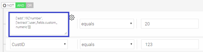

Filter expression operands
A filter expression operand provides useful shorthand for complex logic, such as in the following example:
["add",["number",["extract","number__a"]]]
Where:
  • add is the arithmetic operation to be performed using the expression
  • number__a is the field name
  • number is the data type of number__a
  • extract is the keyword that extracts a value from number_a
Supported filter expressions
Add
["add",20,["number",["extract","number__a"]],["number",["extract","number__c"]]]
