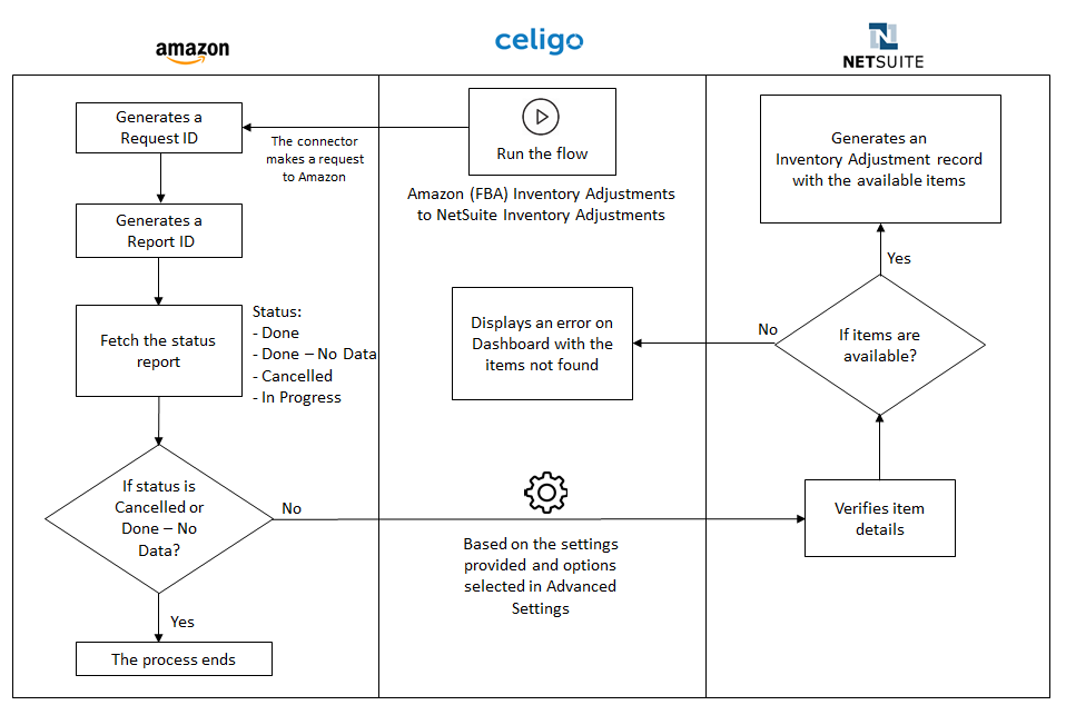

The flow fetches the Inventory Adjustment report from Amazon and creates the Inventory Adjustment record(s) in NetSuite as follows:
NetSuite allows only 1000 lines in a single adjustment record. If an adjustment report contains more than 1000 lines, then the flow creates multiple inventory adjustment records, with each record of 1000 lines.

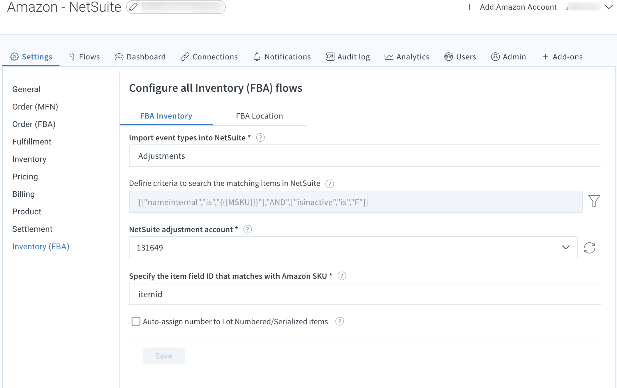

  • Go to Settings > Inventory (FBA) > FBA Inventory.
  1. In the Import event types into NetSuite setting, enter event types that must be imported into NetSuite. Records of event types entered in this setting will be imported into NetSuite and records of all other event types will be ignored. By default, the ‘Adjustments’ event type is added to this setting. You can add other event types as per your business requirements in a comma-separated format.
    The event types entered in this setting must match the event types existing in the report.
  2. In the Define criteria to search the matching items in NetSuite field, define the lookup criteria to search the matching items in NetSuite.
    Notice
    By default, you can define the lookup criteria where the Item name (Name(internal)) matches the "SKU" coming from Amazon and is in the "active" state.
  3. In the NetSuite inventory adjustment account setting, choose an account to map the inventory adjustments. The account you select in this setting is synced to the Adjustment Account field on the NetSuite inventory adjustment record.
  4. In the Specify the Item field's Field ID that matches with Amazon SKU field, specify the NetSuite field ID that matches with the Amazon SKU. You can specify only one Field ID.
  5. Click Save .

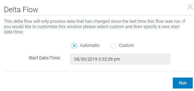

  1. Run the “Amazon (FBA) Inventory Adjustments to NetSuite Inventory Adjustments” flow.
  2. A new pop-up window opens to select any custom date to import any previous FBA inventory adjustment reports.
  3. Click Run.

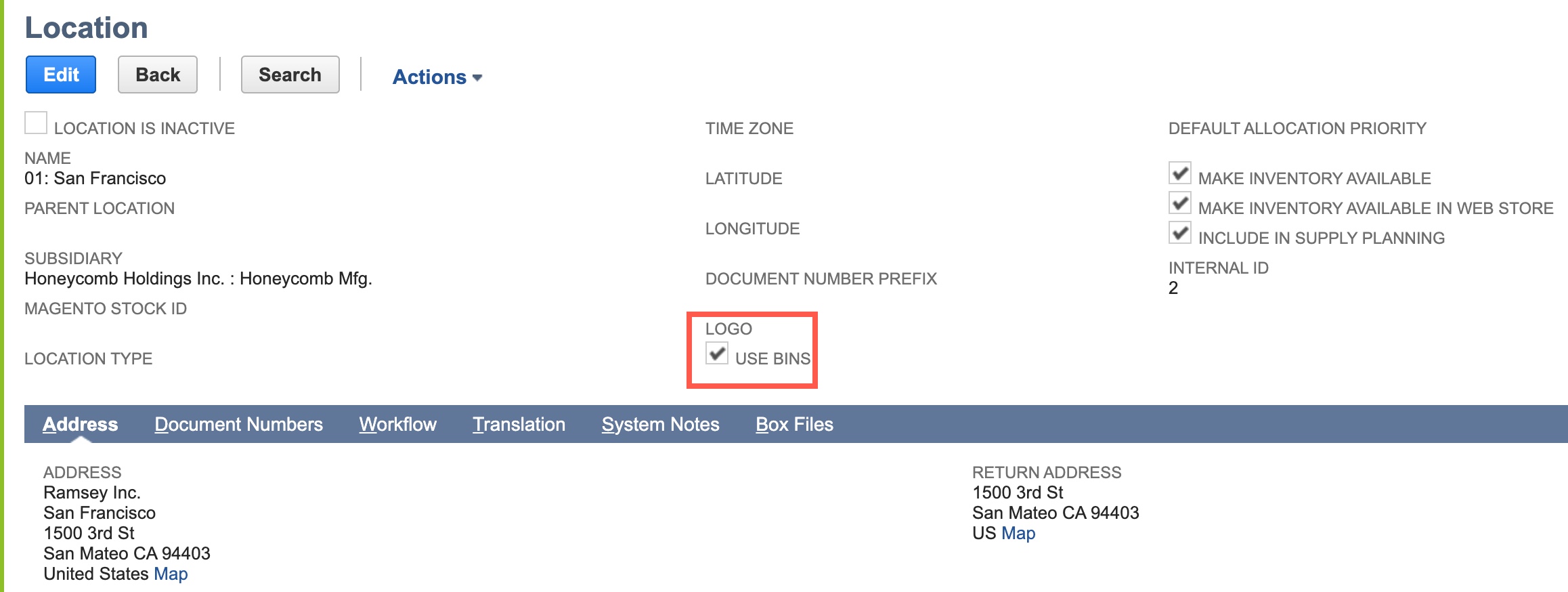

Sync negative inventory adjustments for the bin-numbered items if the Use Bins checkbox is unchecked for NetSuite locations
NetSuite limitation: If the Advanced Bin/Numbered Inventory Management check box (Setup > Company > Enable Features page > Item and Inventory tab) is unchecked, you'll not be able to see the Use Bins check box on the location.
To maintain accurate inventory in Amazon and NetSuite, the Amazon (FBA) Inventory Adjustments to NetSuite Inventory Adjustments flow syncs negative adjustment even if the required quantity is not available in the NetSuite location. For a NetSuite location, if the Use Bins checkbox is unchecked, and the inventory status is disabled, the flow syncs the negative inventory adjustment even if the required quantity is not available in the respective location. For serialized or lot-numbered items,
  • If the adjustments are less than the available quantity, then the flow adjusts the quantity without any error.
  • if the adjustments are more than the available quantity, then an error message is displayed.
