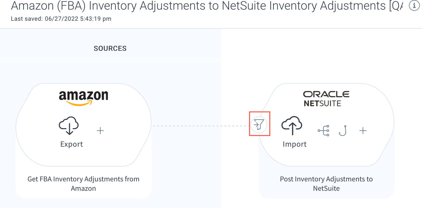

  2. In the output source tile, click Define options (+).
    The Input filter button (filterIn.svg) will appear before the output source tile.
    Input filter added

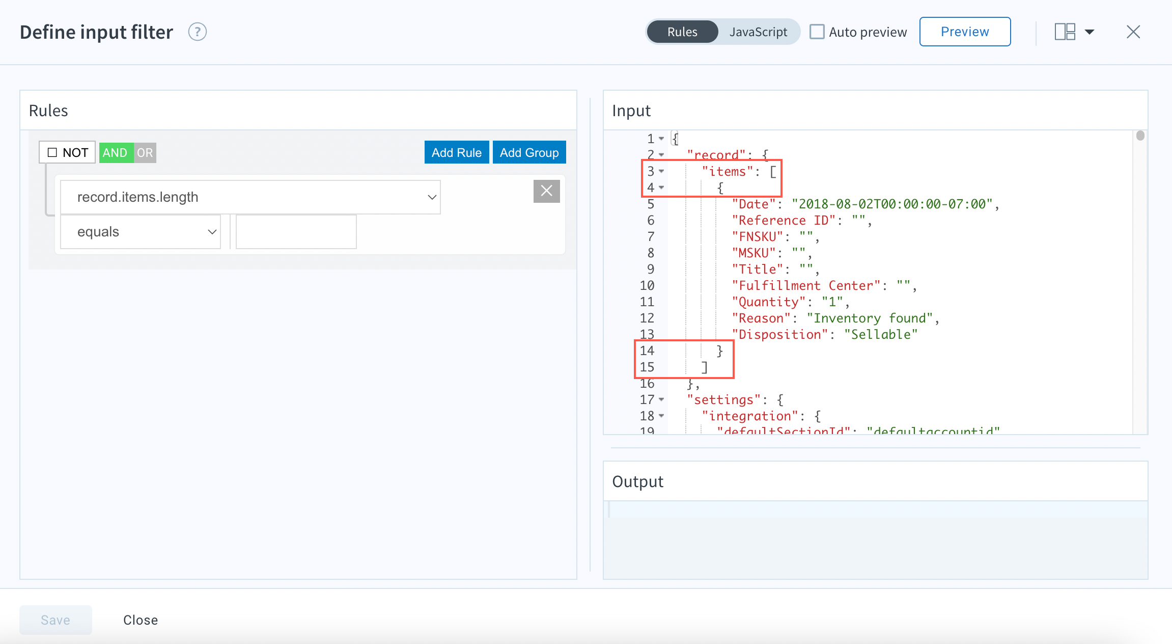

  4. To add an input filter for a node in the “record” object, remove the reference to the “items” array and the brackets and curly braces related to this array under the “record” object (lines 3, 4, 14, and 15 in the image above)
    You will now be able to add the input filter in the Rules section of this dialog box.

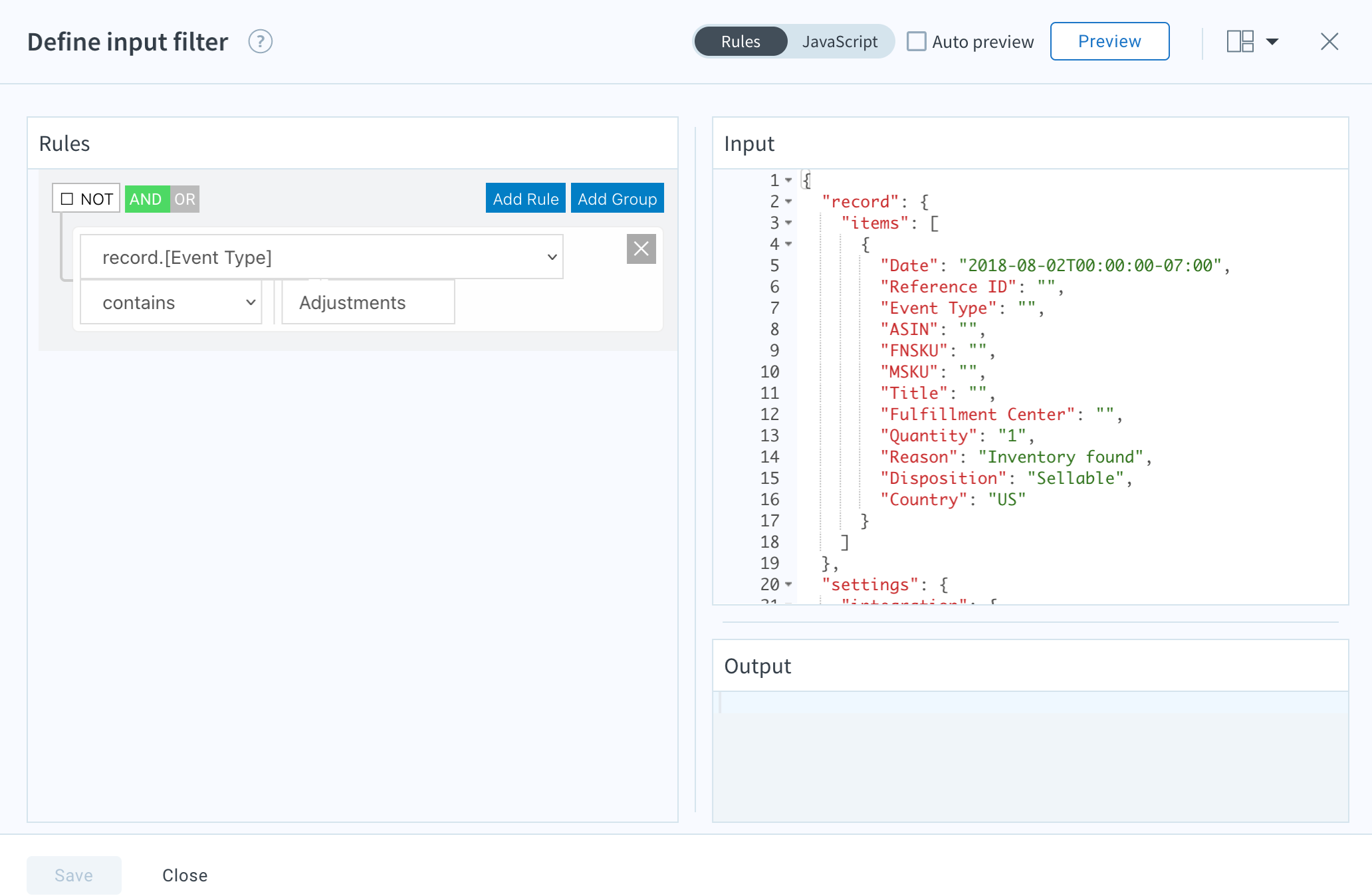

To add the input filter for the 'Adjustments' entry type,
  1. In the Rules section of the Define input filter dialog box, select the record.[Event Type] option from the options available in the drop-down list.
    1. Click Settings (settings_gear.svg) to the right of this field.
    2. Select the Operand type as Field and Data type as String in the Operand Settings dialog box.
    3. Click Save to confirm the changes.
  2. Select the And operator to sync only ‘Adjustments’ event type into NetSuite.
  3. Select the contains option in the drop-down list that appears after the record type is selected.
  4. Enter the value as Adjustments in the text box that appears after the record type is selected.
    1. Click the Settings (settings_gear.svg) button to the right of this field.
    2. Select the Operand type as Value and Data type as String in the Operand Settings dialog box.
    4. The input filter will be displayed as shown in the following image:
  5. Click Save & close to confirm the changes made and return to the flow.
  6. Run the flow and you will notice that only records with the ‘Adjustments’ event type will be synced to NetSuite. Records with all other event types will be ignored.

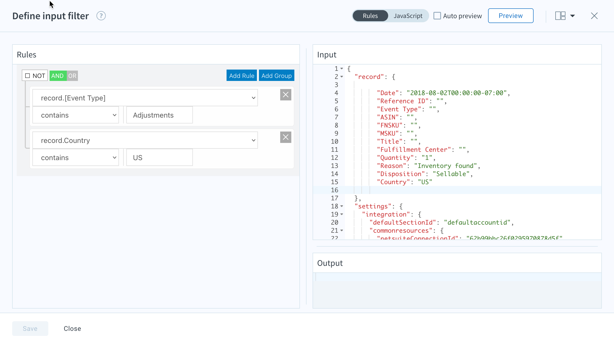

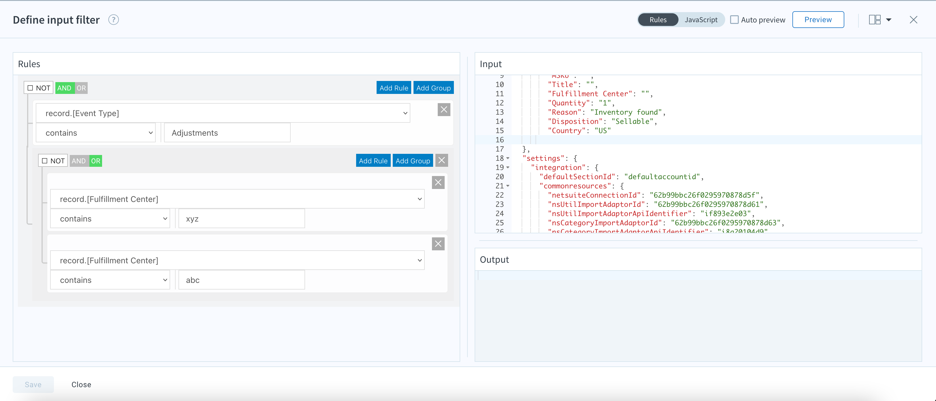

To add the input filter for the country / fulfillment centers,
  1. Click Add Group to add the filter rules for the country / fulfillment centers.
    You can add the input filter for either the country or the fulfillment centers but not both.
  2. To know how to add the input filter for the country / fulfillment centers, see Add input filter for country or fulfillment centers
    The input filter for the 'Adjustments' entry type and the fulfillment centers will be displayed as shown in the following image:
    Input filter for ‘Adjustments’ entry type and country:
    Input filter for ‘Adjustments’ entry type and fulfillment centers:
    Input filters added for 'Adjustments' event type and fulfillment centers.png
  3. Click Save & close to confirm the changes made and return to the flow.
  4. Run the flow and you will notice that the records will be synced to NetSuite only for the 'Adjustments' event type and the fulfillment centers whose fulfillment center IDs have been entered in the newly created input filter.

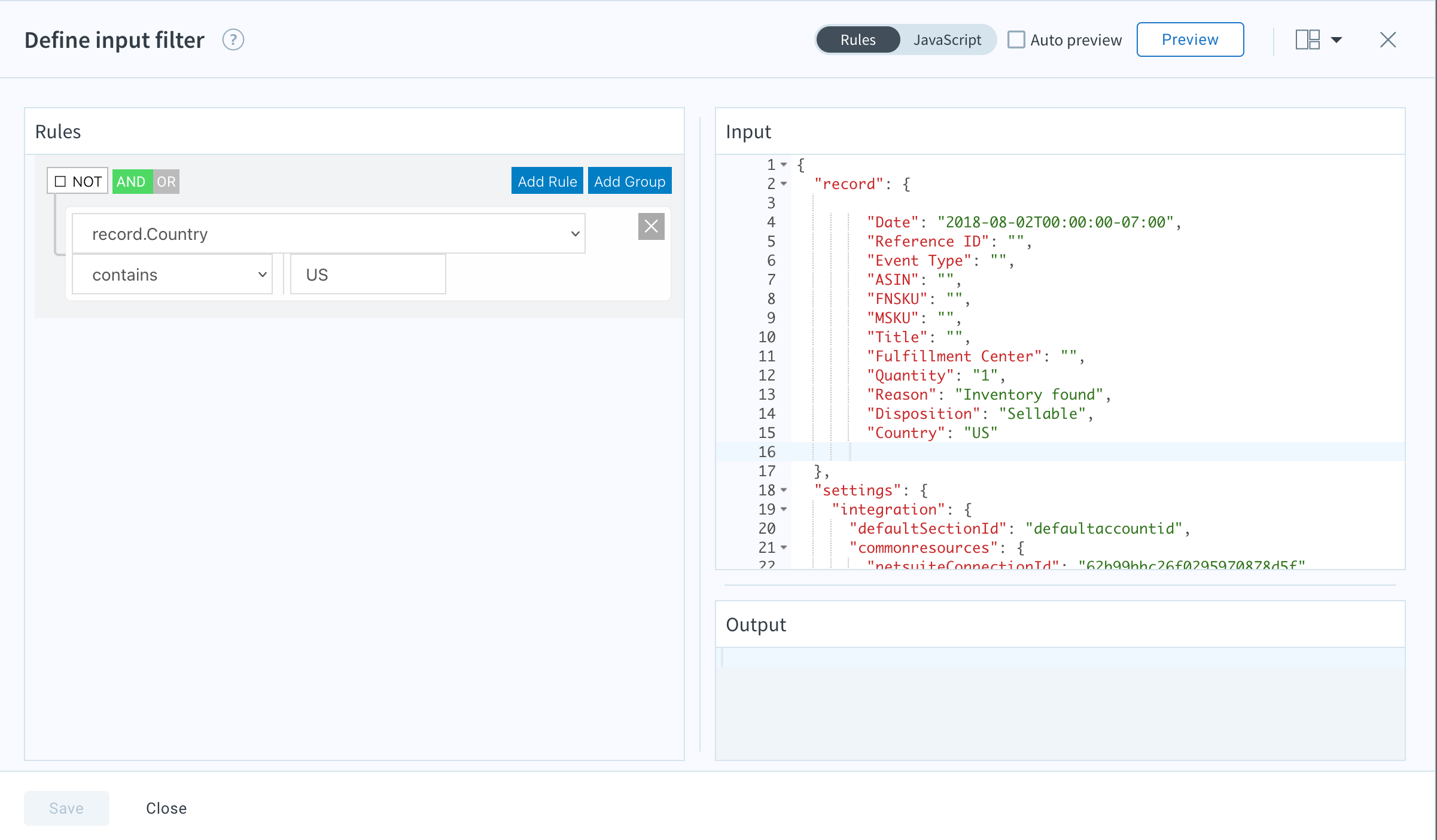

To add the input filter for the country,
  1. Select the And operator to sync only the records for the entered country code into NetSuite.
  2. Select the record.[Country] option from the options available in the drop-down list of the Rules section in the Define input filter dialog box.
  4. Enter the value as <country code> in the text box that appears after the record type is selected. For example, US for United States, CA for Canada, MX for Mexico, etc.
  6. Run the flow and you will notice that the records will be synced to NetSuite only for the country code entered in the newly created input filter.

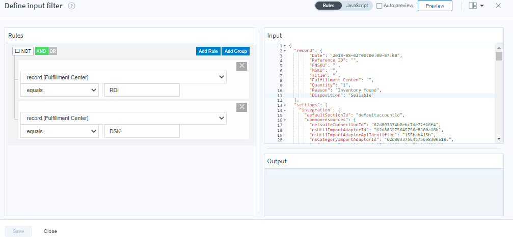

To add the input filter for the fulfillment centers,
  1. If only one fulfillment center ID needs to be added, select the And operator. If multiple fulfillment center IDs need to be added, select the Or operator.
  2. Select the record.[Fulfillment Center ] option from the options available in the drop-down list of the Rules section in the Define input filter dialog box.
  4. Enter the value as <fulfillment center ID> in the text box that appears after the record type is selected. For example, “ABC”, “XYZ”, etc.
  5. Click Add Rule to add details for another fulfillment center to the input filter and repeat the actions described in the steps above to add the details for the new rule added.
    You can add details of as many fulfillment centers as required by clicking Add Rule.
  6. Click Save & close to confirm the changes made and return to the flow.
  7. Run the flow and you will notice that the records will be synced to NetSuite only for the fulfillment centers whose fulfillment center IDs have been entered in the newly created input filter.
