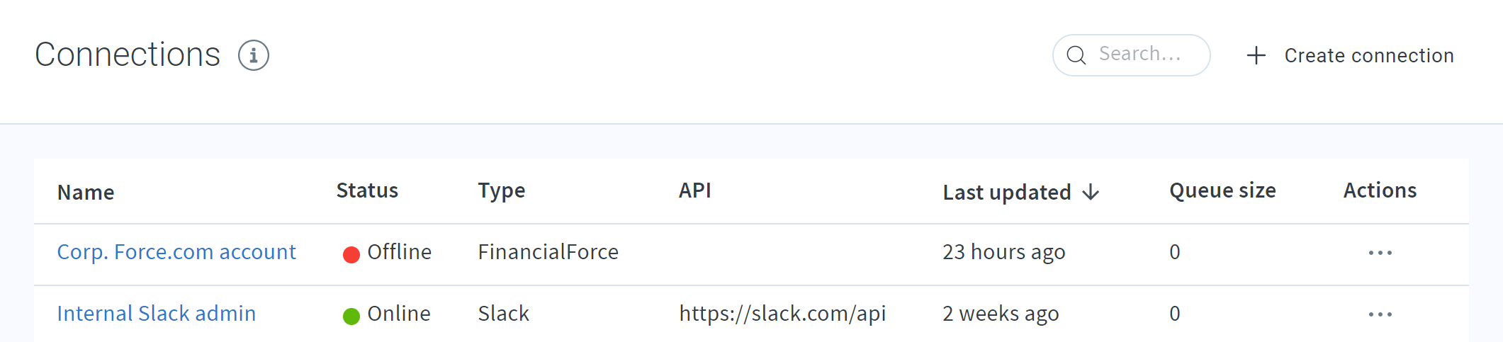

Offline connections will pause your flows
Connections go offline when the authentication to the external application fails.
An offline connection will automatically pause all flows using the connection, and the usage stats for the affected flows will show zero until it is brought back online. As soon as the connection starts working, all paused flows will automatically resume processing right where they left off.
It is very important to get notified when a connection goes offline. See Get error notifications via email (You only) and also Configure error notification emails for other users. When subscribed to connection offline notifications, you will also get notified when the connection goes back online.
It is worth noting that while a connection is offline, integrator.io will automatically test the connection to see if it can be brought back online. If the connection cannot be brought back online after a few days, then integrator.io will cease testing it, and the connection will remain offline until you bring it back online by updating the credentials or clicking Test connection. For real-time flows (initiated with a listener endpoint), data will still be queued by the flow when a connection in the flow is offline, but it will not be processed until the connection is brought back online.

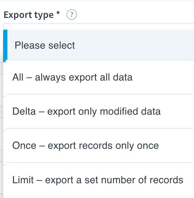

Four different export types to retrieve data
There are four primary patterns for exporting data. Choosing the right pattern for your export will impact the number of records retrieved from the source application each time it runs. To state the obvious, choosing the right pattern to minimize the number of records will give your flow the best performance.
  • All – always export all data
  • Delta – export only modified data
  • Once – export records only once
  • Limit – export a set number of records

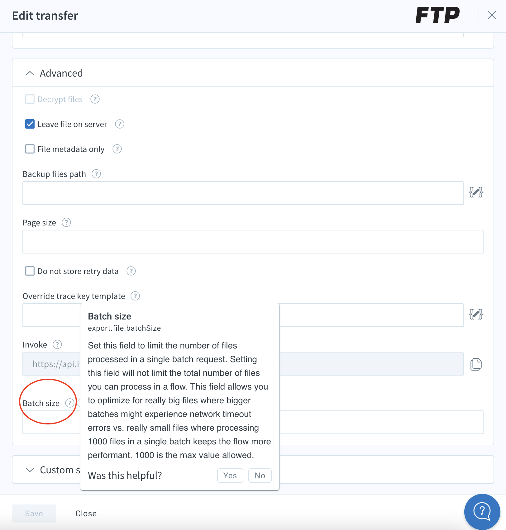

Exporting batches vs. single files from an FTP site
Historically, FTP exports always retrieved files one at a time, and they work great for processing large files. But if you are processing lots of smaller files, then it might slow down your flow. The Batch size setting allows you to control how many files should be retrieved at a time.
The upper bound limit is 1000. The batch size setting affects only the number of files retrieved in a single request to the FTP size; it does not control the total number of files that can be retrieved when a flow is running. When the number of files on the FTP site is greater than the batch size, integrator.io will continue to make subsequent batch requests until all files have been retrieved.
If you are processing a very large number of files that are also very large in size, and you set batch size to 1000, then your flow will likely fail due to network timeout errors associated with trying to retrieve too many large files in a single request to an FTP site.

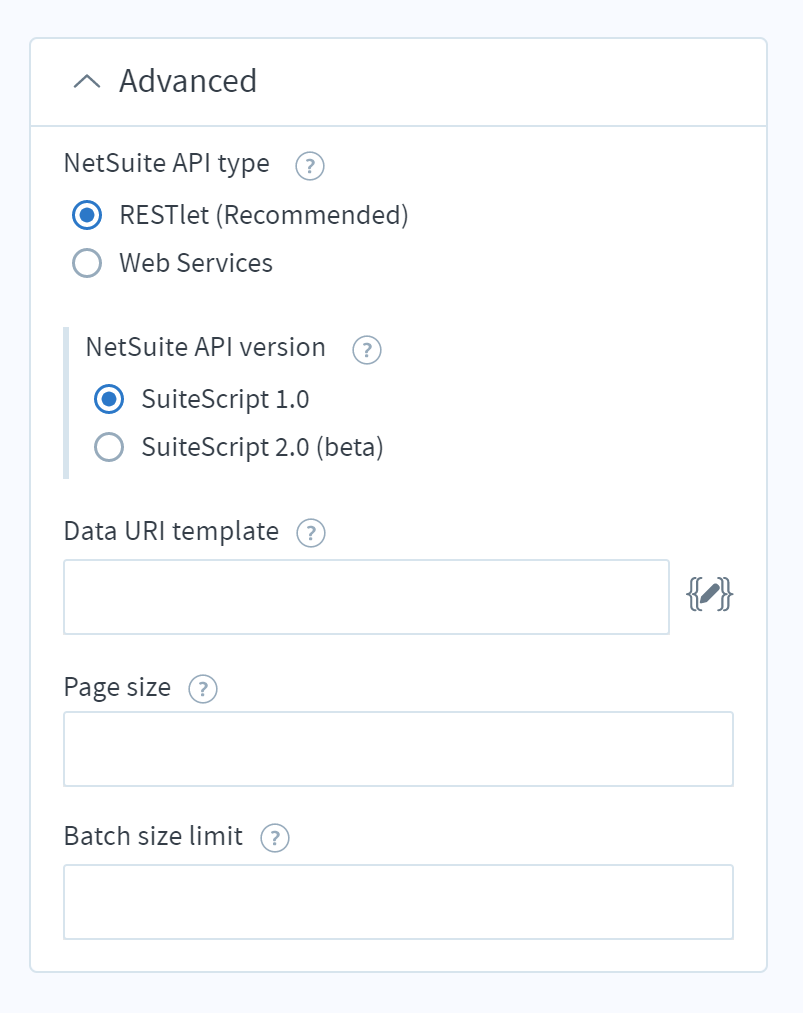

Running SuiteScript hooks on data returned by NetSuite search APIs
NetSuite search APIs always return batches of 1,000 records. This volume can cause performance problems if you are running a SuiteScript based hook on the records before they are exported. For example:
  • You may run out of SuiteScript points or hit NetSuite instruction count limits
  • The sum of all 1,000 records might exceed the 5 MB limit that a SuiteScript hook can process in a single invocation
For such scenarios, specify a value in the Advanced > Batch size limit setting to tell integrator.io to break down the 1,000 records into smaller batch sizes.

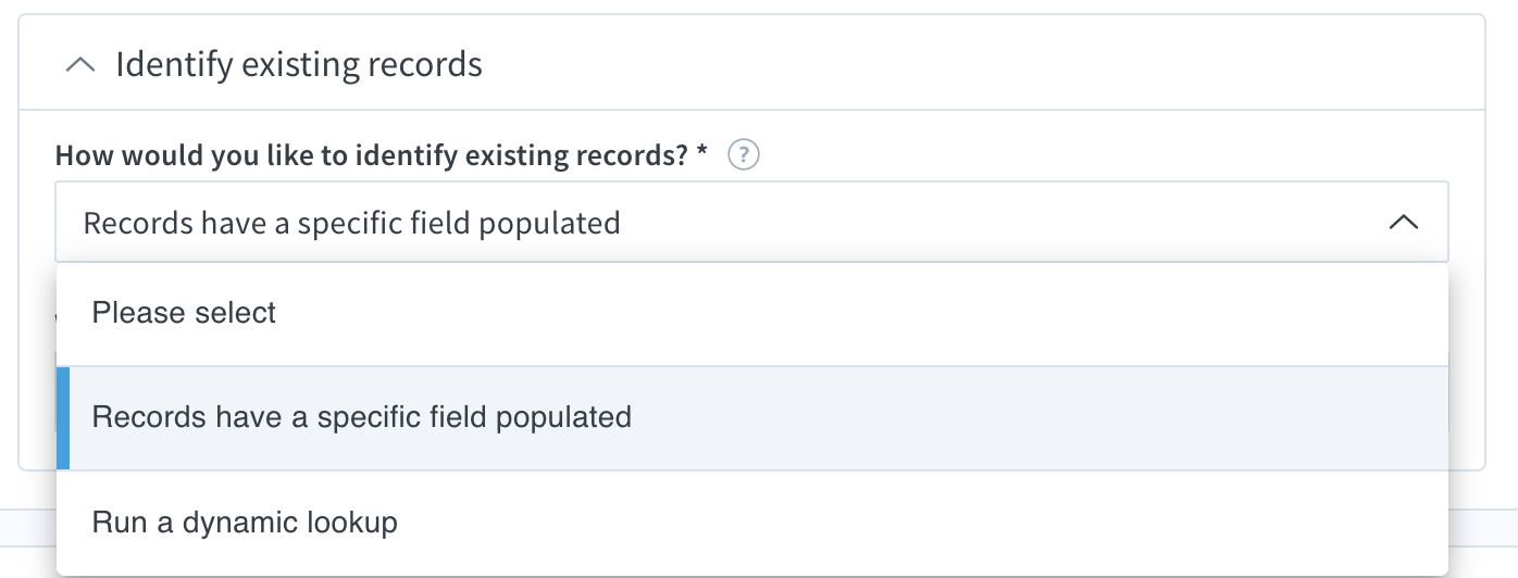

Identifying existing records using a dynamic lookup
When importing records into an application, five patterns are supported by integrator.io.
  1. Create new records & update existing records. If your source records can be either new or existing records, then this option will dynamically create vs update accordingly.
  2. Create new records & ignore existing records. If your source records can be either new or existing records, then this option will create new records and ignore existing records.
  3. Ignore new records & update existing records. If your source records can be either new or existing records, then this option will ignore new records and update existing records.
  4. Update existing records. If your source records are always existing records, then this option will always update existing records.
  5. Create new records. If your source records are always brand new records, then this option will always create new records.
For each of the first four patterns above, you must choose how to tell if a record is new or existing (see image below). When you choose to run a dynamic search, then the same performance concerns outlined above for dynamic lookups in field mappings applies here, too.
If you want to remove the dynamic lookup from your import, then the most common way to do this is to build a secondary flow to sync the dynamic values from the destination application back into the source application. Then, you can pick the option Records have a specific field populated to reference the ID field in your source record.

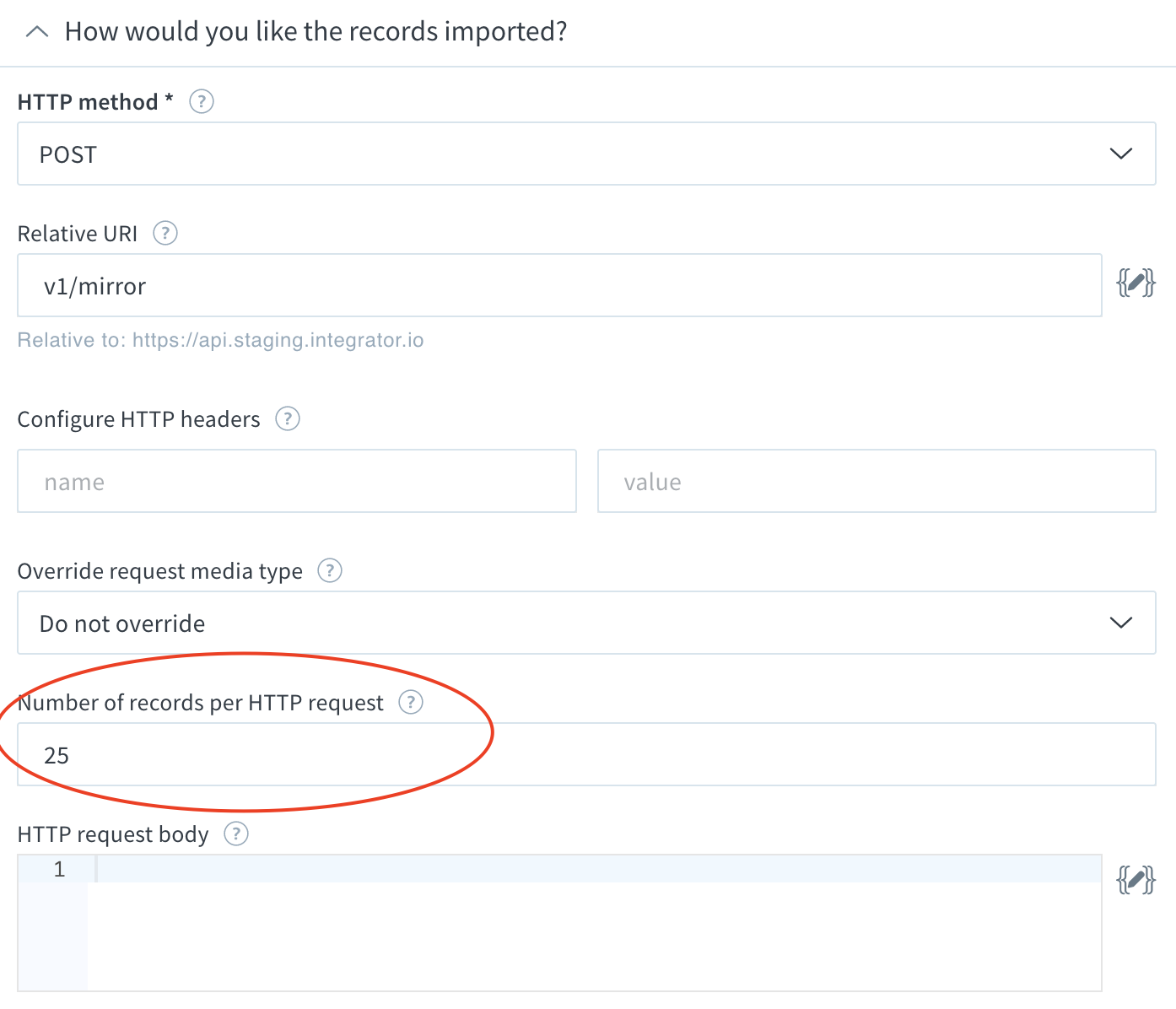

Submitting records in batches to minimize network API calls
For many applications, you can choose the number of records that should be sent in each request to the destination application. Choosing a larger batch size will reduce the number of network API calls that need to be made, and should improve the performance of your flow. Please note the following parameters:
  • Most applications have a hard limit on the number of records that can be submitted in a single batch request.
  • Batch size cannot be greater than the page size of the flow, because integrator.io will not aggregate records across pages to build a batch.
  • Batch size can be much smaller than page size. For example, page size can be 1000 and batch size can be 5, and then integrator.io will break the page into 200 batches.

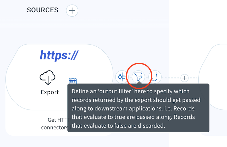

Input and output filters
Output filters and input filters provide a mechanism to exclude records from being processed by your flow. To state the obvious, the more records you can discard, or ignore at specific steps in your flow, the better your flow performance will be.
Output filters and input filters are very similar, but differ in one major regard.
  • Output filters allow you to remove records entirely from the flow such that the records will not get processed by any of the steps in the flow. Output filters are a great way to optimize the performance of your flows. They are especially useful if you are exporting data from an API or a file system that does not natively support the ability to exclude records through search criteria.
