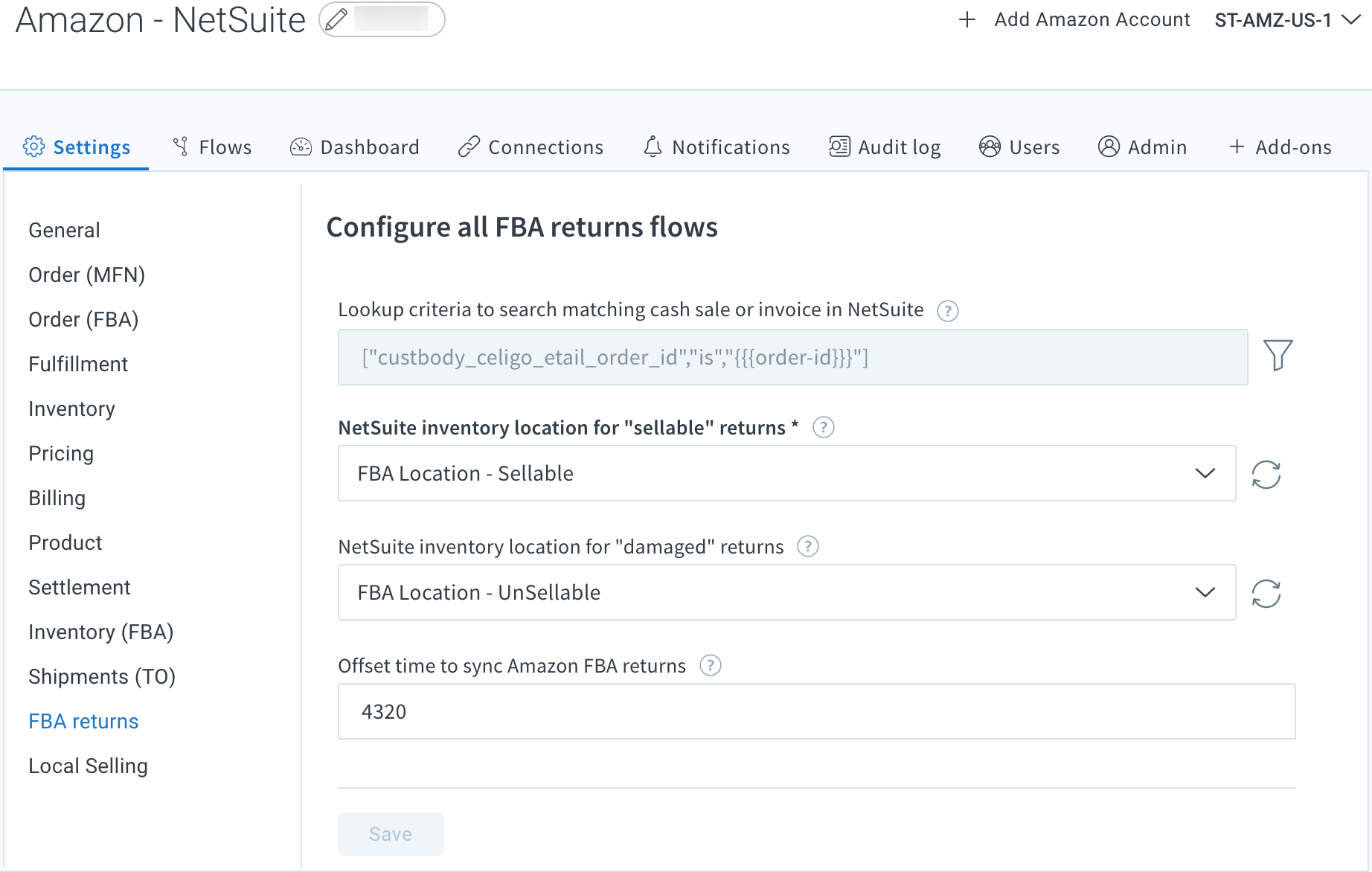

  3. Go to Settings > FBA returns.
    1. In the Lookup criteria to search matching invoices in NetSuite setting, define the lookup criteria to search for the matching invoices in NetSuite. By default, the flow looks for the "eTail order ID" from the FBA returns report. The default value is [‘custbody_celigo_etail_order_id’ ‘is’, {{order-id}}]. You can modify the lookup criteria according to your business needs.
    2. From the NetSuite inventory location for "sellable" returns setting, select a NetSuite location to track your inventory for “sellable” returns. If you are not using a different location to track your inventory for “damaged” returns, the return authorization record will have only “sellable” records.
      • This is a mandatory setting.
    3. From the NetSuite inventory location for "damaged" returns setting, select the location to track your returned inventory that is “damaged.”
      If you don’t select any location in the NetSuite inventory location for "damaged" returns setting:
      • In NetSuite, if the Advanced Receiving checkbox is checked (Setup > Company > Setup Tasks > Enable Features page > Transactions tab > Shipping & Receiving sub-tab), then you can find the “damaged” returns on the item receipt with “restock” as No.
      • If the Advanced Receiving checkbox is unchecked, the “damaged” returns are ignored. The item receipt will only have “sellable” disposition records.
        IMPORTANT: It is recommended to select an account in the Write-off account for returns drop-down list (Setup > Accounting > Accounting Preferences page> Order Management tab > Returns sub-tab) to track the damaged returns on the item receipt. If you do not select any account in the Write-off account for returns drop-down list, the restock value is "Yes" for all the item receipt lines, irrespective of the Amazon disposition or the location selected in the NetSuite inventory location for "damaged" returns integration app setting.
    4. In the Offset time to sync Amazon FBA returns setting, enter the value in minutes to wait before syncing Amazon FBA returns. Amazon recommends a value of 4320 (= 72 hours or 3 days).
