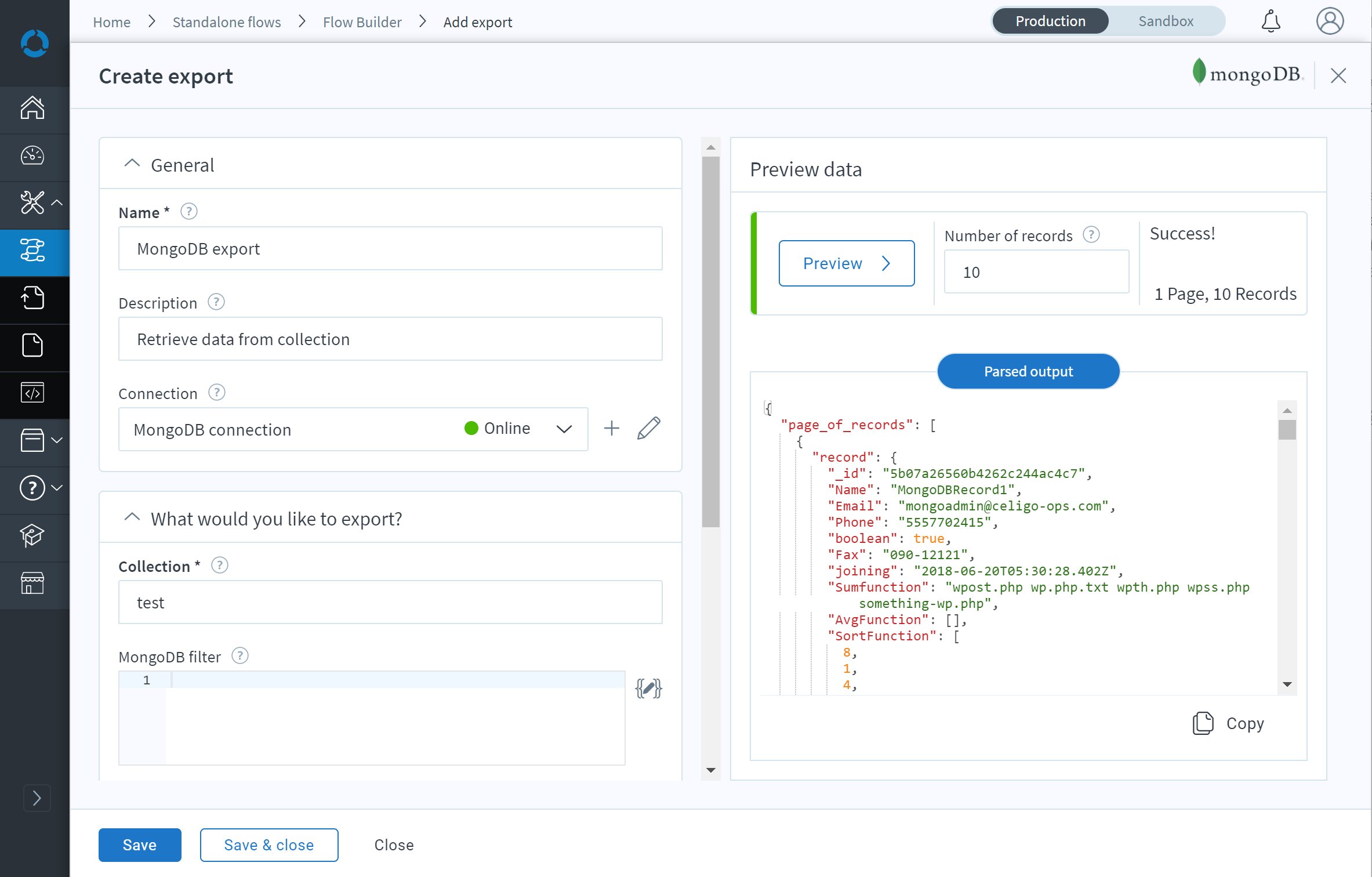

Describe the export
Name (required): Name your export so that you can easily reference it from other integrator.io resources.
Description (optional): Describe your export so that others can quickly understand what it is doing without having to read through all the fields and settings. Be sure to highlight any nuances that someone should be aware of before using your export in their flows. Also, as you make changes to the export, be sure to update this field.
Collection (required): Enter the name of the MongoDB collection in your database that you will query, such as orders, items, users, or customers.
Filter (optional): To export only specified documents from your collection, enter a filter for this setting. Handlebars are supported, but the final value must be a valid JSON-formatted string describing a MongoDB filter object, in the correct format and with the correct operators. Refer to MongoDB documentation for the list of valid query operators and the correct filter object syntax. For example:
{"Name":"MongoDBRecord1"}
The filter field supports handlebars expressions. However, filter validation only applies when handlebars are not present.
Warning
When filtering the record based on the _id field, the Id must be written as follows, so integrator.io processes it as a MongoDB Id rather than a string:
{"id":"ObejctId('id')"}
Projection (optional): To return only a subset of fields from each MongoDB document, enter a projection here. The value of this field must be a valid JSON-formatted string describing a MongoDB projection object – in the correct format and with the correct operators (not mixing inclusions and exclusions). Refer to MongoDB documentation for the expected projection object syntax and operators. For example:
{"Name":true}

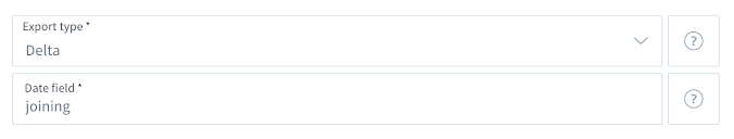

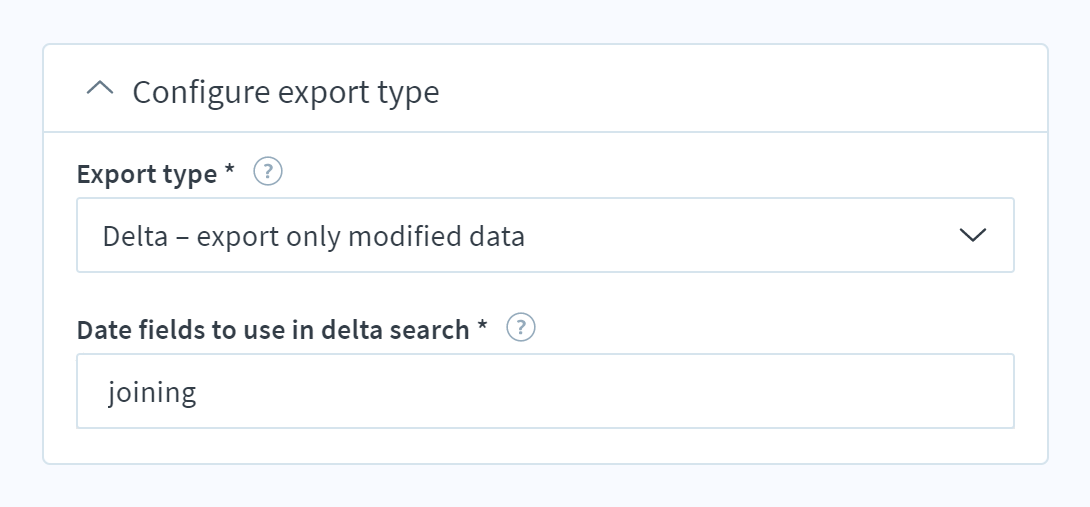

Delta
Export all records with a Date field value that is greater than the last time the data flow was run.
Date field (required): Provide a date field in MongoDB that integrator.io can use to keep track of records that have changed since the last time the export was run. It is recommended that you pick a system-generated field. For example, many applications maintain a standard Date Last Modified or Last Modified Date field that always contains the date and time that a record was last changed. You could select a custom field if you have your own logic in place to set the field accordingly whenever a relevant change is made to a record.
The MongoDB field must contain a valid date value, such as a BSON date type. A string containing a timestamp will not be interpreted as a date for purposes of comparing changed records for the export.

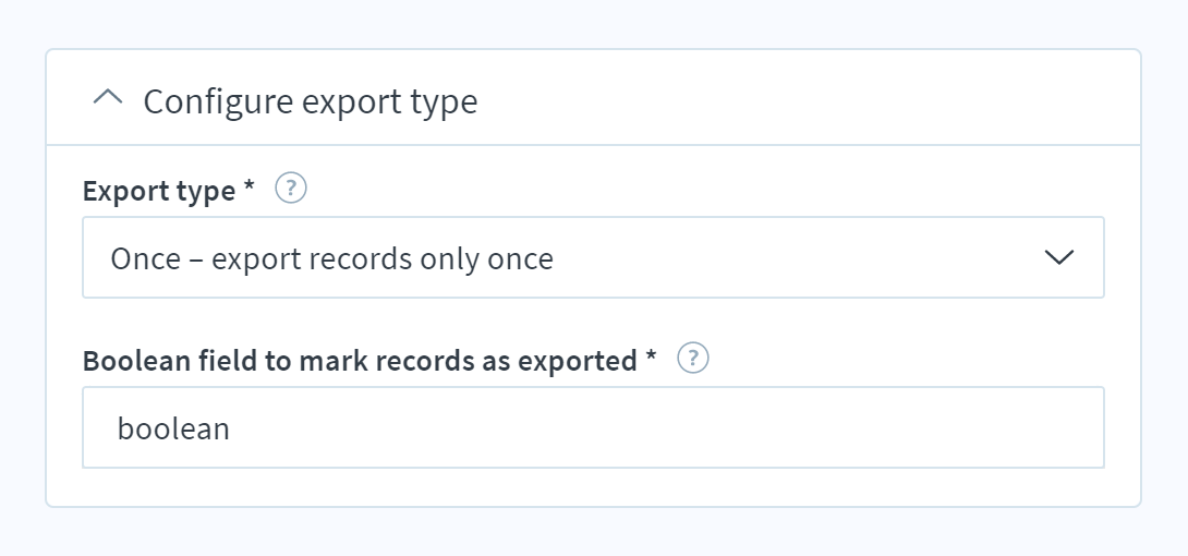

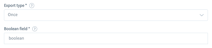

Once
Export any records that have not been exported already and automatically update records to mark them as exported.
Boolean field (required): Select a Boolean (checkbox) field in MongoDB that integrator.io can use to keep track of records that have been exported. integrator.io will export only those records where this field is false (unchecked) and then make a subsequent request to MongoDB to set the Boolean field to true for all exported records (so that they are exported once).

Preview exported data
You can validate your expressions by clicking Preview to view the first record in the results or any errors.
This export preview will show the results for all export types except Delta, in which case you would have to validate any export errors.
