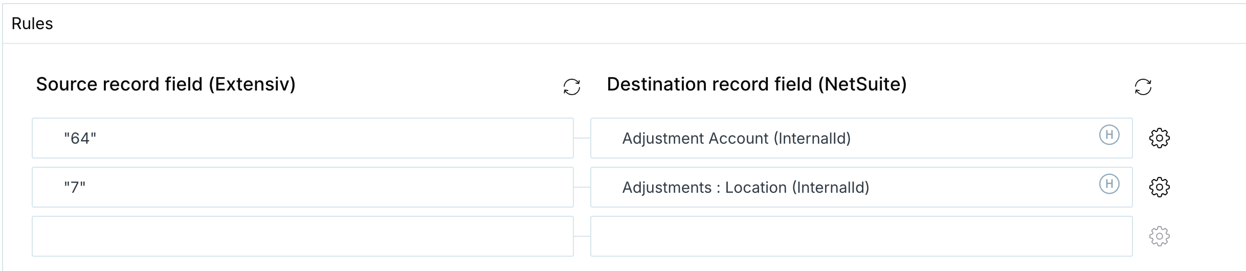

Extensiv inventory adjustments to NetSuite inventory adjustments
This flow syncs Extensiv inventory adjustments as NetSuite inventory adjustments. When a new inventory adjustment is created in Extensiv, this integration flow exports inventory adjustment from Extensiv to NetSuite.
Flow details
- Export source: Extensiv
- Built-in export: Get Extensiv inventory - get all inventory from Extensiv that have been created since this flow last ran.
- Importdestination: NetSuite
- Built-inimport: Import NetSuite inventory adjustment - add or ignore inventory adjustments in NetSuite with the configured custom field as the lookup identifier.
Before you begin
- Verify that Extensiv Items have the same values as NetSuite Items.
- Create an inventory cost revaluation field for the NetSuite item.
Setup instructions

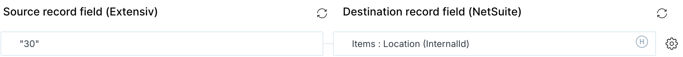

- Configure the following mapping according to your business requirements in Import NetSuite inventory adjustment, before running the flow.
- Add subsidiary mapping to Import NetSuite inventory adjustment.

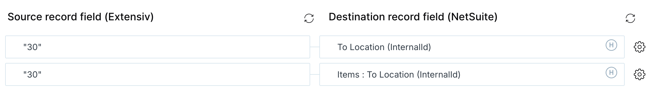

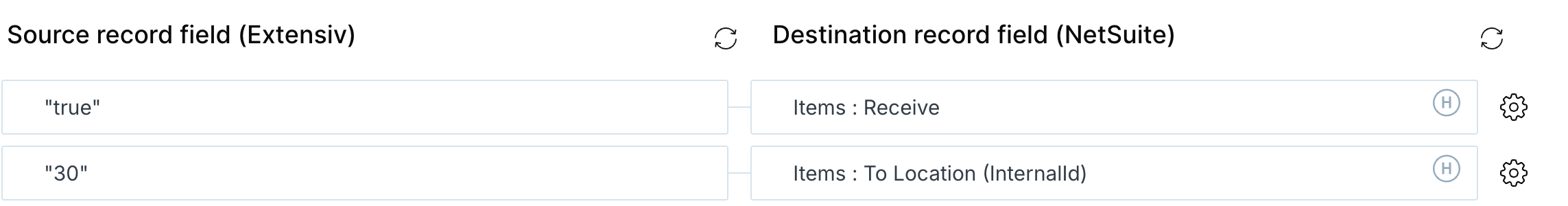

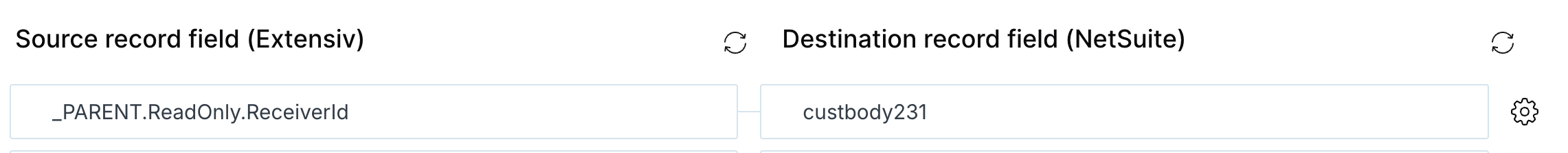

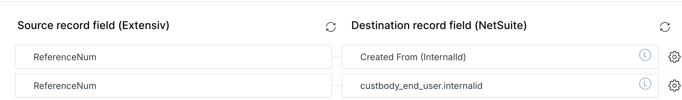

Extensiv inventory receivers to NetSuite return authorizations and item receipts
This flow syncs Extensiv inventory receivers as NetSuite return authorizations and item receipts. When a new inventory receiver is created in Extensiv, this integration flow exports the inventory receiver from Extensiv to NetSuite as return authorization and item receipt.
Flow details
- Built-in export: Get Extensiv inventory receivers - get all inventory receivers from Extensiv that have been modified since this flow last ran.
- Built-in lookup: Get NetSuite sales orders - get all sales orders from NetSuite with Order # as the lookup identifier.
- Built-inimport: Import NetSuite return authorizations - add or ignore return authorizations into NetSuite with PO # as the lookup identifier.
- Built-in input filter: Import NetSuite return authorization item receipts - filter for record ID that is not empty.
- Built-inimport: Import NetSuite return authorization item receipts - add or ignore return authorizations item receipts into NetSuite with Ref.No. as the lookup identifier.
Before you begin
- The NetSuite sales orders and item shipments with Extensiv sales orders must be in sync.
- The Extensiv shipment confirmations to NetSuite item shipments must be in sync.
- The NetSuite Order # should have the same values as Extensiv Ref.No.
Setup instructions

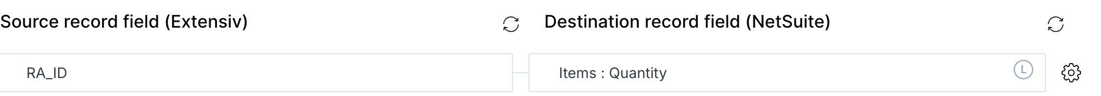

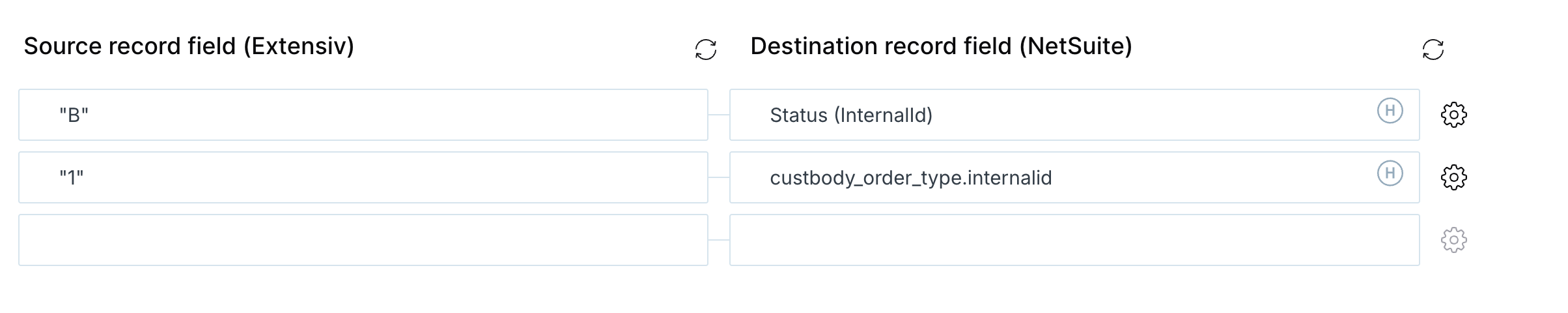

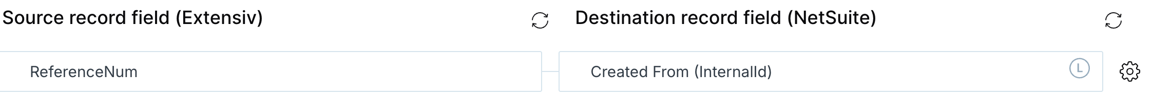

- Configure the mappings according to your business requirements in Import NetSuite return authorizations, before running the flow.
- Configure the following dynamic according to your business requirements in Import NetSuite return authorizations, before running the flow.
- Configure the following dynamic according to your business requirements in Import NetSuite return authorization item receipts, before running the flow.
- Configure the mappings according to your business requirements in Import NetSuite return authorization item receipts, before running the flow.

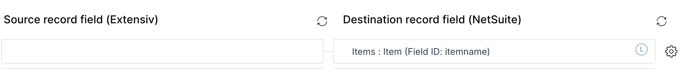

- Configure the mappings according to your business requirements in Import NetSuite item shipments, before running the flow.
- Configure the dynamic mappings according to your business requirements in Import NetSuite item shipments, before running the flow.

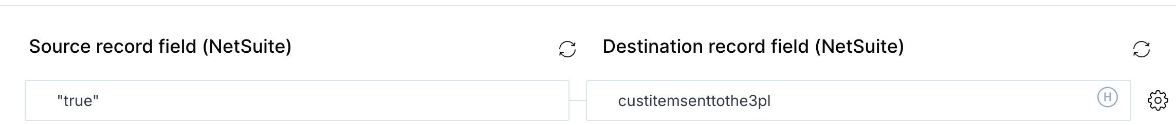

- Create a custom checkbox field in the NetSuite import and configure the mappings according to your business requirements in Import NetSuite inventory items and Import NetSuite assembly items, before running the flow.

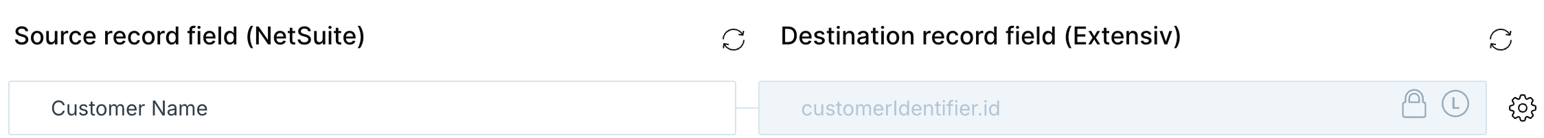

- Verify the NetSuite customer name is mapped to the Extensiv company name.
Setup instructions

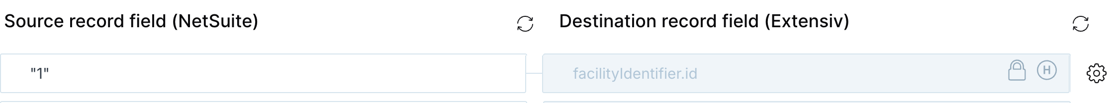

- Configure the mappings according to your business requirements in Import Extensiv sales orders, before running the flow.
- Configure the dynamic mappings according to your business requirements in Import Extensiv sales orders, before running the flow.

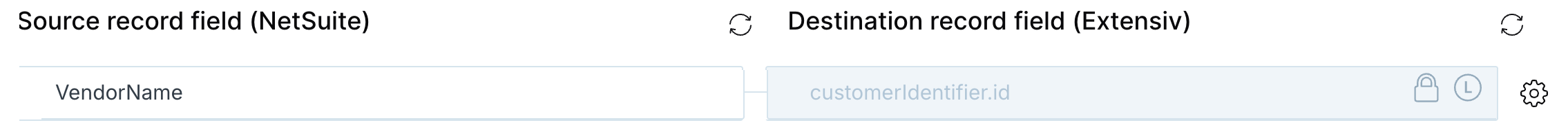

- The NetSuite vendor name and Extensiv customer name should be the same in both NetSuite and Extensiv.
- The NetSuite items and Extensiv items should be the same in both Extensiv and NetSuite.

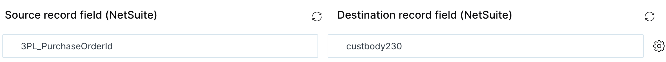

- The Extensiv purchase order ID should be stored as a custom field in the NetSuite purchase order.
Setup instructions

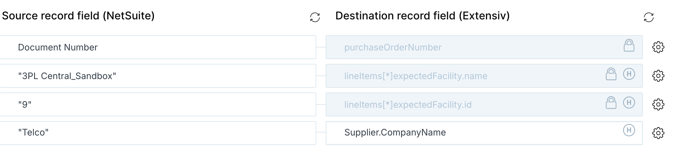

- Configure the mappings according to your business requirements in Import Extensiv purchase orders, before running the flow.
- Configure the dynamic mappings according to your business requirements in Import Extensiv purchase orders, before running the flow.
- Create a custom field in NetSuite purchase order to store Extensiv purchase order ID in NetSuite.
