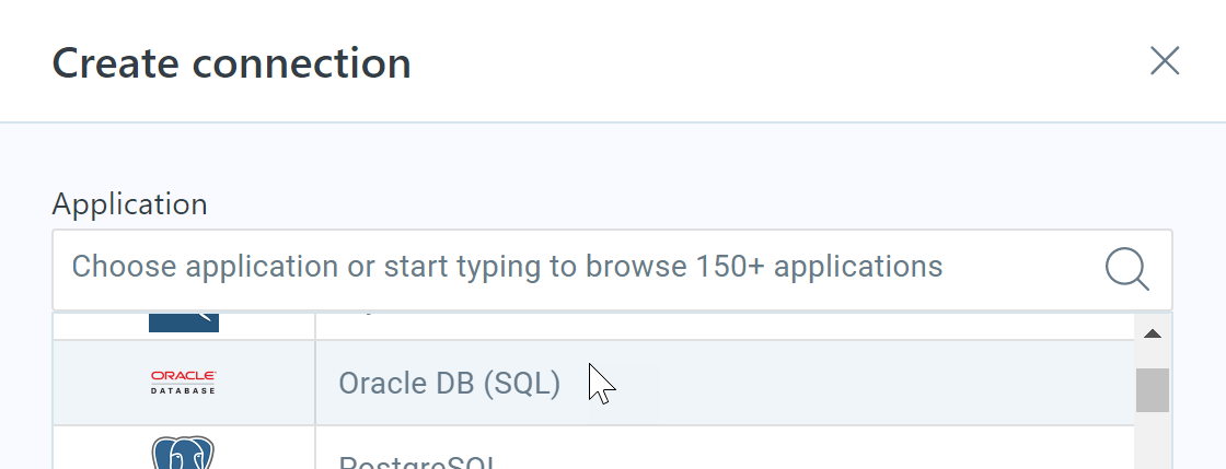

Start establishing a connection to Oracle DB (SQL) in either of the following ways:
    – or –
In the resulting Application list, select Oracle DB (SQL).

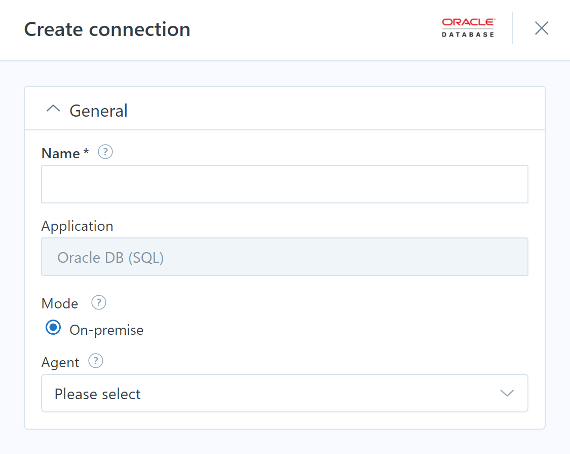

B. Describe the Oracle DB connection
At this point, you’re presented with general settings about the Oracle DB connection:
Application (required, not-editable): A reminder of the app you’re editing.
Agent (required): To connect to an on-premise application integrator.io requires that an agent be installed on a computer that has network access to the on-premise application. Once the agent has been installed you can reference the agent with the drop-down menu here. A single agent can be used by multiple different connections.

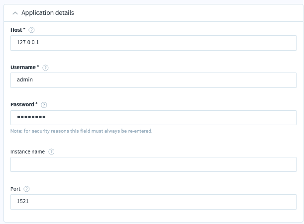

C. Edit required Oracle DB (SQL) settings
At this point, you’re presented with a series of options for establishing Oracle DB (SQL) authentication.
Host (required): Enter the hostname or IP address of the server you are connecting to.
Username (required): Enter the username to authenticate with the server.
Password (required): Enter the password to authenticate with the server.
Instance name (optional): This field specifies the instance name to connect to. The SQL Server Browser service must be running on the database server, and UDP port 1521 or 1434 on the database server must be reachable. If you set this field you cannot also set the port field because "instanceName" and "port" are mutually exclusive connection options.
Port (optional): The server port to connect to. The default port is 1521.

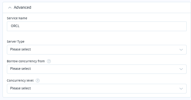

D. Edit advanced Oracle DB settings
Before continuing, you have the opportunity to provide additional configuration information, if needed, for the Oracle DB connection.
Service Name: This field specifies the name or alias of a database service that integrator.io should connect to. Not every Oracle installation will use this feature. In this case, "ORCL" is the service name used by the external database.
Server Type: Choose one of the following server types from the drop-down menu:
