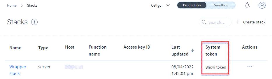

Wrappers require you to create your own stack to store all the logic for connecting to and communicating with the external system. You're able to see Stacks in the Resources menu.
Use the following steps to create a server stack:
Navigate to → .
Click + Create stack.
In the Name field, enter an appropriate name for the stack that you are about to create.
Use the drop-down list in the Type field to select Server.
Enter the server URL in the Host field.
Click Save & close.
Once you've saved the stack, click Show token in the System token column, and copy the token. You'll need this access token to enable the wrapper extension to communicate with integrator.io.
Review the express-integrator-extension readme files to specify the wrapper functions required to set up the connection. The ping function is especially important since it allows integrator.io to detect if the connection to your stack is active.

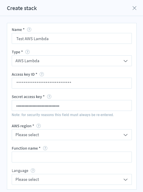

Use the following steps to create a AWS Lambda stack:
Navigate to → .
Select AWS Lambda from the Type drop-down list.
Enter the Access Key Id and the Secret Access Key.
Select the region from the AWS Region drop-down list.
Enter the Function name.
Select C#, Java, Node.js, or Other from the Language drop-down list.
Click Save & close.
Review the lambda-integrator-extension readme files to specify the wrapper functions required to set up the connection. The ping function is especially important since it allows integrator.io to detect if the connection to your stack is active.

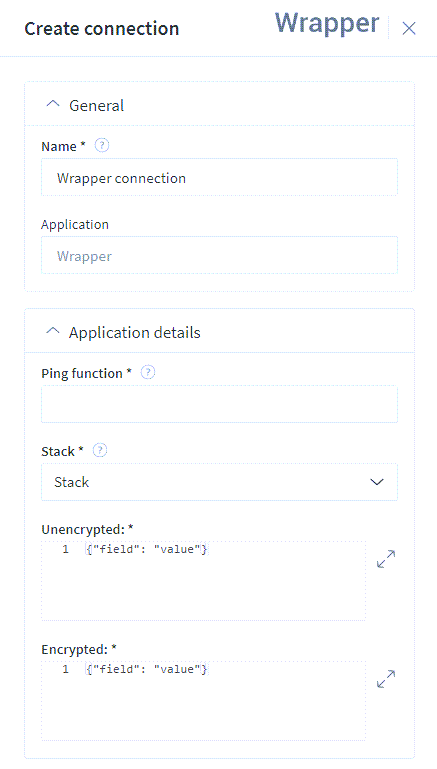

Use the following steps to create a wrapper connection:
After completing the above steps, click → → → .
Ping function: If you're using a ping function in your wrapper code, specify that function name here. This enables integrator.io to test your connection. If your connection goes offline due to an intermittent issue, integrator.io runs a batch process every hour (with an exponential decay) to regularly ping your connection and bring the connection back online if possible. If the connection drops and is re-established, pending or in progress jobs will resume processing.
Stack: Choose the stack that is hosting your wrapper code.
Unencrypted: Provide any non-sensitive data here.
Encrypted: Provide any sensitive data here.
