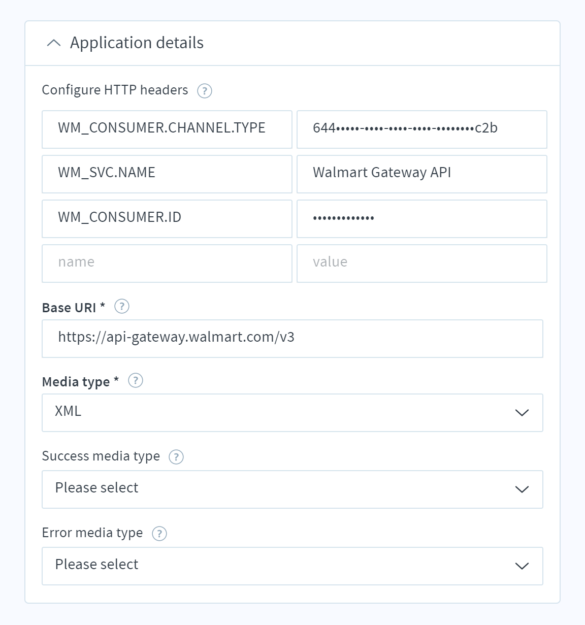

B. Edit HTTP application details
Note: This article is concerned only with the settings needed for Walmart DSV connections. For complete field documentation, see Set up a custom HTTP connection.
Configure HTTP headers: Add the following headers, with the values provided with your Walmart account:
Name | Value |
WM_CONSUMER.CHANNEL.TYPE |
Enter the Consumer Channel Type received during onboarding |
WM_SVC.NAME |
Enter Walmart Gateway API |
WM_CONSUMER.ID |
Copy the Consumer ID you see when signed into the Developer Center |
Base URI: Enter https://api-gateway.walmart.com/v3
Media type: Select XML.

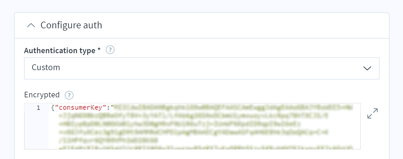

C. Configure auth settings
Continuing in the Create connection pane, select Custom for the Authentication type. The settings then become specific to custom HTTP connections:
Encrypted: Provide your value for the {'consumerKey': '<consumer key/private key>'}

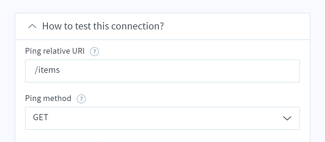

D. Specify how to test the connection
Scroll down farther to the How to test this connection? section:
Ping relative URI: Enter /items
Ping method: Select GET.
