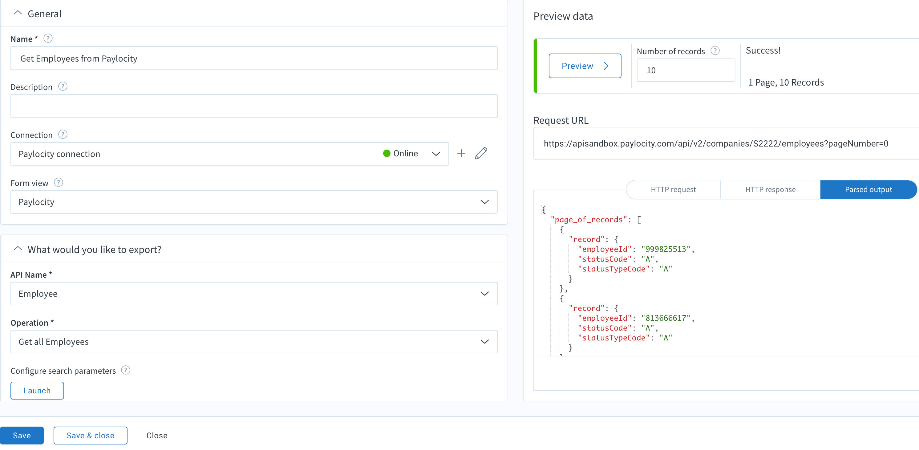

There are two steps to get employee information from Paylocity:
Get information from Paylocity: Here you can retrieve all the employees from Paylocity through API.
You can add a filter where the status code should be A(Active).

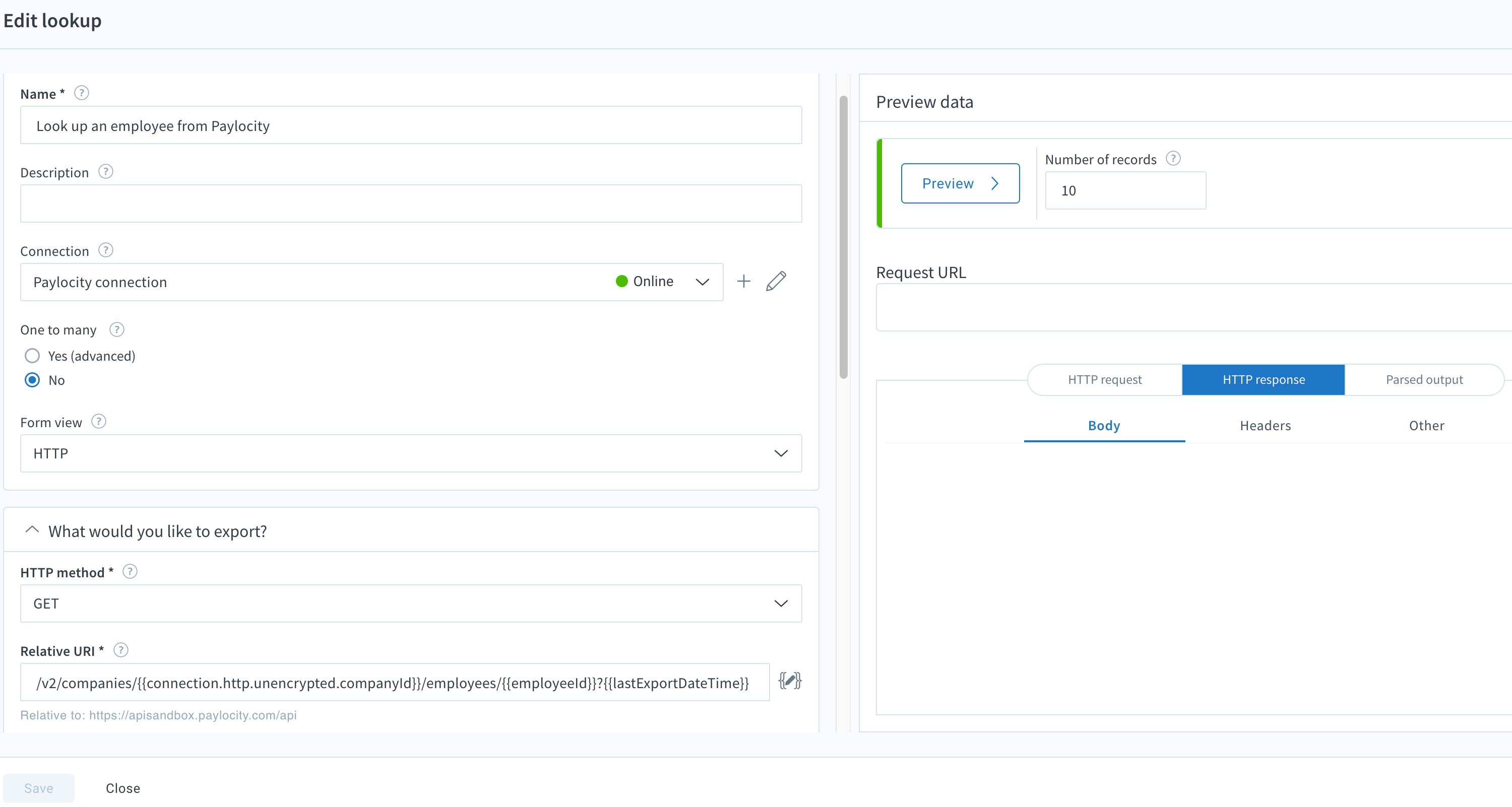

Look up an employee from Paylocity: This step will be based on getting information using the employee id which was selected in the previous step. The export type here is delta, where we have added lastExportDateTime in the Relative URI.
