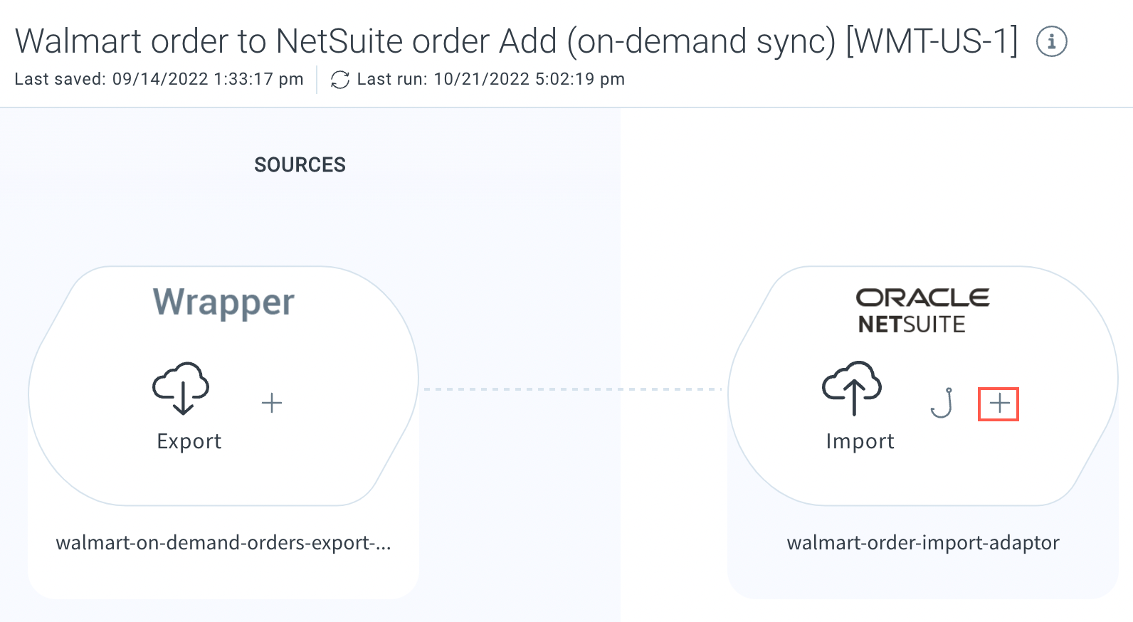

  1. Access the Walmart order to NetSuite order Add (on-demand sync) flow.
  2. In the walmart-order-import-adaptor, click the Define options icon.

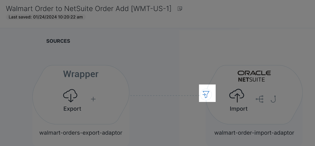

  3. The Input filter button will appear to the left of the walmart-order-import-adaptor.

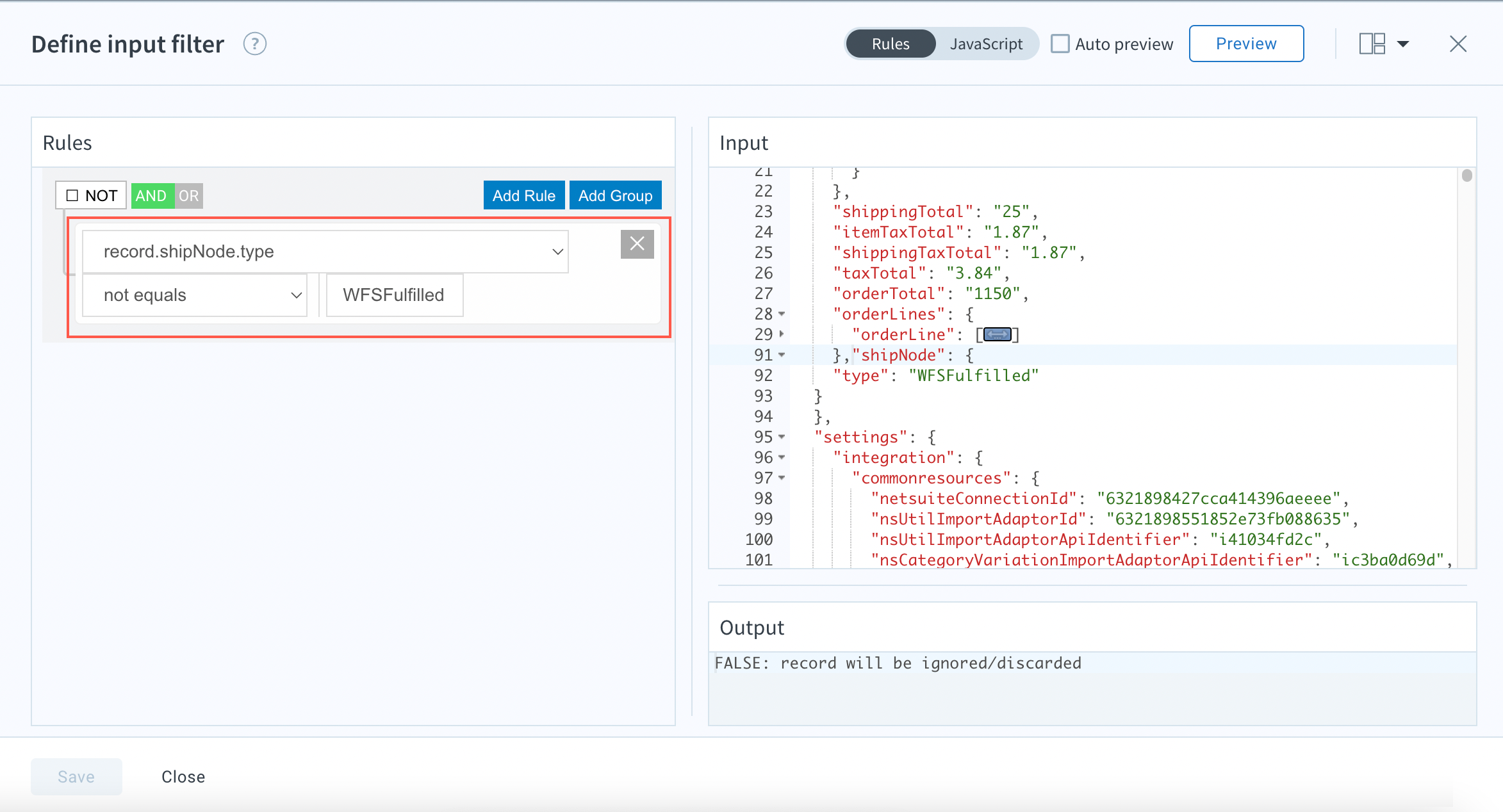

  4. Click the Input filter button to access the Define input filter dialog box.
  5. In the Rules section of the Define input filter dialog box, select the record.shipNode.type option from the options available in the drop-down list.

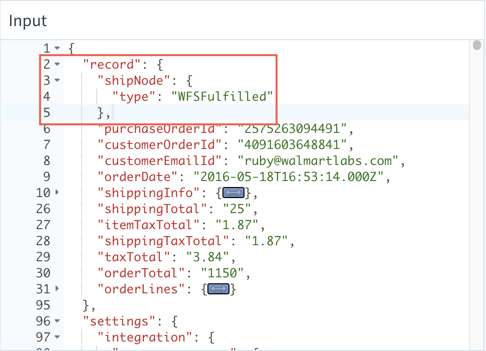

    If this option is not available for selection, add the shipNode field under the record field in the Input JSON:
    "shipNode": {
    "type": "WFSFulfilled"
  6. Select the not equals option in the drop-down list that appears after the record type is selected.
  7. Enter the value as WFSFulfilled in the text box that appears after the record type is selected.
    The input filter will be displayed as shown in the following image:
