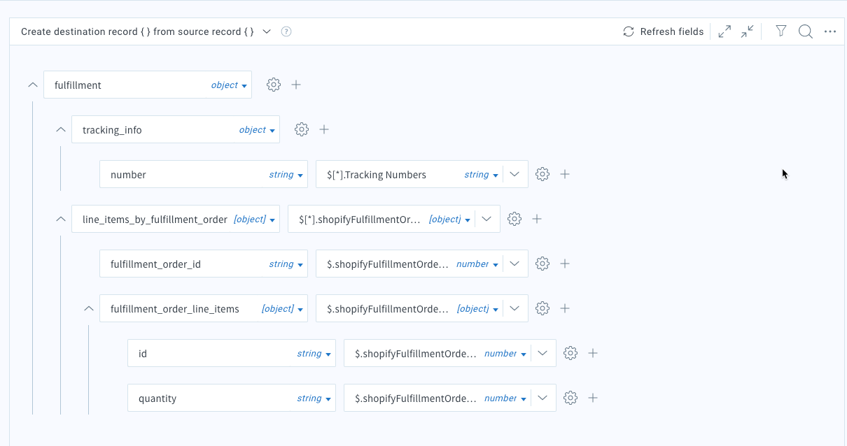

- Replace the Shopify fulfillment import
- The new import calls the updated fulfillment API which creates the fulfillment against one or more fulfillment orders.
- A script will match the shipment data against the fulfillment orders depending on the Shopify id at the line level of the shipment. The script will provide an updated list of fulfillment orders and lines that must be fulfilled.

Mappings are updated to use the list of fulfillment orders and lines to be fulfilled based on the matching process in the script. If there are any custom mappings in the existing flow, copy the mappings as explained in the section Copy flow mappings.
Update Method 2
In this method, we are retaining the existing custom mappings in the updated flow and will handle the transformation to meet new API requirements within the script.
