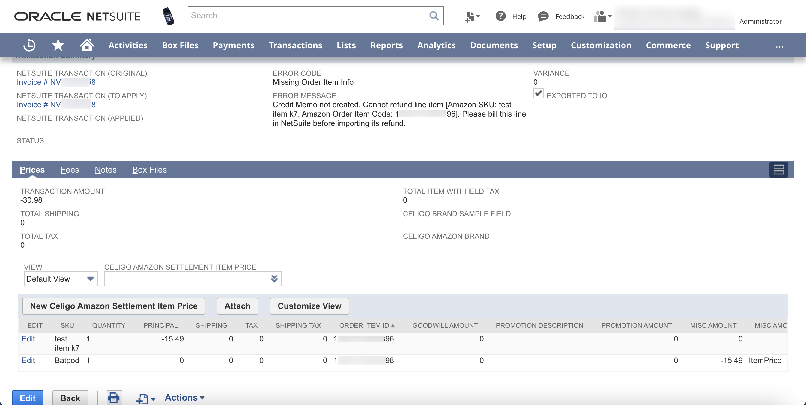

A sample of how a refund transaction is displayed in NetSuite with the incorrect order item IDs updated for the transaction line items is shown below:
In this sample, you can see that the Exported to IO checkbox is checked. However, the record is not exported to IO as the incorrect order item IDs have been assigned to the transaction line items of the refund transaction. The Error Code and Error Message fields display this information.

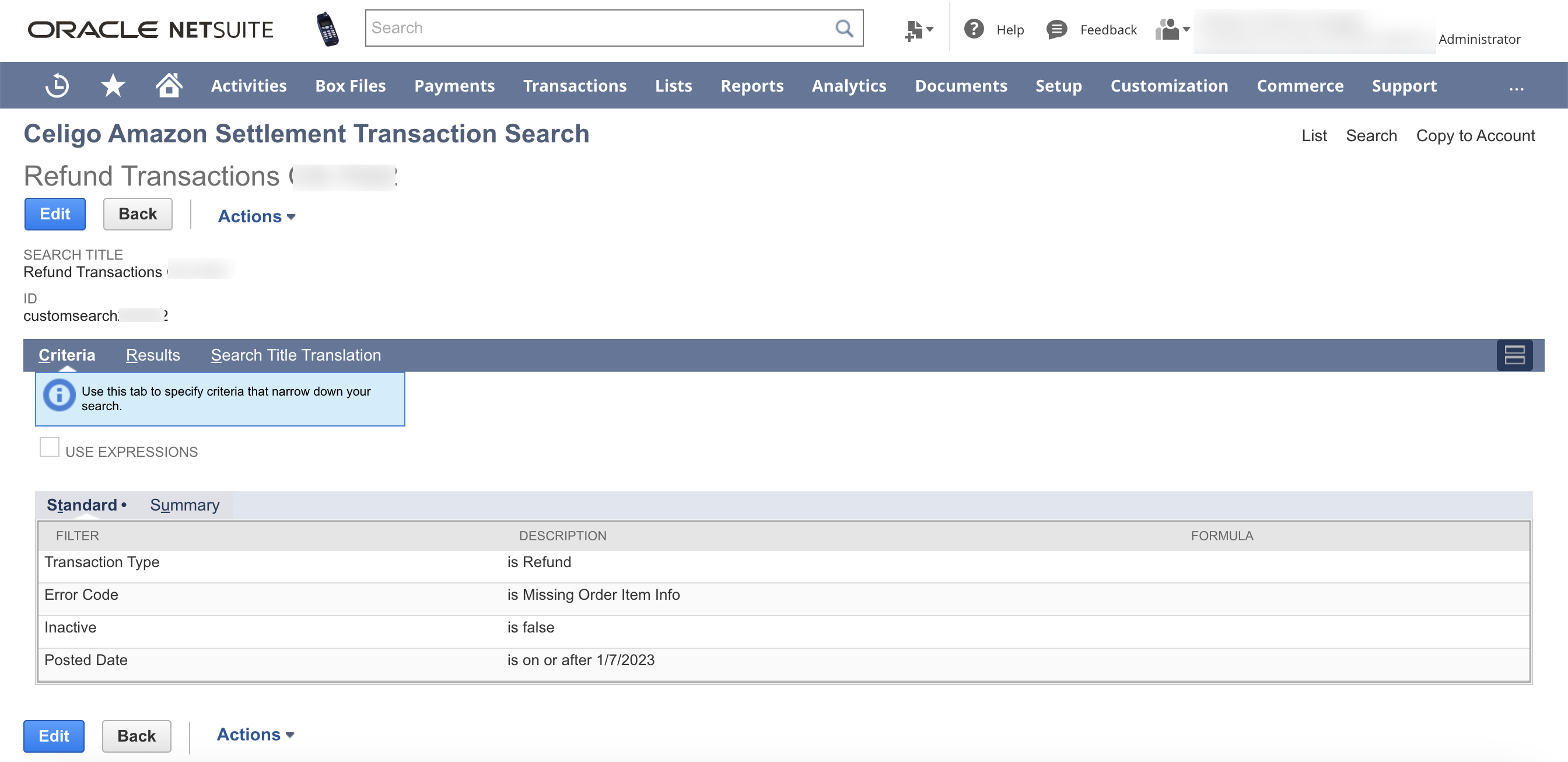

After the custom flow is configured, you need to create a new saved search in the Celigo Amazon Settlement Transaction Search screen in NetSuite with the following parameters:
- In the Criteria tab, select the following parameters:
| Filter | Description |
| Transaction Type | is Refund |
| Error Code | is Missing Order Item Info |
| Inactive | is false |
| Posted Date | is on or after 1/7/2023 |

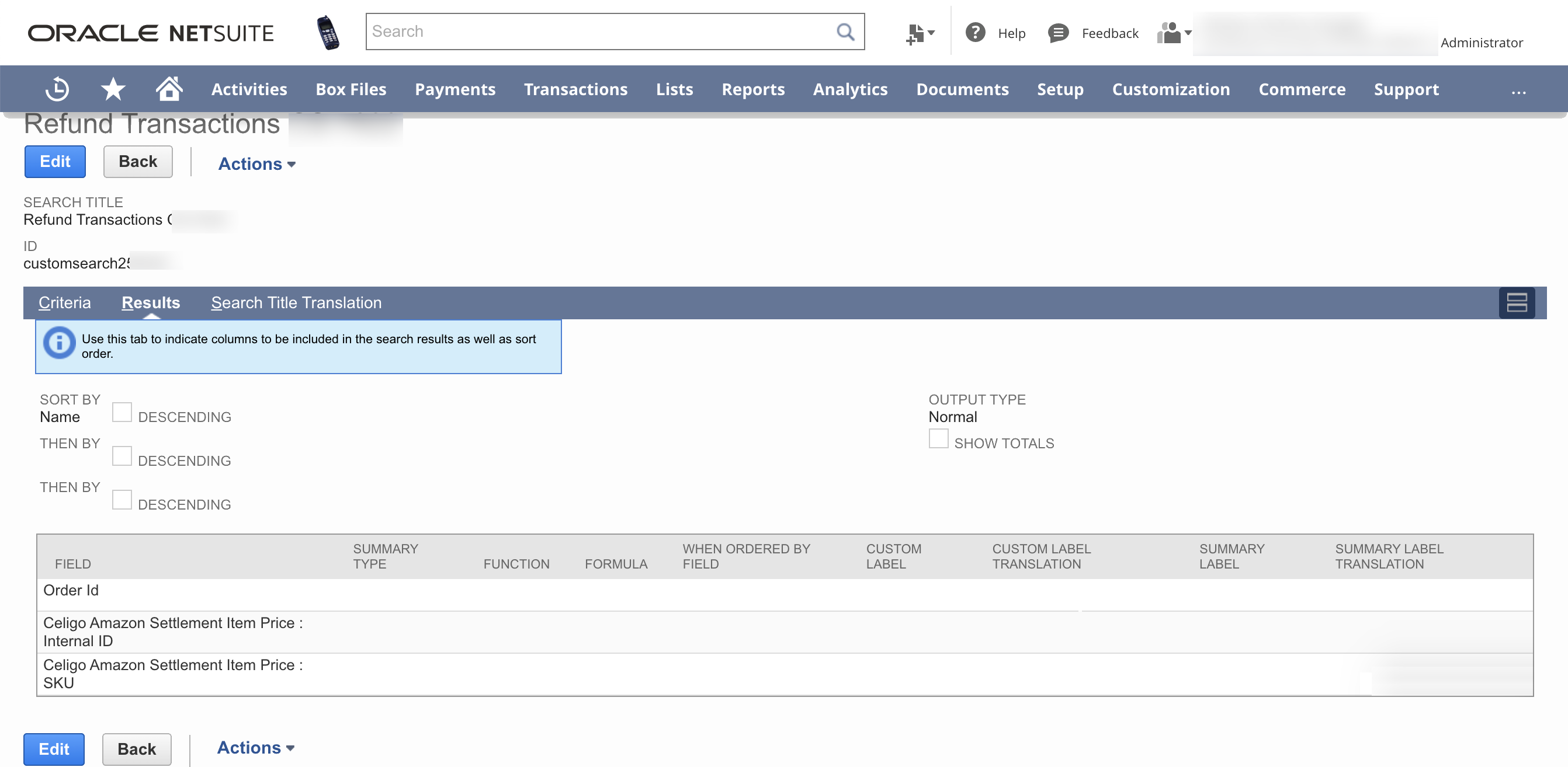

- In the Results tab, select the following fields:
- Order Id
- Celigo Amazon Settlement Item Price: Internal ID
- Celigo Amazon Settlement Item Price: SKU

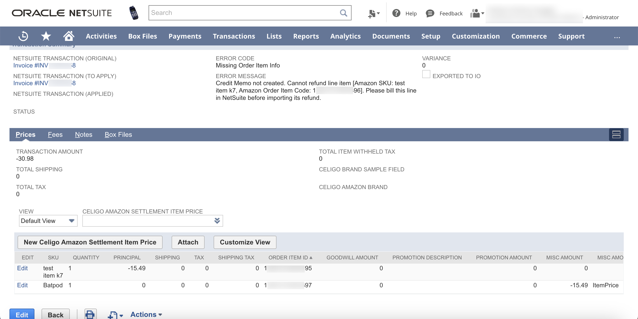

A sample of how a refund transaction is displayed in NetSuite with the correct order item IDs updated for the transaction line items after running the Amazon - NetSuite refund errors custom flow is shown below:
In this sample, you can see that the Exported to IO checkbox is not checked and the correct order item IDs are mapped to the transaction line items in the refund transaction. The information displayed in the Error Code and Error Message fields will be updated once the NetSuite Settlement Transaction to NetSuite Refund Add flow is run again and the transaction is successfully synced in NetSuite.
