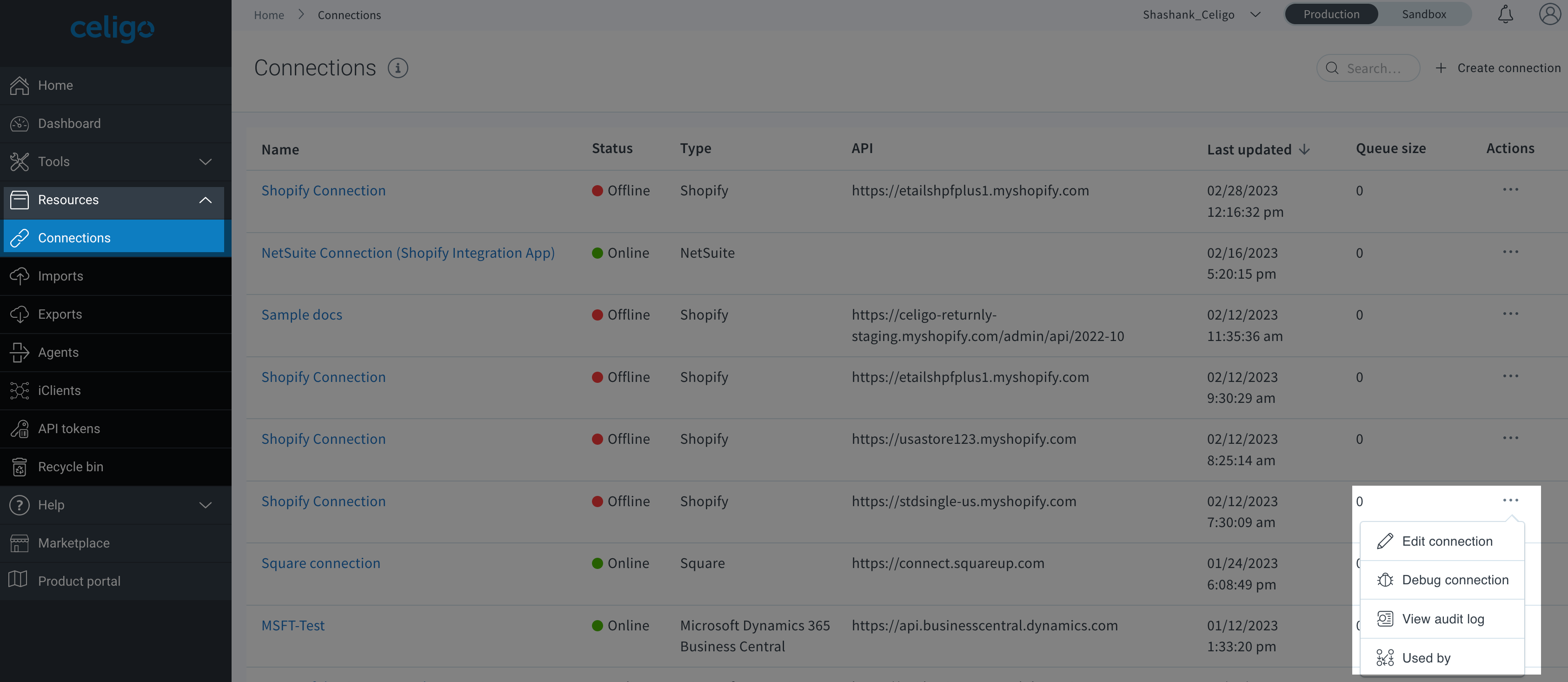

  4. In the Actions column of the connection you want to delete, click the three dots.
  5. Click Used by and check if the connection is being used by other resources or if it’s a primary connection.

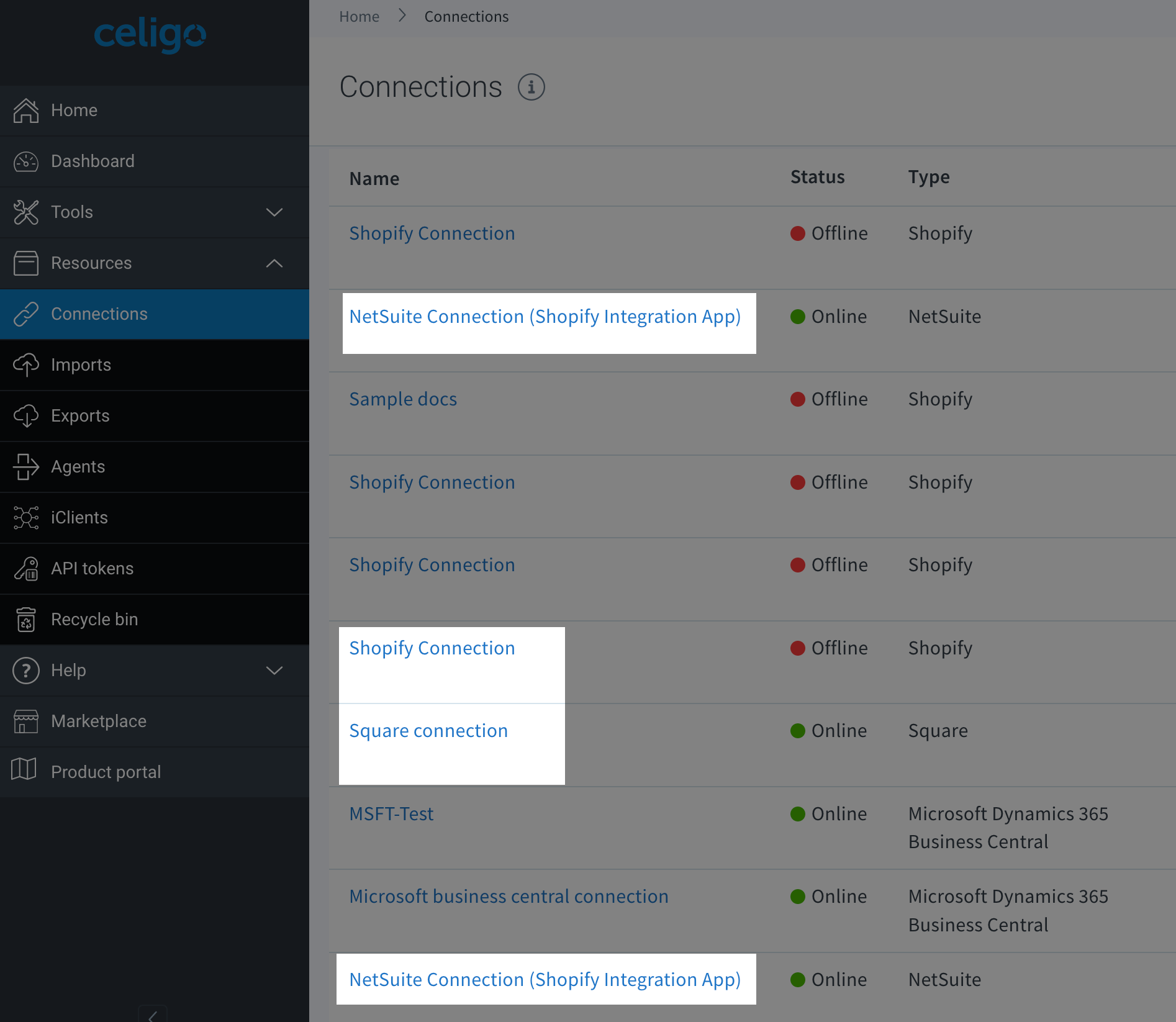

    • Do not delete the primary connection. The primary connection is created by default during the installation of the integration app, deleting it might impact the functionalities of the integration app and might not work as expected. Assume you have deleted a primary connection unknowingly, use this Restore endpoint explained below to get back the connection.
    • The primary connection follows the naming convention as <app name> Connection and this cannot be edited. The naming convention is the one detail with which you can easily identify the primary connection. For example, <Shopify> Connection , as shown in the following screenshot. Only for NetSuite connections, the primary connection name has additional details. For example, <NetSuite> Connection (Shopify Integration App).

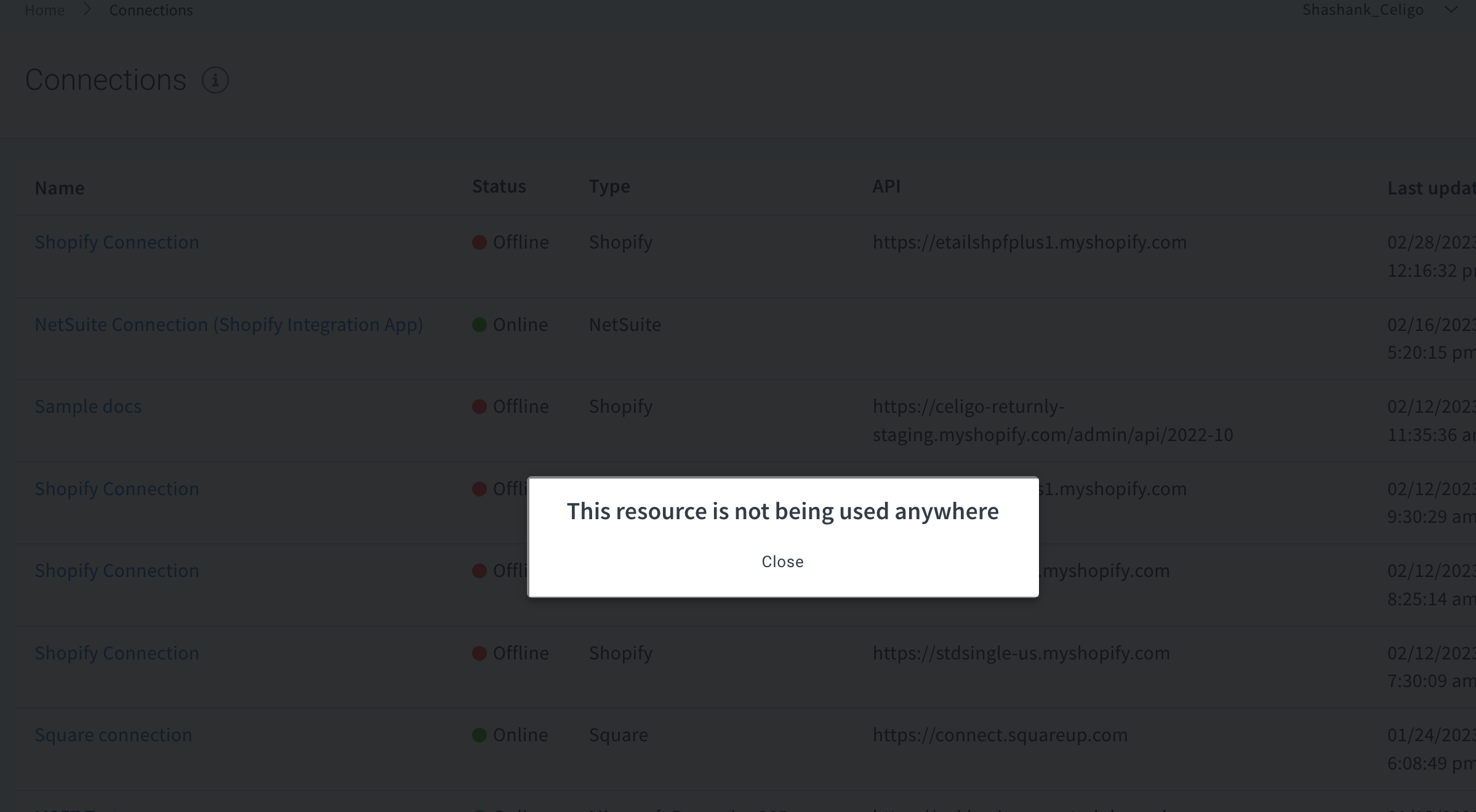

  6. Unlink the connection from all the resources, if you want to delete the connection. Once you unlink the connection, the Used by window displays the following message.
