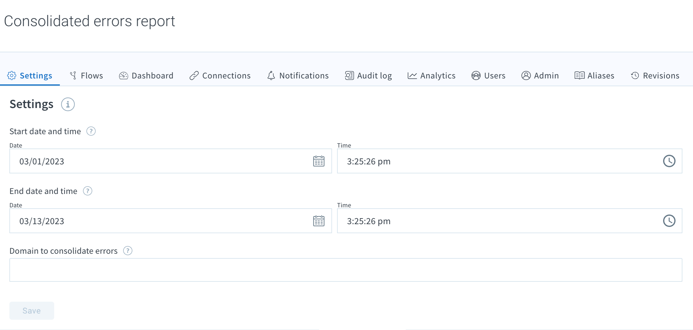

  1. Access the Consolidated errors report tile.
  2. Access the Settings tab to customize the time duration and the domain to consolidate the errors.
    1. Start date and time: Select the start date and time to review consolidated errors. Select the start time in the UTC time zone. The start date can be within the last 30 days or earlier depending on your data retention plan. For example, if you want to review errors that have occurred since 08:00 AM EST 01/31/2023; you can select the start date and time as 01:00 PM UTC 01/01/2023.
    2. End date and time: Select the end date and time to review consolidated errors. Select the end time in the UTC time zone. The end date can’t exceed the present date and time. For example, if you want to review errors that occurred between the Start date and time and 08:00 AM EST 01/31/2023; you can select the end date and time as 01:00 PM UTC 01/31/2023.
      You cannot select the end date and time as 01:01 PM UTC 01/31/2023 or 01:00 PM UTC 02/01/2023.
      You can select a date which is before the end date and time. For example, 01:00 PM UTC 01/30/2023 or 00:59 AM UTC 01/31/2023.
    3. Domain to consolidate errors: Enter the domain to consolidate errors – integrator.io or eu.integrator.io.

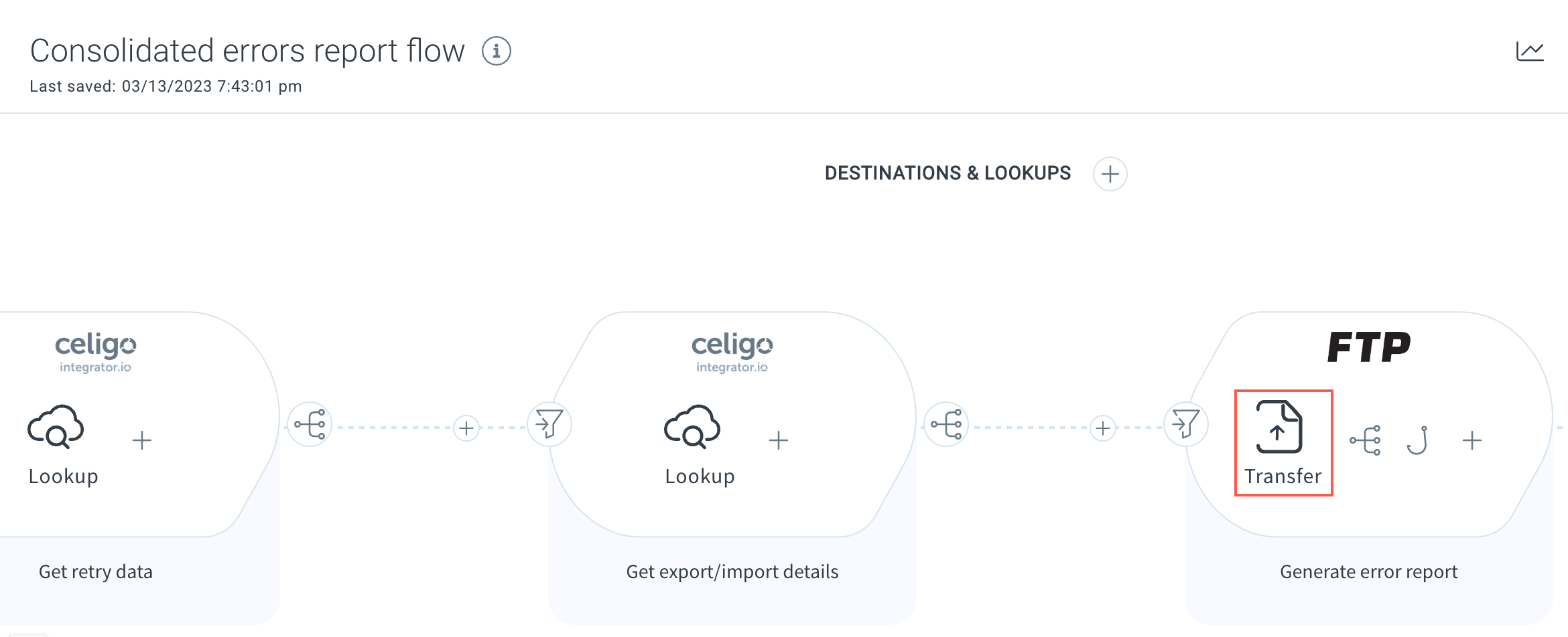

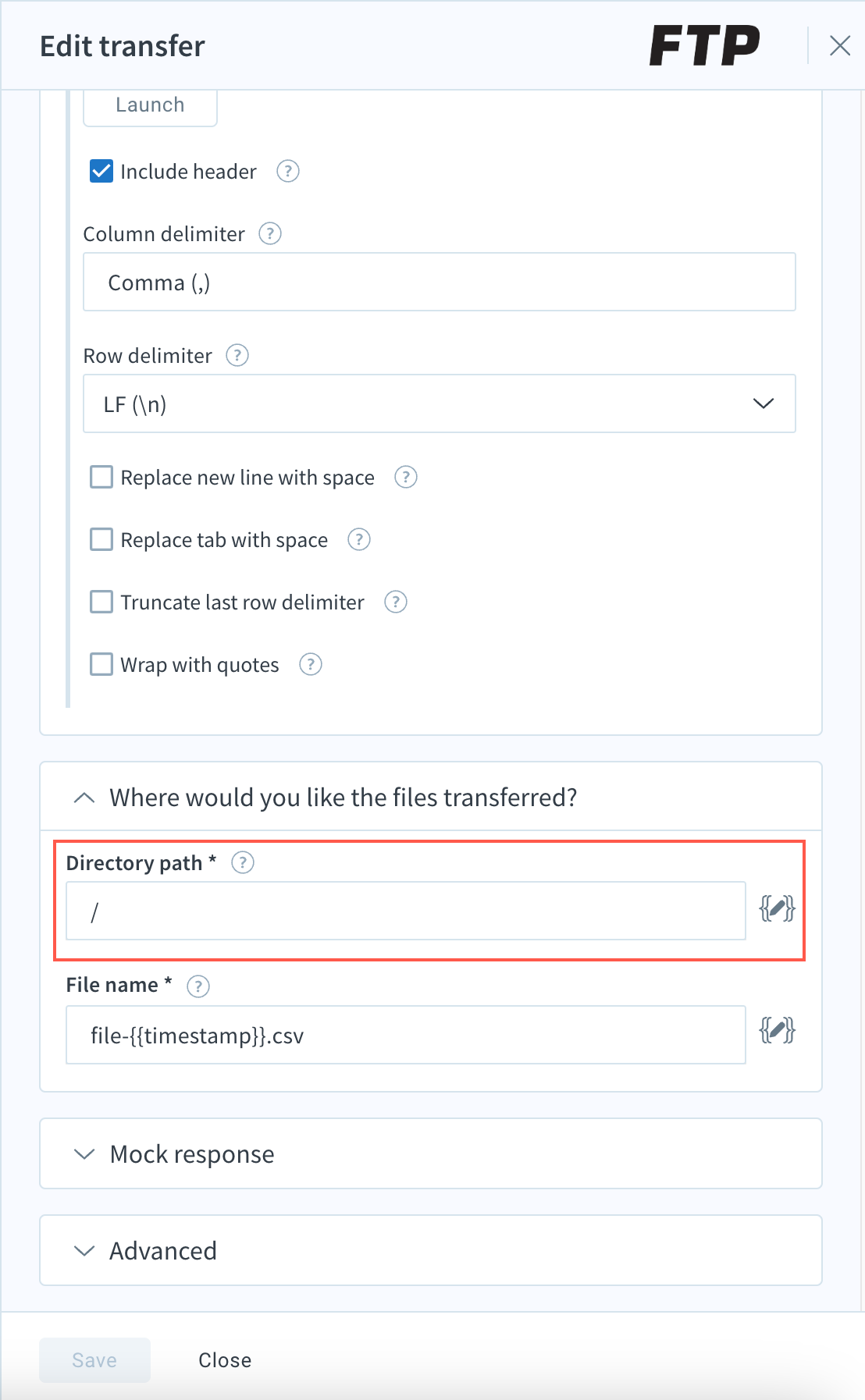

    3. In the Destinations & Lookups section, select and drag the mouse to the left till you view the Generate error report step.
    4. Click Transfer to access the Edit transfer pane and specify the FTP location where the report needs to be saved.
    5. Enter the FTP path in the Directory path setting.
    6. Click Save to update the FTP location where the consolidated errors report needs to be saved.

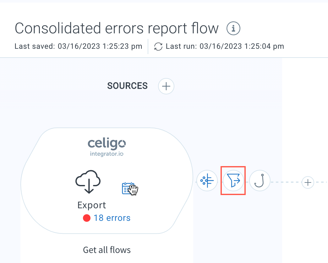

  1. Access the Flows tab and click the flow name to view the various steps involved in the flow.
  2. In the Get all flows step, click the Define options button (Define options).
    The Output filter button (Output filter button) will appear after the Get all flows step.

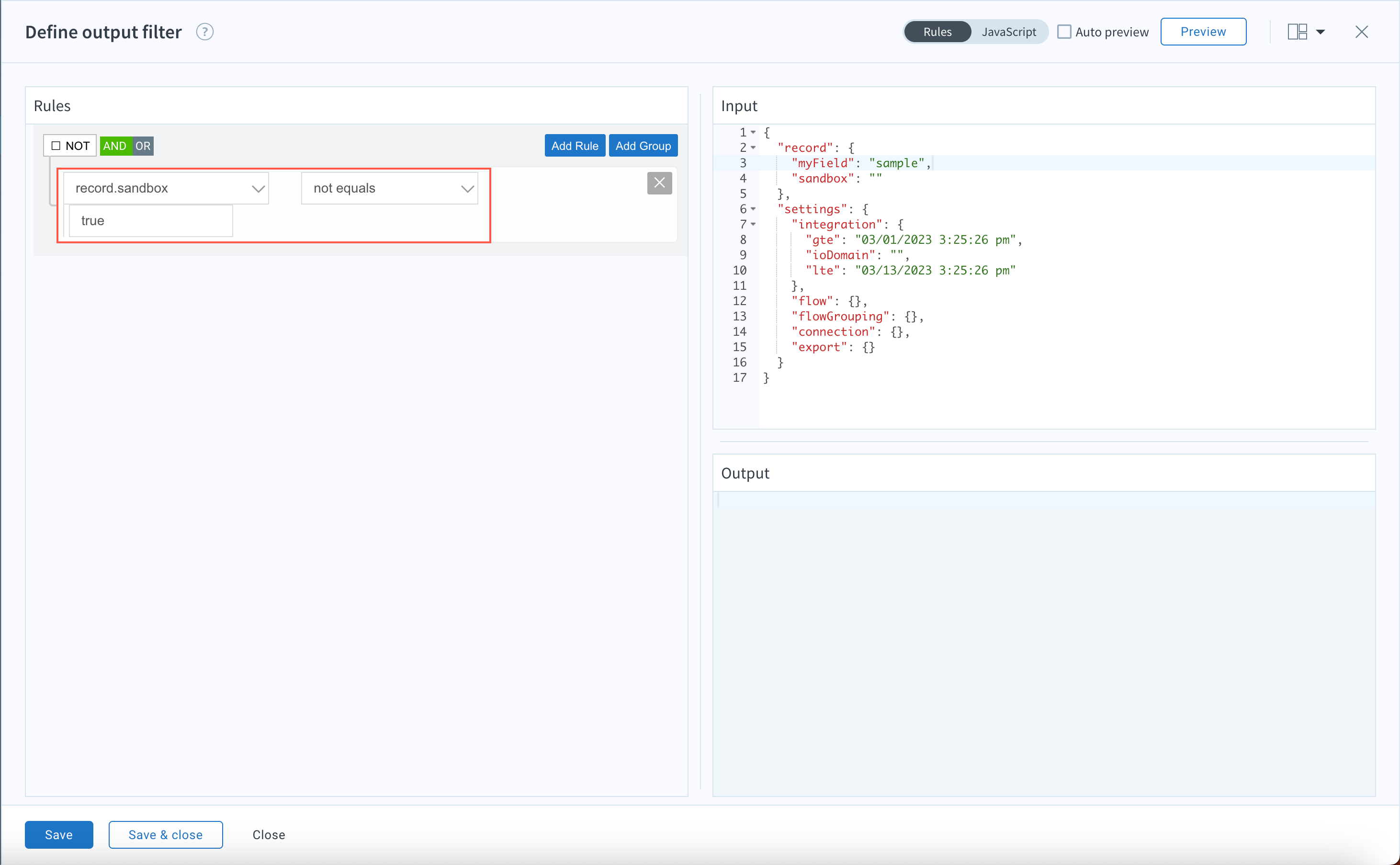

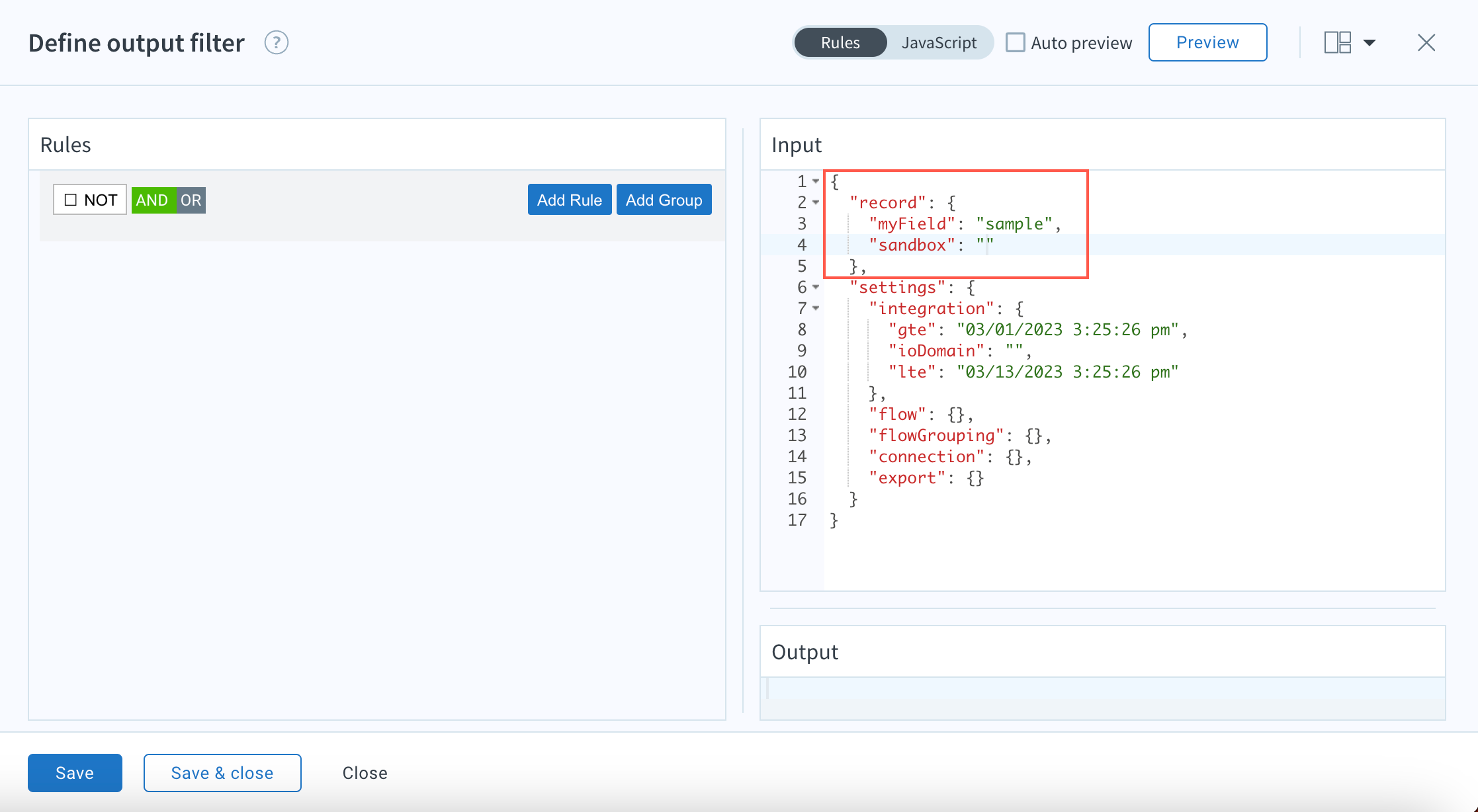

  3. Click the Output filter button to access the Define output filter pane.
    The parameter “sandbox”: “” (line 4 in the image above) needs to be added in the “record” array to be able to add the record.sandbox option in the Rules section.
To add the output filter to ignore the sandbox records,
  1. In the Rules section of the Define output filter pane, select the record.sandbox option from the options available in the drop-down list.
    1. Click the Settings button to the right of this field.
    2. Select the Operand type as Field and Data type as String in the Operand Settings dialog box.
    3. Click Save to confirm the changes.
  2. Select the not equals option in the drop-down list that appears after the record type is selected.
  3. Enter the value as true in the text box that appears after the record type is selected.
    2. Select the Operand type as Value and Data type as String in the Operand Settings dialog box.
The output filter will be displayed as shown in the following image:

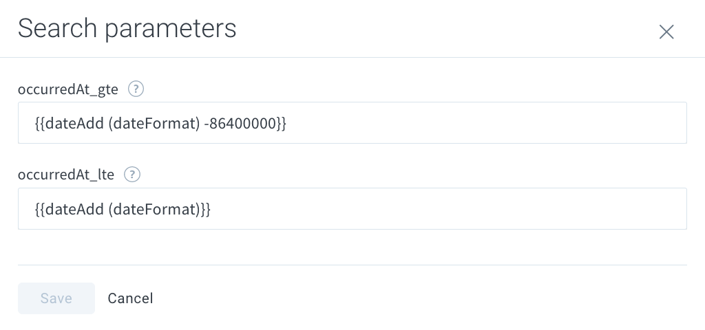

Before you can schedule the flow to run automatically, you need to modify the search parameters in the Get errors step of the Consolidated errors report flow using the actions described below:
  2. In the Get errors step, click Lookup to access the Edit lookup pane.
  3. Click Launch in the What would you like to export? section to edit the Search parameters.
  4. Replace {{dateAdd settings.integration.gte}} with {{dateAdd (dateFormat) -86400000}} in the occurredAt_gte setting.
  5. Replace {{dateAdd settings.integration.lte}} with {{dateAdd (dateFormat)}} in the occuredAt_lte setting.
  6. Click Save to update the search parameters.
  7. Click Save & close to update the changes made in the lookup.
    You can now schedule the flow to be run once every 24 hours and any errors found in this time duration will be added to the error report and saved in the selected FTP location.

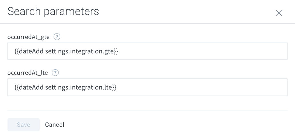

If you have scheduled the flow to run automatically and want to revert to running the flow manually, you can do so by updating the search parameters in the Get errors step of the Consolidated errors report flow.
  4. Replace {{dateAdd (dateFormat) -86400000}} with {{dateAdd settings.integration.gte}} in the occurredAt_gte setting.
  5. Replace {{dateAdd (dateFormat)}} with {{dateAdd settings.integration.lte}} in the occuredAt_lte setting.
    You can now run the flow manually. When the flow is run, the error report will be generated and saved in the selected FTP location.
