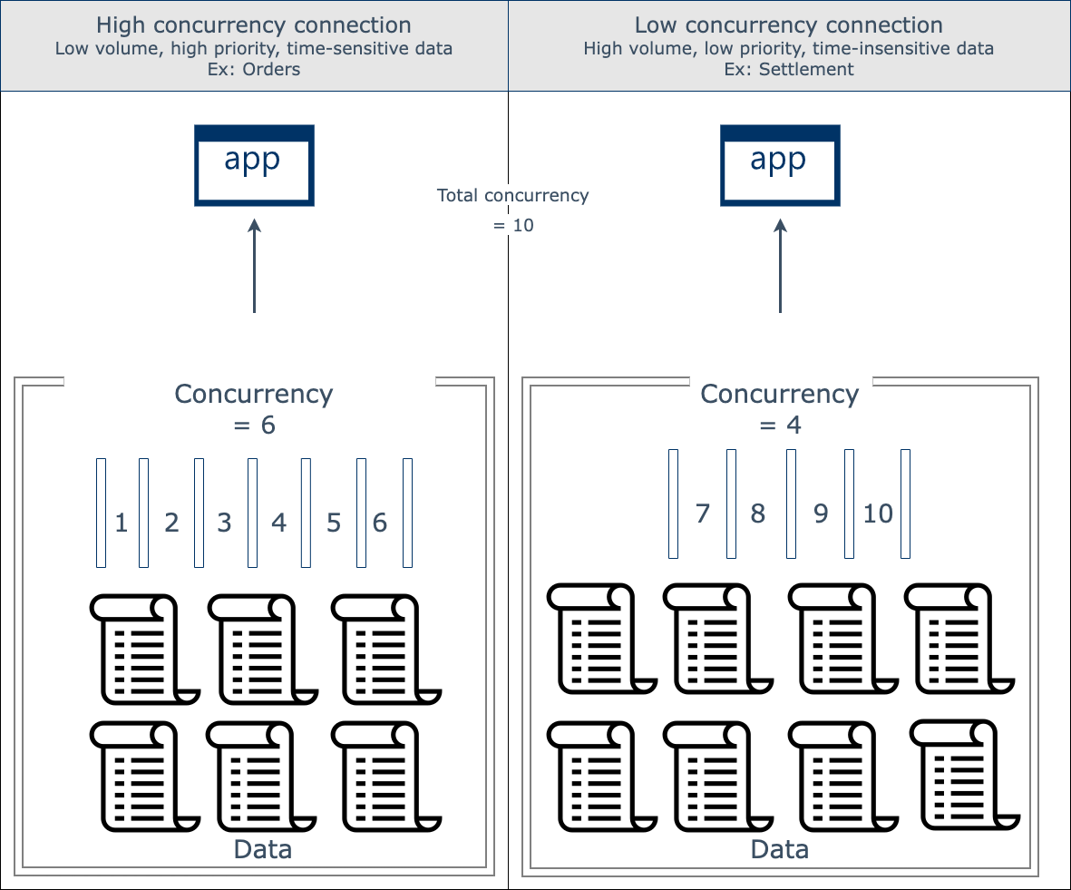

Secondary connection | Scenario 1
As demonstrated below, you can see that the secondary connection is dealing with flows that generate high volume, low priority, and not time-critical data, such as Settlement. The primary connection is dealing with flows that generate low-volume, high-priority, and time-critical data, such as Order.
Figure 1: Secondary connection dealing with flows that generate high-volume, low-priority, not time-critical data.
This arrangement enables your high priority data, such as Order, to get synced faster without getting stuck in the queue.

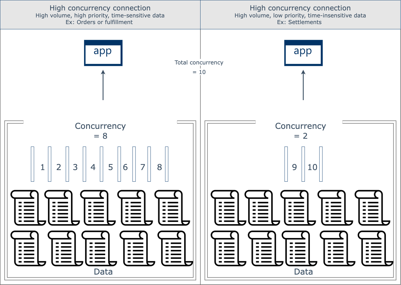

Secondary connection | Scenario 2
In the following image, you can see that the secondary connection is dealing with flows that generate high volume, lower priority, and not time-critical data, such as Settlement. The primary connection is set up for flows that generate high-volume, high-priority, time-critical data, such as Order and Fulfilment.
Figure 2: Secondary connection dealing with flows that generate high volume, low priority, and not time-critical data.
This arrangement enables you to have a greater number of concurrency levels available for your high priority data that is time critical and should get synced faster.
