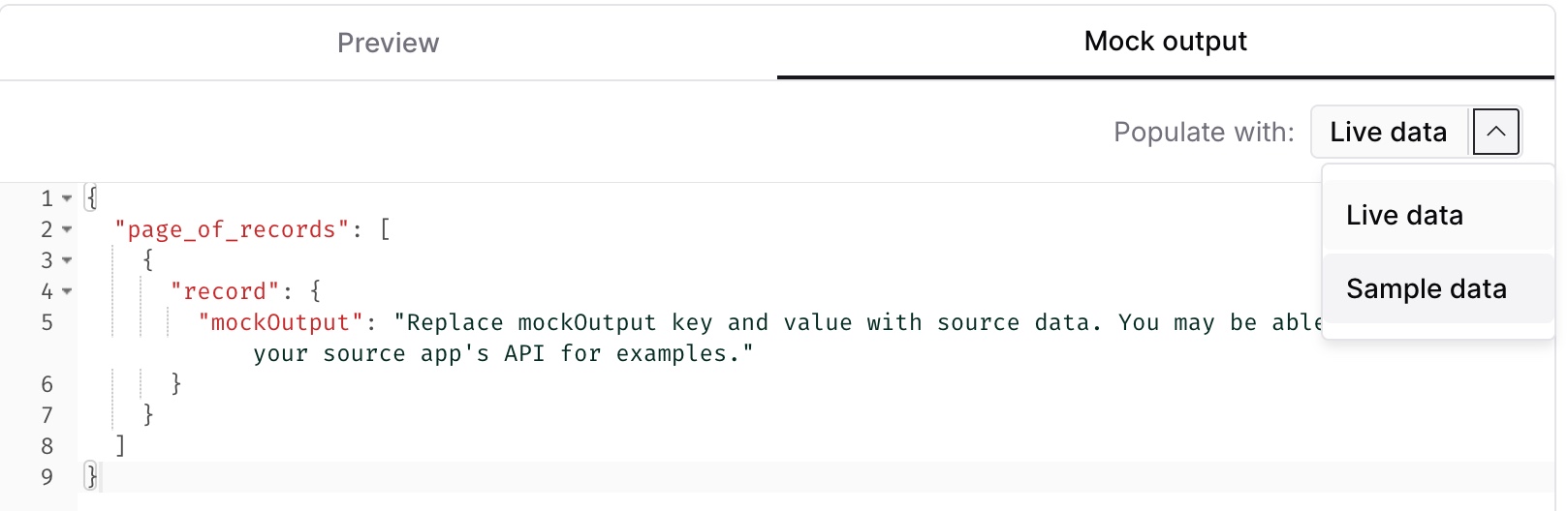

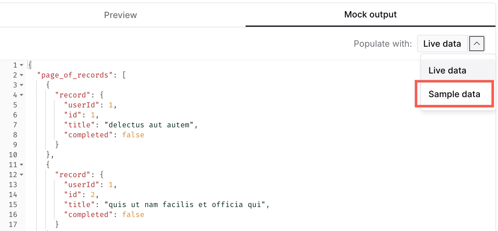

Provide mock data for a test run
Test mode flow runs allow you to test your flow with live data, as mock data, or manually enter mock data for testing purposes. Before you can perform accurate test runs, you must first provide mock output data for the source flow step(s) and any lookup flow step you want to test. You must also provide mock response data for each destination import flow step.
  • Live mock response data: For imports, you can send the mock output record from the source application to the destination application API to generate a response, and use the returned response data to configure response mappings. Use caution if you use live data to test import flow steps because the live call can unintentionally create or update records in the destination application.
  • Manually enter mock data: You can manually enter mock data to use as source output data or destination import response data. The mock data you enter in the Mock output or Mock response AFE is used for the test run, and no call to the application is made to retrieve testing data from the connected app.
For exports and lookups, if you do not provide any mock output data in the Mock output setting and execute a test run, the flow will make a call to the source application to retrieve live data and will prioritize the test run call in the connection queue.
For imports, if you do not provide mock response data in the Mock response setting. integrator.io inserts the following sample data in the Mock response setting to complete the test run.
You can use mock data that you provided to test flow behavior in future test runs.
  • If an integration folder (or a single flow within an integration folder) is cloned, any mock data you provided for the cloned flow(s) is included in duplicate flow(s).
  • Mock data provided by you while creating a template is available post-publishing, and you can see it after template installation as well.

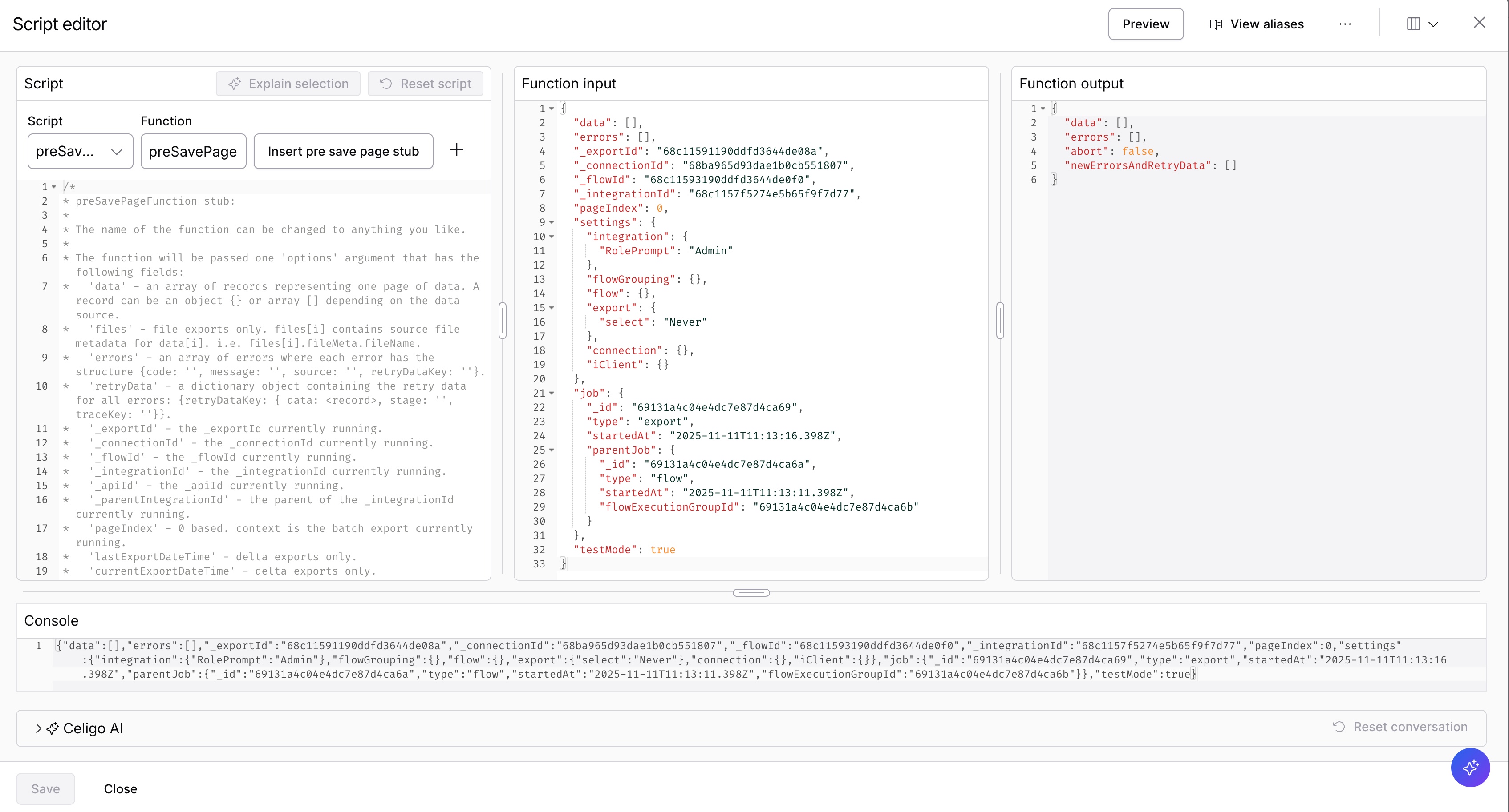

TestMode boolean flag as an input parameter for hooks used to customize script behavior during test runs, previews, or when making send calls. An export preview will not include the results of a testMode flag in the hook, but any subsequent destination step will include the results triggered by the testMode flag.
testMode - True
testMode - False
The TestMode flag is only supported in preSavePage, preSend, preMap, postMap, postSubmit, postAggregate, postResponseMap in export and import hooks.

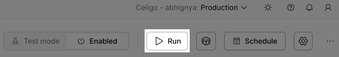

Switch to test mode

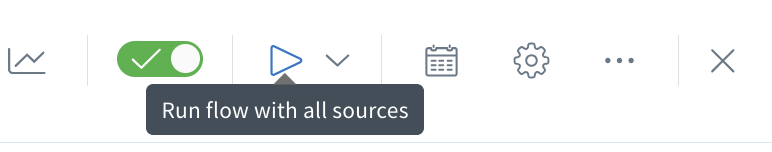

In Flow builder , when a flow is not enabled, it automatically switches to test mode. The Run button becomes Run test. When you enable the flow, the button returns to Run.
Test mode
Production mode
If you want to switch a flow to test mode, disable the flow.

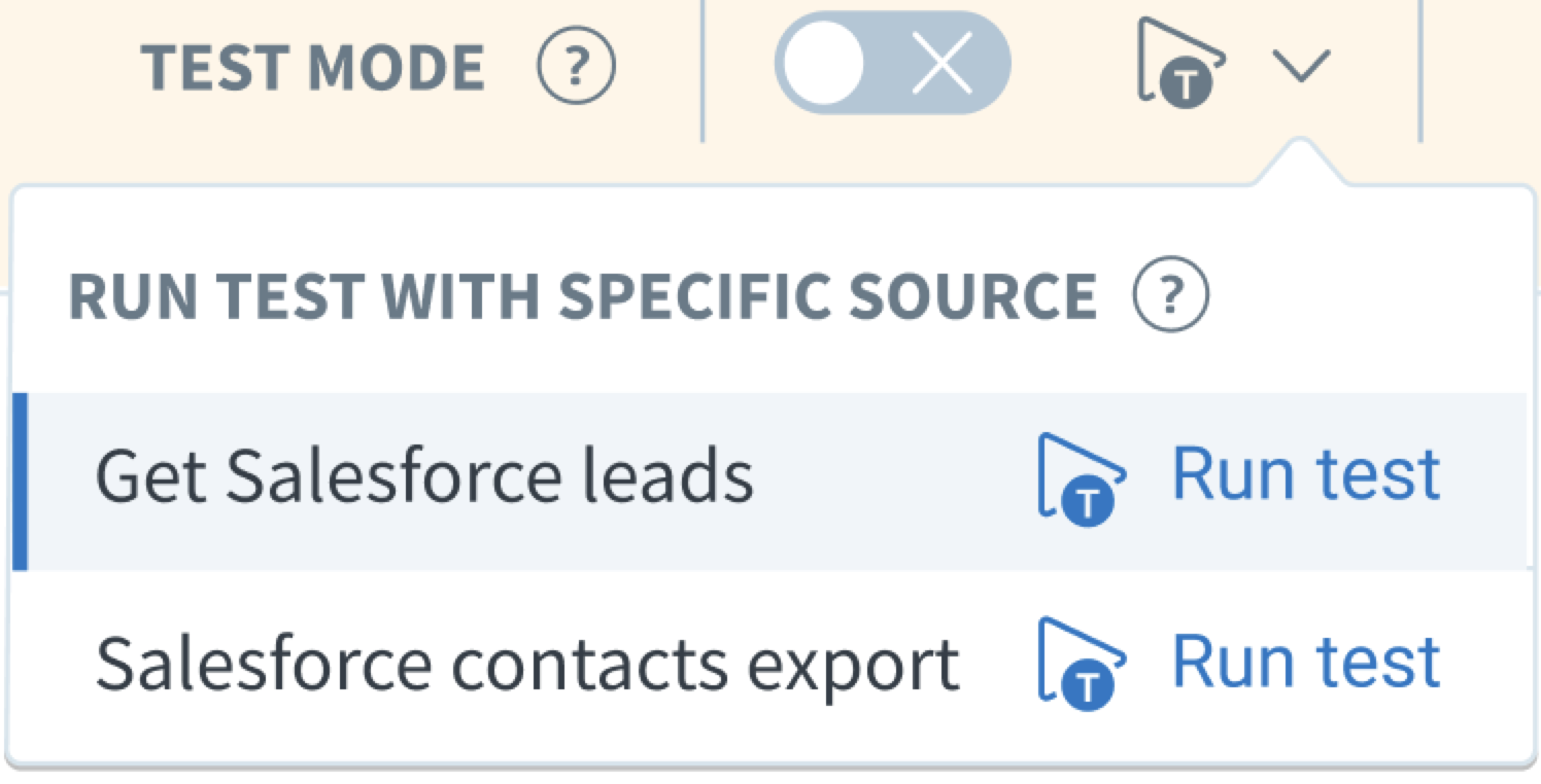

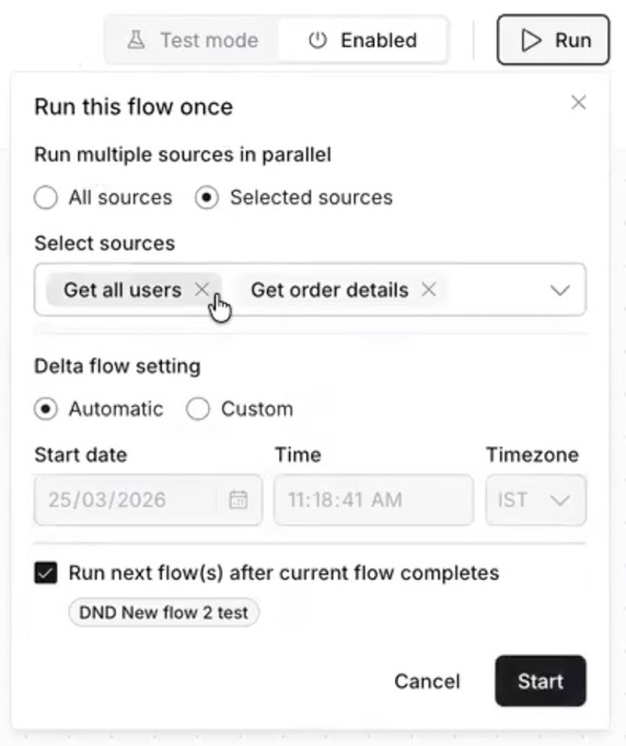

Set the source to be used in the test run
You can select only one source flow step that will provide the mock data for the test run from the list of available sources from the Run test drop down button. By default, the first source is selected.
  • Test flow run – The selected source is stored for the session and used for the flow test run

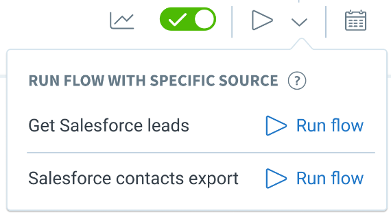

  • Enabled flow run – The selected source is never stored. If you want to execute a flow for a single source, then you have to select it manually
  • Scheduled flow run – If the flow is not triggered by selecting a source from the list, but instead runs on a schedule, is triggered by a webhook listener, or is set to run after another flow is complete, the entire flow (including all sources) is executed
  • Listener export – It cannot be manually triggered in production mode. In test run mode, you can use mock output data as a source to run a test flow
Production mode

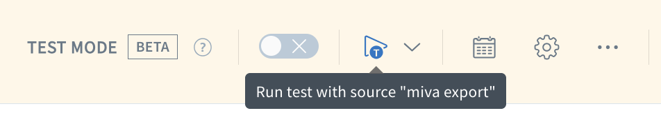

  1. Disable your flow to enter Test mode (any new flow is disabled and in test mode by default).
  2. Select a single source for your test run. If you have multiple sources, you can change the source that is used. To use an offline source for a test run, you must enter mock output data from either source:
    • Provide your own output data from the API documentation.
    • Populate with > Live data pulled from the source.
  3. Provide mock response data for all destinations.
    • Provide your own mock response data from the API documentation. You must provide a statusCode in your mock response data. If your mock response data contains an error, the test results will demonstrate flow behavior when such errors occur during enabled production flows.
    • Populate with > Live data: This option is available only when your connection is online and for connectors that have a preview panel. Clicking this button makes a live call to the import application and creates a record in the destination app. The response returned by the call to the destination app will replace any existing mock response data. Test mode flow runs use only mock data, so no live calls will be made to the destination app when you run the flow in test mode.

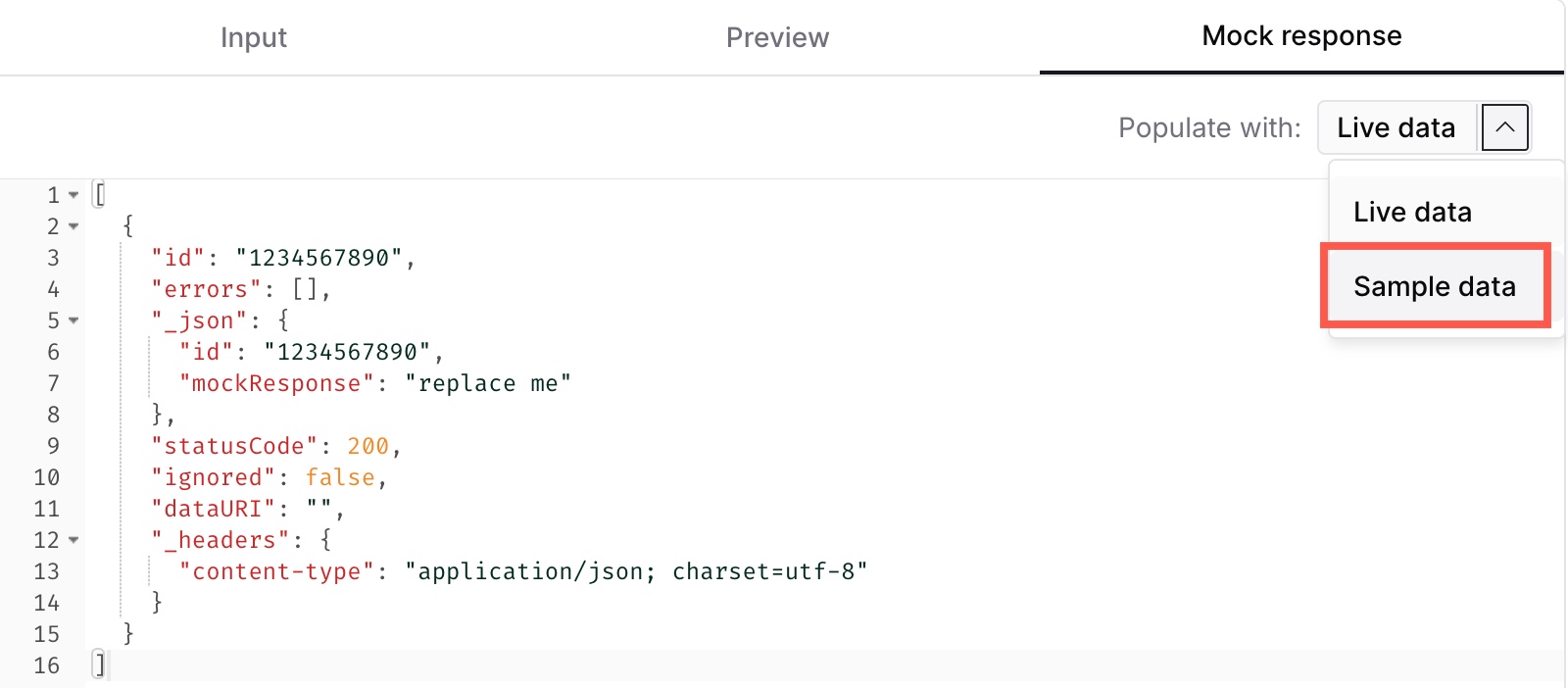

    • If you leave the mock response setting empty, integrator.io populates the step with dummy data during a test run, and it may not provide accurate test results. That auto-populated data remains in the setting. You can add your own data instead of “replace me”.
    • Populate with > Sample data: Populates mock output and mock response fields with the data object in the required integrator.io sample JSON format. Simply replace the placeholder text with source data.
Run a test flow

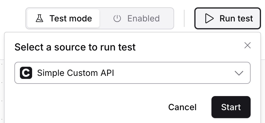

To run a flow:

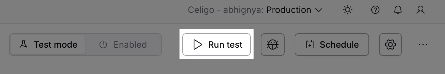

  1. Click Run test button at the top right of the Flow builder. The Select a source to run test window is displayed.
  2. Select a source flow step from the Select a source to run test drop down list and click Start.

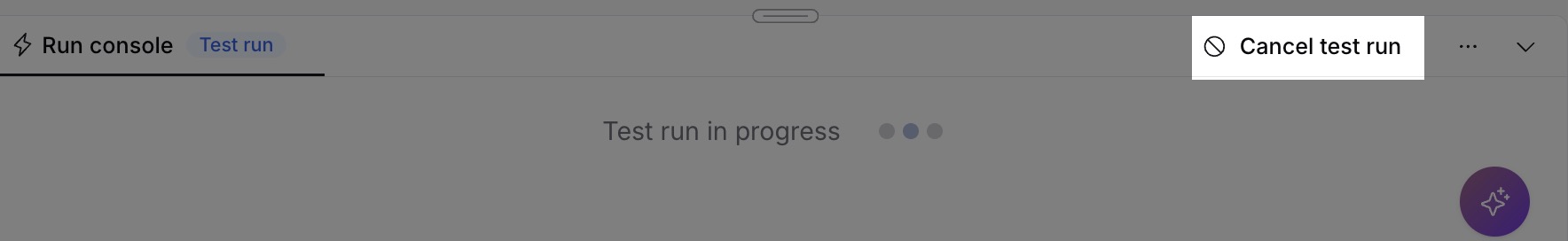

Cancel a test run

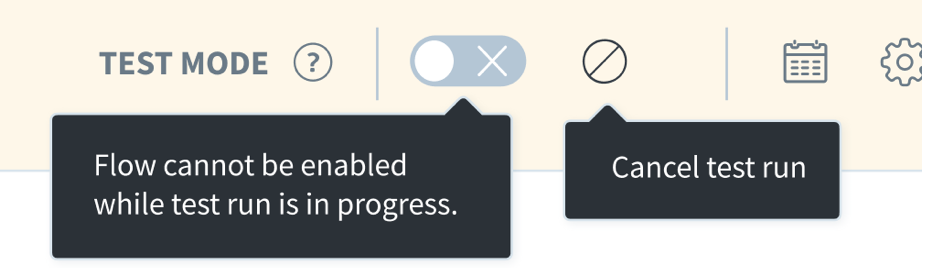

During the test run, in the Run console tab click Cancel job icon in the Actions column or Cancel test run to abort the test run. The Test mode enabled switch is disabled until the test run is completed or is canceled.

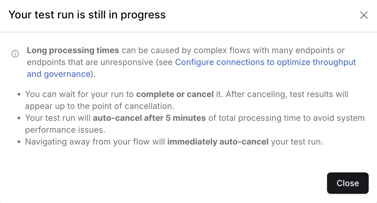

If a test flow run takes more than a hundred seconds to process, the system displays the following message due to long processing time. You can either cancel the flow run or wait for it to complete.
To avoid system performance issues, the test run will be auto-canceled after five minutes of running a test flow in the following scenarios:
  • The endpoint does not respond within two minutes of running a test flow

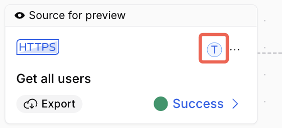

Review test run results and errors

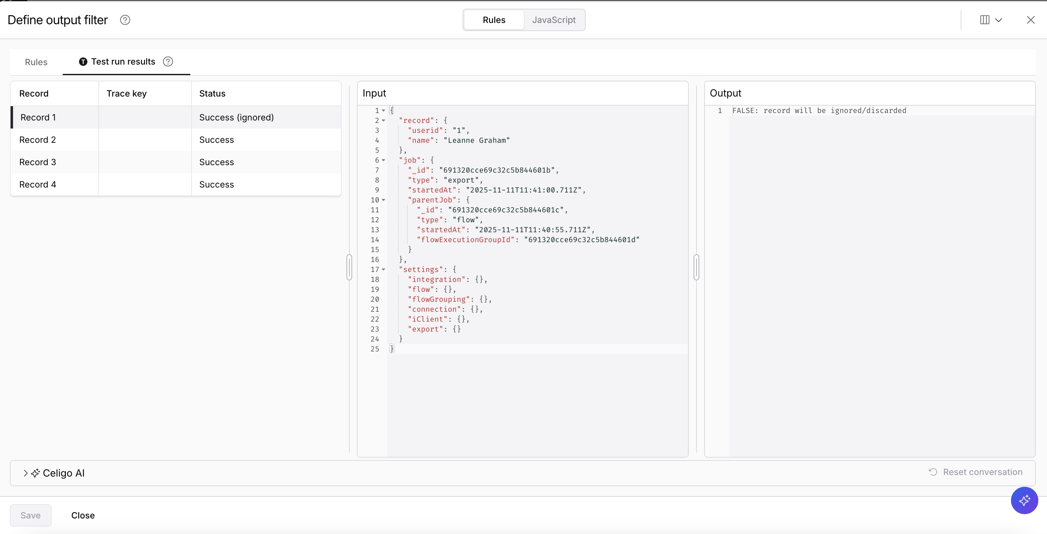

After the test run is complete, you can view the test run results for each flow step option and review errors in the Run console. Each flow step also displays the error status of your test run.
Review test run results for each flow step option
The test result indicator (Test_results_indicator.svg​​) displays next to each flow step option (transformation, filter, mapping, or hook) after the test run is complete.
Click Test_results_indicator.svg​​ to see the test results associated with that flow step.

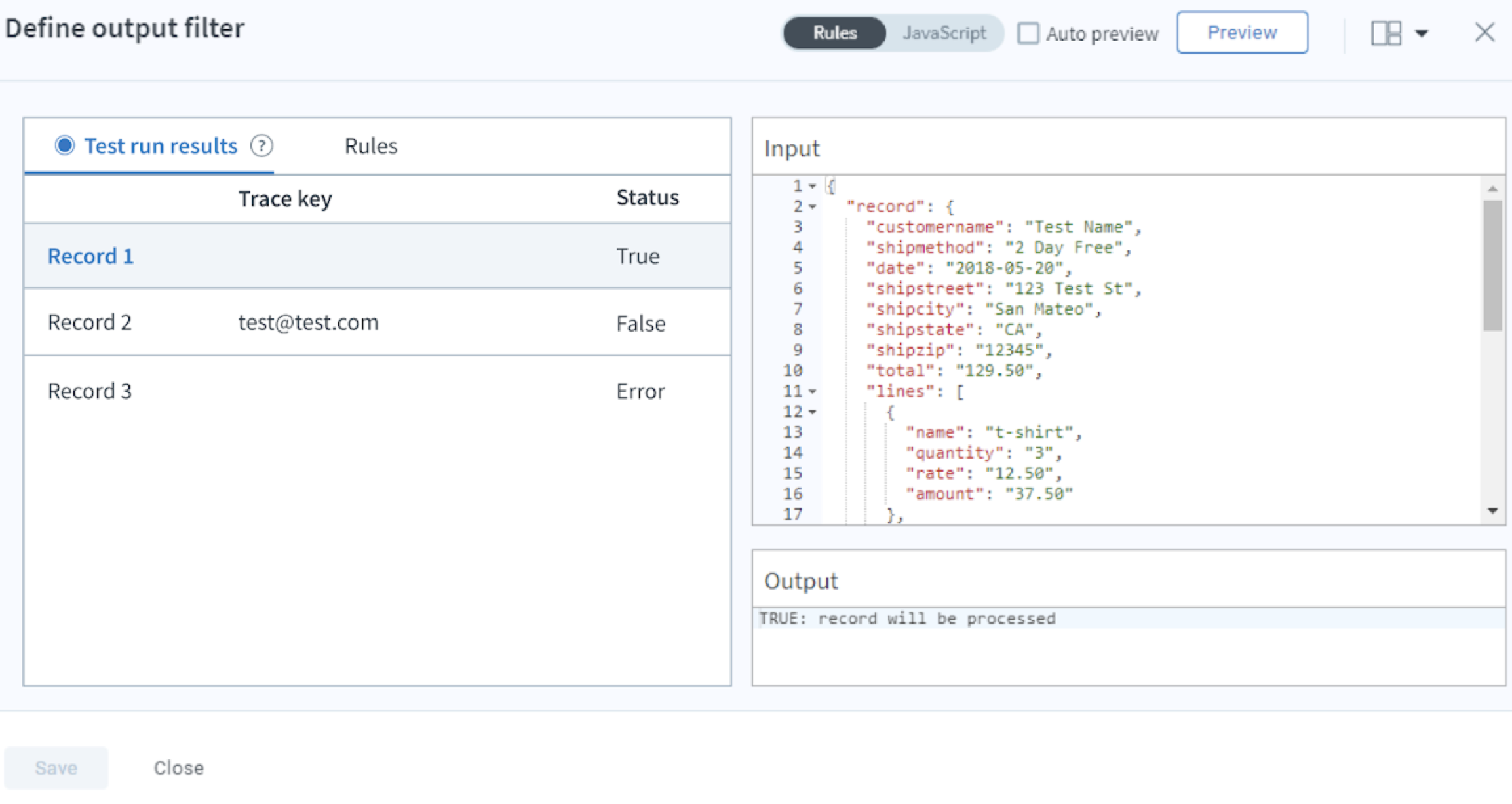

The image below displays the filter indicator on the flow step. The window name changes based on each step of the test run details.
The Test run results section lists all records along with the trace key and status that were processed based on the selected processor. For example, Record 1, Record 2, and Record 3 as shown in the image. The record status can be success or error. In case of filter evaluation for successful records, the record status is shown as Success or Success (ignored).
  • Success – Record successfully processed and passed the filter criteria
  • Success (ignored) – Record successfully processed and did not pass the filter criteria
Click a record under Test run results to see the related input to the processor in the Input pane and the processor output for the selected record in the Output pane. Only one record can be viewed at a time. Use the toggle in the top right corner to change the editor view between Rules or JavaScript while making edits.

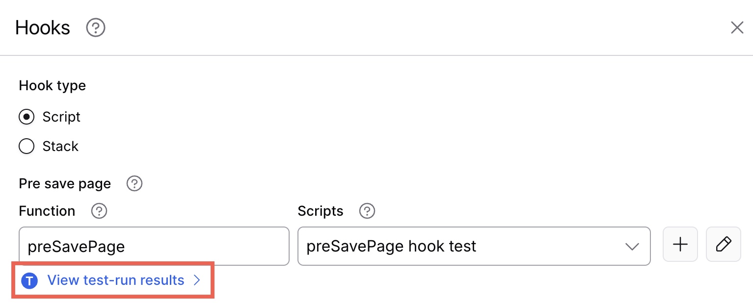

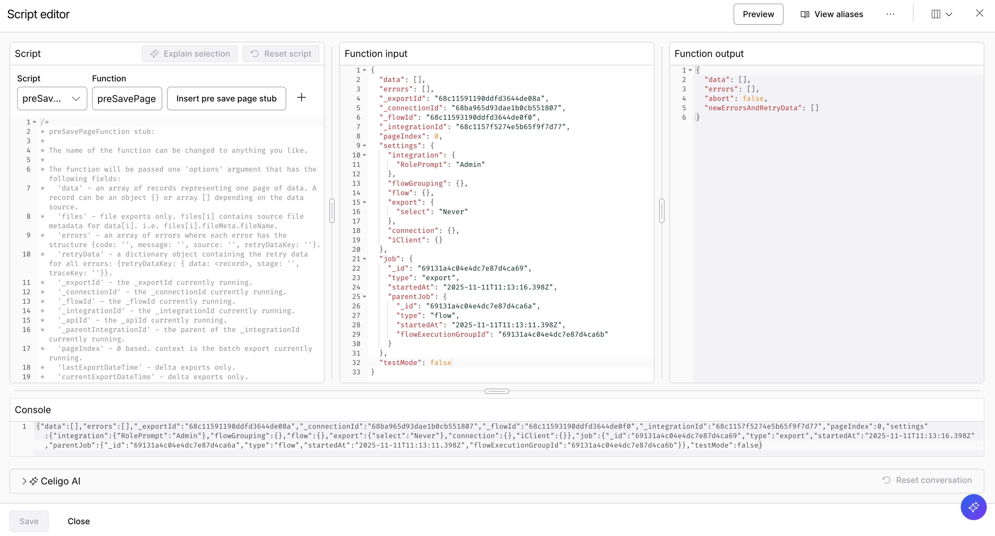

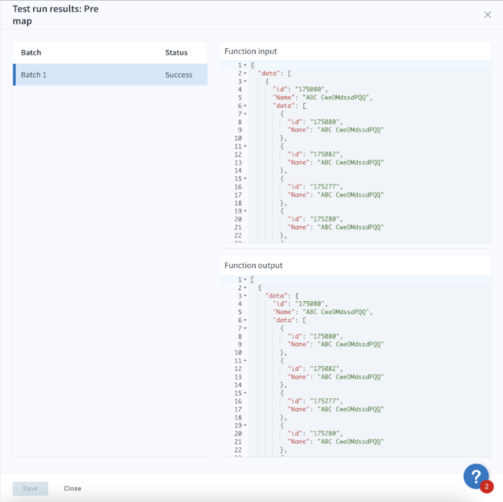

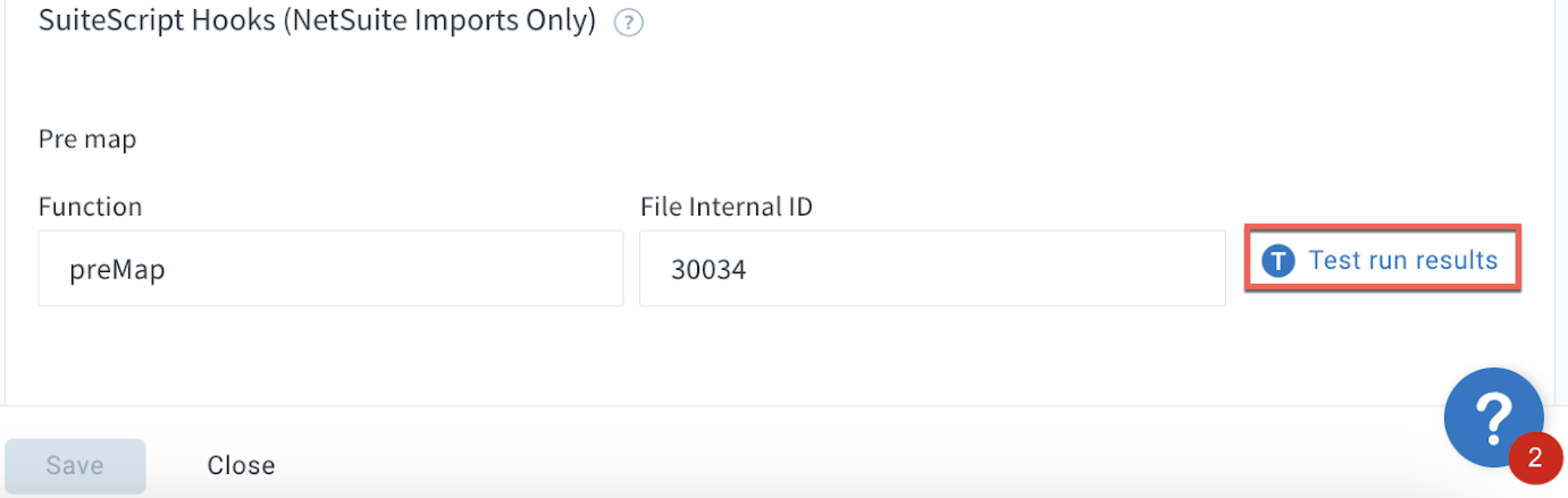

To see detailed test run results for NetSuite SuiteScript hooks, click Test run results
Only when mock output is not added, the SuiteScript preSend hook is executed, and input and output in the test run results are available.
  • If the batch size is less than 10, then the number of records shown in the mock output is equal to the batch size set.
  • If the page size is less than the batch size, then the number of records shown in the mock output is equal to the page size.

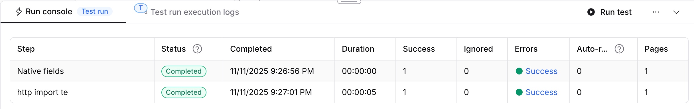

Review test run errors on flow steps and in the Run console
You can expect any of the following results post-test flow completion in Run console :
  • Success
  • Ignore
  • Error
  • Resolve
Errors and successes are indicated on the flow steps as shown in the production flow runs.
In test mode, the test result is updated only for the selected source. The test run results are not available for other sources.

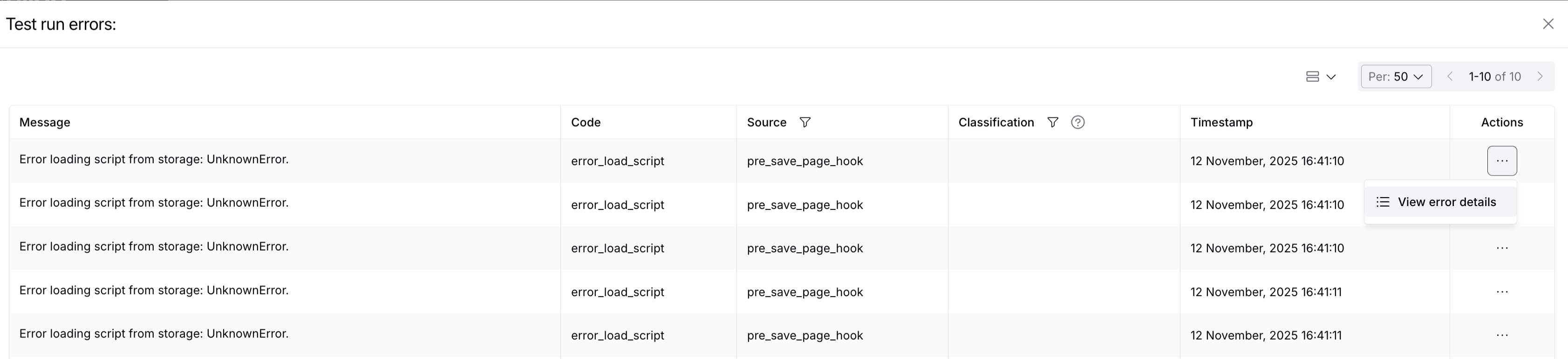

Perform the following steps to see the record error details:
  1. Click an error to open the Error details page and review the list of errors.
  2. By default, the first record is selected, and the error details can be seen under Error details on the right.
  3. Click a record to see the error details.
  4. If you switch from a unified view to a list view by using the toggle view, then to see the error details for the selected source, click View error details under the Actions overflow (...) menu.
The View error details option is available under the Actions menu in test mode.

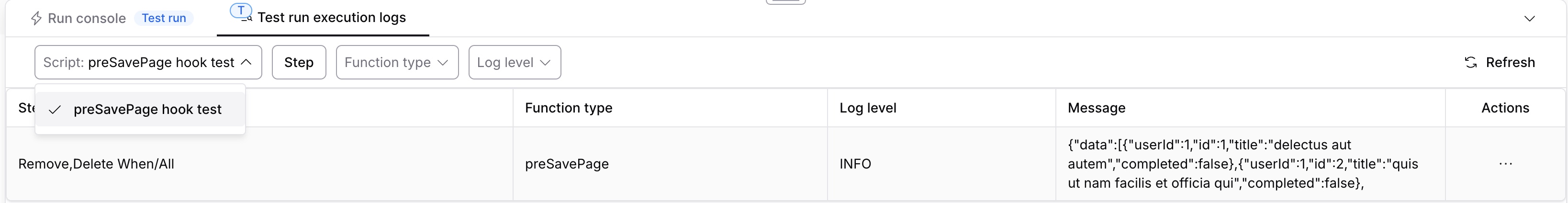

Review flow step and script debug logs
You can review the test run debug logs in HTTP for exports, imports, lookups, listeners, and for the scripts within the flow, without starting the debug process. The debug logs from the enabled runs are also available under the debug logs tab.
Perform the following to view the script execution logs for scripts that are added to a flow:
  1. On the Flow builder page, click Test run execution logs tab in the Run console panel.
  2. Select the script from the Scripts drop down list to view its log details.
  3. The script log details are displayed.
In test mode, the debug logs are available only for a single session.
Postresponsemap hook script execution logs are not captured in the test run.

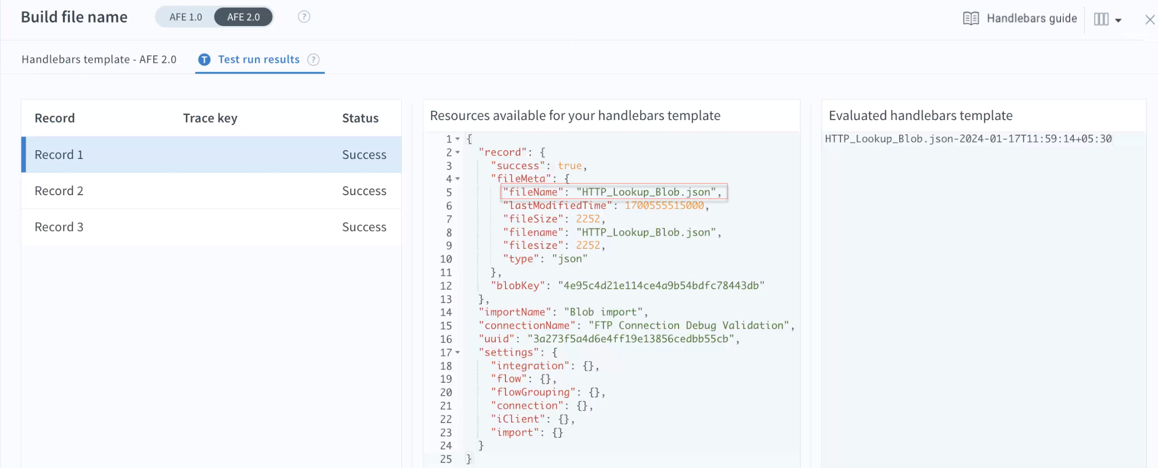

Blob support
Blobs are supported in test run mode with the updated sample data.
For example, view the detailed test run result for handlebar expressions configured using file meta.
When running a flow in test mode for FTP blob export or lookup, having more than 200 files on the FTP server leads to a test run delay or run timeout. The test run results may not be visible.
