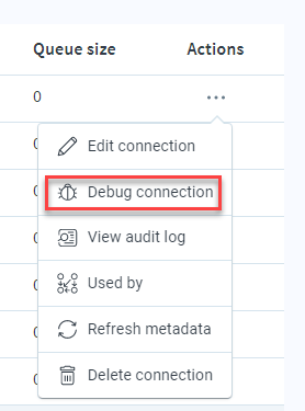

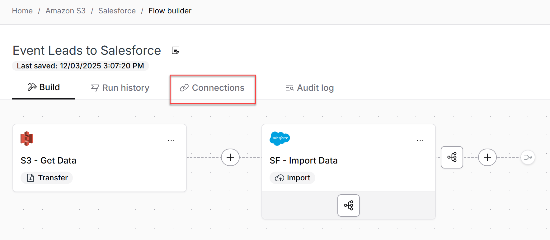

  1. Open a flow and click the Connections tab.

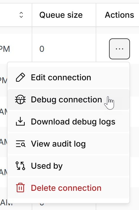

  2. Click the Actions overflow (...) menu for the connection and select Debug connection.

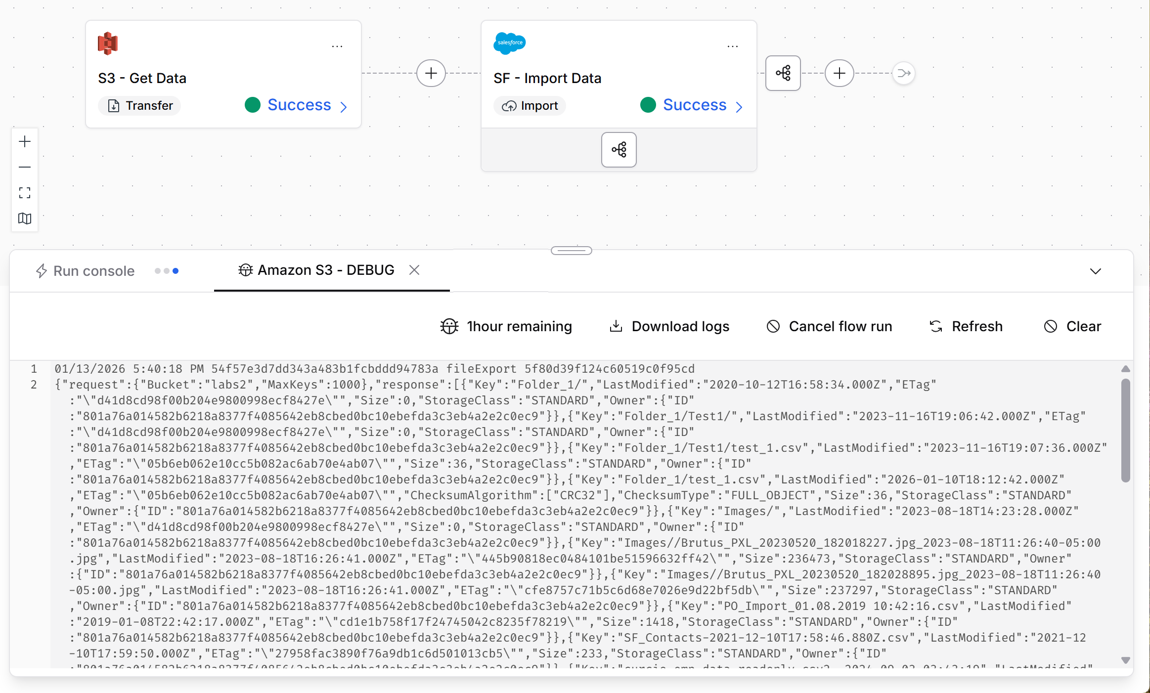

  3. Run the flow to see the debug logs. Any requests made through that connection during this timeframe are recorded in the debug logs console. You can view the logs directly from the console or click Download logs to view the logs in a text file.
Each debug log has the following format:
Date uniqueIdForRequest resourceType resourceId
request/response
  • Date - Date in ISO format
  • uniqueIdForRequest - A universally unique identifier (UUID) that for the request/reponse pair. You can check the response for a particular request using the UUID.
  • resourceType - The type of resource using the connection (import, export, etc.)
  • resourceId - The unique identifier for the resource using the connection
  • request/response - The request sent from integrator.io (with sensitive fields masked) and the response returned from the end point.
2020-05-16T08:06:54.786Z 230910249c5a44208ad1dcb732662812 export 5ebf8aabd25b2e67296014b9
{"url":"http://demo4866900.mockable.io/testingInvDetail","method":"GET","headers":{"accept":"application/json"}}
2020-05-16T08:06:55.076Z 230910249c5a44208ad1dcb732662812 export
Debug logs will not be displayed until the flow is actively in progress and processing data. If a flow is queued to run (or the flow has been initiated but hasn’t yet started), the logs will be empty until data begins to be processed and exchanged between endpoints. Debug logs remain in the connection debugger console for 24 hours, or until you click Clear from the console.

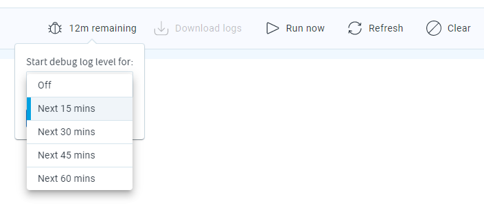

The connection debugger stays on for fifteen minutes by default, but you can turn it off or extend that length of time with the drop-down menu available from the console.
