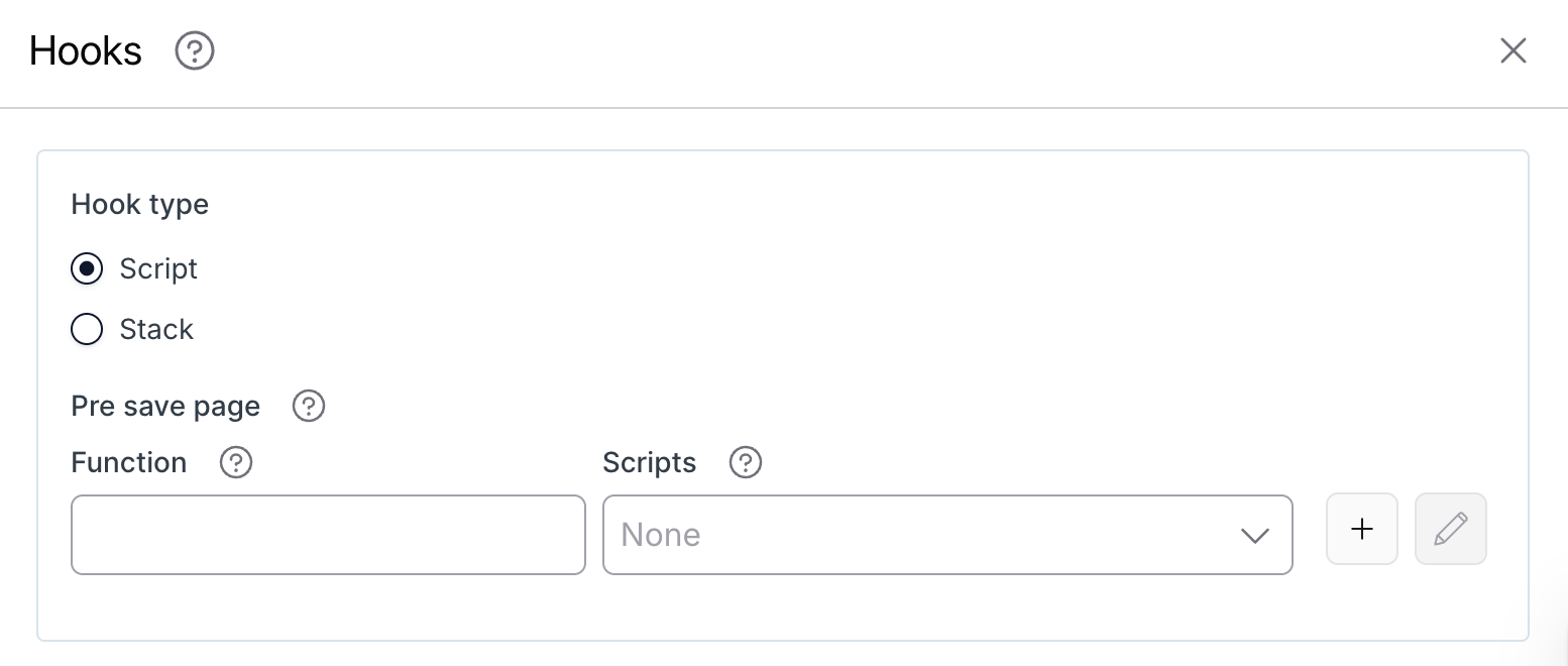

Hooks (​​hook.svg​​) are your place to write custom code that can run at different stages during the execution of your flow to modify the functionality of the flow. Hooks are typically invoked individually for each page of data. A page is a set of records processed in smaller batches to improve performance. You can configure the number of records per page via the Page size property in the Advanced section of your export or listener.

Any hook that calls an export, lookup, or import must be in an integration tile rather than a standalone flow. You cannot call a resource inside a hook if your hook is in a standalone flow. To call a resource inside a hook, create a new integration tile and then add your flow to the tile.
Hook scripts run under a 4-second processing limit per invocation and a 120-second cumulative API call limit per flow run. These limits apply regardless of subscription tier and can't be adjusted. Configurable API timeouts apply to API Builder only and don't affect hook or transformation scripts. If you need a longer execution time, consider using a stack (a server-side Node.js hook) instead of a script.

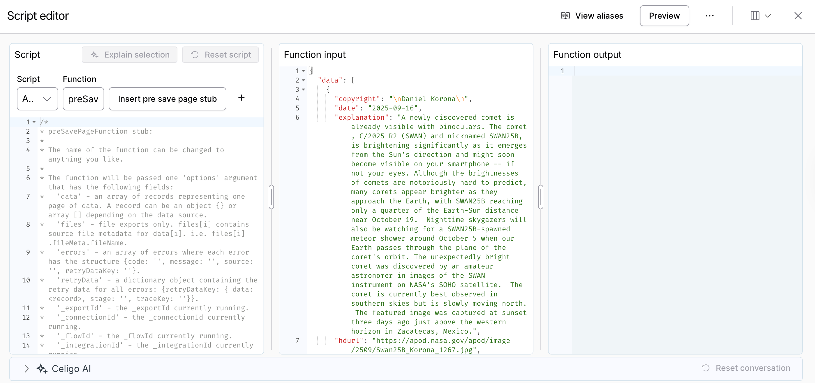

preSavePage
The preSavePage hook is invoked on a page of records before the page is sent to subsequent steps in your flow. This hook can be used to add, update or delete records. This hook is a great place to execute logic on batches of records at the same time. For example:
  • Filter or group records in batches
  • Apply calculations in batches
  • Perform complex data transformations in batches
  • Validate data and return errors for records
Function stub
* preSavePageFunction stub:
* The name of the function can be changed to anything you like.
* The function will be passed one 'options' argument that has the following fields:
*   'data' - an array of records representing one page of data. A record can be an object {} or array [] depending on the data source.
*   'files' - file exports only. files[i] contains source file metadata for data[i]. i.e. files[i].fileMeta.fileName.
*   'errors' - an array of errors where each error has the structure {code: '', message: '', source: '', retryDataKey: ''}.
*   'retryData' - a dictionary object containing the retry data for all errors: {retryDataKey: { data: <record>, stage: '', traceKey: ''}}.
*   '_exportId' - the _exportId currently running.
*   '_connectionId' - the _connectionId currently running.
*   '_flowId' - the _flowId currently running.
*   '_integrationId' - the _integrationId currently running.
*   'pageIndex' - 0 based. context is the batch export currently running.
*   'lastExportDateTime' - delta exports only.
*   'currentExportDateTime' - delta exports only.
*   'settings' - all custom settings in scope for the export currently running.
*   'job' - the job currently running.
*   'testMode' - Boolean flag that executes script only on test mode and preview/send actions.
* The function needs to return an object that has the following fields:
*   'data' - your modified data.
*   'errors' - your modified errors.
*   'abort' - instruct the batch export currently running to stop generating new pages of data.
*   'newErrorsAndRetryData' - return brand new errors linked to retry data: [{retryData: <record>, errors: [<error>]}].
* Throwing an exception will signal a fatal error and stop the flow.
function preSavePage (options) {
  // sample code that simply passes on what has been exported
  return {
    data: options.data,
    errors: options.errors,
    abort: false,
    newErrorsAndRetryData: []
