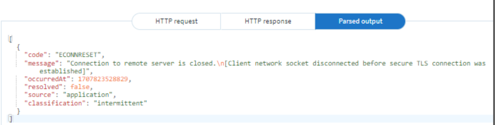

Issues if you use these ports
If you use any of the restricted ports in the base URI for your exports or imports in a flow, for example: https://*eno-wsdl.***************.nl:15001/*****lp130/***ndioApi?wsdl
then
  • You might have flows that are stuck.
  • You might not be able to establish a connection to the endpoint.
You could receive an error message as shown below in your export/import.
Resolution
If you notice that you're using any of the restricted ports, raise a Support ticket so that we can look into the matter and help you to resolve the issue.
