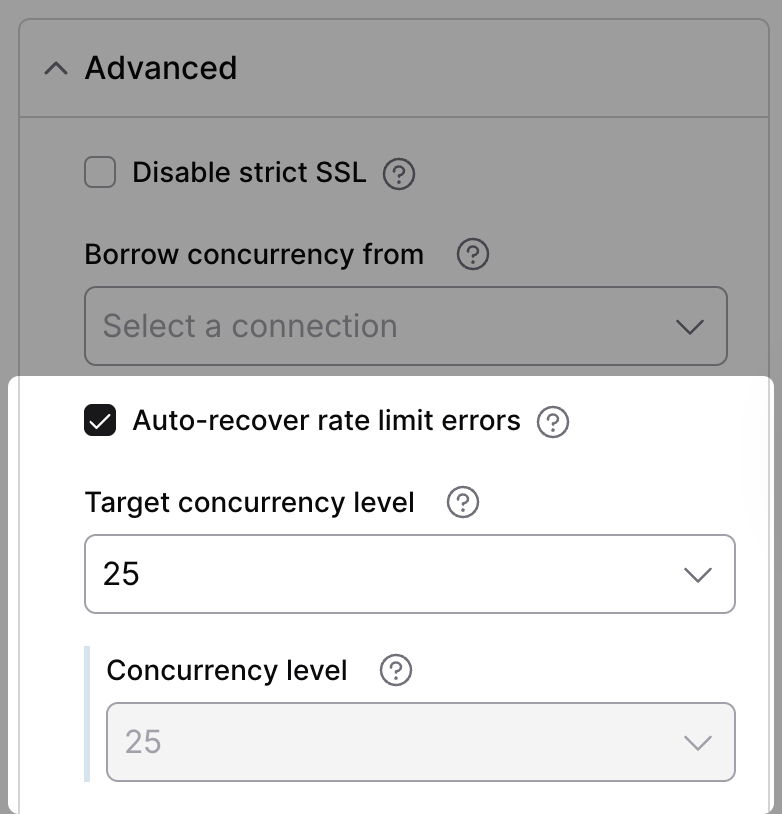

When the Auto-recover rate limit errors setting is enabled
In the Advanced section on any new connection resource, Auto-recover rate limit errors is enabled with a default Target concurrency level based on your endpoint for efficient processing. This setting applies to all flows that will use the connection.
Target concurrency level defines the maximum number of messages in the connection’s FIFO queue that can be processed in parallel. (Concurrency level is not editable and indicates what the Celigo platform is using.)
For example, if the Target concurrency level is set to 6 and a long-running export is running in one of your flows, then you will still have 5 messages that can be processed in parallel. Those additional 5 messages could also be long-running exports, or they could be very quick record imports. It does not matter.
For details on how concurrency is managed to automatically recover from rate limit errors, see Connection setting – Auto-recover rate limit errors.

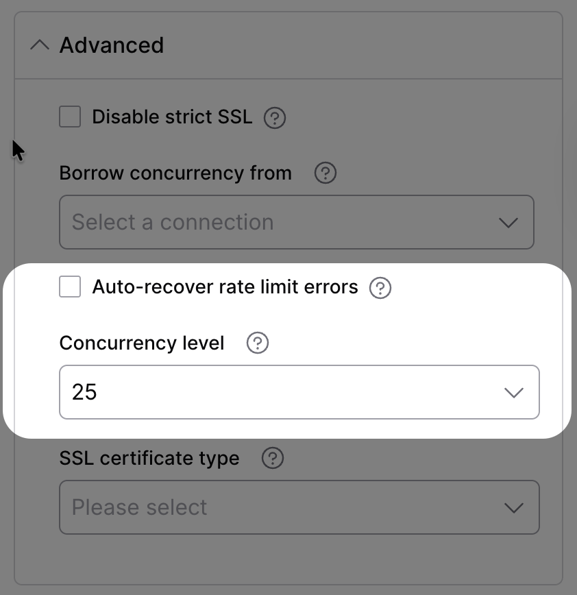

When the Auto-recover rate limit errors setting is not enabled
When Auto-recover rate limit errors is not enabled, the Target concurrency level is not shown.
In this case, the Concurrency level will define the maximum number of messages in the connection’s FIFO queue and the processing will be exactly the same as explained in the example above. This setting applies to all flows using the connection.
The maximum concurrency level allowed per connection varies by Celigo edition, but you can always create multiple connections for the same application to achieve higher concurrency levels when needed.
