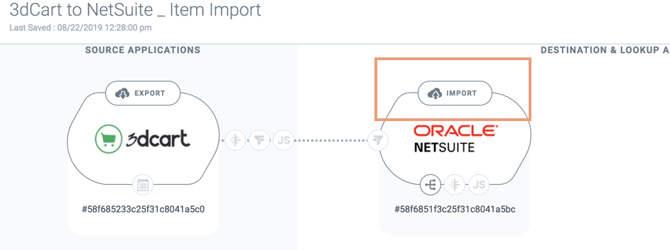

- From Home, click your integration tile.
- Open the import in the flow you want to adjust.

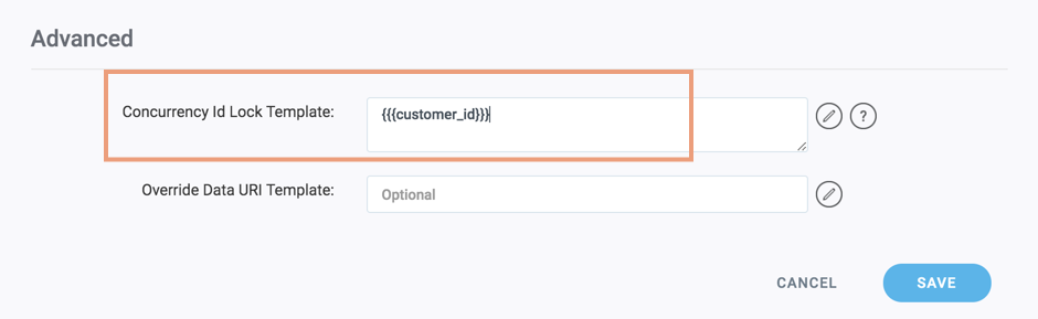

- In the Advanced settings section, find the Concurrency ID Lock Template field.
- Enter the field you want to use as the unique key (wrapped in three sets of curly brackets) to process records in the order that changes are received. For example:
{{{customer_id}}}
- Click Save.

- Open the configuration form for your import.
- At the bottom of the import configuration form, under Advanced settings find the Concurrency ID Lock Template field.
- In curly brackets, enter the field you want to use as the unique key to make sure records are processed in the order that changes are received.
- Click Save.

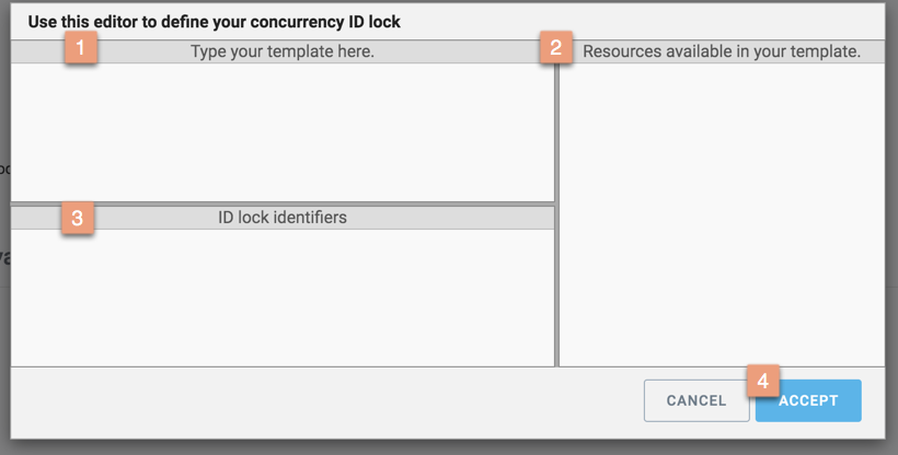

You can use the editor to write more complex logic to lock your records in subsequent order. Click the pencil icon to the right of the Concurrency ID Lock Template field to open the editor.
- Type your handlebars template here: Enter the handlebars expression you want to use as your template.
- Resources available in your template: This displays sample data to test your expression.
- Evaluated handlebars template: This displays the value captured by your handlebars expression that would be used when processing the sample record.
- Save: Click Save or Save & close to save your configuration.
