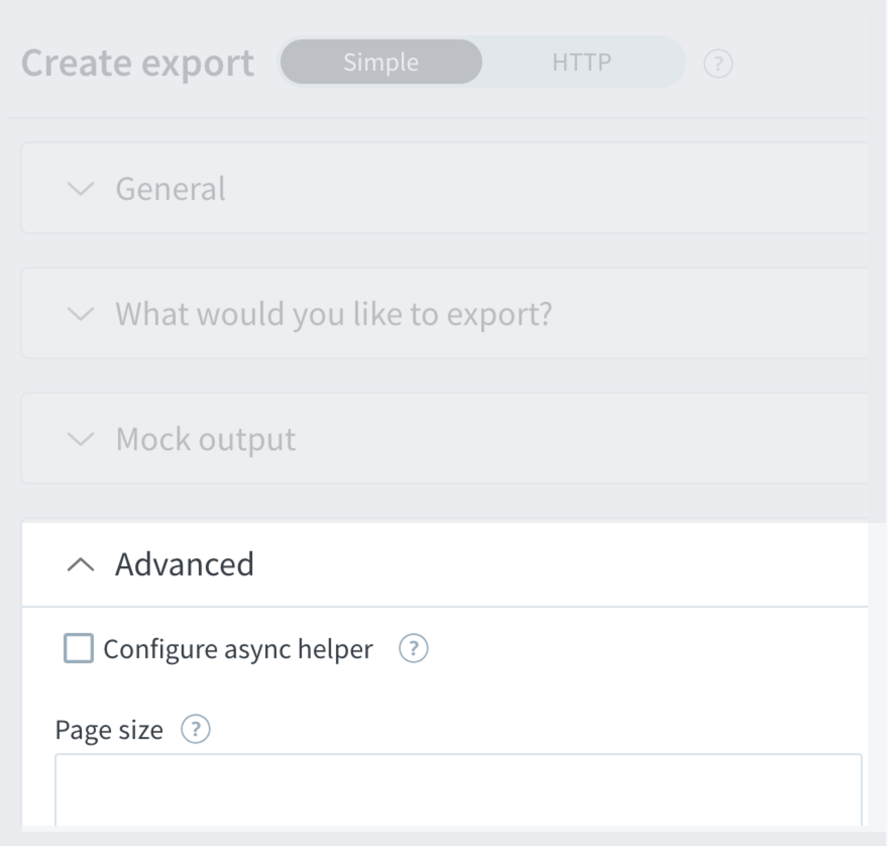

Set a higher page size on your export

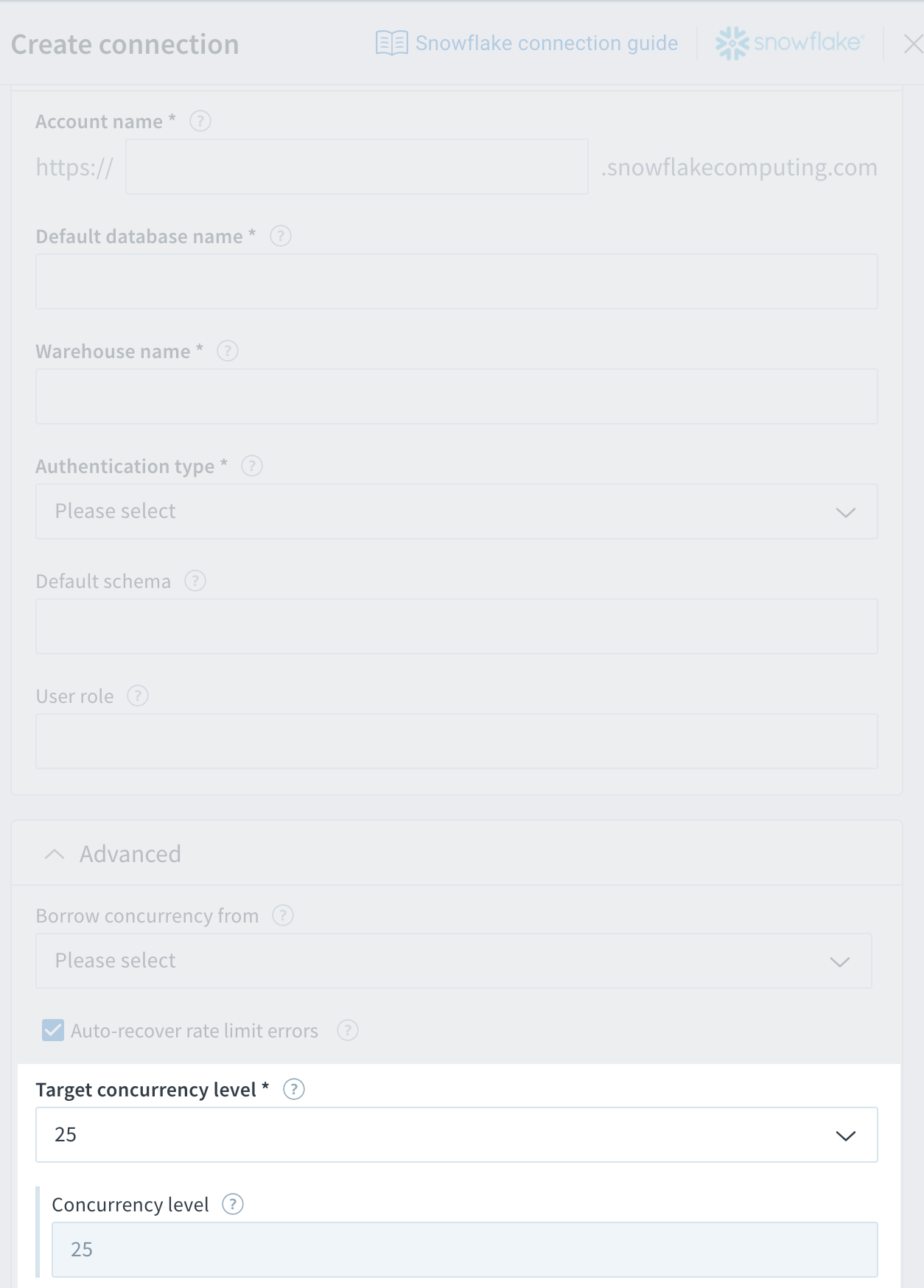

Increase the target concurrency level of your flow connections.
