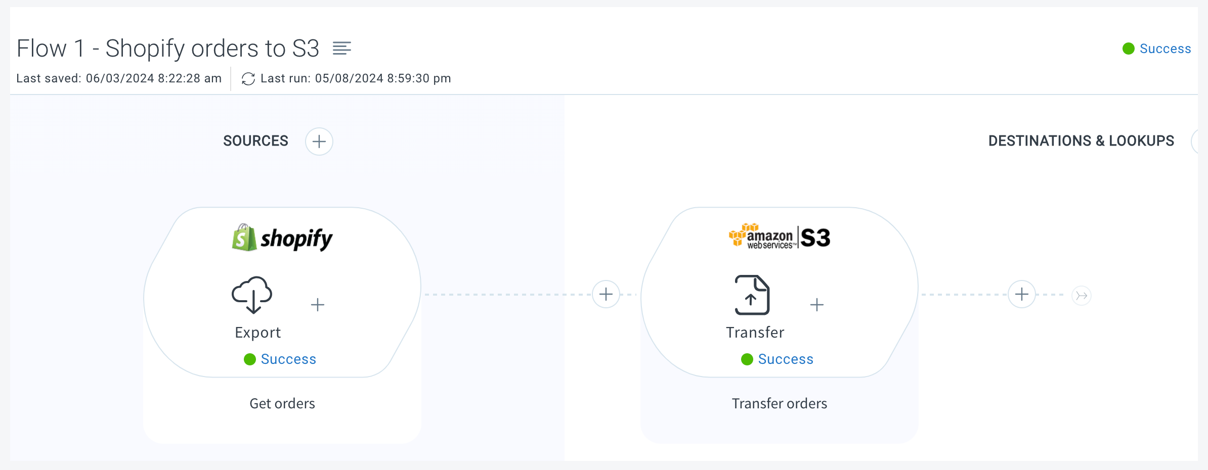

Flow 1

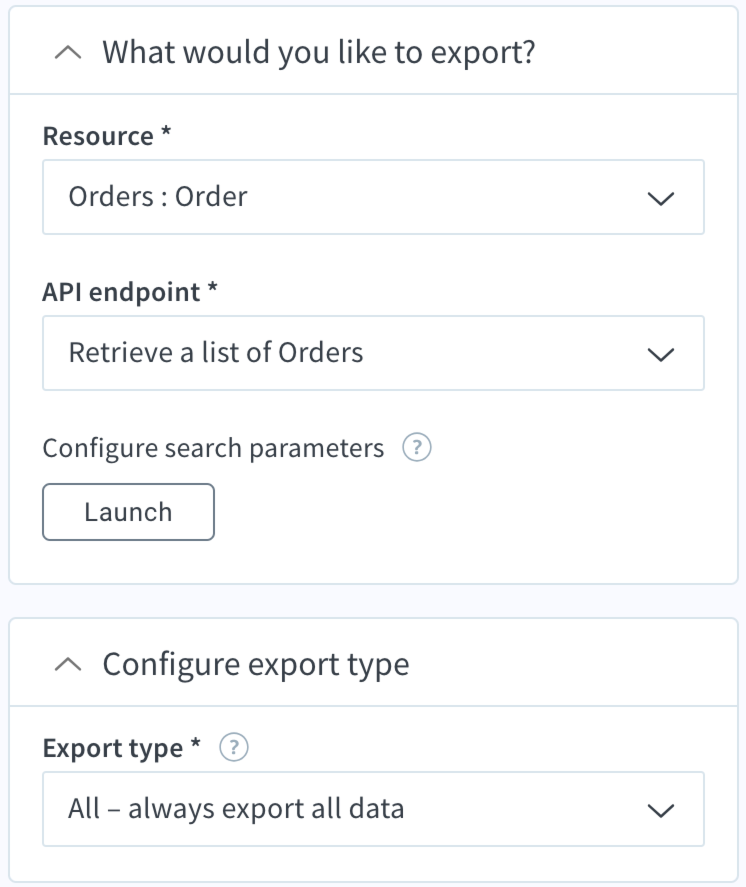

This flow (Shopify orders to S3) exports orders from Shopify using a REST API call and writes it to an S3 bucket.
  • The Get orders export step uses a REST API call to the /orders.json endpoint to retrieve a list of orders.

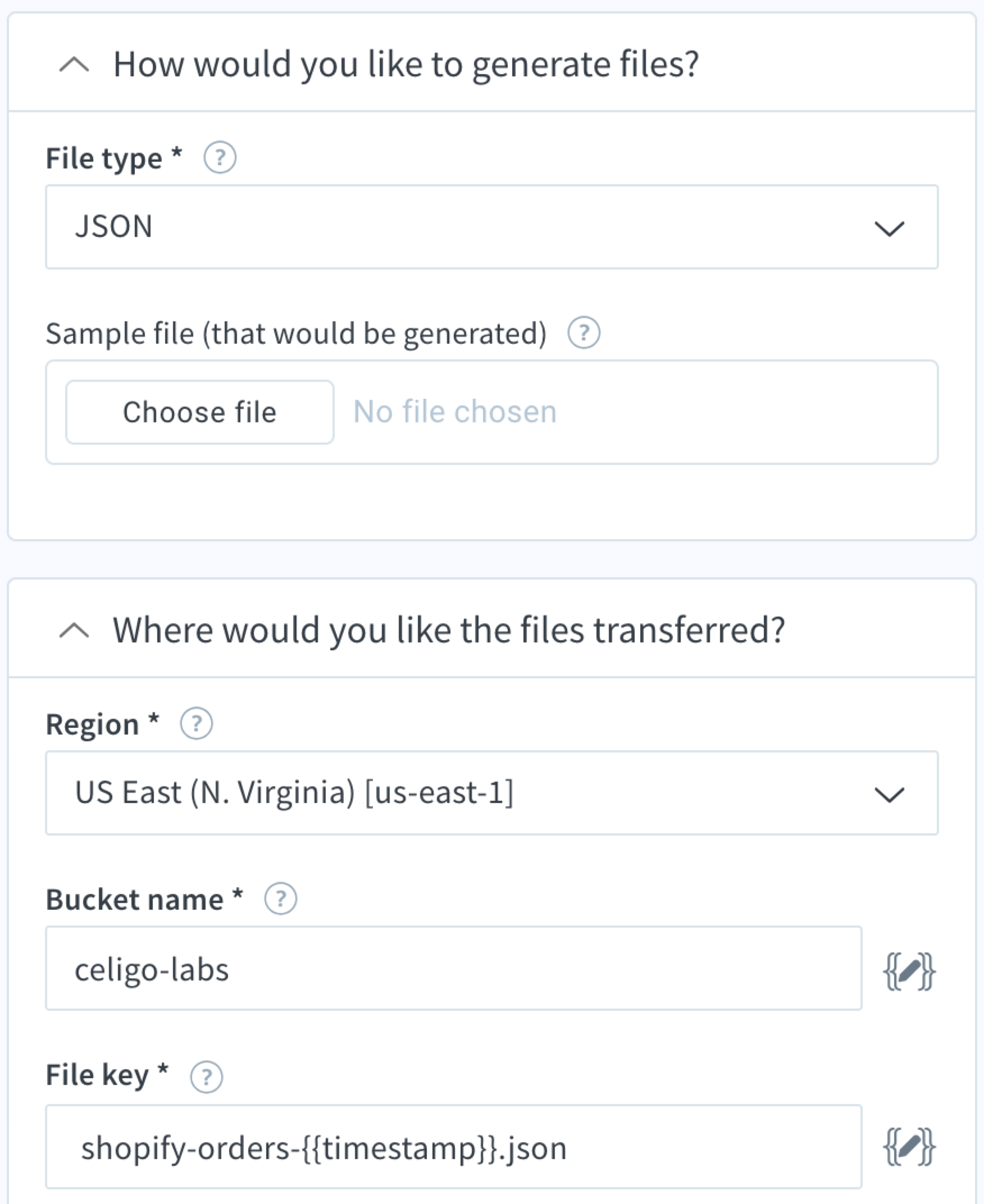

  • The Transfer orders import step writes the retrieved data into an S3 bucket named "celigo-labs''.
You should create a file format in Snowflake that can handle the file placed in your S3 bucket. In this example, the first flow placed JSON data into the S3 bucket and all records were wrapped in an array.
create or replace file format myjsonformat
type = 'json'
strip_outer_array = true;

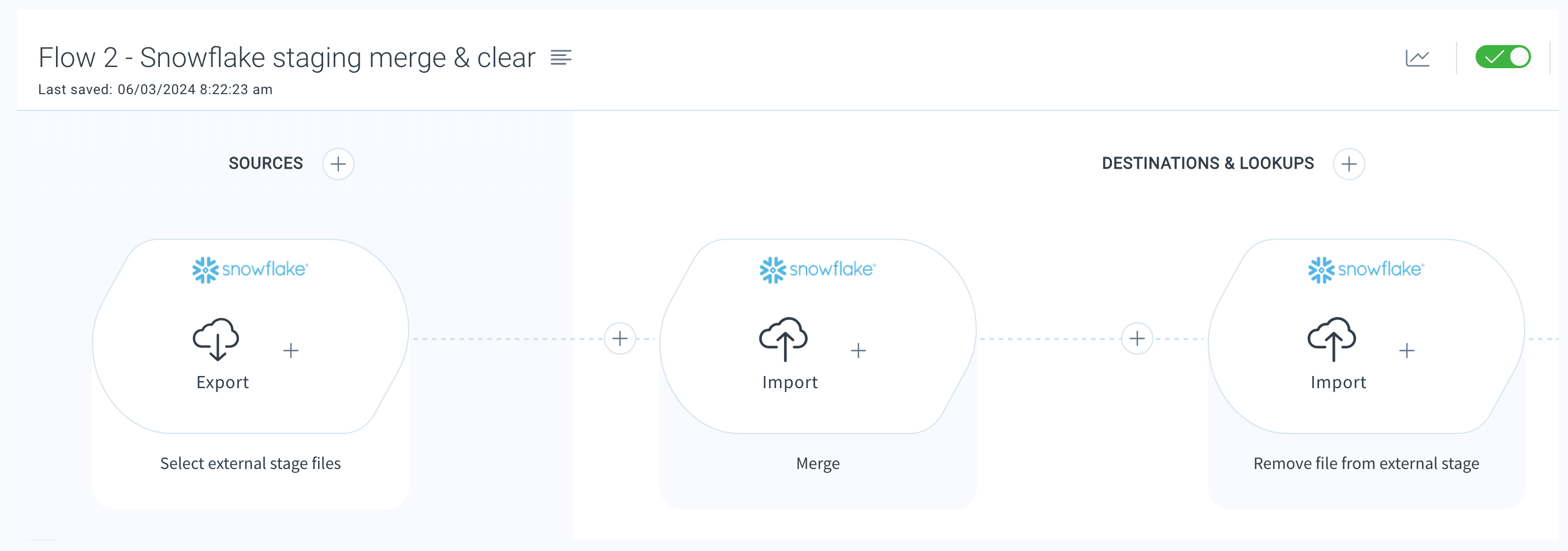

Flow 2
This flow (Snowflake staging merge & clear) retrieves the staging records, then it merges and clears the data in the staging database.

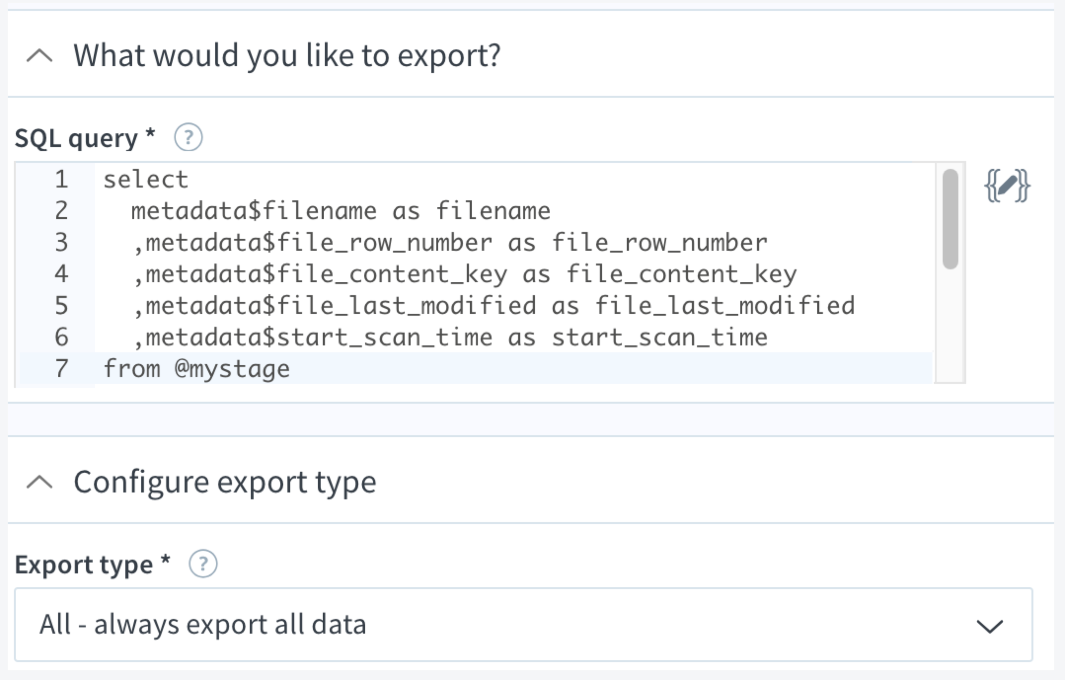

  • The Select external stage files export step uses an SQL query based on the last updated timestamp to retrieve files from the staging external S3 stage.

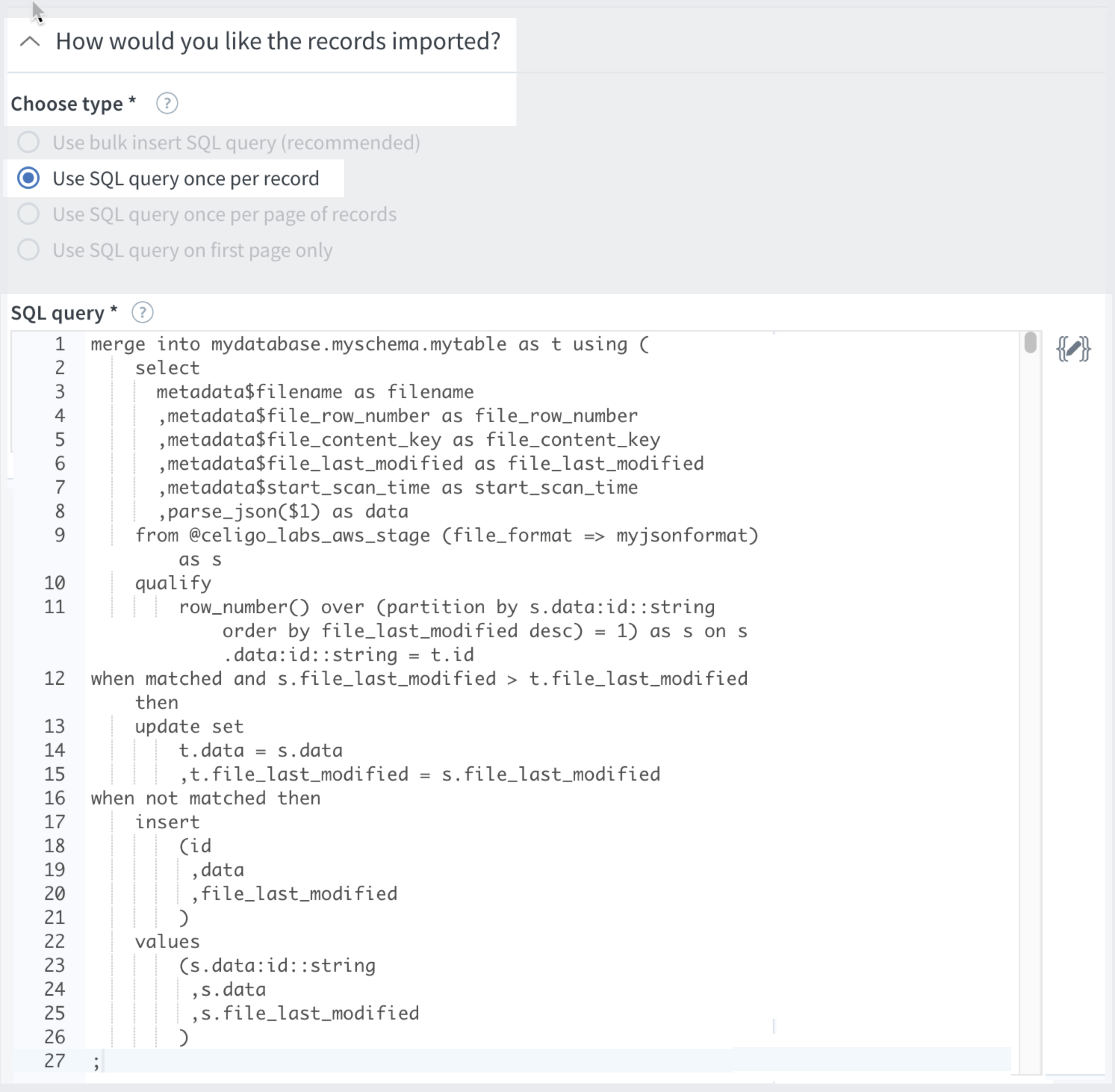

  • The Merge import step uses an SQL merge statement to merge data from the S3 stage files into a production table.

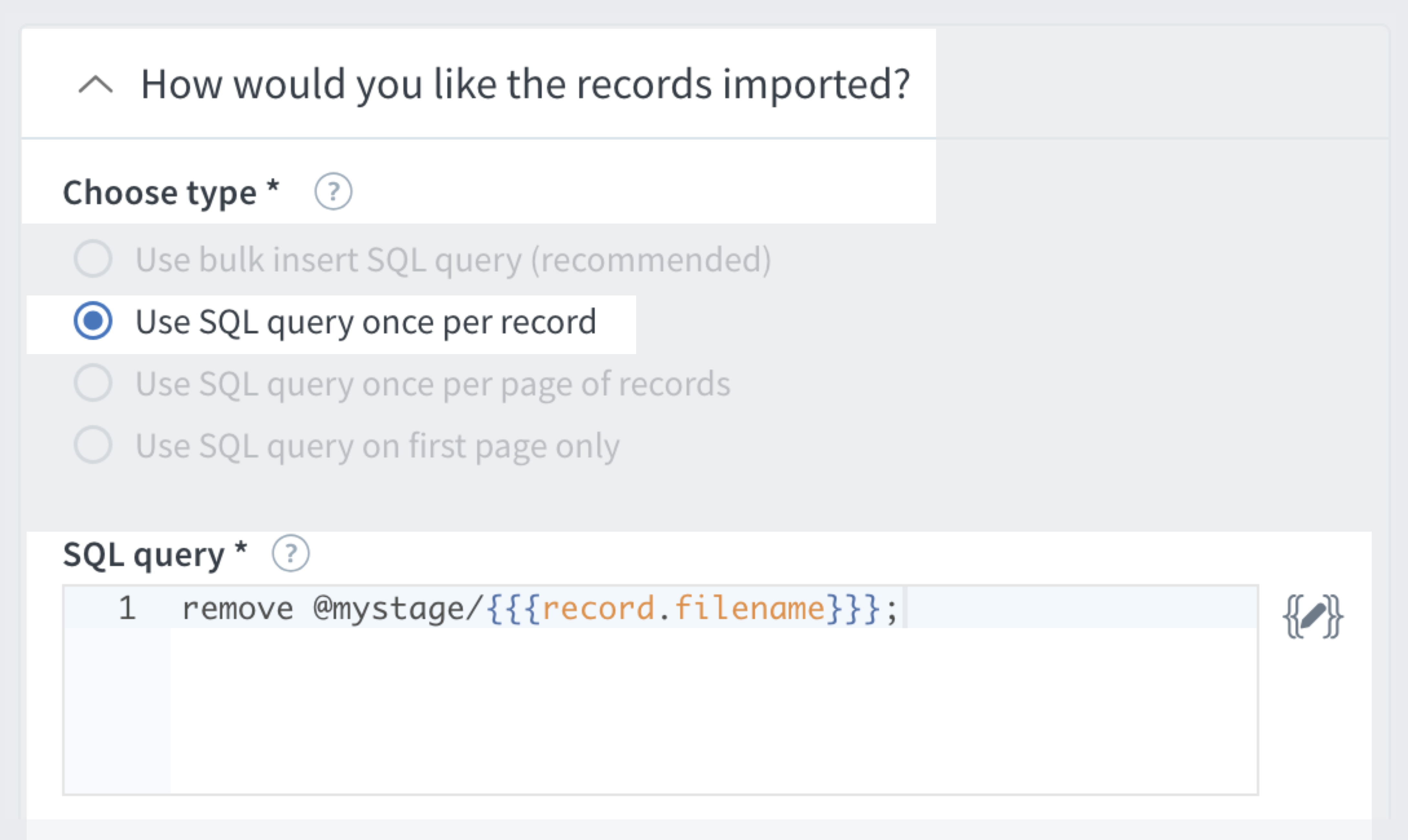

  • The Remove file from external stage import step uses an SQL remove statement to clear all records from the staging table.

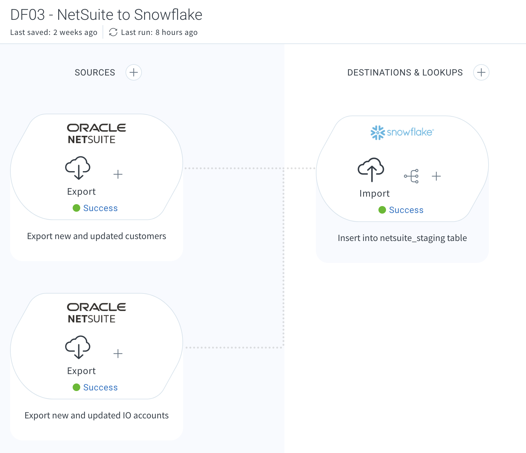

Flow 1
The first flow (DF03 - NetSuite to Snowflake) exports data from NetSuite and imports into a single staging table in Snowflake.

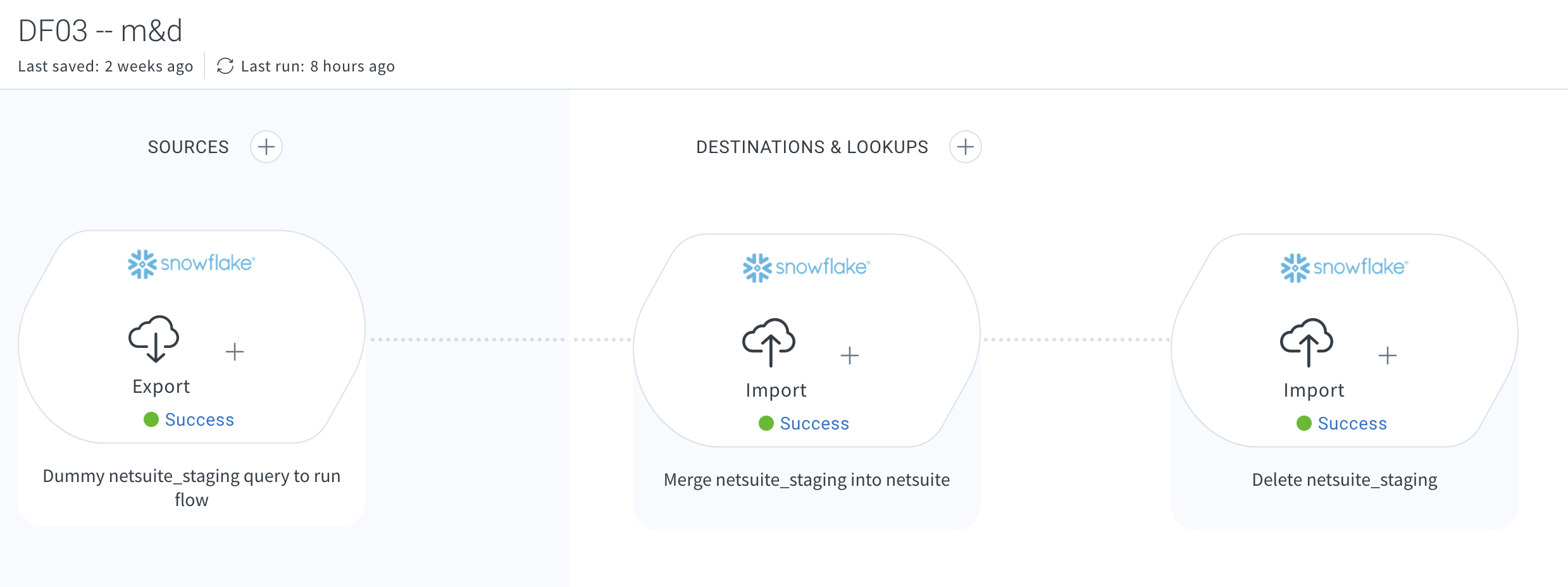

Flow 2

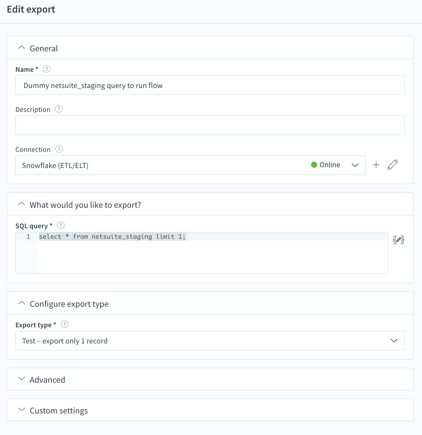

The second flow (DF03 -- m&d) first checks if any records exist in the staging table. This is done with a simple dummy query: SELECT * FROM netsuite_staging LIMIT 1
If any records are returned, integrator.io runs the flow to merge the tables together, then deletes all rows in the staging table so that the next time the flow runs, only future changes will be synchronized.
DF03 -- m&d

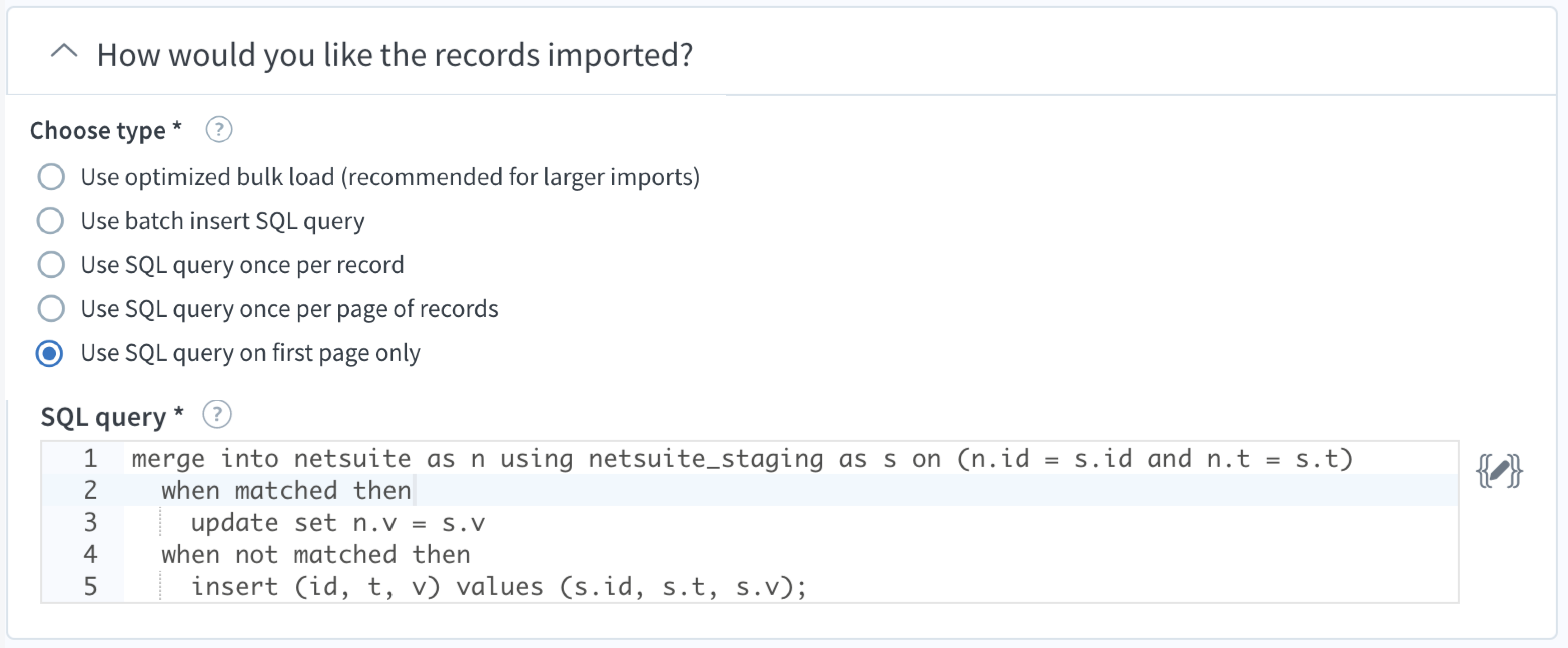

The following image illustrates the MERGE query used in the above flow. Notice that Use SQL query on first page only is selected since we only want to run the MERGE query once.
The following image illustrates the dummy query that checks if there are any records in the staging table. If so, integrator.io will only export a single record to keep the merge. The single record returned is only used to trigger subsequent steps in the flow, and the data from that record is not used for anything else.
