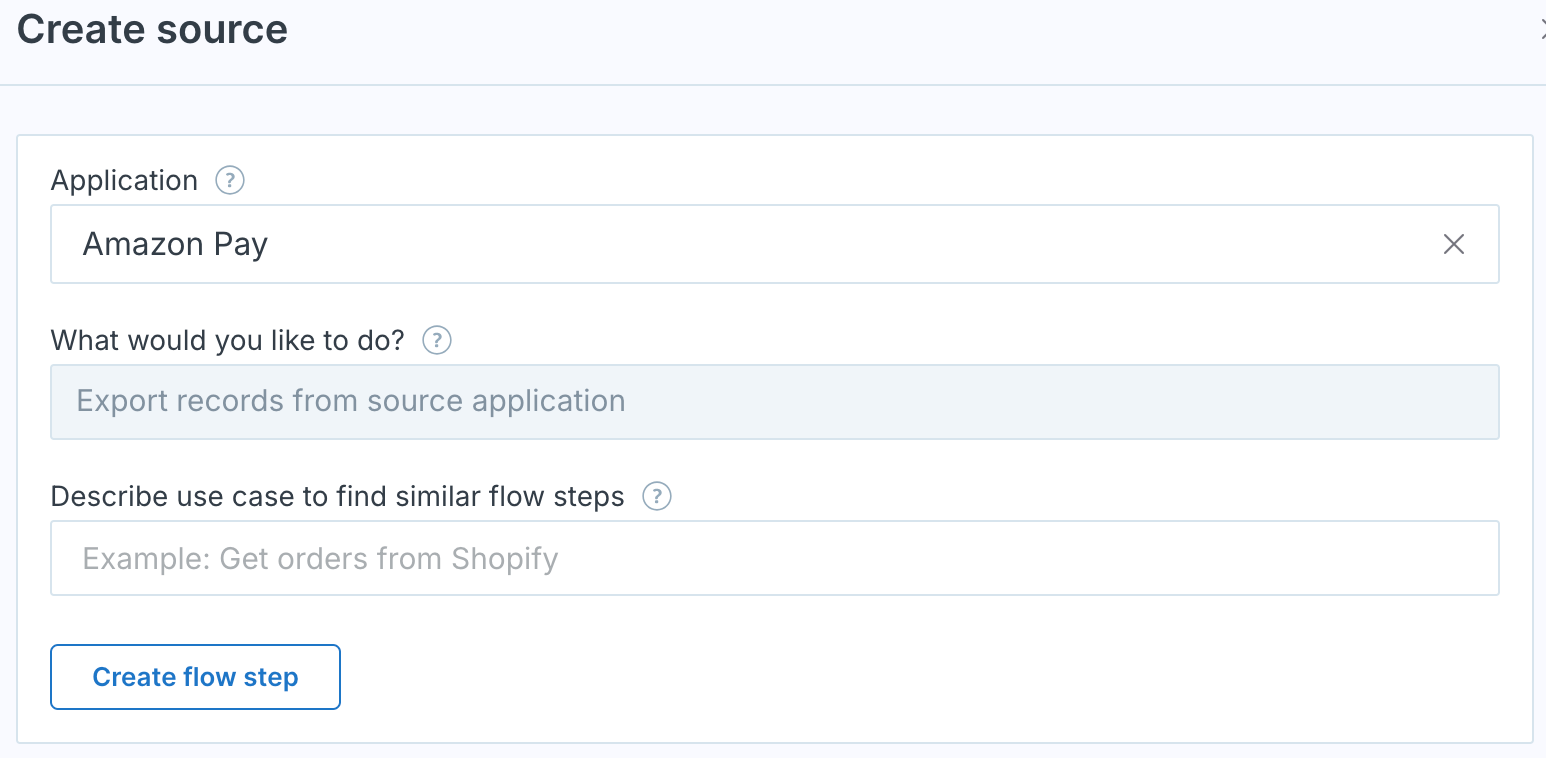

  6. Click Add source. The Create source side panel opens.
  7. From Application, select Amazon Pay.
  8. Click Create flow step. The Create export page opens.

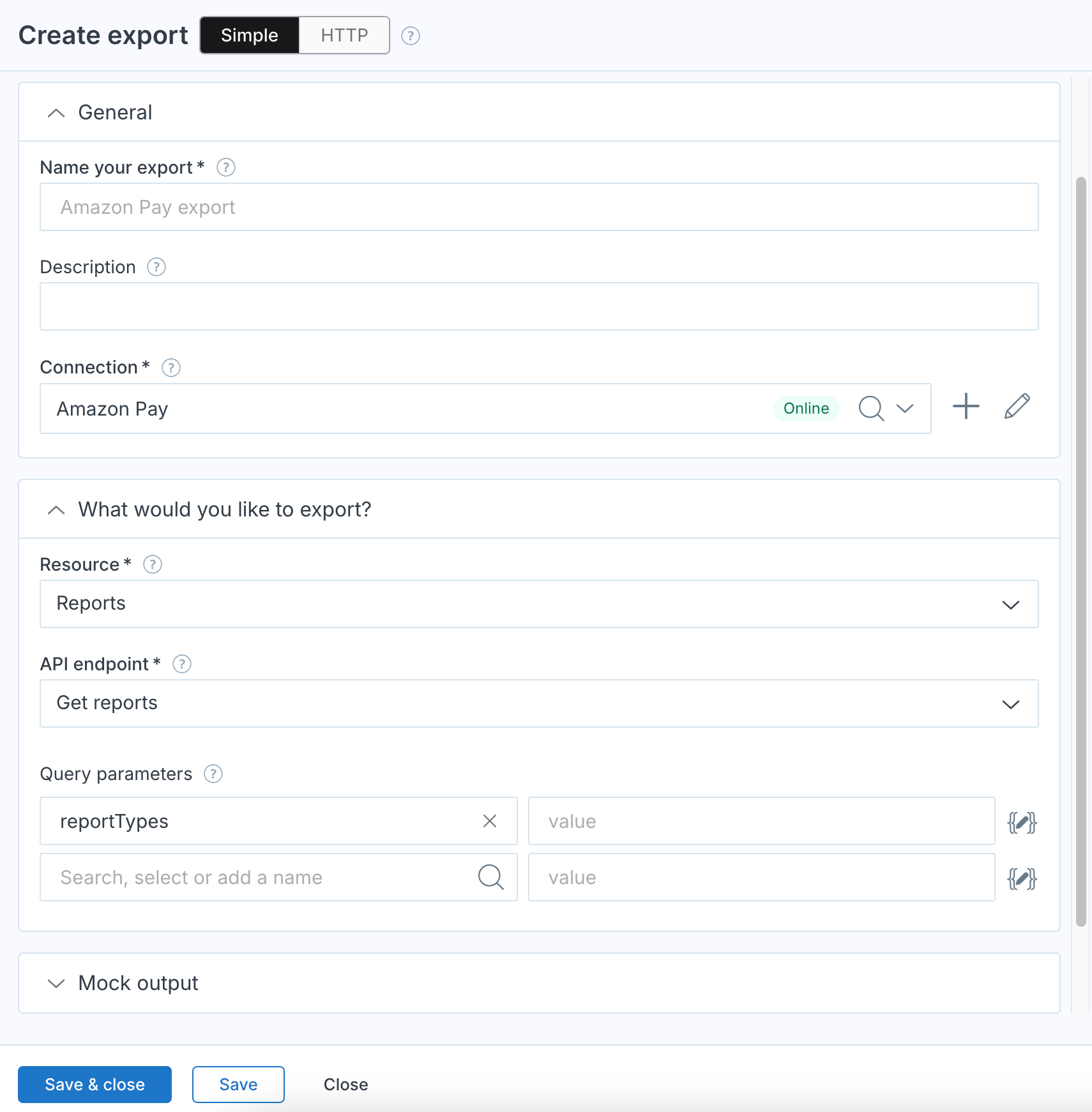

  9. In the General section, enter a Name for your export.
  10. Click Create connection. For information, see Set up a new connection to Amazon Pay.
  11. In the What would you like to export section, select the Resource and API endpoint as explained in the Configuring a new export (sample) section.
  12. Click Preview to make sure the output is as required.
  13. Click Save and close.

  1. From the Tools menu, select Flow builder and click Add source, or from the Resources menu, select Exports. Then, click + Create export.
  2. Enter a Name and Description for your export.
  3. Select the configured Amazon Pay connection.
  4. Navigate to the What would you like to export section.
    1. From Resource, select Reports.
    2. From the API endpoint, select Get reports.
    3. From Query parameters, select the required parameter listed in the table below. For example, choose reportTypes and then enter a value. For detailed information on how to choose your query parameters, see Parameters.
  5. Click Save and close.
