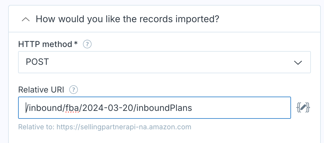

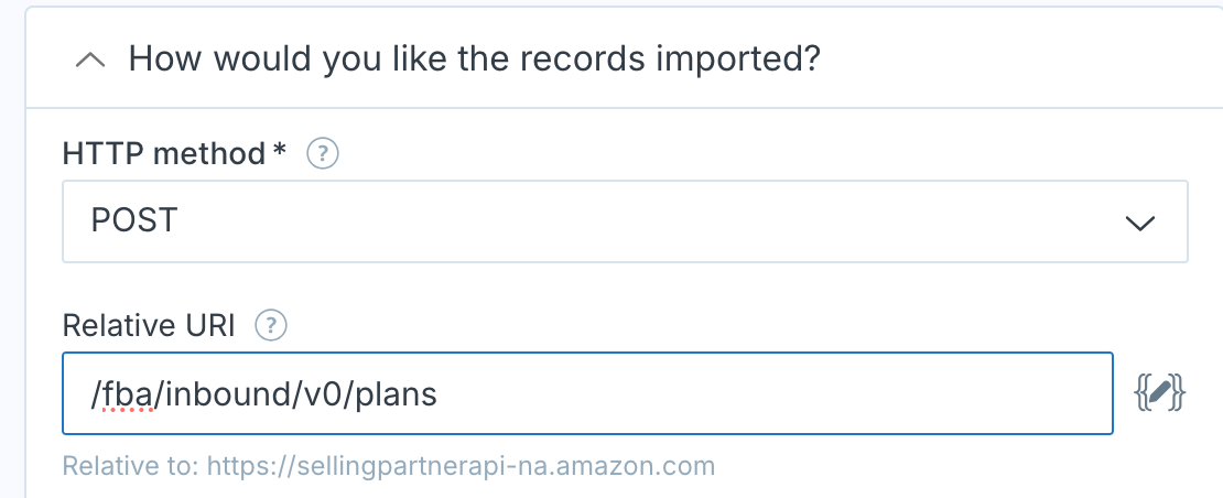

  5. Replace the configuration for the deprecated endpoint with the new endpoint as shown in the following example:
Example of how to replace the deprecated endpoint (createInboundShipmentPlan)
Navigate and expand the How would you like the records imported? section and update the following settings:
Existing configuration to be replaced:
Replacement:
  1. HTTP method * : POST
  2. Relative URI: /inbound/fba/2024-03-20/inboundPlans
    Note: For existing exports/imports, you must also update any mappingshooks, and filters based on the new endpoint data, if any are used in your resources.
