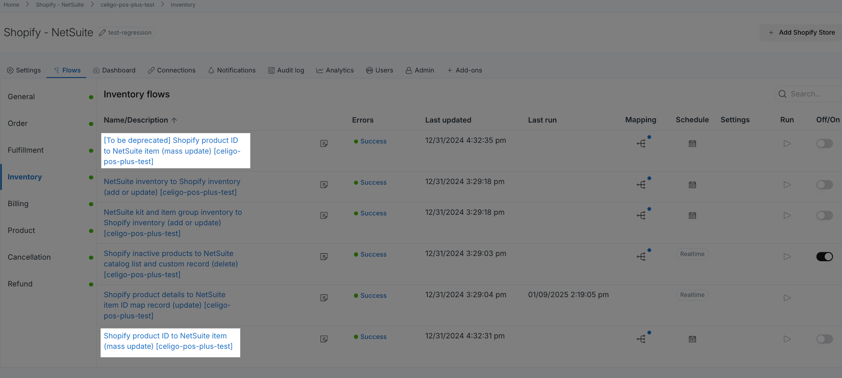

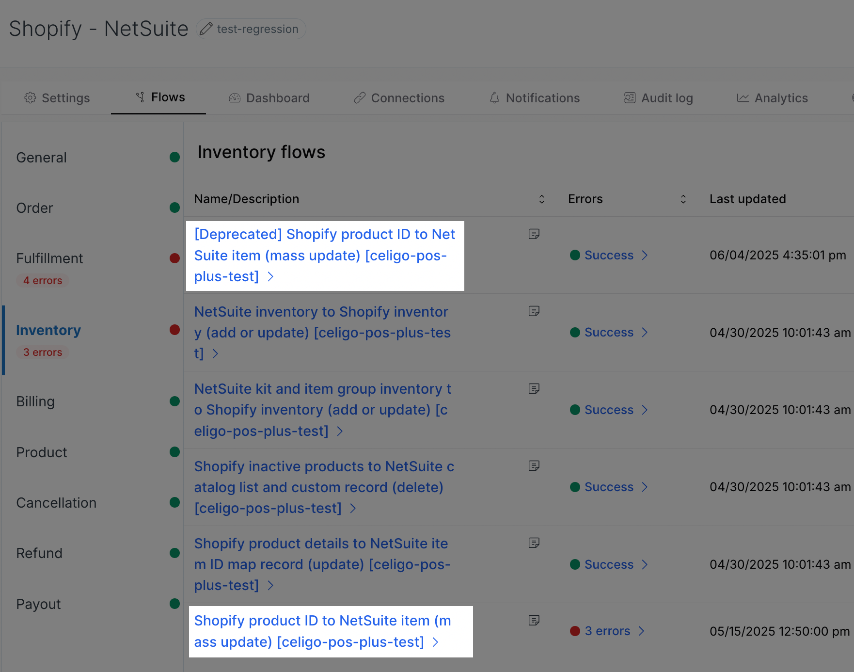

  • Flows > Inventory
    • Shopify product ID to NetSuite item (mass update)

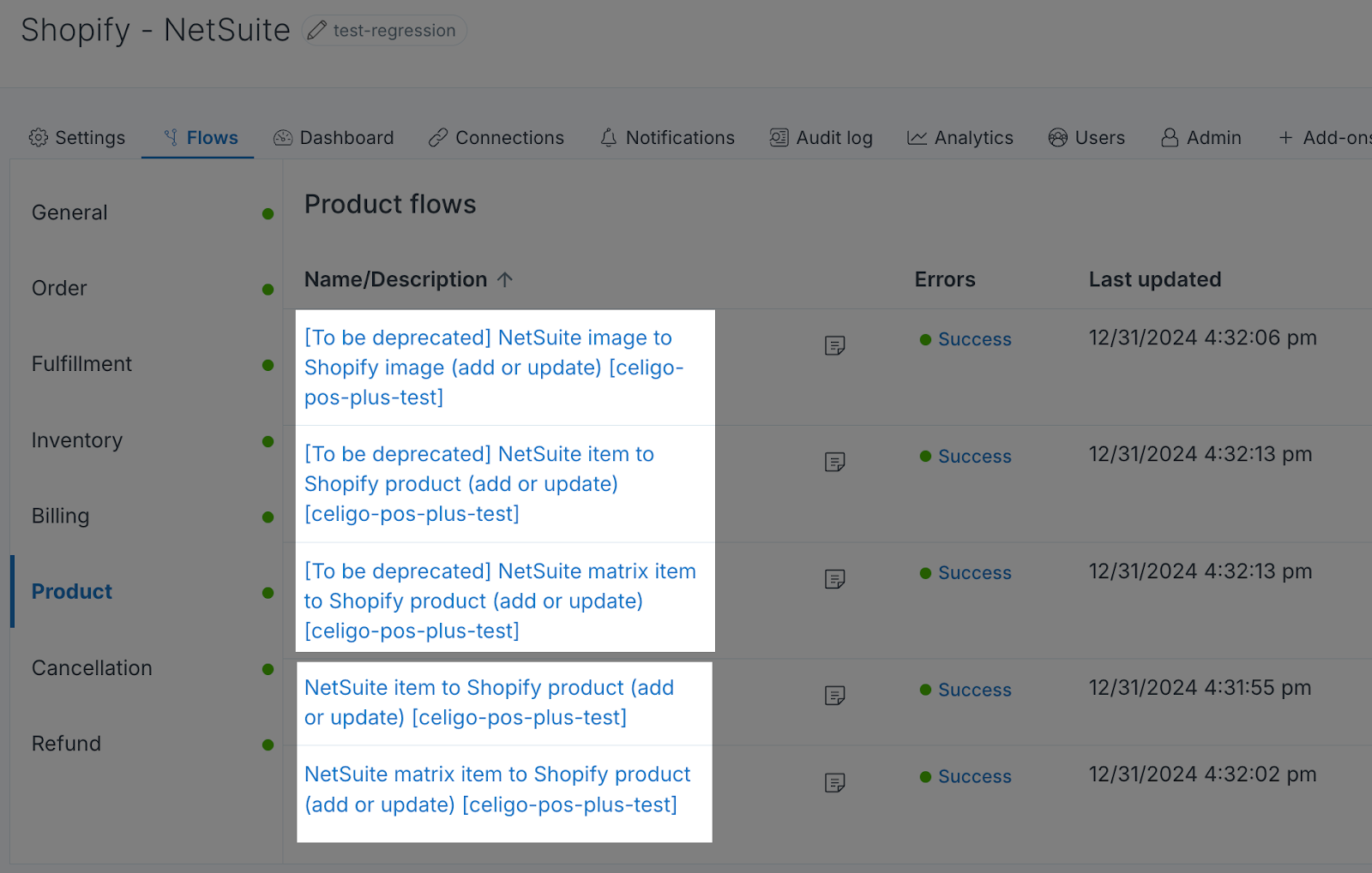

Deprecating flows
Shopify deprecated REST-based product flows on 1 July 2025, and Celigo disabled the following REST-based flows at that time.
  • Flows > Product
    • (To be deprecated) NetSuite image to Shopify image (add or update)
    • (To be deprecated) NetSuite item to Shopify product (add or update)
    • (To be deprecated) NetSuite matrix item to Shopify product (add or update)
  • Flows > Inventory
    • (To be deprecated) Shopify product ID to NetSuite item (mass update)
The functionality of the NetSuite image to Shopify image(add or update) flow will be incorporated into the logic of the other two flows, so it will no longer exist as a separate flow.

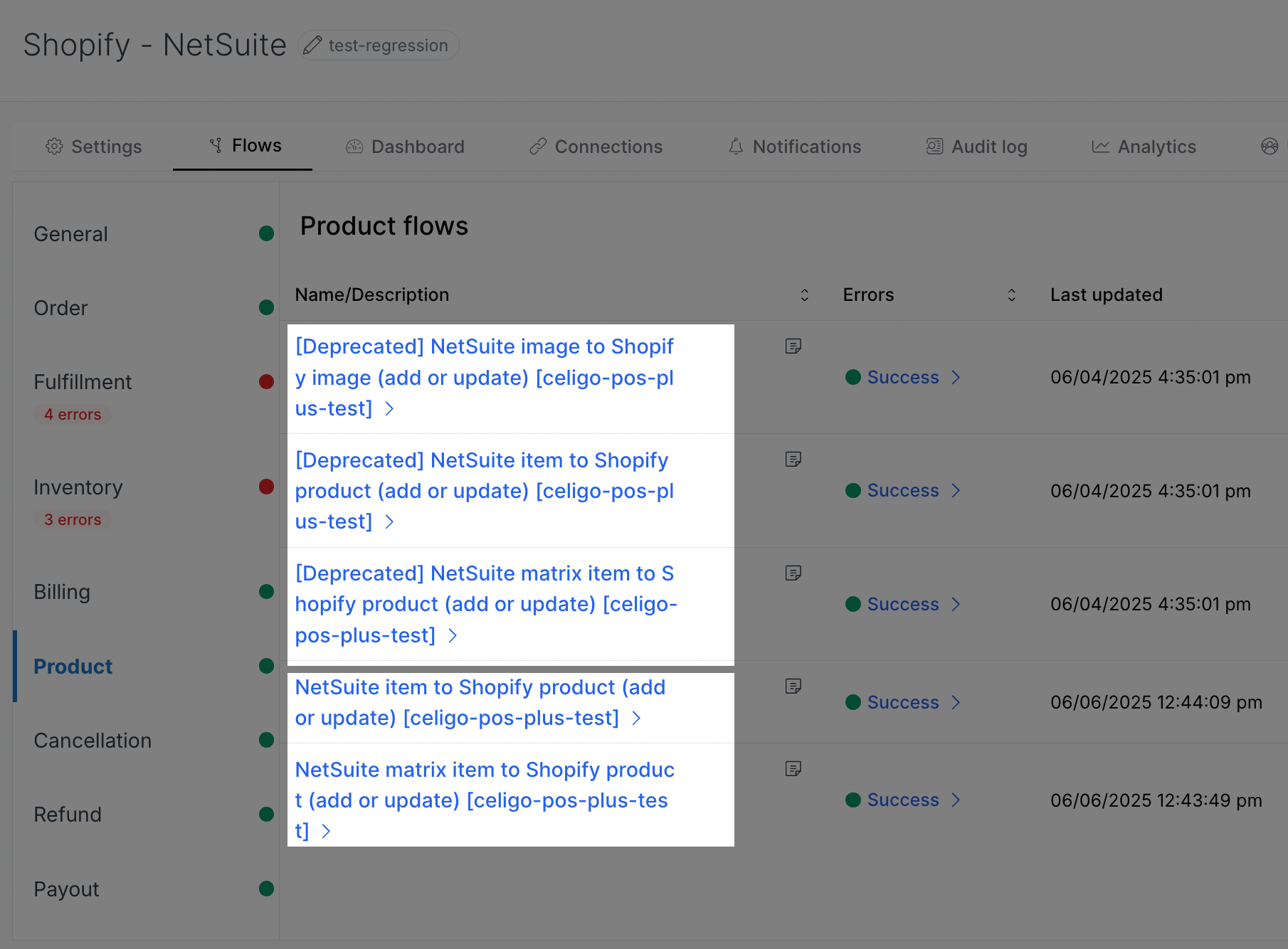

  1. Open your Shopify–NetSuite integration app.
  2. Navigate to Flows > Product.
    Product flows in the Shopify–NetSuite integration app
  3. Verify the SKU field mapping in your saved search: Before enabling the GraphQL flows, confirm which NetSuite field you use as the SKU.
    If you use the default Name/Item ID field, no action is required. If you use an alternate field, such as UPC Code, EAN, or a custom field, map that field under the Item Name (Variant) custom label in your saved search results.
    The GraphQL flows read SKUs exclusively from this label. If the SKU value is not mapped there, inventory lookups return empty results and items cannot be located or updated. See SKU field configuration for GraphQL flows and Error: Inventory item does not have inventory tracking enabled for more information.

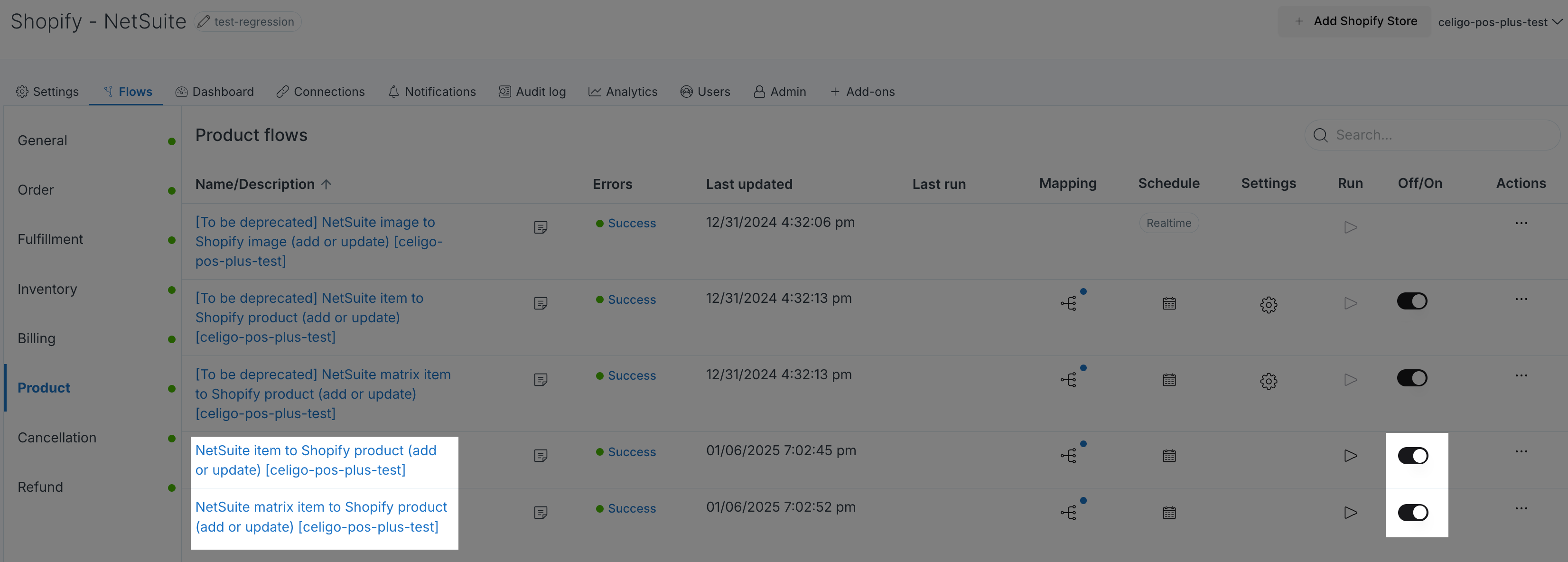

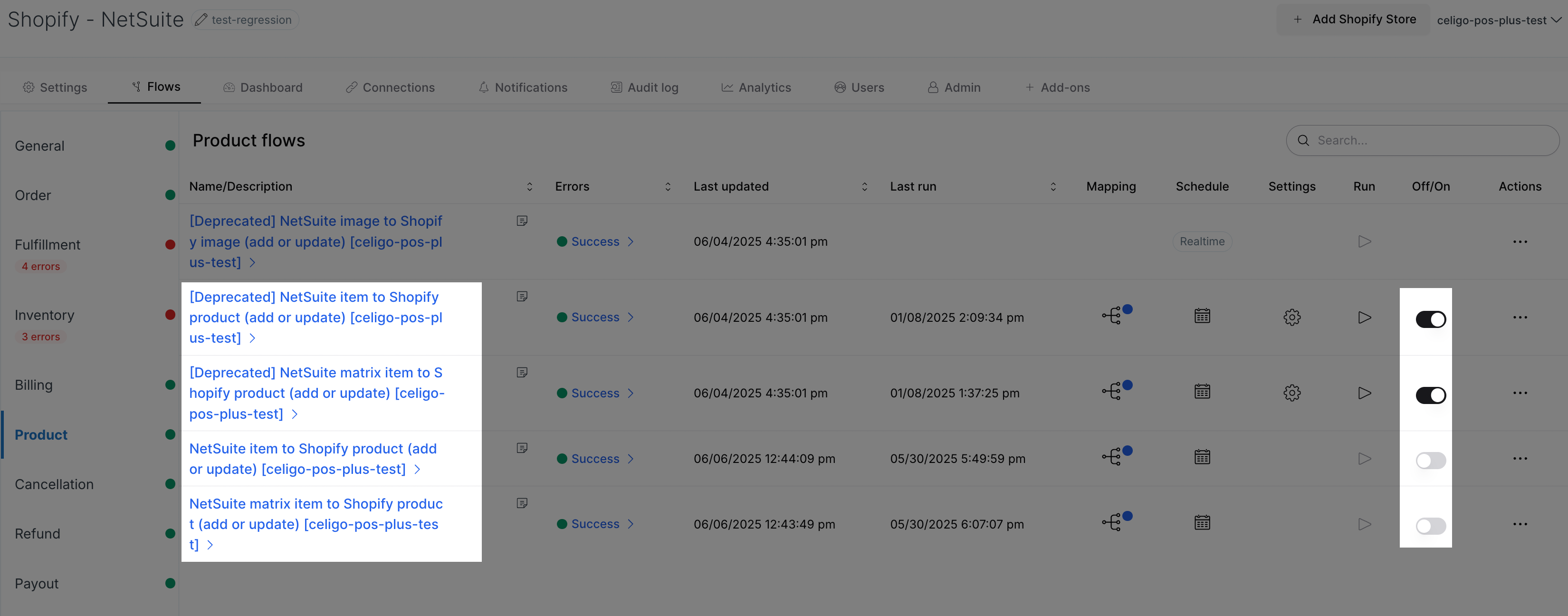

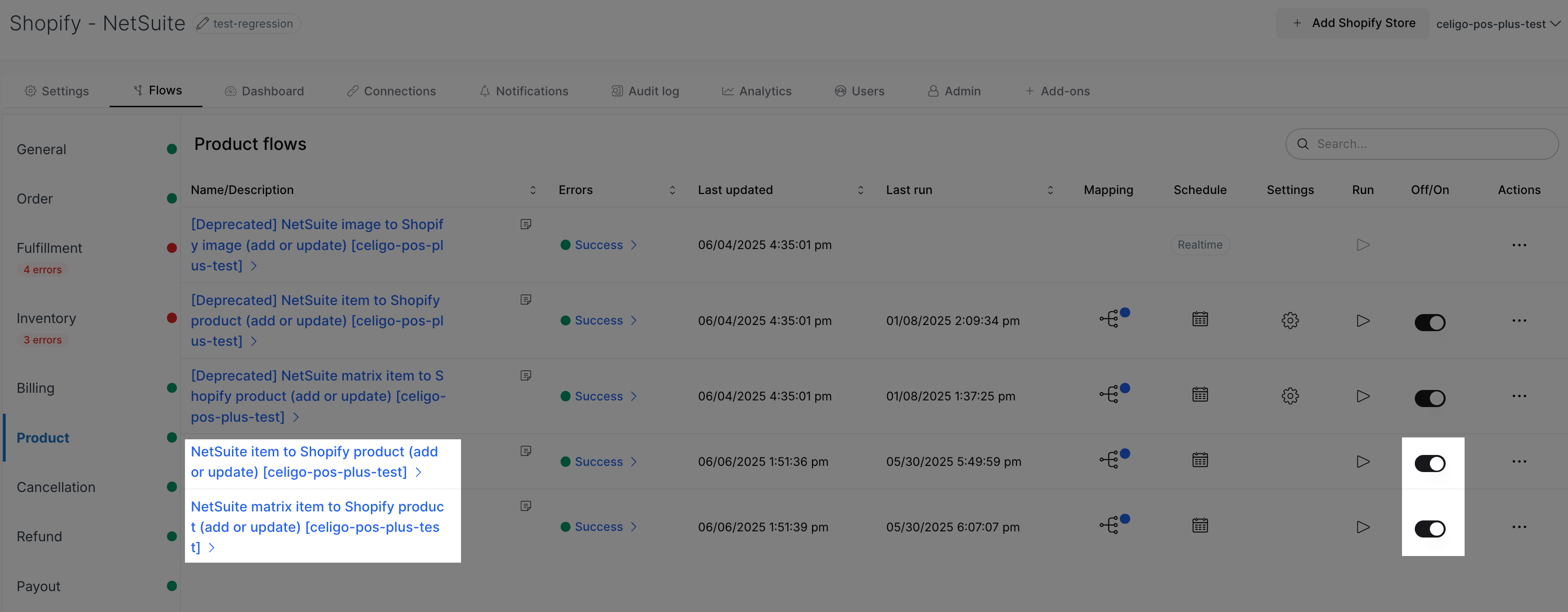

  4. Turn on the toggle for the following GraphQL flows:
    • NetSuite item to Shopify product (add or update)
    • NetSuite matrix item to Shopify product (add or update)
    Enable the GraphQL-based product flows

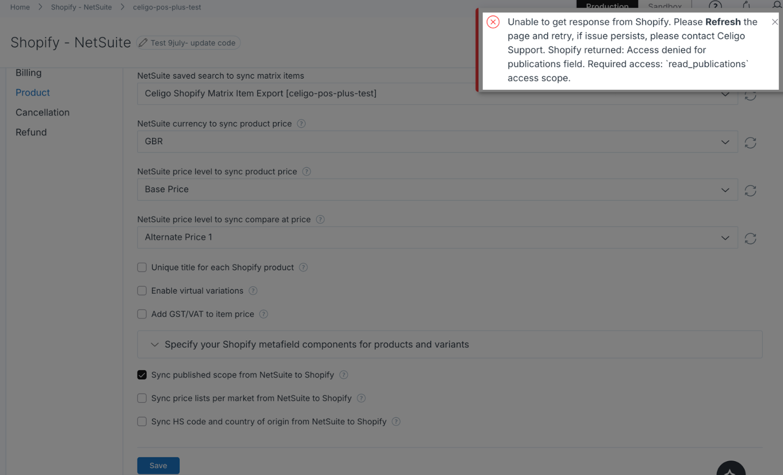

  5. Reauthorize the Shopify connection: Reauthorize the connection if you use the Sync published scope from NetSuite to Shopify setting. If you enable this setting after reauthorization, reauthorize the connection again to sync the scopes.
    For more information, see Settings.
    If you enable the Sync published scope from NetSuite to Shopify setting before authorizing the connection, you will see the following error:
    Unable to get a response from Shopify. Refresh the page and try again. If the issue continues, contact Celigo Support. Shopify returned: Access denied for publications field. Request access: 'read publications' access scope.
    Shopify publications access-scope error

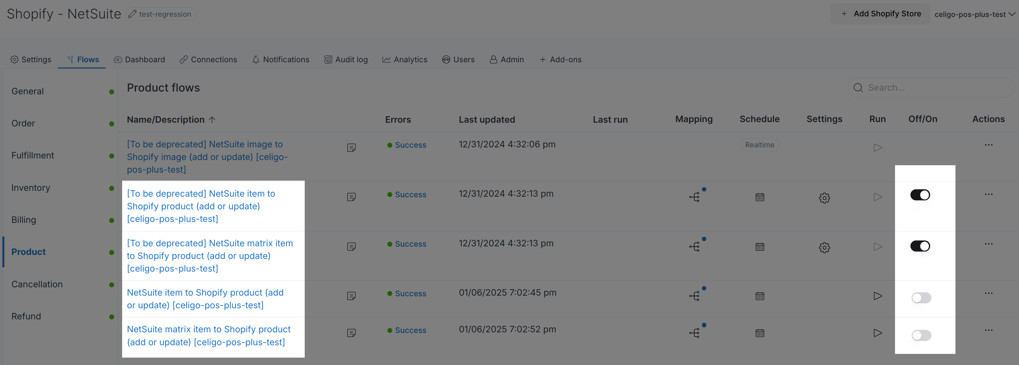

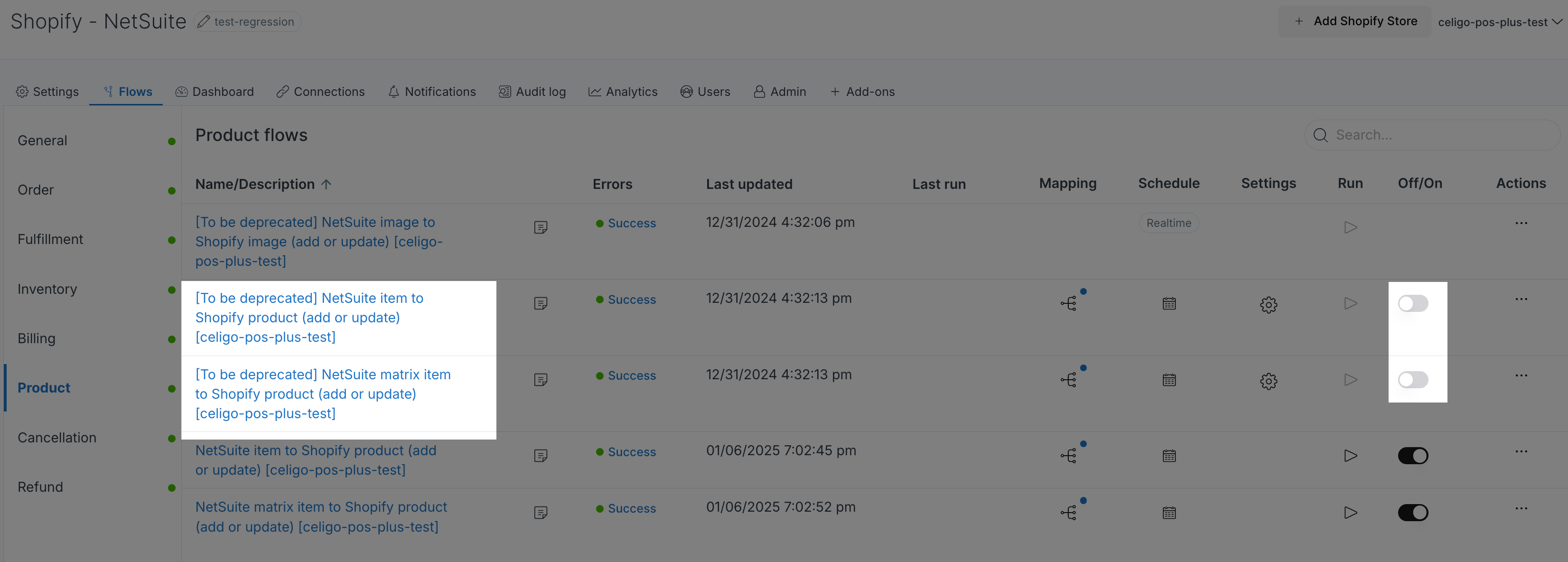

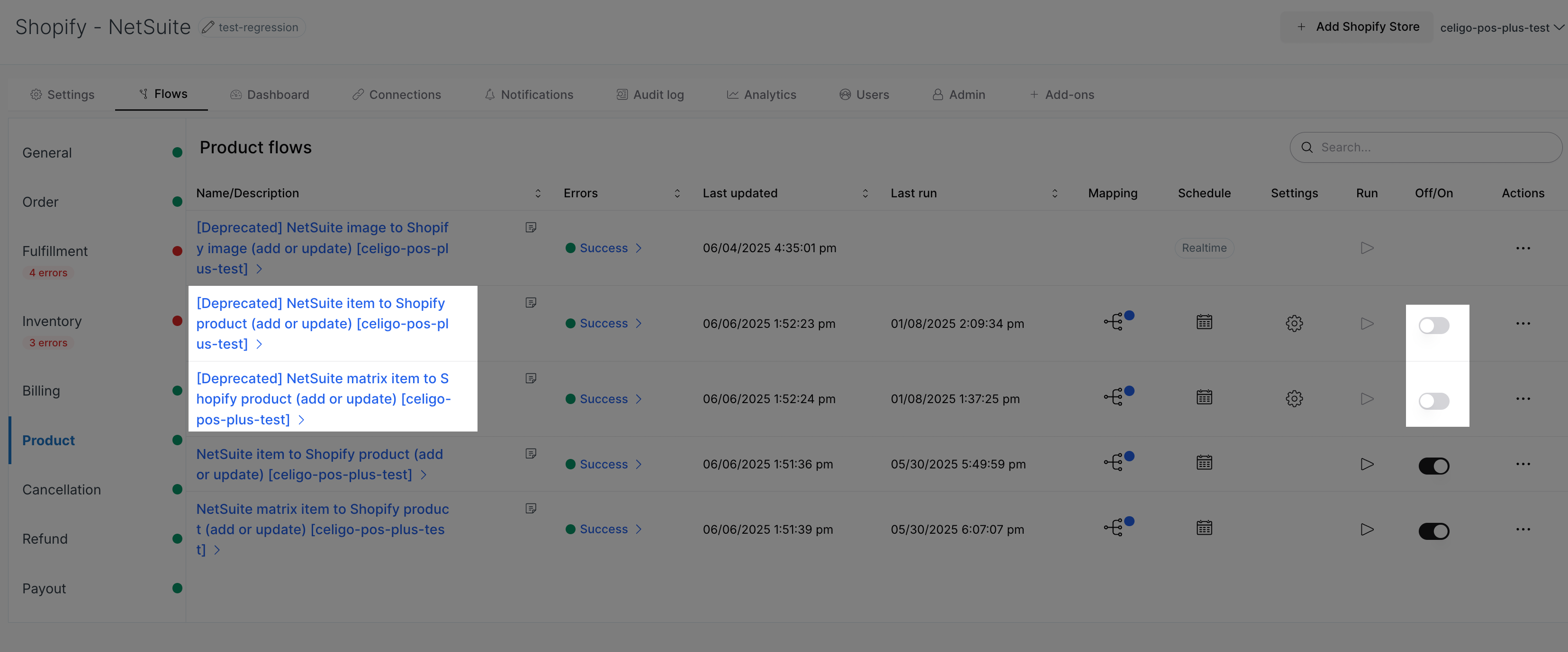

  7. Turn off the toggle for the following REST-based flows:
    Disable the REST-based product flows

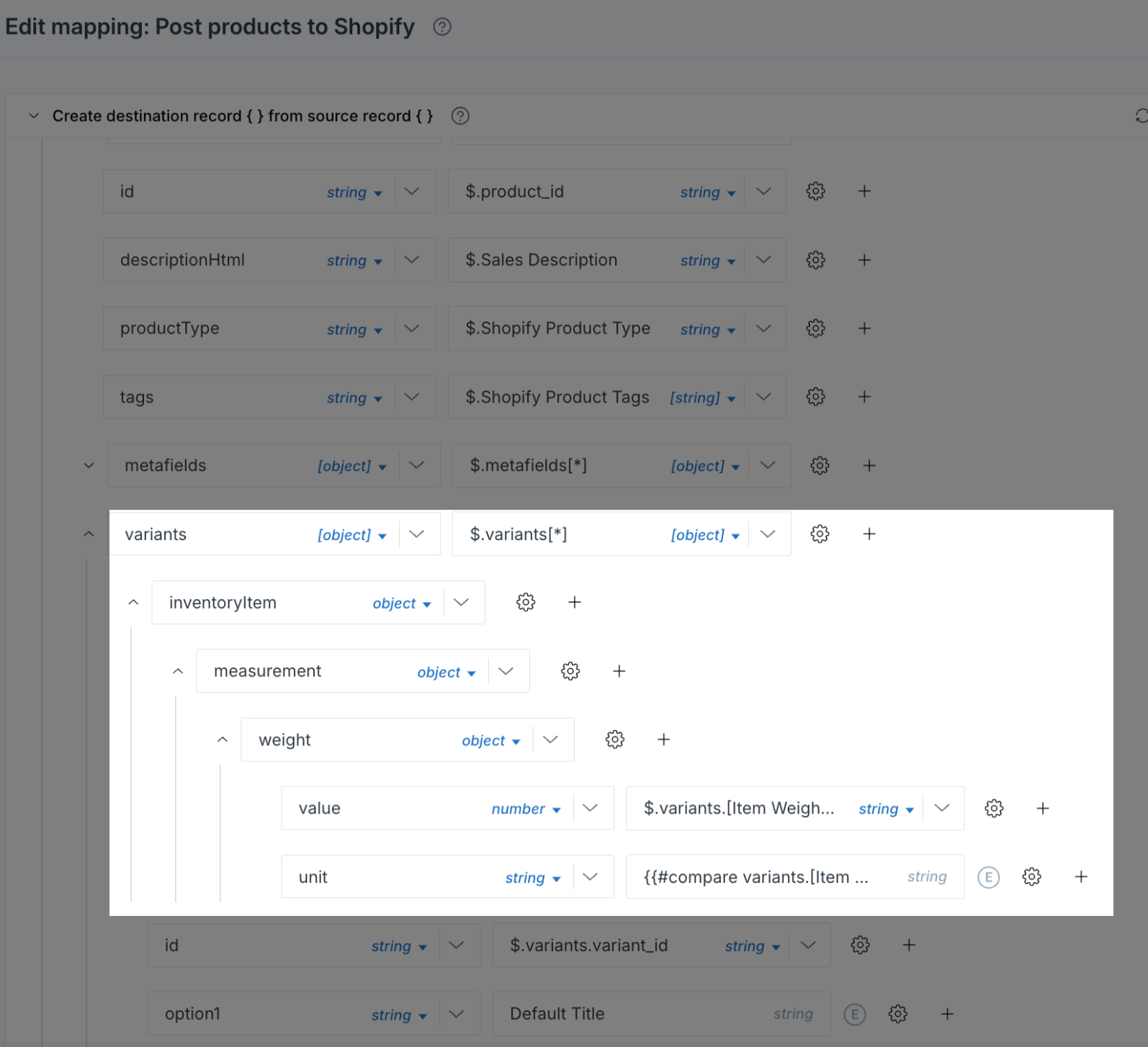

Configure mapping for weight fields
  1. In the Flows > Product section, open the "Field Mappings" for the NetSuite Item to Shopify Product Add/Update flow.
  2. Click Post products to Shopify. Scroll to the standard mappings for variants.
  3. Click + to add a new row under the variants.
    • In the text field, type in inventoryItem and select the datatype as the object.
    • Click + at the inventoryItem level. In the text field, type in measurement and select the datatype as the object.
    • Click + at the measurement level. In the text field, type in weight and select the datatype as the object.Mapping_Weight.png
    • Click + at the weight level. Type in value and select the datatype as number.
    • From the source field dropdown, select Item Weight (Variant).

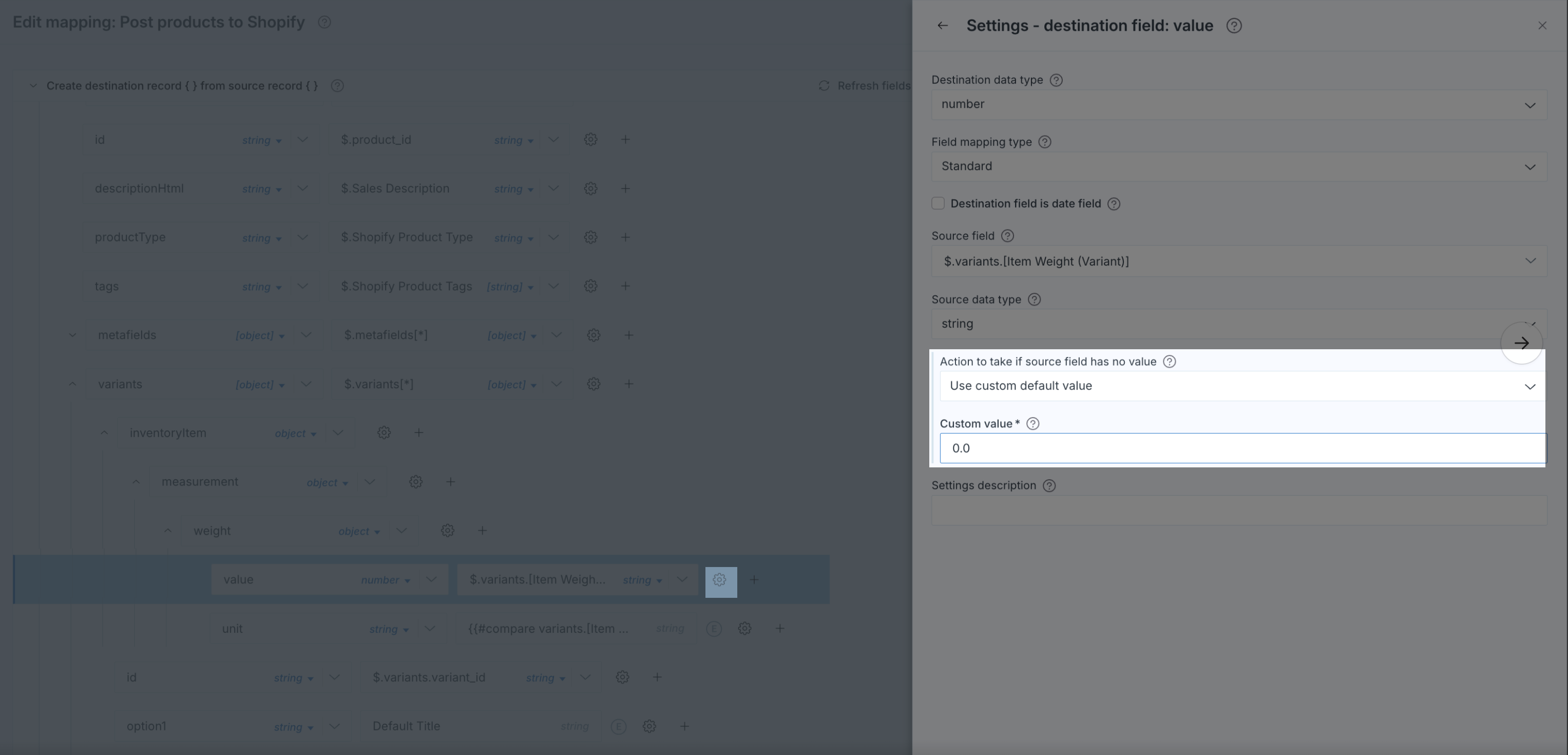

      For items with weight value zero or no value: If an item's weight value is zero or you do not need to define a weight in NetSuite (e.g., Item type as service), configure the mapping as explained below:
      • Click Settings next to the NetSuite Item Weight (Variant) field.
      • In the Action to take if source field has no value dropdown, select Use custom default value.

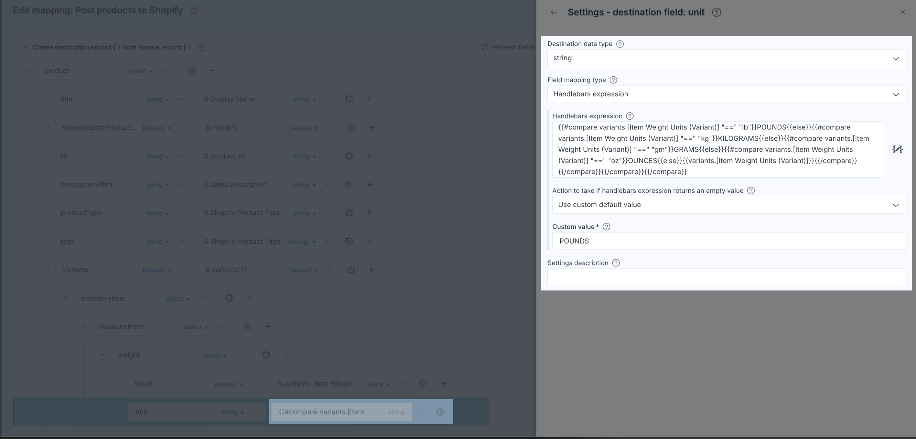

      • Click + at the weight level. Type in unit and select the data type as string.
      • From the source field dropdown, select Item Weight Units (Variant).
        For items with weight units other than "kilogram" or "pounds": Shopify expects the weight unit to be either "kilogram" or "pounds". If an item's weight unit you want to sync from NetSuite is not "kilogram" or "pounds", configure the mapping as explained below:
        • Click Settings next to the NetSuite Item Weight Units (Variant) field.
        • From the Destination data type dropdown, select string.
        • From the Field mapping type dropdown, select Handlebars expression.
        • In the Handlebars expression, copy and paste this:{{#compare variants.[Item Weight Units (Variant)] "==" "lb"}}POUNDS{{else}}{{#compare variants.[Item Weight Units (Variant)] "==" "kg"}}KILOGRAMS{{else}}{{#compare variants.[Item Weight Units (Variant)] "==" "g"}}GRAMS{{else}}{{#compare variants.[Item Weight Units (Variant)] "==" "oz"}}OUNCES{{else}}{{variants.[Item Weight Units (Variant)]}}{{/compare}}{{/compare}}{{/compare}}{{/compare}}
        • From the Action to take if handlebars expression returns an empty value, select Use custom default value.
        • In the Custom value text box, enter POUNDS.
Now, once you run the flow, the weight records get synced correctly without any errors.

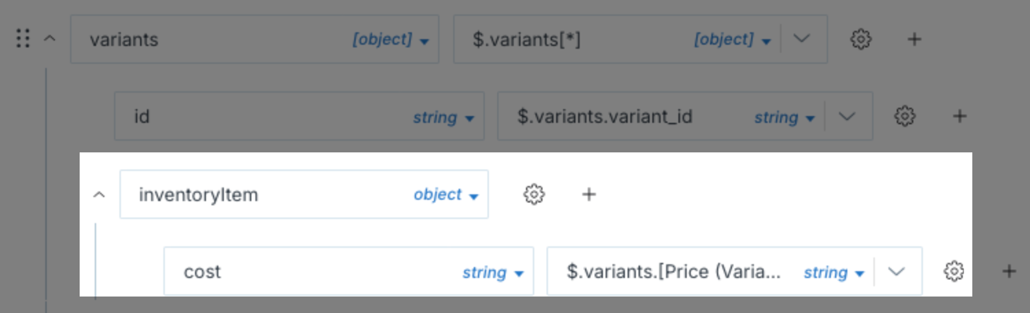

Syncing Cost from NetSuite to Shopify (other inventory fields)
You can sync the Cost from NetSuite to Shopify using GraphQL-based product flows. The mapping in the product flows ensures that Cost is accurately transferred to Shopify.
Pre-requisite: Before syncing, ensure that the Cost field is added to the Saved Search results criteria in NetSuite.
To ensure seamless synchronization, configure the cost settings in the mapping correctly as explained below.
Configure mapping for cost field
    • Click + to add a new row under the variants. In the text field, type in inventoryItem and select the datatype as the object.
    • Click + at the inventoryItem level. In the text field, type in Cost and select the datatype as the string.
    • From the source field dropdown, select Price (Variant).
    • Click Save.

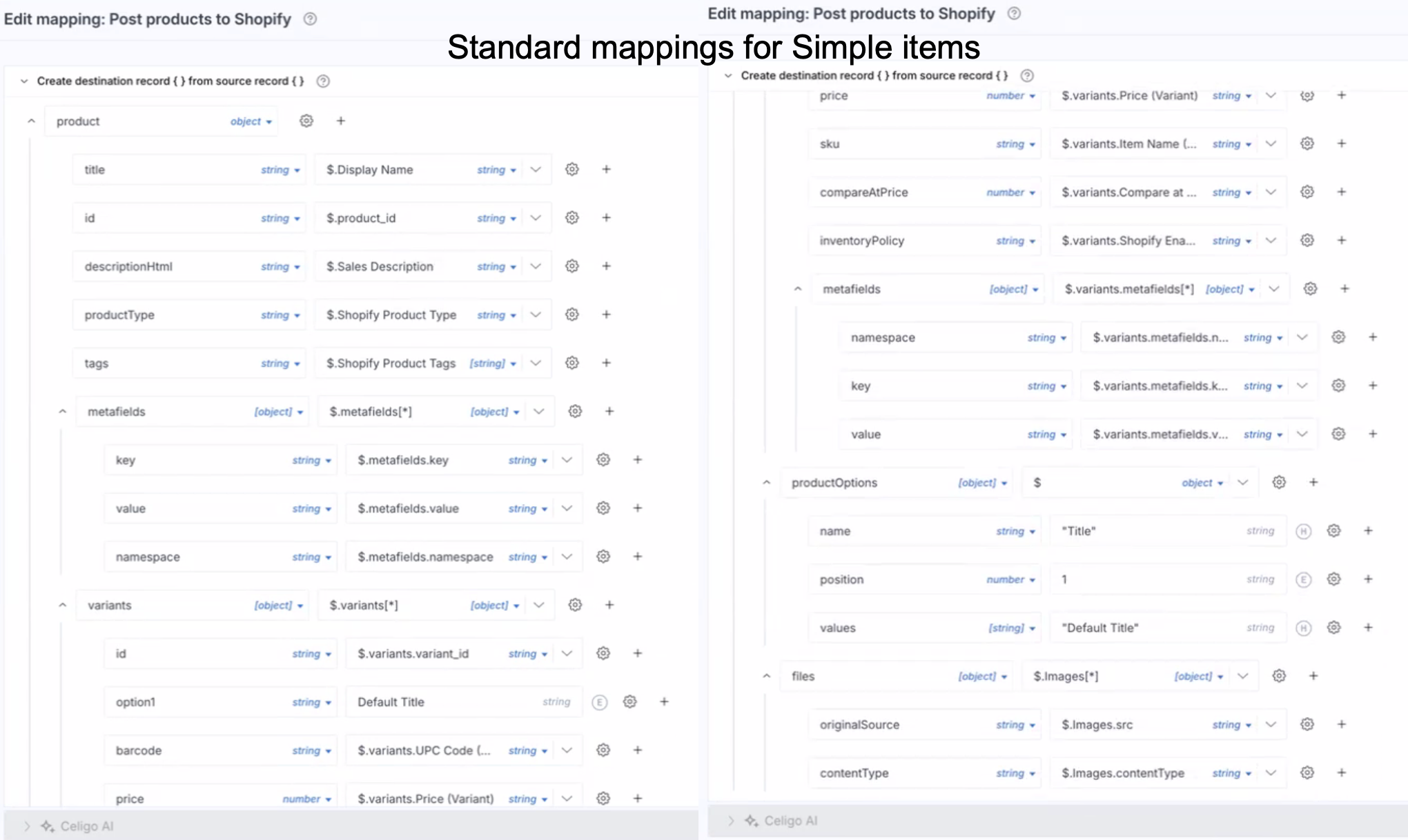

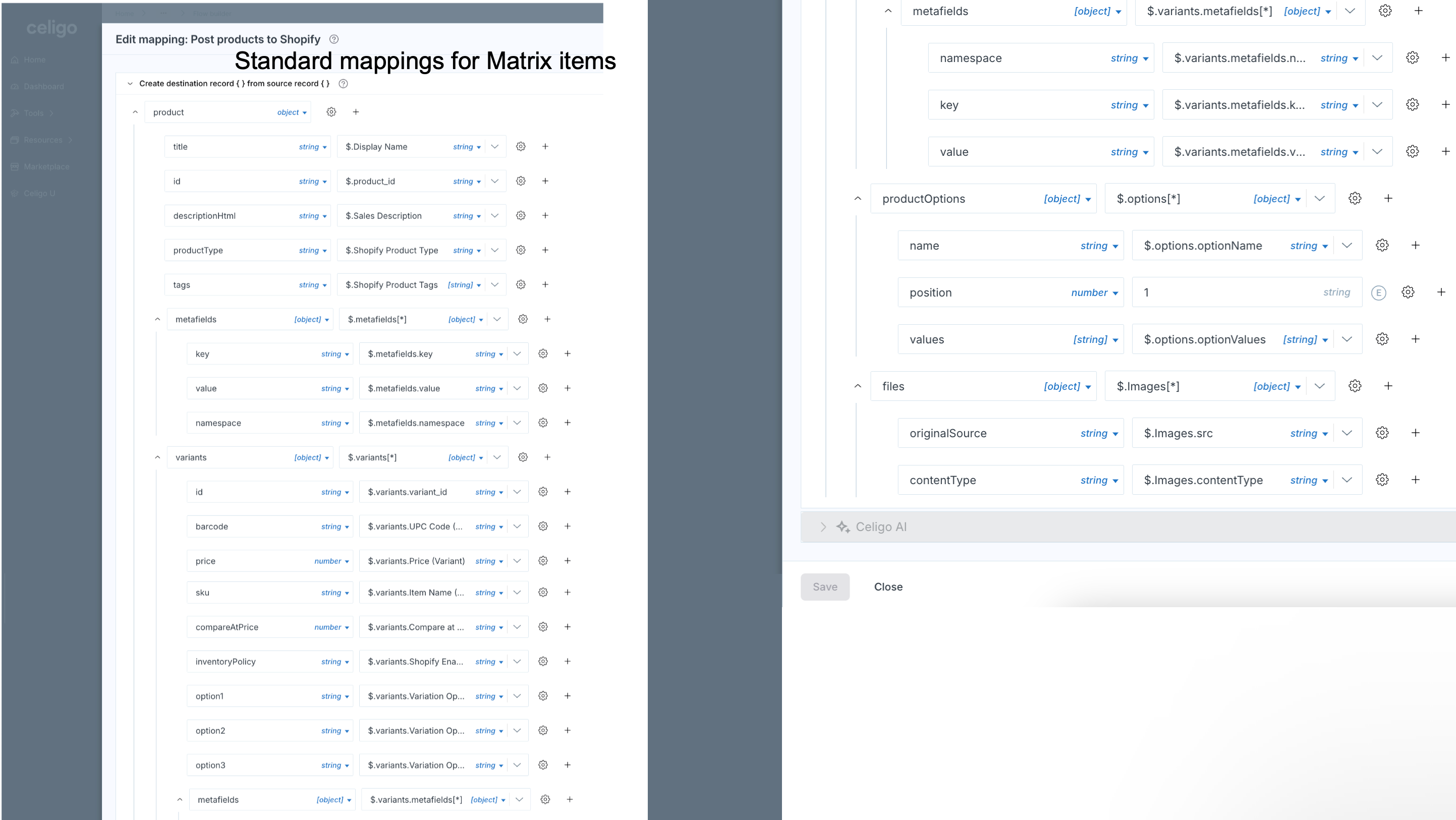

The following screenshot displays the list of standard mappings for simple items.
The following screenshot displays the list of standard mappings for matrix items.

Field mappings:
  • GraphQL-based flows use 2.0 mappings, which have been moved to the new Mapper 2.0 from the previous REST-based versions.
  • The metadata structure has also been updated and will vary in GraphQL-based flows, enhancing data organization and compatibility.

Publish scopes: The GraphQL-based product flow gives you full control over publishing and unpublishing products and product variants for a specific sales channel.

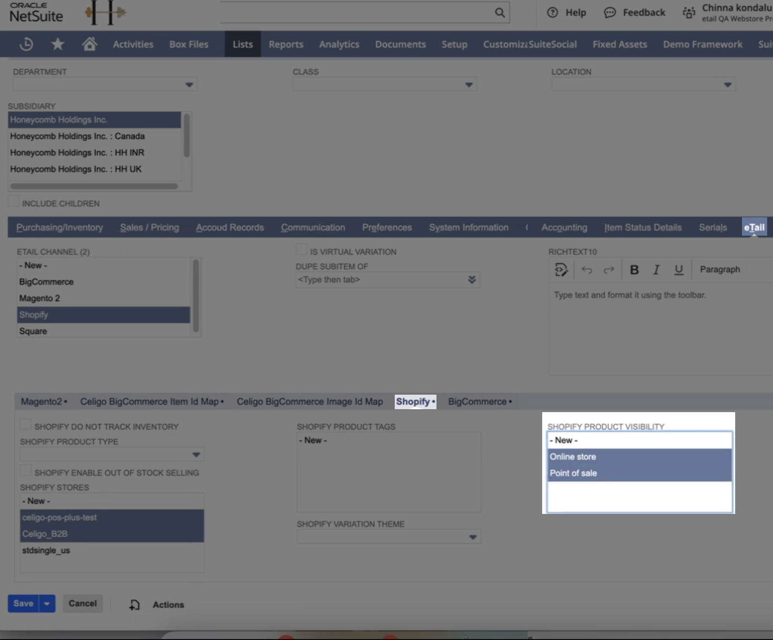

To manage publication visibility in NetSuite, navigate to:
Item > eTail tab > Shopify > Shopify Product Visibility.
Saved search column: The published-scope sync reads the sales-channel names from the item saved search result column with the custom label Shopify Product Scope. The integration app's default item saved searches include this column. If you use your own saved search, keep a column with this exact custom label. Without it, products still update in Shopify but aren't published to any sales channel, and no error appears.
Product sync behavior: When the Sync published scope from NetSuite to Shopify setting is enabled:
  • You must define all sales channels in NetSuite where you want the product to remain published.
  • Any channel that is not listed in NetSuite and not selected under Inventory Item > eTail > Shopify > Shopify Product Visibility for the product will be removed from Shopify during the sync.
Example: A merchant has a product published to 5 channels in Shopify: Online Store, Google, X, Meta, and Shop.
In NetSuite, only 3 channels are listed under product visibility: Online Store, Google, and X. The merchant updates the field in NetSuite to select just Online Store and Google.
Result in Shopify:
  • Product stays published to the Online Store and Google
  • Product is unpublished from X, Meta, and Shop
In short, NetSuite becomes the source of truth — only the channels you list and select in NetSuite will remain active in Shopify.
Variant-level publishing: The Shopify Product Visibility field also controls sales-channel publishing for individual variants.
  • Existing variants can be published or unpublished for supported Shopify sales channels and catalogs.
  • New variants can initially remain unpublished and are published during synchronization based on the Shopify Product Visibility values set for the variants.
  • A variant can't appear in a sales channel unless its parent product is published to that channel first.
  • Variant-level publishing doesn't apply to the Point of Sale channel.
Note: Variant-level publishing is part of the 2026.10.1 integration app update, which Celigo deploys to installed integration apps automatically. Until your integration app has the update, variant values in Shopify Product Visibility aren't applied. If Manage Shopify Markets and catalogs from NetSuite doesn't appear under Settings > Product, contact Celigo Support.
Markets and catalogs: To also manage publishing to Shopify catalogs, enable Manage Shopify Markets and catalogs from NetSuite under Settings > Product. When enabled, each product and variant is published to the catalogs selected in Shopify Product Visibility and unpublished from any catalogs not selected. Items with only sales channels selected are removed from all Markets and catalogs on each sync.
To set up variant-level publishing:
  1. Make sure the parent product is published to the required sales channel.
  2. Go to Settings > Product and select Sync published scope from NetSuite to Shopify.
  3. Set the Shopify Product Visibility field on the relevant NetSuite item records.
  4. To also manage publishing to Shopify catalogs, select Manage Shopify Markets and catalogs from NetSuite under Settings > Product.
