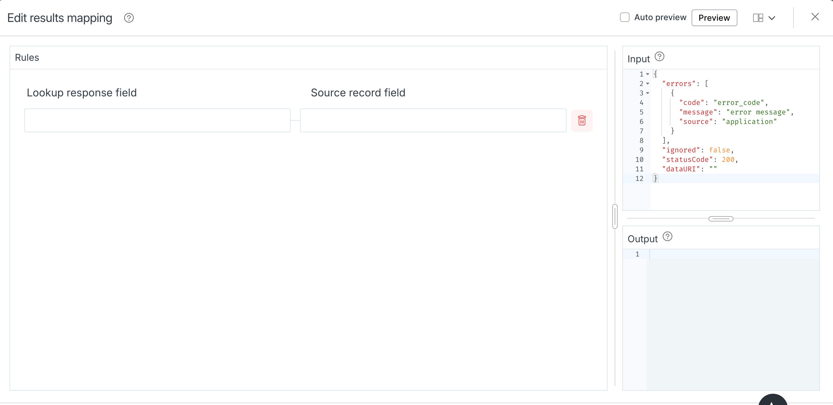

  • Results mapping (lookup): Results mapping is similar to response mapping, but instead of returning the response after an import, results mapping allows you to merge the resulting records returned by a lookup in your API back into the provided data. The returned lookup records can be used later in the API.

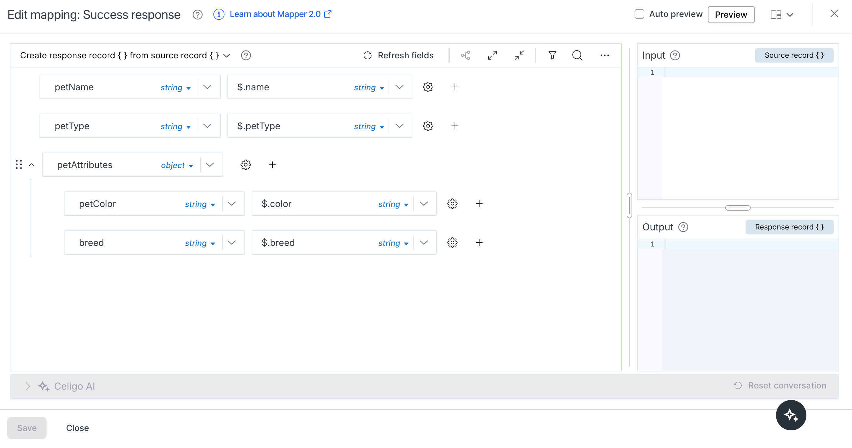

Map your API response
In the API response step, click + → Mapping (mapping.svg) to open the Mapper.
The schema can include arrays, objects, nested fields, etc., and the supported media type is JSON. You can use handlebars to supplement your mappings in cases where you have complex data requirements.
Click Auto preview or Preview to view the HTTP response body and other details you've added to your API response.

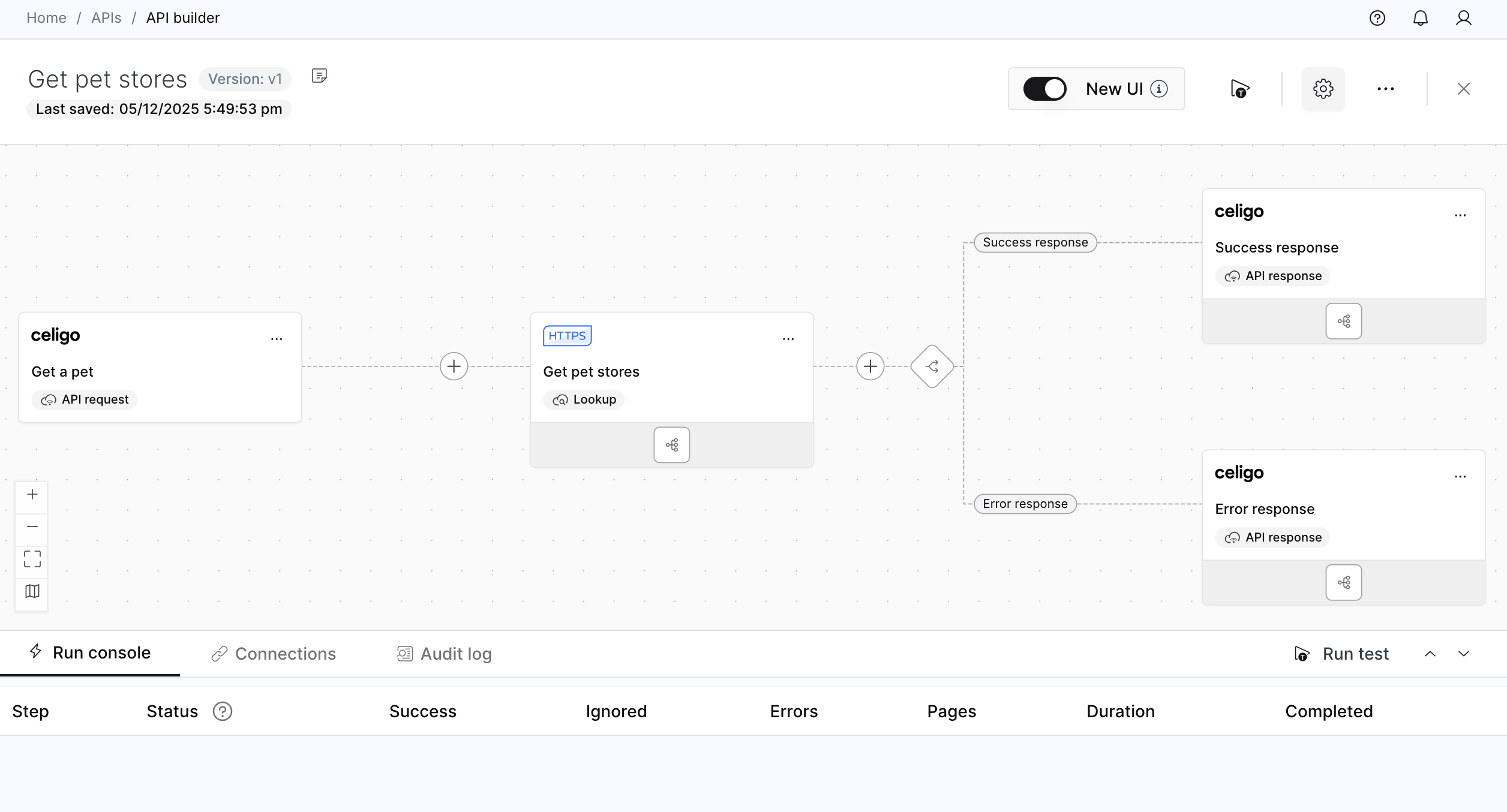

Get all pet stores
Relative URI: /stores/
This API includes one request, one lookup, and two responses.
API request
  "method": "GET",
  "endpoint": "/stores/",
  "headers": {
    "Authorization": "Bearer <your_api_token>",
    "Content-Type": "application/json"
  "query_parameters": {
    "limit": 10,
    "offset": 0,
    "sort": "name",
    "order": "asc"
Lookup: Get all pet stores
A lookup allows you to process the request data and use it to search ("look up") the information for all pet stores. In this lookup step, you'll want to configure the request mapping so the data your API consumer sends is properly mapped to your database.
API response: Successful retrieval of pet stores

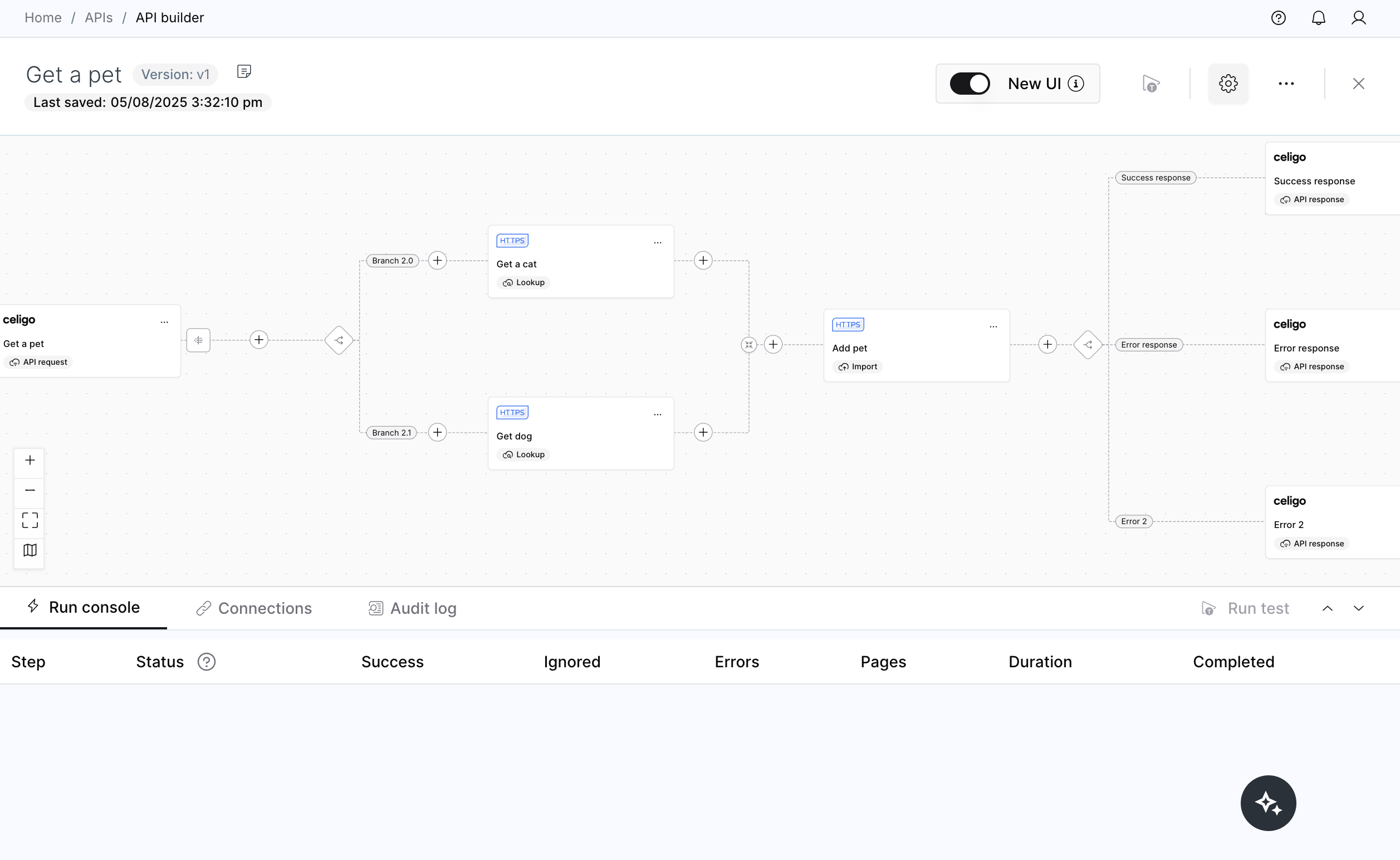

Get a pet
This API includes one request, three lookups, and two responses. The request retrieves details of a specific pet and its health records from a store.
Relative URI: /stores/:storeId/pets/:petId,
API request
  • storeId (123): Represents the specific store (vet office or pet store).
  • petId (101) → Unique identifier for the pet.
  "method": "GET",
  "endpoint": "/stores/123/pets/101",
  "headers": {

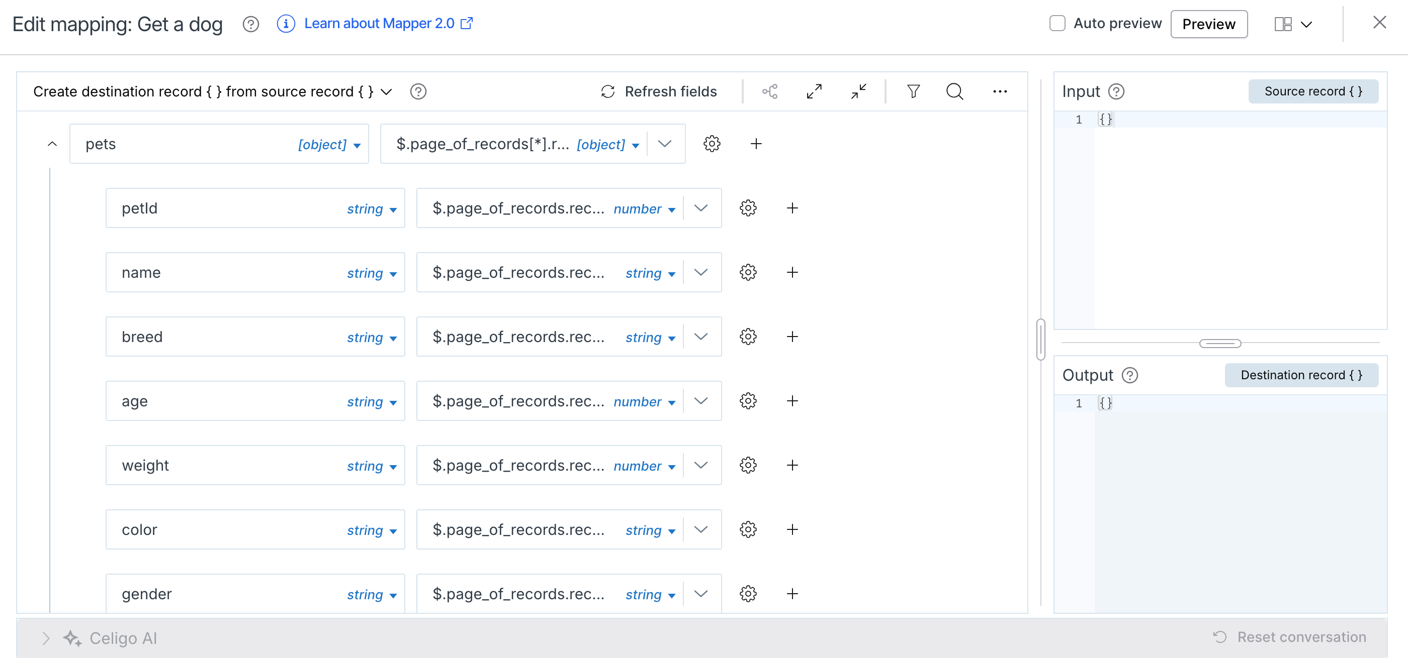

Lookup: Get a dog
A lookup allows you to process the request data and use it to search for ("look up") a dog. In this lookup step, you'll want to configure the request mapping so the data your API consumer sends is properly mapped to your database.
Lookup: Get a cat
A lookup allows you to process the request data and use it to search for ("look up") a cat. In this lookup step, you'll want to configure the request mapping so the data your API consumer sends is properly mapped to your database.
Lookup: Get health records
A lookup allows you to process the request data and use it to search for ("look up") the dog or cat's health records. In this lookup step, you'll want to configure the request mapping so the data your API consumer sends is properly mapped to your database.
