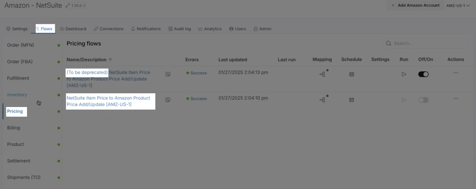

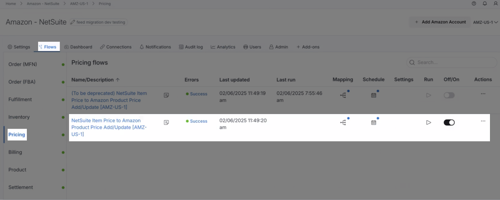

Migrate to new pricing flow
  1. Open your Amazon - NetSuite integration app.
  2. Navigate to Flows > Pricing.
  3. Turn off the toggle for the flow: (To be deprecated) NetSuite Item Price to Amazon Product Price (Add or Update).
    Note: Ensure that you don’t turn on the new flow before turning off the old flow.
  4. Turn on the toggle for the flow: NetSuite Item Price to Amazon Product Price (Add or Update).
