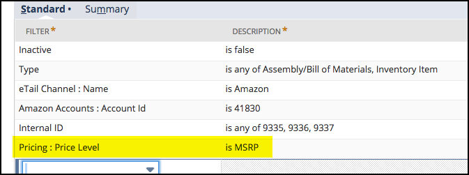

See the search configuration below:

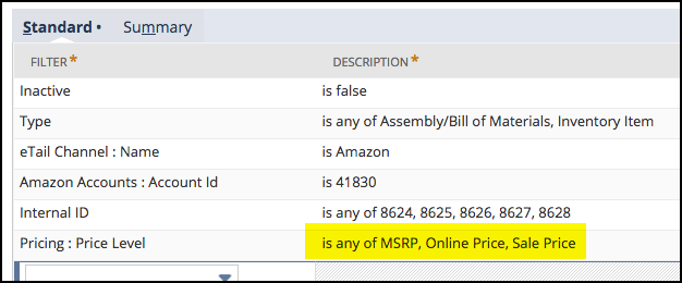

  • In the criteria, add a filter for the price level:

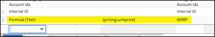

  • In the results, add the unit price:

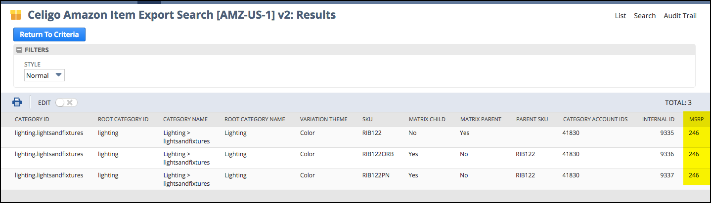

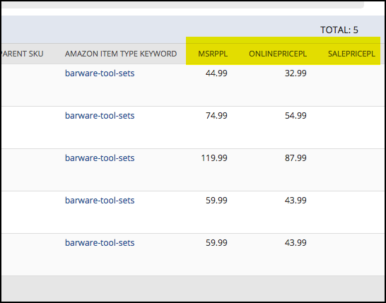

  • It will appear like this when you preview the search:

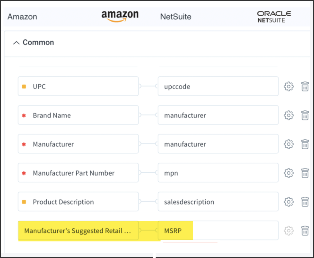

  • You can then use that column in the mapping:

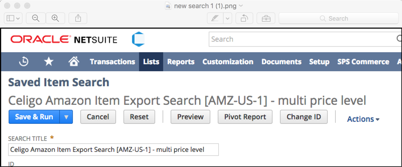

Update your saved search as in the sample below:

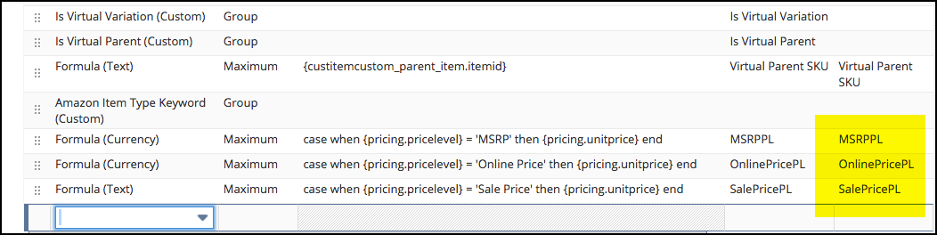

  • Add the criteria for the 3 price levels:
  • Next, add groupings for each price level to make them appear on a single column which can be used in the mappings:
This is how it appears in the search:
