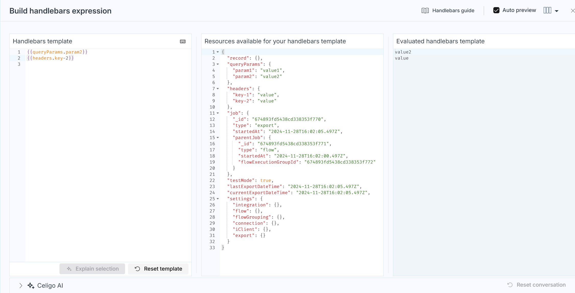

Use the following steps to reference webhook headers and query parameters with a handlebars expression:
  1. Click the settings gear (settings_gear.svg​) for the transformation row.
  2. Select Handlebars expression from the Field transformation type drop-down list.
  3. Click (pencil_handlebars.svg) to open the Build handlebars expression AFE.
Webhooks created in the Celigo platform have the following JSON structure:
  "record": {},
  "queryParams": {
    "param1": "value1",
    "param2": "value2"
  "headers": {
    "key-1": "value",
    "key-2": "value"
  "job": {
    "_id": "674893fd5438cd338353f770",
    "type": "export",
    "startedAt": "2024-11-28T16:02:05.497Z",
    "parentJob": {
      "_id": "674893fd5438cd338353f771",
      "type": "flow",
      "startedAt": "2024-11-28T16:02:00.497Z",
      "flowExecutionGroupId": "674893fd5438cd338353f772"
  "testMode": true,
  "lastExportDateTime": "2024-11-28T16:02:05.497Z",
  "currentExportDateTime": "2024-11-28T16:02:05.497Z",
  "settings": {
    "integration": {},
    "flow": {},
    "flowGrouping": {},
    "connection": {},
    "iClient": {},
    "export": {}
