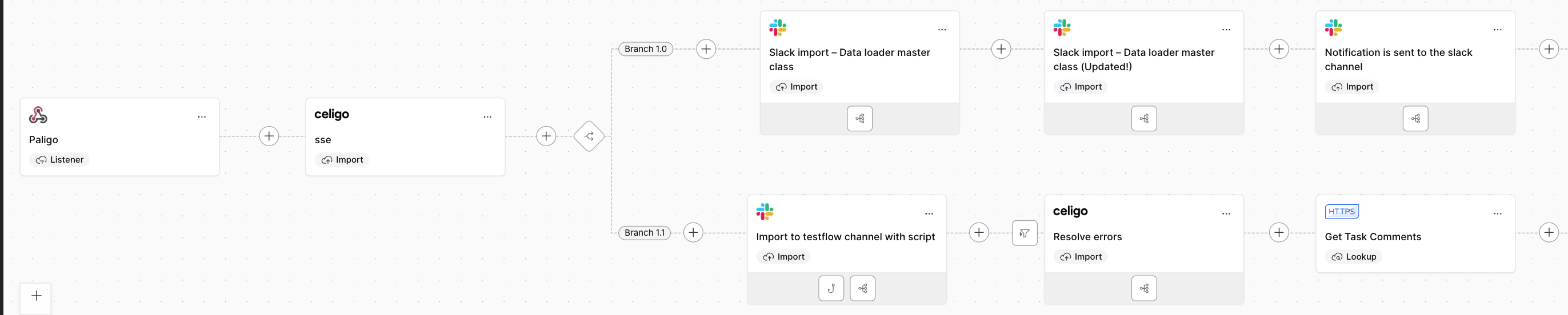

  1. There is one source and many destination steps: In this case, transformations let you simplify the data before it is processed by multiple imports. For example, if you create an export with many fields, objects, arrays within arrays, or other complicated JSON structures, you can use a transformation to flatten or simplify the record so only the needed information is sent to the next steps.

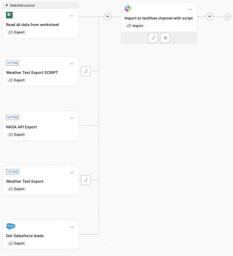

  2. There are many sources and one destination: In this scenario, transformations help you modify the data from all the sources so it's only processed once by the destination app. For example, if you are syncing a MongoDB database to Snowflake, you can use transformations to map those source records over to a canonical representation of data that your flow wants to process.

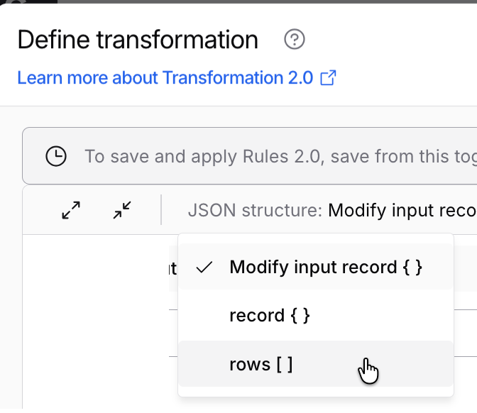

There are three modes you can use in Transformation 2.0. The modes are available in a dropdown near the top, left-hand side of the screen.
Three modes
  1. Modify input record { }: This mode is useful when you want to make simple targeted changes to source records but keep everything else in the source records as-is.
  2. Record { }: This mode is helpful when creating a new output record from the source record. It lets you define the output record from scratch, so you can pick and choose only the fields you need from the source record. It's also useful when you want to transform the data from multiple different sources into a canonical format that the flow can then process, making it easier to add new sources in the future.
  3. Rows [ ]: This mode is used when you want to transform record-based data into row-based data. For example, you can transform an object into row-based data to build a CSV file where rows with the same key column must always be kept together in the same file.

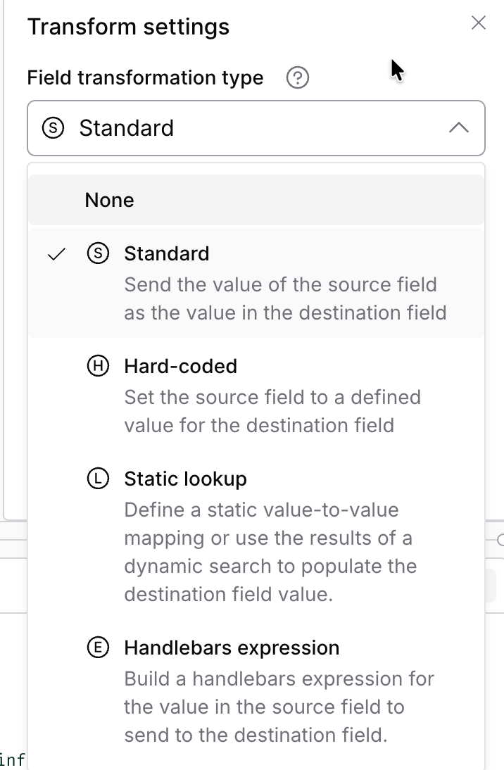

Transformation 2.0: Field types
There are four transformation field types:

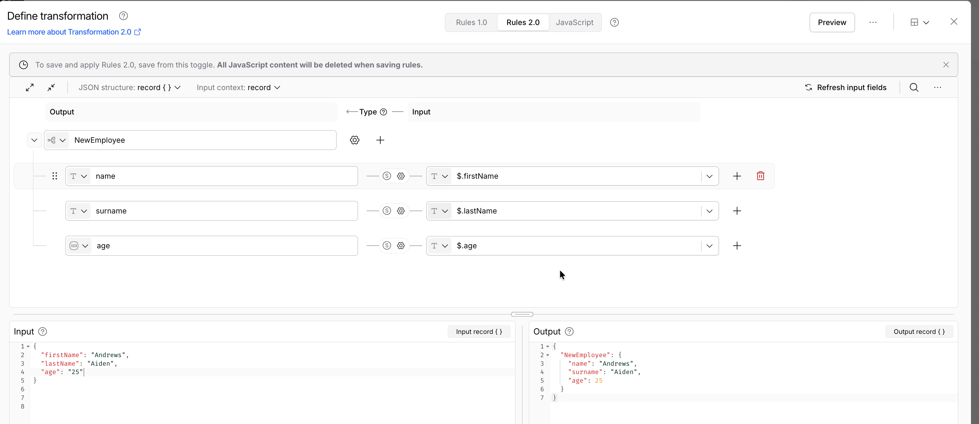

  1. Standard: This is the default transformation type. Use it when you want to map a field directly from the source record to the output record.
  2. Hard-coded: This is useful when you want to set a specific, static value for a field in the output record. For Object and ObjectArray output fields, enter a static JSON value directly — a JSON object or a JSON array of objects — instead of using JSONPath or a handlebars expression. This applies across exports, lookups, and imports. For details, see Transformations 2.0: Field settings.
  3. Lookup: This is used when defining a table containing input-to-output value mappings. For example, every time you see "apple" change it to "banana".
  4. Handlebars expression: This is useful for creating a custom value for a field in the output record using a handlebars template. This option lets you build any type of output and is particularly useful when you want to concatenate fields, multiply numbers, source from custom settings in the flow, or perform any other complex processing on input field values.

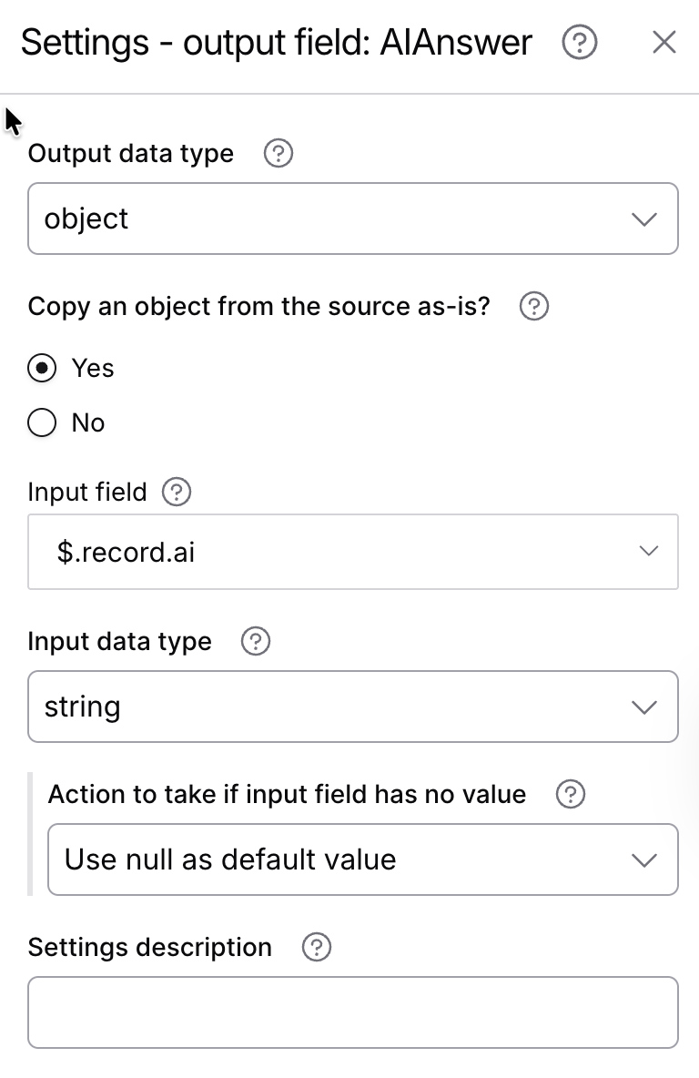

The supported output and input data types include string, number, boolean, object, string array, number array, boolean array, date, and object array. Recursive definitions are also supported.
The transformation 2.0 engine automatically converts data types where possible. For example, if a number is mapped to a string, the platform will automatically convert the number to a string. However, some data types are not compatible with each other, and this will cause the mapping to fail. See how all the different input and output data types are mapped.
The Action to take if the input field has no value field lets you configure a custom value, null, or an empty string.

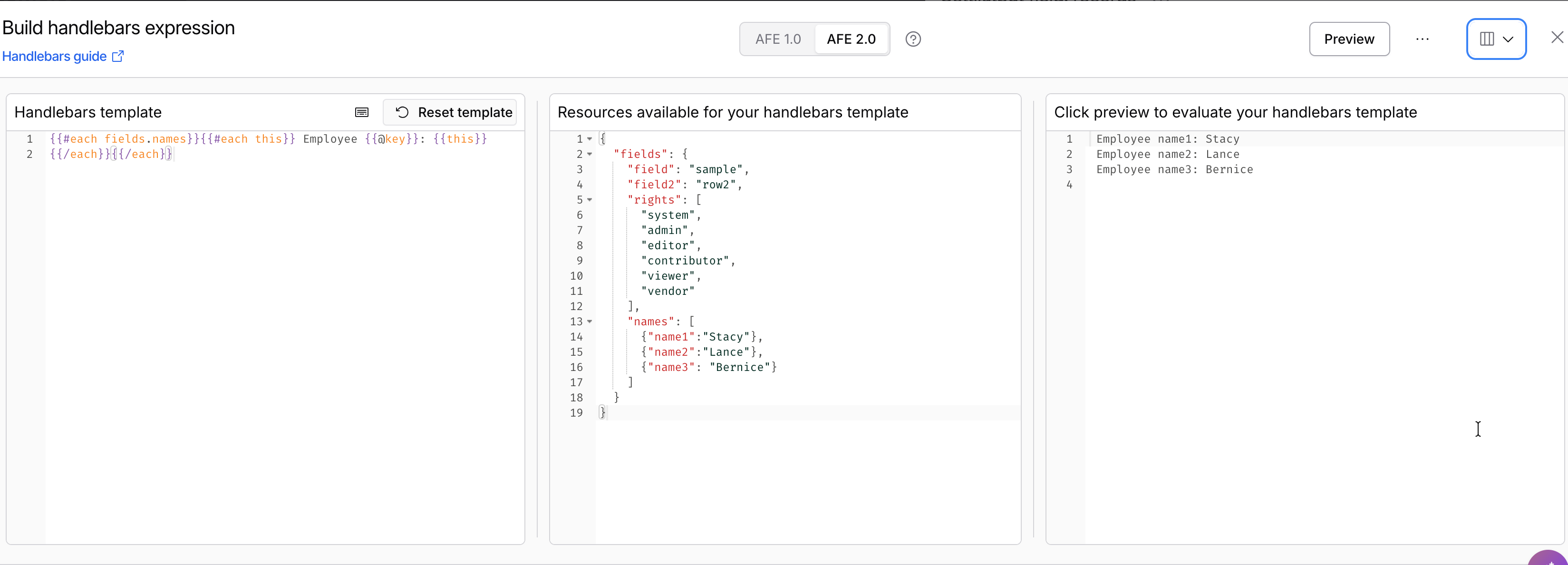

Handlebars expressions: Handlebar expressions can be used whenever you need to generate an output field that is not just a single field from the source record. It's useful if you need to concatenate fields, multiply numbers, encode or decode strings, format multiple fields uniquely, or source values from custom settings in the flow.

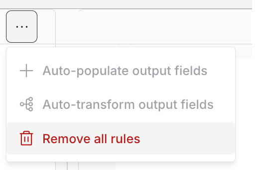

  • Actions menu
    • Auto-populate output fields: Automatically generate the output JSON structure with the output expected field names.
    • Auto-transform output fields: Automatically transform the output JSON fields.
    • Remove all rules: If you decide to start over, you can remove all the rules in one-go using this option.

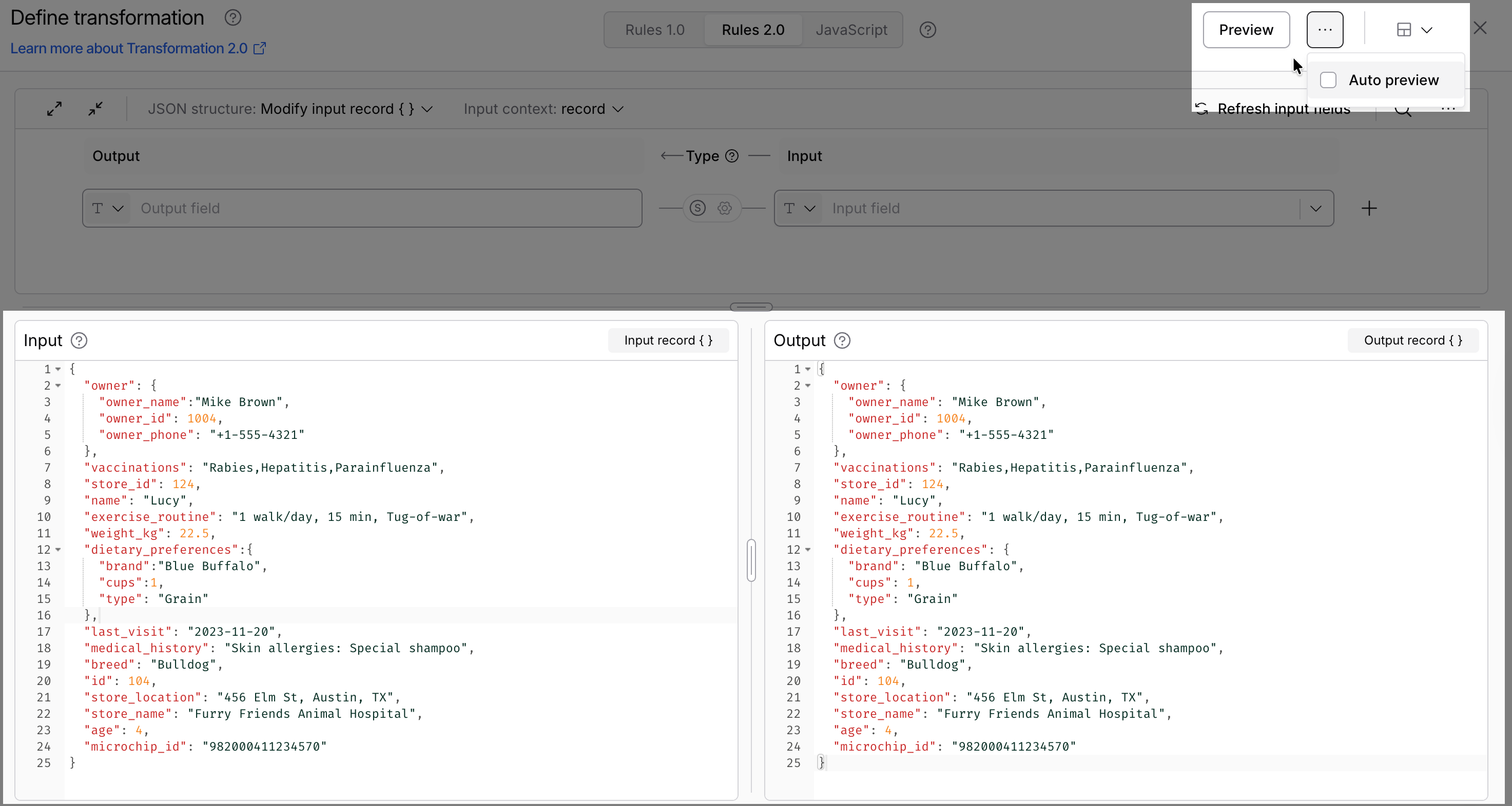

  • Preview and auto-preview:
    Use Preview and Auto-preview to ensure that the transformations and mappings are working as expected. Testing and previewing lets you verify your results and mappings as they're built. For example, when creating a new field, use Preview to see the exact output based on the input record you're working with. This lets you make sure that the field is working exactly as you want it to.

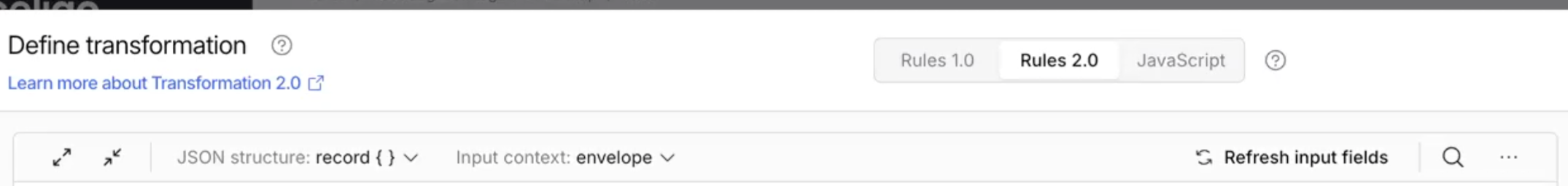

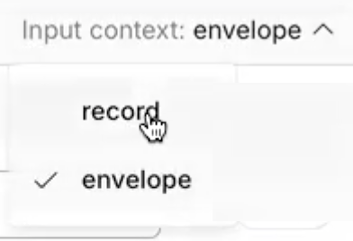

Choose the JSON input context
The Input context setting determines the structure of the incoming data payload and how fields are referenced. There are two primary options: record and envelope.
The record context is simple and limited in scope, focusing only on the raw, core data from the source application. Referencing is direct, with the record as the root (for example, $.field). This option is best suited for straightforward integrations that only require the core business data for processing.
The envelope context is comprehensive. It wraps the core data record with essential runtime metadata and execution details. Because the envelope acts as the root, the core data record is nested (for example, $.record.field). The main advantage of the envelope option is the access it provides to dynamic runtime objects. These include job details ($.job.*), settings ($.settings.*), query or path parameters ($.queryParams.*, $.pathParams.*), and — on file provider export and lookup steps — file metadata ($.fileMeta.*). This option allows clean, direct JSONPath references to both the core data and the crucial metadata, eliminating the need for complex Handlebars expressions to access runtime execution details.

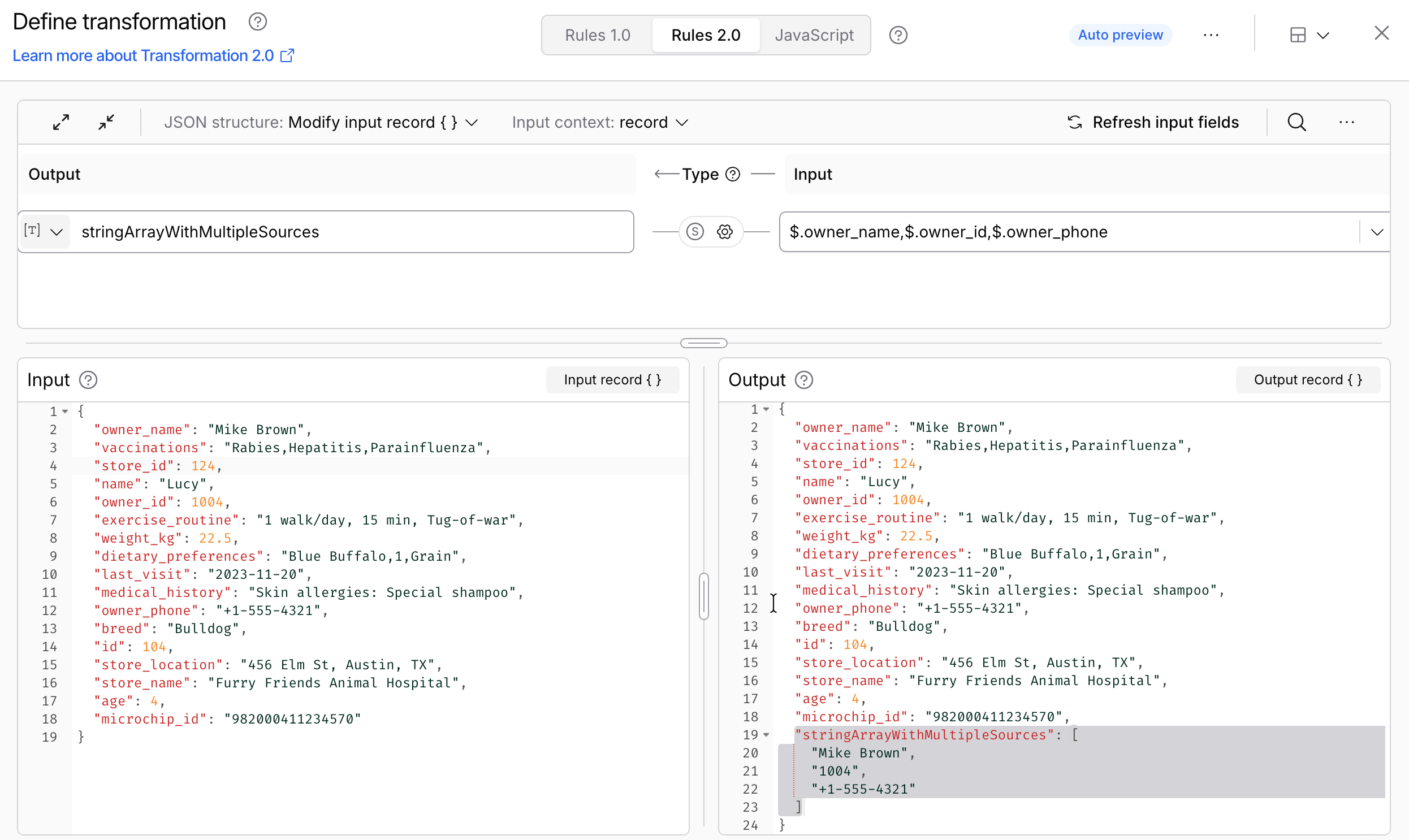

Create string array sourcing from multiple different places in the input.

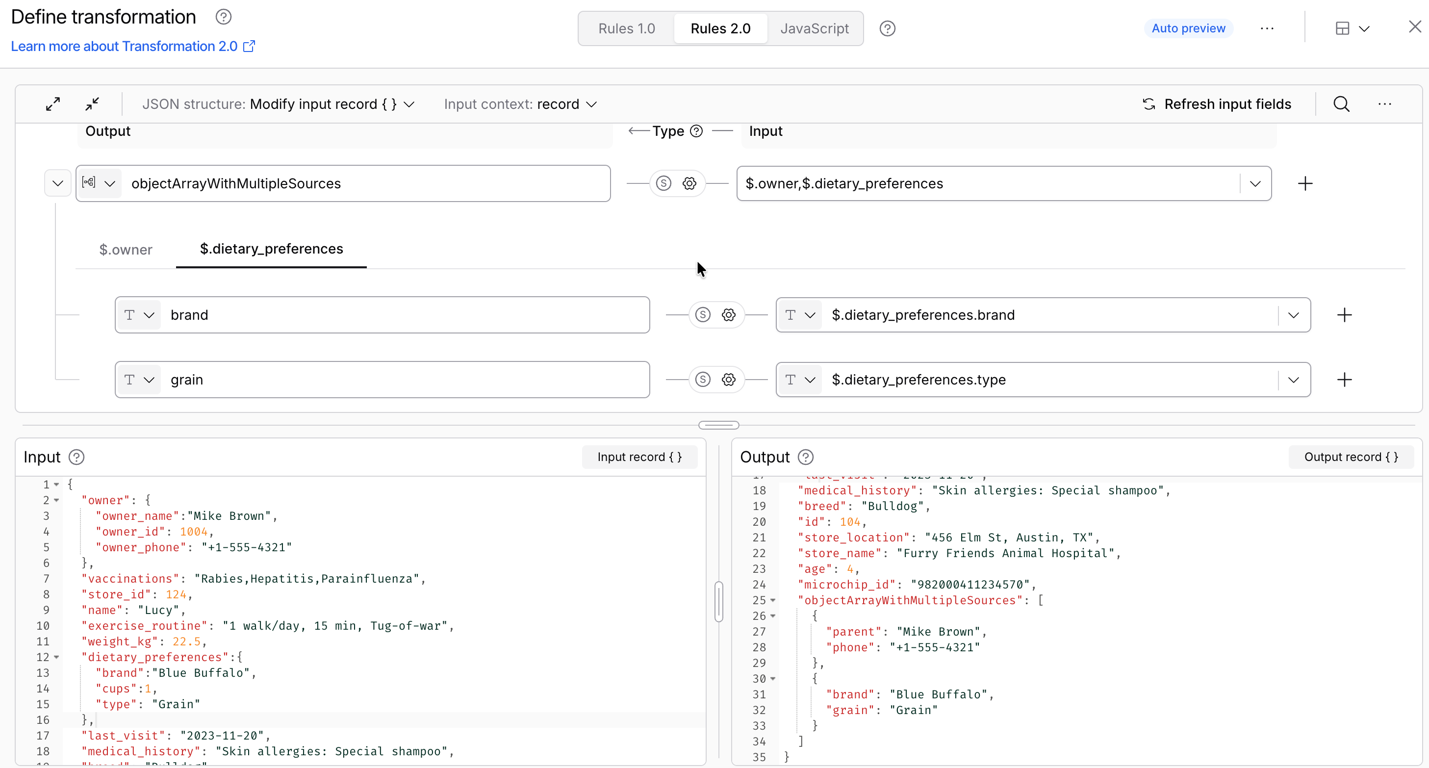

Create object array sourcing from multiple different places in the input.

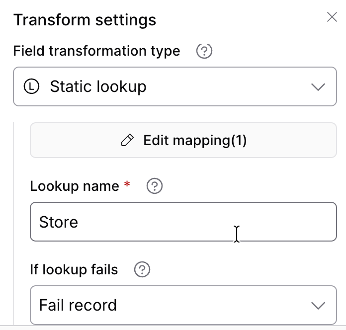

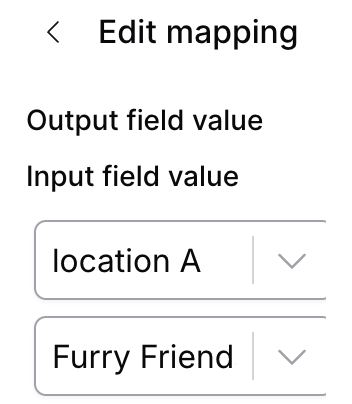

Use a static lookup to translate values between input and output records.
