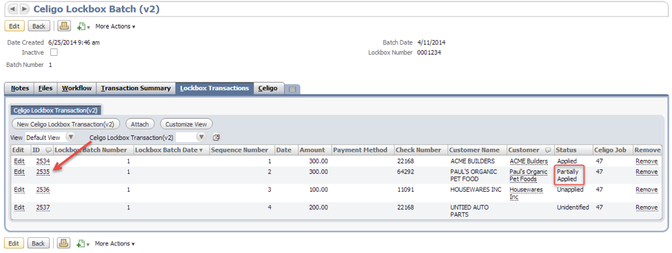

  1. Navigate back to the Celigo Lockbox Batch by clicking on the hyperlink as shown below.
  2. Navigate again to Lockbox Transactions tab and locate a line with a Status of Partially Applied .
  3. For that row, click on the ID number, not Edit, as shown below.

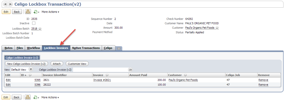

  4. Navigate to the Lockbox Invoices tab. Are there multiple invoices for the payment? Is one or more matched, and one or more unmatched?
  5. In the example above, one invoice is paid and the other is not.

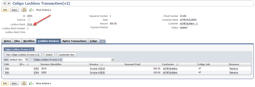

  7. Return to the transaction (by clicking on the Lockbox Transaction number in the custom tab or going back in your browser). Here, you can see that the transaction has changed to Applied.
