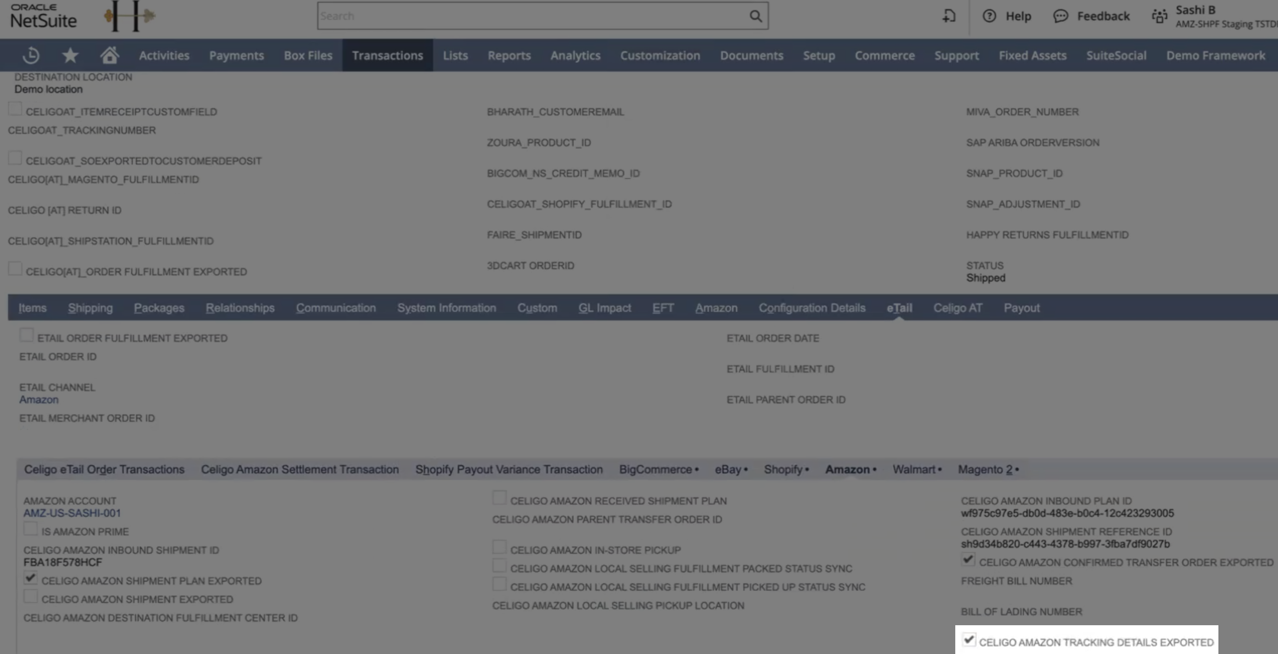

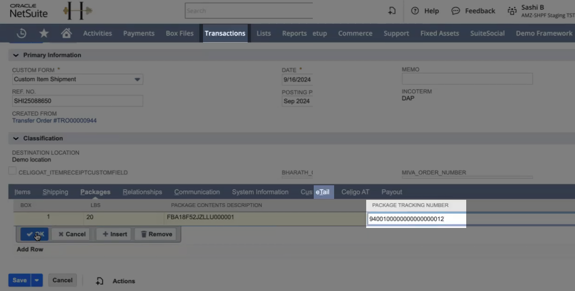

This flow ensures that tracking details from item shipments in NetSuite are synced with Amazon shipments, maintaining accurate shipment tracking across both platforms.
  1. Get Item Shipments with Tracking Details from NetSuite (Export): This step retrieves the item shipments along with their tracking details from NetSuite, ensuring that all relevant shipment information is ready for synchronization.
  2. Post Tracking Details to Amazon Shipments (Import): The retrieved tracking details are synced from NetSuite to Amazon, ensuring that Amazon has up-to-date tracking information for the associated shipments.
The NetSuite Tracking Details to Amazon Tracking Details flow automates the transfer of tracking information, including the tracking ID, package tracking number, freight bill number, bill of lading number, and more, from NetSuite to Amazon. This ensures accurate and consistent shipment tracking across both systems.

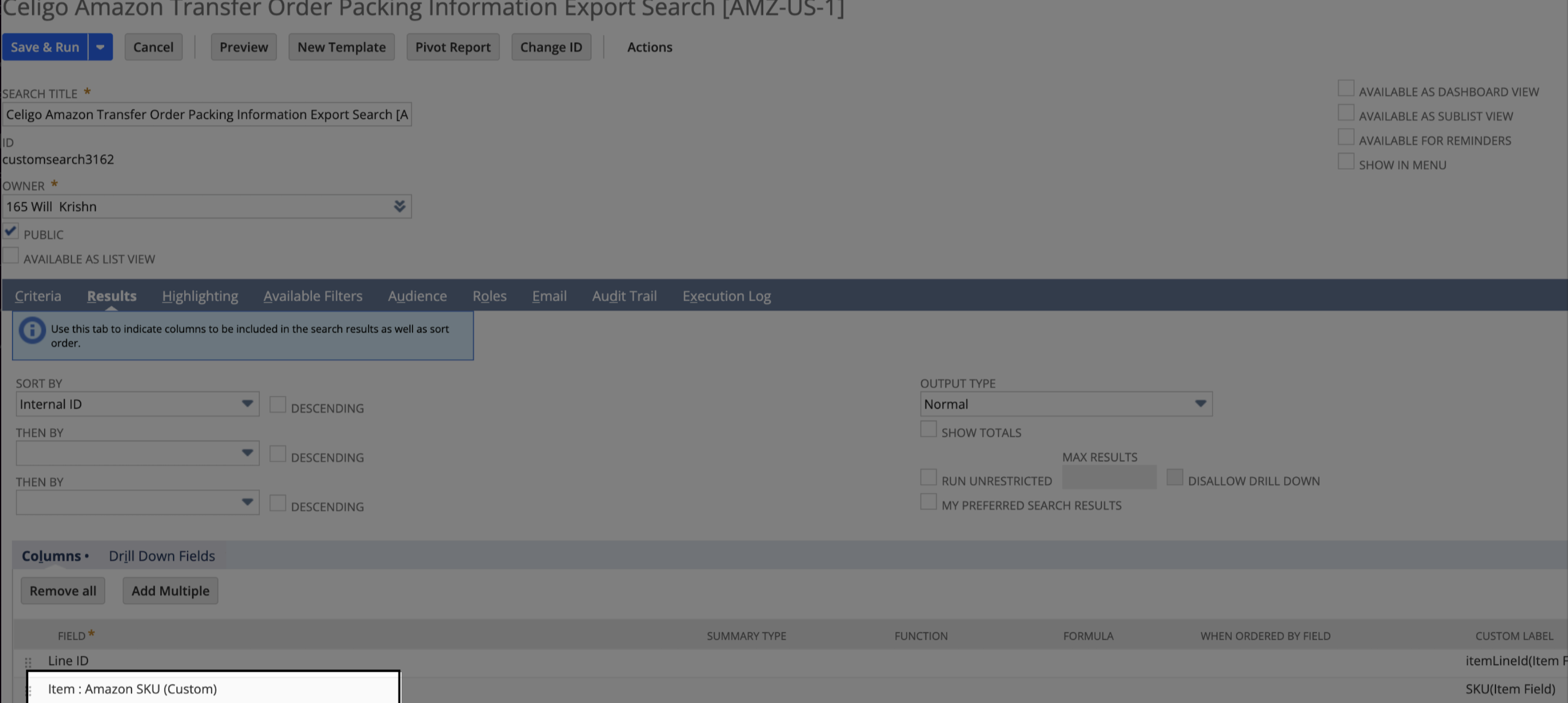

When using a custom field for the SKU, ensure that the default or standard SKU field is replaced with the custom SKU field in the item criteria of all three transfer order saved searches listed below:
  • Celigo Amazon Shipment Plan Export Search
  • Celigo Amazon Transfer Order Packing Information Export Search
  • Celigo Amazon Confirmed Transfer Order Export Search
Refer to the screenshot, where the default Item field is replaced with Amazon SKU (Custom).

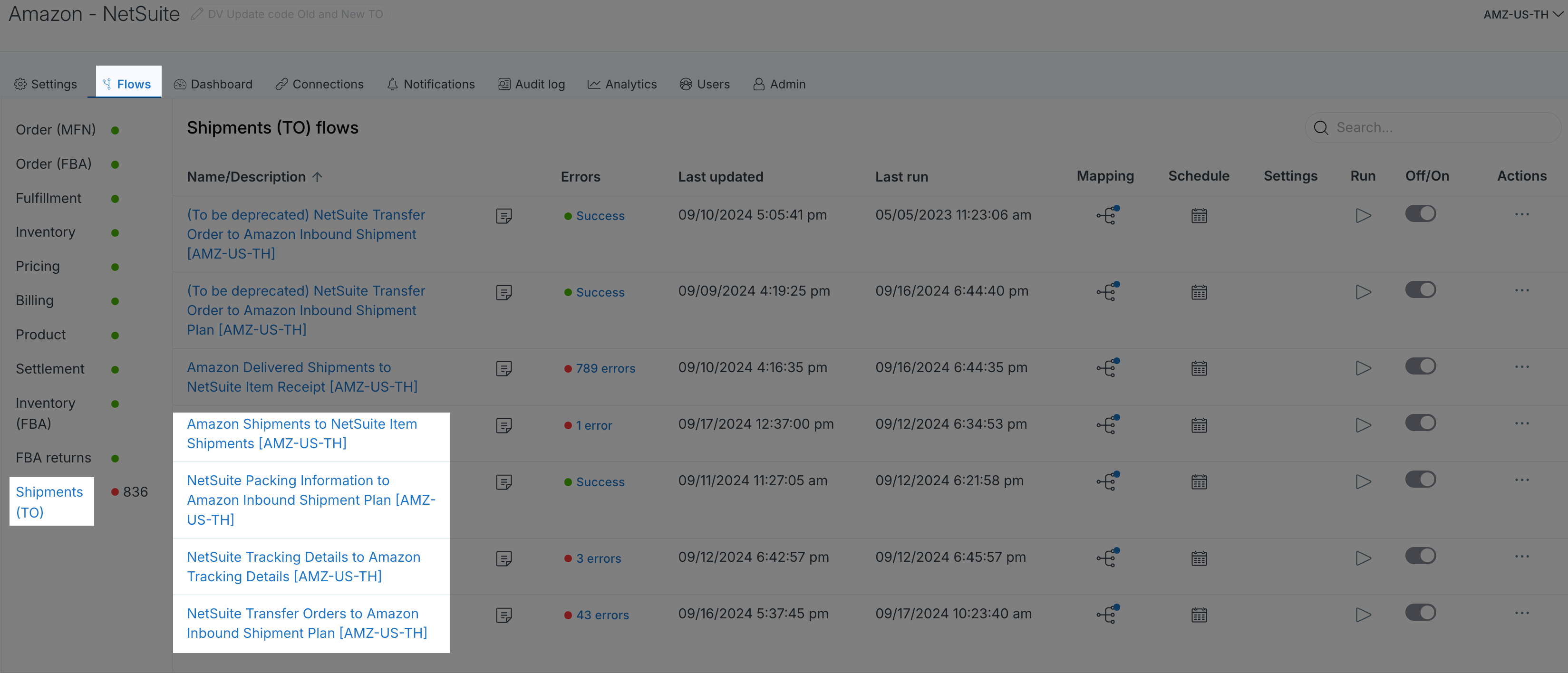

Currently, the flows are sorted alphabetically. To ensure proper operation, configure and run the flows in the following sequence:
  1. NetSuite Transfer Orders to Amazon Inbound Shipment Plan
  2. NetSuite Packing Information to Amazon Inbound Shipment Plan
  3. Amazon Shipments to NetSuite Item Shipments
  4. NetSuite Tracking Details to Amazon Tracking Details
  5. Amazon Delivered Shipments to NetSuite Item Receipt
The Transfer Order (TO) - Shipment add-on uses scheduled data flows to automatically fetch transfer orders from NetSuite and create Inbound Shipments and Inbound Shipment Plans in Amazon. This automation saves time and reduces the risk of errors when managing shipments between NetSuite and Amazon's FBA network.
By following the above-mentioned flow sequence, you ensure each step is completed in the correct order, enabling smooth synchronization between NetSuite and Amazon.

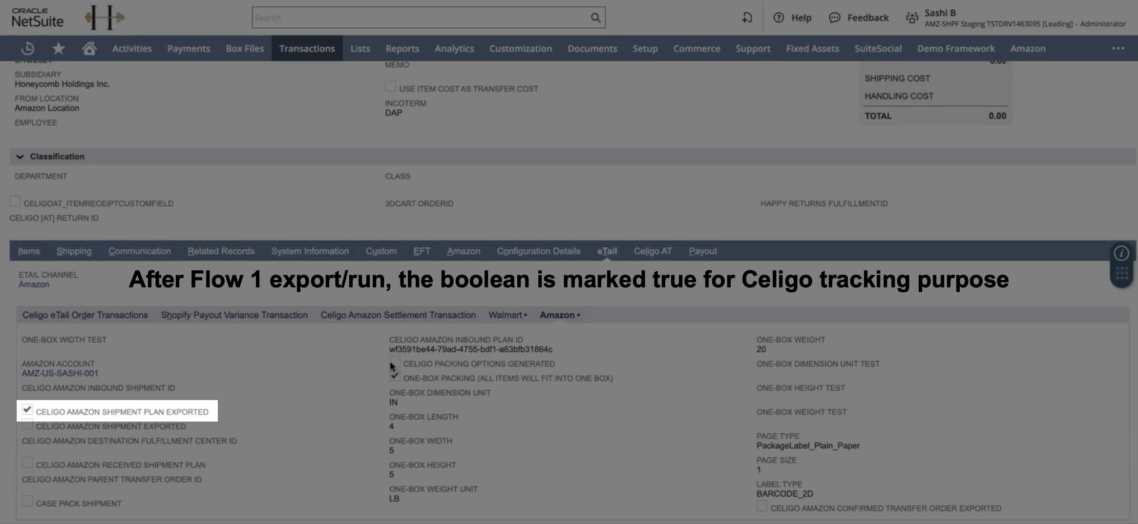

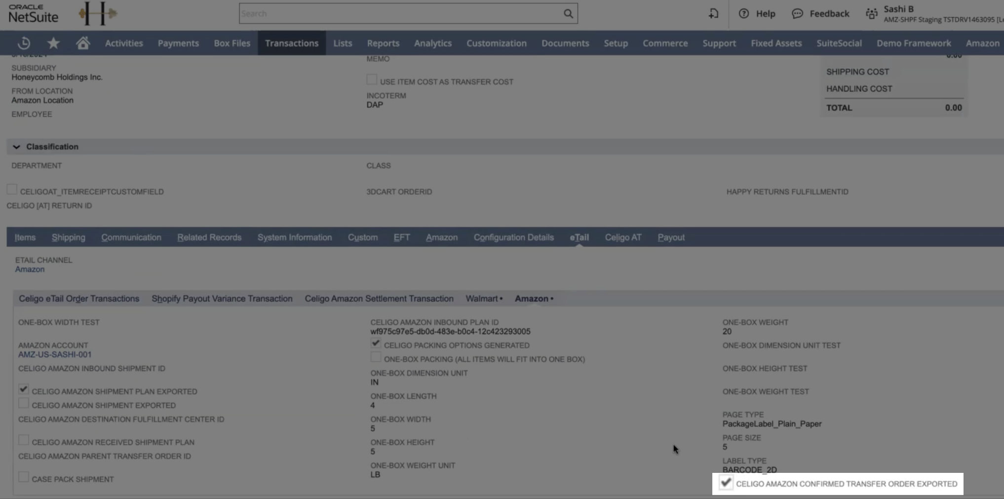

After the flow is completed, the Celigo Amazon Shipment Plan Exported checkbox on the NetSuite transfer order record is automatically selected to prevent the same plan from being processed multiple times by the flow.

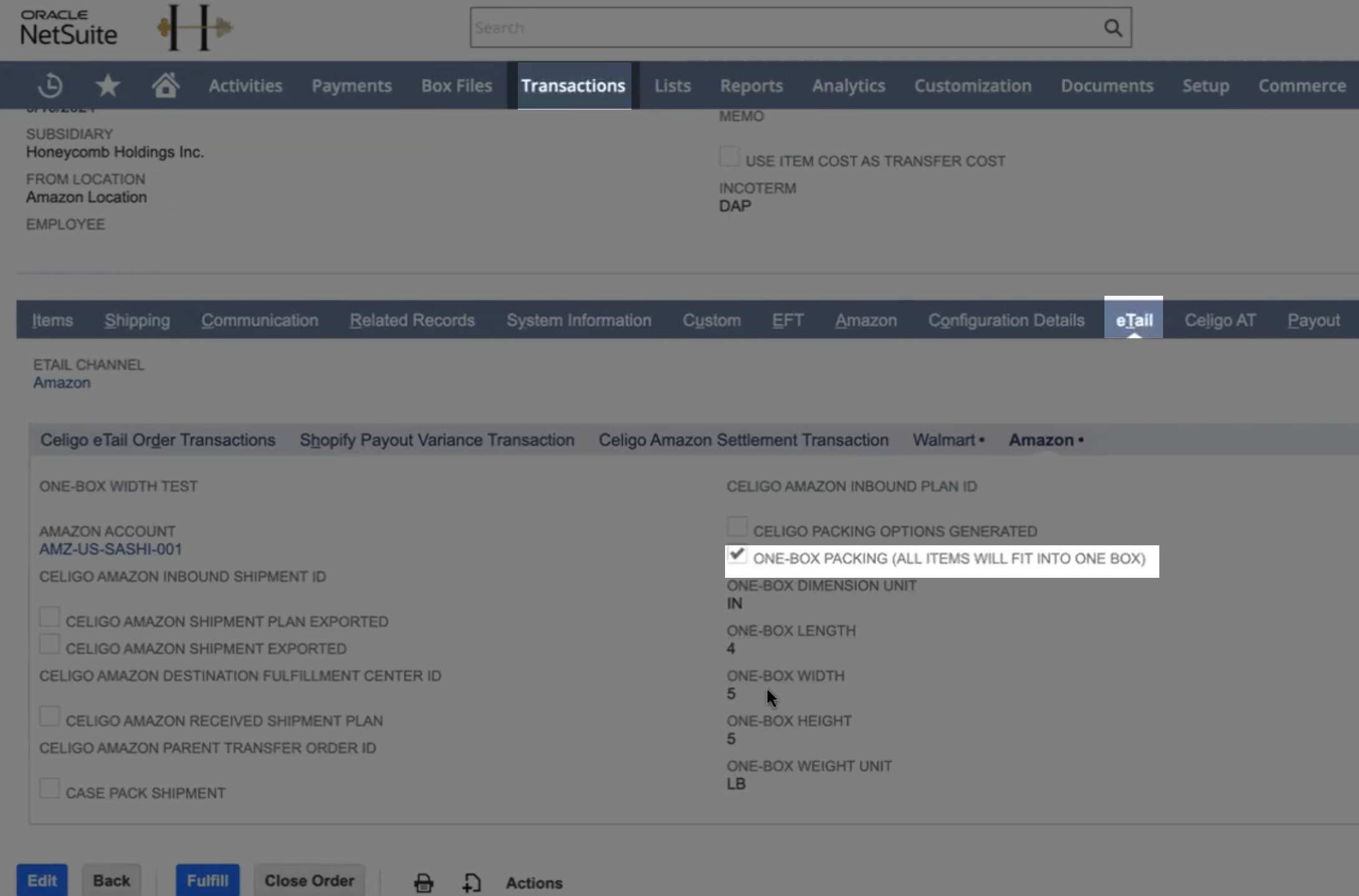

  • To ship all items and quantities in a single box, make sure to select the One-Box Packing (All items will fit into one box) option under Transactions > Transfer Order record > eTail tab. Additionally, provide the box details, including length, width, height, and weight unit. These details will be retrieved using the Amazon Inbound Shipment Plan ID, which is received after running the NetSuite Transfer Orders to Amazon Inbound Shipment Plan flow.
  • To ship items in multiple boxes, the dimensions of each box are determined based on the item record fields. You must provide the details for each box, including length, width, height, and weight unit, as specified by the item.

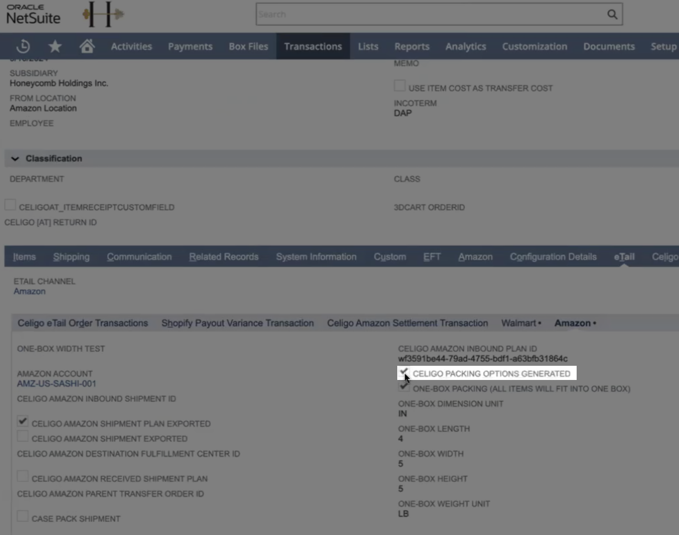

After the flow is completed, the Celigo Packing Options Generated checkbox on the NetSuite transfer order record is automatically selected to prevent the same packing information from being processed multiple times by the flow.

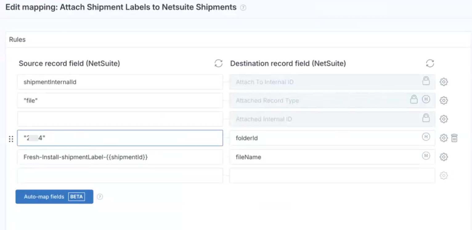

  • Ensure you configure the mapping for the folderId field in the Attach Shipment Labels to NetSuite Shipments import as shown in the screenshot. With this configuration, the app can download the shipment labels PDF, store them in the specified NetSuite folder, and attach them to the corresponding NetSuite shipments.

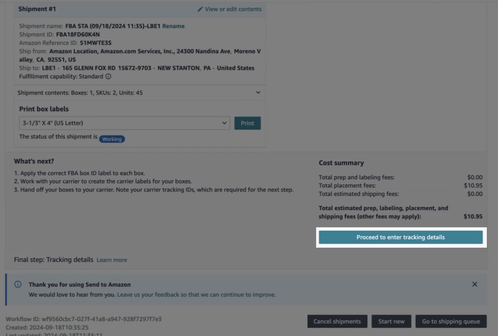

  • Confirm and process each shipment plan in Amazon (Shipments > Send to Amazon tab). Be sure to provide the ship date, select the shipping mode, choose the shipping carrier, and specify the delivery window.

  4. Run the Amazon Shipments to NetSuite Item Shipments flow.
If you are using case pack shipments, complete the case-pack configuration and run the NetSuite Packing Information to Amazon Inbound Shipment Plan flow before running this flow. See Configure case pack shipments.
After the flow is completed, the Celigo Amazon Confirmed Transfer Order Exported checkbox on the NetSuite transfer order record is automatically selected to prevent the same transfer order from being processed multiple times by the flow.

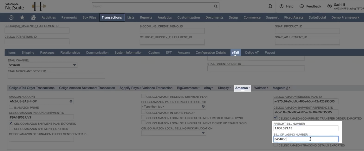

Configure and run the Tracking Details flow
Important: Do not run this flow if you are using “Amazon partnered carriers”.
Prerequisites
In NetSuite
Before running the NetSuite Tracking Details to Amazon Tracking Details flow, perform the following actions:
  • For SPD (small parcel delivery) - ensure that you provide the package tracking number in the Package Tracking Number custom field.
  • For LTL and FTL (less than truck load/ full truck load delivery) - ensure that you provide the freight bill number and bill of lading number in the Freight Bill Number and Bill of Lading Number custom fields. In the Freight Bill Number field, you can add multiple values separated by a comma.
In Amazon
  • In the Shipments tab > Send to Amazon > open the shipment plan, ensure that you click Proceed to enter tracking details.
To configure and run the flow:
  1. In integrator.io, click the integration app tile.
  2. Enable the NetSuite Tracking Details to Amazon Tracking Details flow.
  3. Click Save.
  4. Run the NetSuite Tracking Details to Amazon Tracking Details flow.
After the flow is completed, the Celigo Amazon Tracking Details Exported checkbox on the NetSuite item shipment record is automatically selected to prevent the same tracking details from being processed multiple times by the flow.

Required changes for Matrix items in Shipment flows
If you're using matrix items in the Shipment flows, you must modify the saved search to ensure the SKU appears in the correct format.
Update the saved search for the following flows:
  • Use Formula (Text) against the SKU (Item Field) instead of {item}.
  • Apply the following formula:
CASE NVL({item.parent},'0') WHEN '0' THEN {item.itemid} ELSE SUBSTR({item.itemid}, INSTR({item.itemid}, ' : ', -1) + 3) END
After the saved search update
  • The SKU format will change from "parent item: child item" to "child item".
  • After updating the saved search, create a new Transfer Order (TO) and test it, starting from the first flow.
