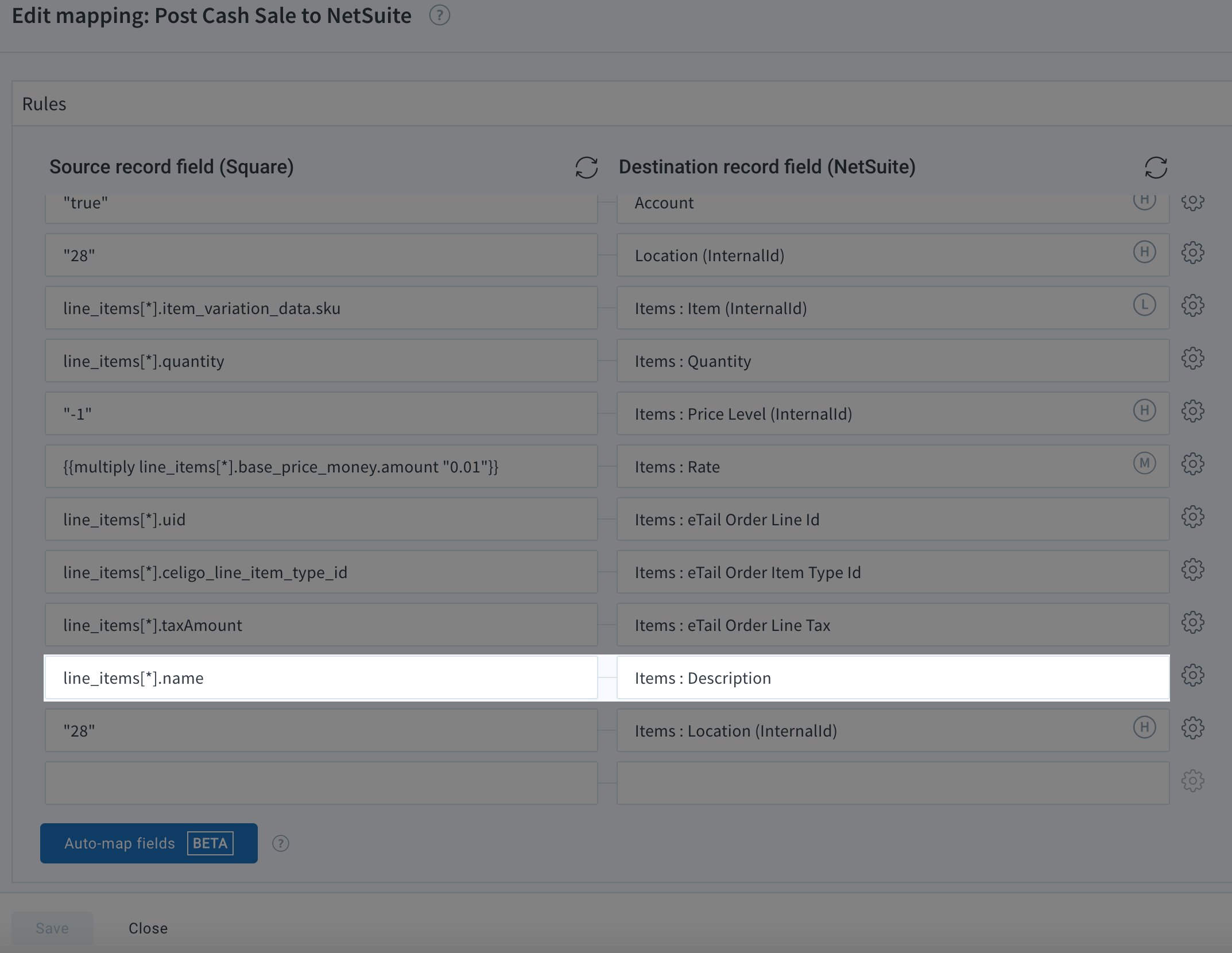

Note: The description field in NetSuite cash sale and cash refund displays the modifier name only when you add the item description mapping to the cash sale, as shown in the following screenshot.
