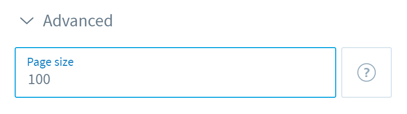

integrator.io page size
When integrator.io gets data from a source, it splits the response into “pages” for queueing and further processing. Simply put, a page chunks up data into a discrete number of records to make them more manageable for processing and sending downstream to be imported into their destination.
The default page size is set to 20 records. You can modify the Page size advanced setting of an export for fewer or greater than 20 records, up to 5 MB per page. In fact, there is no upper limit to the number of pages or the amount of data you can export.
Tip: For one strategy to reduce record size, see Restructure payload with a preSavePage hook.
For performance purposes, note that the page size does not take into account the size of each record. A page size of 10 could return a 2 KB page or a 4.9 MB page, depending on the data requested.
To get an idea of the size of data flowing through the integration, multiply the average page size by the number of pages. For example, if a page is typically 1 KB and your export retrieves 38 pages, you will have a total of around 38 KB of records. Navigate to your Run dashboard to see the summaries of pages exported.
Often, the biggest factor determining ideal page size is the destination app where the data will be imported. NetSuite, for example, can reject attempts to write or update large data sets in a single request, so the page size should not exceed 100 records. Even then, if the records themselves are large, containing things like sales orders with line items, you may want to reduce the page size further to 10 or 20 records for optimal throughput and to avoid governance errors.
On the other hand, when syncing with a database system, such as MongoDB, or a data warehouse app, a page size of 1,000 records might be preferred.
Finally, with respect to pagination, keep the processing overhead in mind. In general, the smaller the page size, the slower the flow will run, since pages are processed individually from the queue. With real-time listeners, for example, the page size is often for a single record that the app sends to integrator.io. The performance overhead of a smaller page size is negligible per page, but it’s something to be aware of when fine-tuning these settings.
Note: You may be familiar with the pagination procedure for a specific API, in which results are returned in a series of pages at a maximum number of records each. Do not confuse API pagination with integrator.io page size. When exporting data with a prebuilt connector, you don’t have to be concerned with an API’s page count or limit; integrator.io first retrieves the complete set of data from the API and then splits it into pages according to the page size you specify.

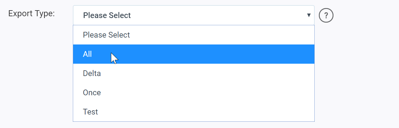

Export types
Data can be exported via four different methods, which will affect the quantity of the data returned, in descending order:
- All – Export all matching records each time the export is run
- Delta – Export all matching records with a date/time value greater than the last time the data flow was run
- Once – Export any data that has not been exported already and also update records to mark them as exported
- Test – Export only one record by default; used for testing, to avoid syncing lots of data
All
This type returns anything that matches the selection. For a database such as MySQL, it would include the records for anything retrieved by your MySQL query, which could be every item in a large table.
If you’re exporting a lot of data with unchanged records, consider narrowing the export type by selecting another option.
Delta
Delta flows drastically improve performance. They export only the matching records that were changed or created since either of the following benchmarks:
- If the last flow ran successfully, meaning that the flow was completed and the last job record had a positive page size
- A custom date and offset that you specified occurred in the past
Delta flows rely on the source system’s lastModified date.
Once
This setting lets you export a record, after which it will be marked as submitted in the source application and not exported again. It ensures that a record that you want to remain unique, such as a sales order, is not sent twice.
For example, you may want to sync all orders that have not been shipped to a warehouse. Within the same flow, you may also need to change the billing ZIP code – an operation that does not impact shipping, but doing so would update the lastModified date of the order. Setting Export type to Once will ensure that the record is marked as exported and not retrieved again.
This flow type relies on the source system’s isExported Boolean field. (If none is present, integrator.io attempts to create a custom field to store this value, which not all APIs support.) Updating isExported to true also has the effect of slowing the export’s performance, because it has to write back to the system.
Test
Use this export type when you first build a flow to check sample data. A test export gets just the first record, enabling you to ensure that a flow is running properly before you fill it with production data.

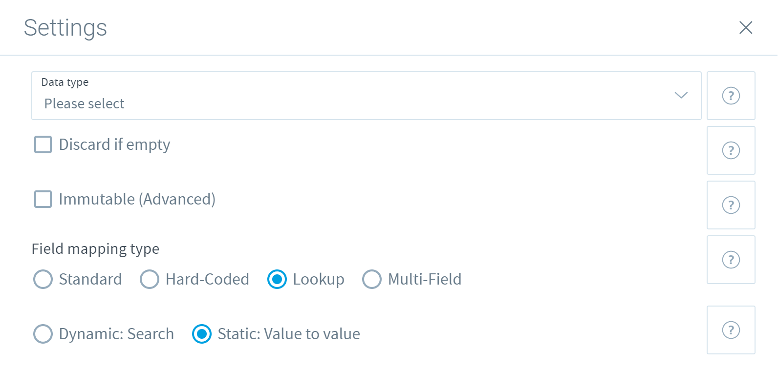

Import mapping
Four options are possible for mapping data to most destination endpoints:
- Standard – Defines a 1:1 direct mapping between two fields
- Hard-coded – Overrides the exported data with a single value that you provide for that field in each imported record
Lookup – Retrieves information from an alternate location to populate fields for import, in one of two lookup types:
- Dynamic – Searches the destination app’s records to find a match for the exported field
- Static – Allows you to build a lookup table to replace expected source field values
- Multi-field – Merges multiple fields from the source app into a single field in the destination app
All import types let you specify a default value for missing data.
Simple data mappings (standard, hard-coded, and multi-field) are processed very quickly.
Dynamic lookups are, by definition, more processor- and HTTP request-intensive. For every record in a queue with a dynamic lookup applied to a field, integrator.io must perform a search in the destination app to retrieve the expected value. Although dynamic lookups are cached for later use, to improve performance, multiple dynamic lookups are a common cause of slow flows.
One way to minimize dynamic lookups involves adding a flow to gather the information. For example, you might have an import that dynamically looks up NetSuite customer IDs. Before running that flow, you could sync the customer ID with the source MongoDB internal ID in a new flow, making the import mappings simpler.

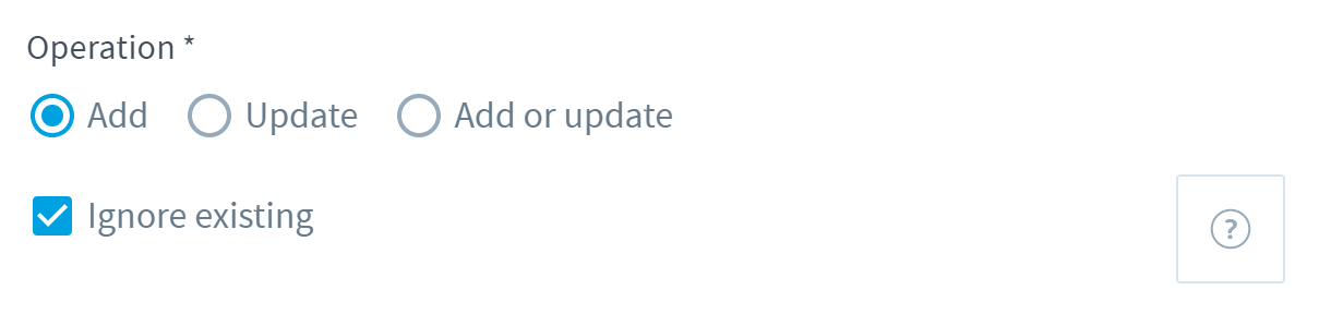

Add/update operations
Imports to certain apps require you to select the import Operation and offer additional options such as adding or upserting according to a lookup.
Specifying a lookup to verify whether the record exists does add some measurable overhead to the performance.
If you’re certain that the records are always present, then an add/update lookup might not be worth the expense. Updating the same record time and again, after all, is a classic idempotent operation.
A further Operation setting is the Ignore existing [records] checkbox, which protects against adding a duplicate record. For data integrity, you may need to select this option, but the downside is that an additional transaction is required before the record can be imported.

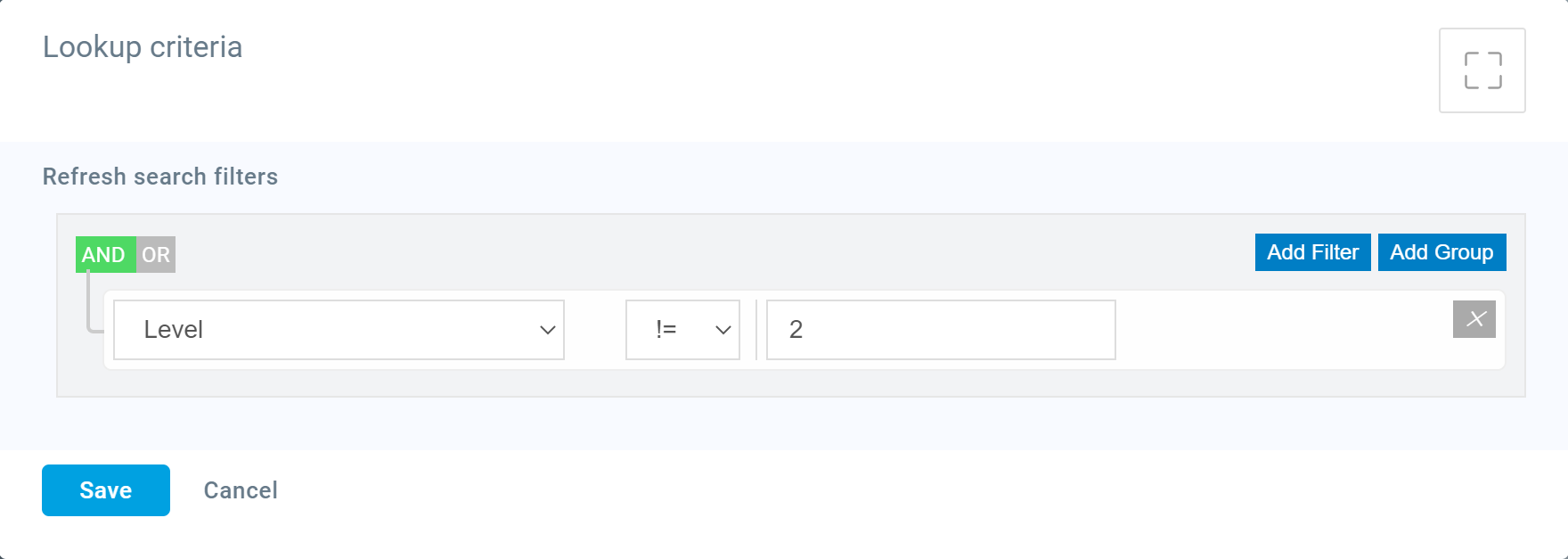

Import filters
Filters are designed to exclude records that do not match the criteria that you specify. Any filter that you apply to a destination app can limit the records that will be imported.
Tip: Keep in mind an important distinction between the filters for exported and imported data:
- Export filters remove non-matching records from the flow
- Import filters then pass through matching records from the remaining data only to a particular destination. If there are other destinations downstream, the flow continues to process all of the original records regardless of whether or not they met the filter criteria for a previous import.
