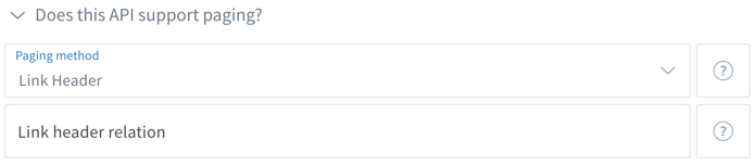

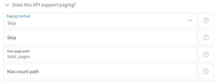

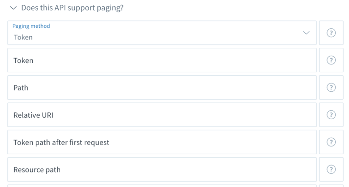

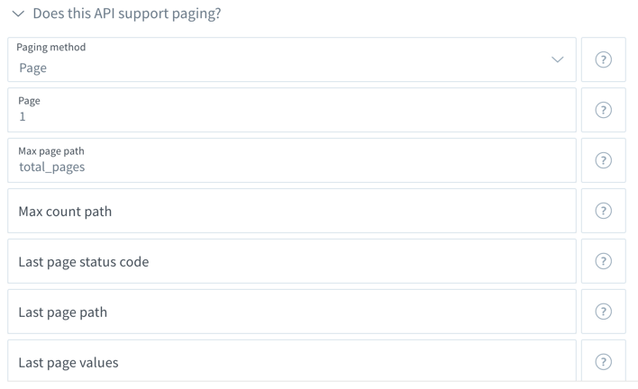

Does this API use paging?
See Pagination for details on which paging method to use.

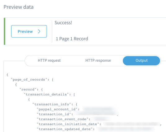

Preview data
Once you have configured all of the export settings, click Preview to review the response from the API call. If you see any errors, then revisit the steps above to fix the problems.

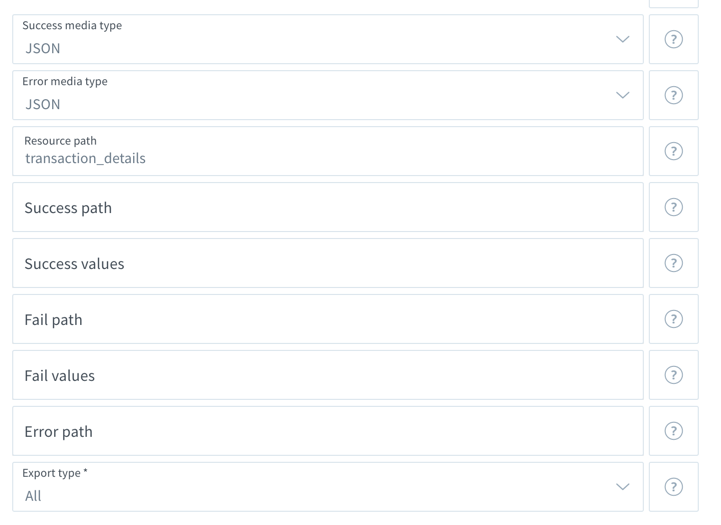

Override media type for success responses: The success media type indicates the format of the data received from all successful (HTTP) requests (CSV, JSON, or XML). Typically, APIs will only support one media type (data format) and will publish that info at the top of their API guides. This is an optional override of the media type associated with the connection in case the API has route-specific data formats. Amazon MWS, for example, is an XML service that returns CSV data for some of its reports.
Override media type for error responses: (JSON or XML)The error media type indicates the format of the response data received from all unsuccessful (HTTP) requests. This refers to all responses with non-2xx HTTP status codes. Typically, APIs support one media type (data format) and publish that info at the top of their API guides. This is an optional override of the media type associated with the connection in case the API has route specific data formats. Amazon MWS, for example, has some endpoints that return CSV data, but send error responses in XML.
