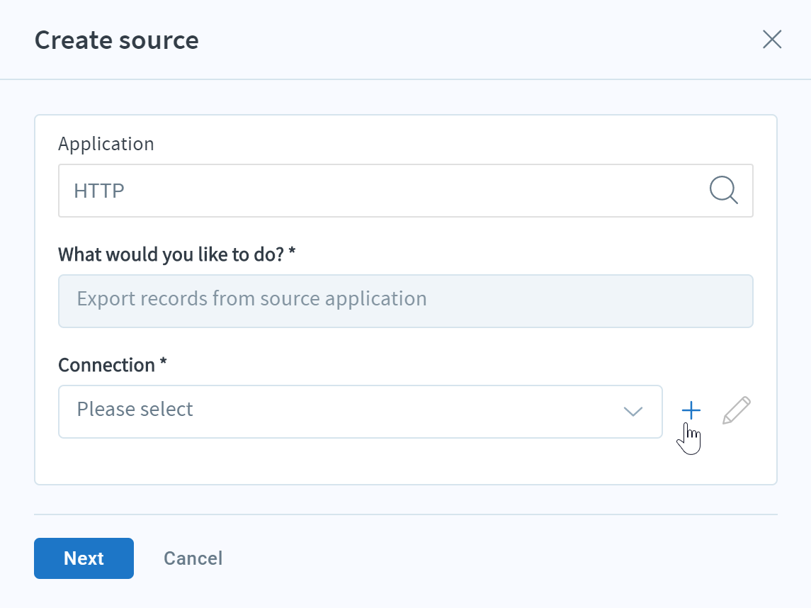

  1. From the Build menu, select Flows > Create flow.
  2. Click Add source in the Sources section of the new flow.
  3. The Create source pane opens.

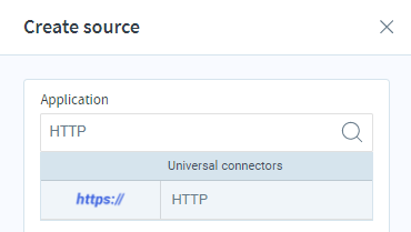

  4. From the Application list, select HTTP from the list of connection types.
  5. After the HTTP Application is added, the Create source pane prompts you for additional information about your export and connection settings. Select an existing connection or click the + button to create one.
  6. Click Next. (The Create export page opens).

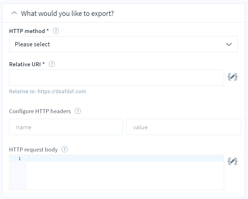

What would you like to export?
HTTP method (required): Provide the HTTP action required by your source application to retrieve the export data (options include GET, PUT, or POST).
Relative URI (required): Enter the relative URI that integrator.io can use to export the data.
Configure HTTP headers (optional): In some cases, you must include custom HTTP headers with your API requests; provide the name and value as required by the API.
HTTP request body (optional): If you need to pass anything in the request body, you can use the Build HTTP request body editor to create complex relative URLs based on the parameters to be passed to the API. The Build HTTP request body editor allows you to use handlebars expressions . Click Launch to open the Build HTTP request body editor.

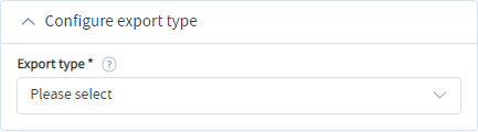

Configure export type
Export type (required): The following export types are available to help support common integration patterns:

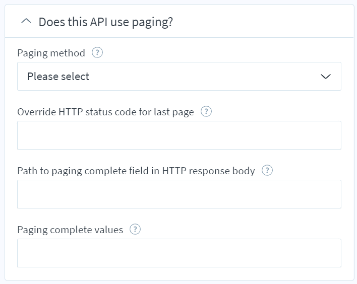

Does this API use paging?
See Pagination for details on which paging method to use.

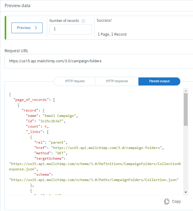

Once you have configured all of the export settings, click Preview to review the response from the API call. If you see any errors, then revisit the steps above to fix the problems.
For more information on Preview panel functionality, see Preview export data.

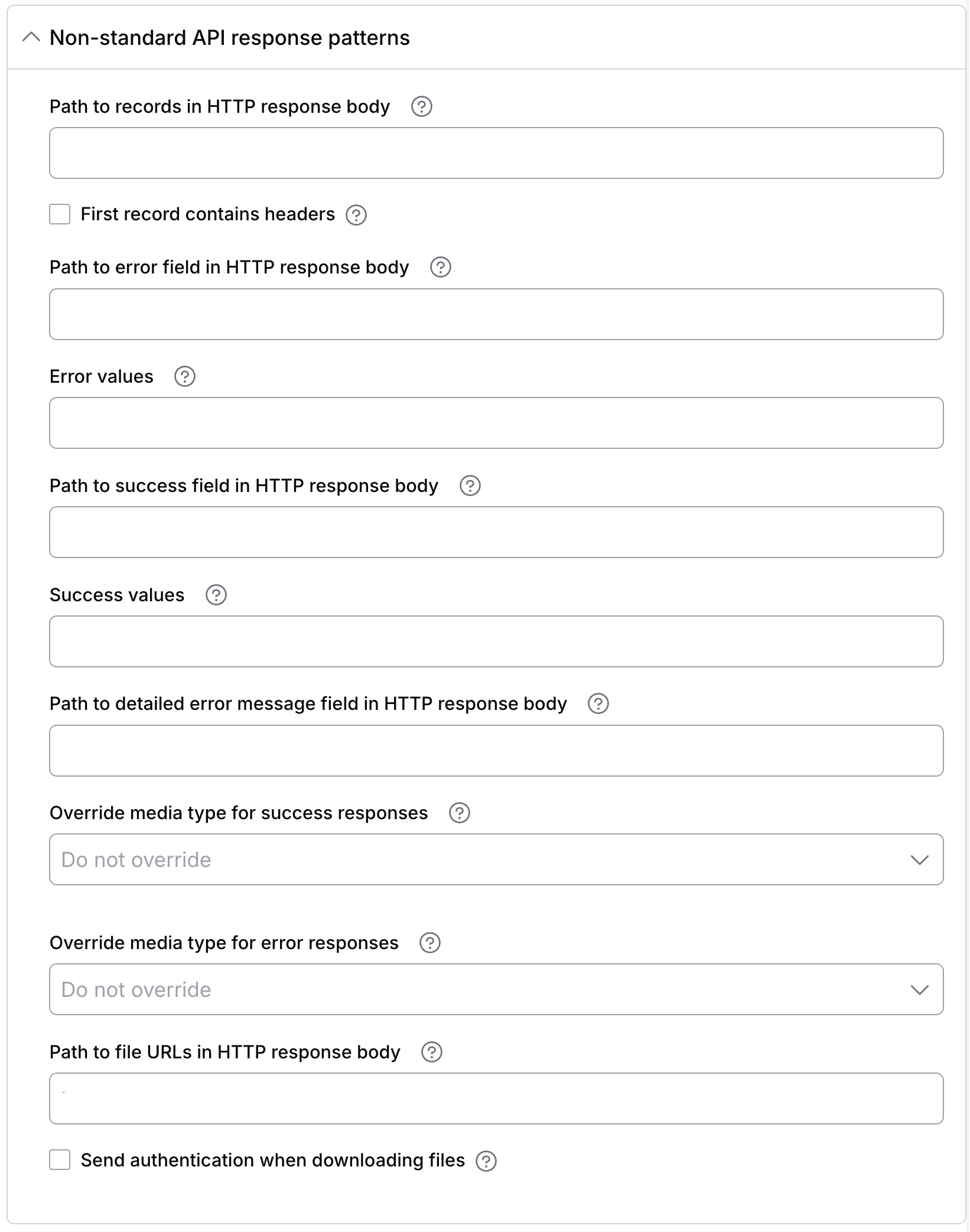

Non-standard API response patterns
Some APIs may have response patterns that are unusual when compared to most APIs. Use the settings below to accommodate outlying response codes.
Path to records in HTTP response body: This optional field allows integrator.io to locate the resource (or set of resources) returned from an API call. If the HTTP response from an API contains resources at the root, then no value is necessary for this field. If the response from an API contains a deeper response structure that contains paging information, you must provide the path to the resources. If no value is provided, integrator.io assumes that the resources can be found at the root of the response. Note that the format of this path is specific to the media type. If the response is represented in JSON structure, then use "dot" notation to describe the path to your resources.
You must manually define the namespace if you are using XML/XPATH. You can also use the following function:
/*[local-name()='OrderDto']
Example JSON path
results.customers
Example XPATH for XML
/SearchResults/Customers/Customer
Path to error field in HTTP response body: Use this optional field to help identify where in the body of a failed HTTP response integrator.io can find the error message. You can provide the field path to the property/node containing the error message. If no value is given, then the full HTTP response body is used as the description of the failure in the dashboard. Use XPATH if the media type of the failed response is XML, and use JSON if the media type is JSON. Note that if failed responses from an application have no body, then a text version of the HTTP status code is used as the reason for failure.
Example JSON path
result.error.message
/result/error.message/text()
Error values: This field is used only if the Fail path field is set. It indicates which specific values to test for when determining if the requests failed for authentication reasons. Use this field only if Fail path is set. It indicates to integrator.io which values to test when determining if the requests failed for authentication reasons.
Path to success field in HTTP response body: Not all services return HTTP status codes to determine the success or failure of a request. If a service always returns 200 HTTP status code, even for some failures, then use this field to tell integrator.io where to look for a success indicator. This field is used in combination with the Success values field to further refine how integrator.io can identify a successful response. If no success values are provided, any value found in the response body at this path is considered a success. You can also use the following function for namespaces:
/[local-name()='OrderDto']/[name()='diffgr:diffgram']/[local-name()='OrderDto']/[local-name()='Order']/*[local-name()='OrderId']
Success values: Use this optional field along with the Success path field. The value found in the HTTP response at the path provided by Success path is compared against the provided list of success values. If there is an exact case-sensitive match of any of the values, then the request is considered successful.
Path to detailed error message field in HTTP response body: If the service you are connecting to embeds authentication errors within the HTTP body, use this field to set the path within the response body where integrator.io should look to identify a failed auth response. If there is a specific value (or set of values) that indicate a failed auth response at this path, use the Fail values field for further instructions on how to identify this type of error.
Override media type for success responses: The success media type indicates the format of the data received from all successful (HTTP) requests (CSV, JSON, or XML). Typically, APIs will only support one media type (data format) and will publish that info at the top of their API guides. This is an optional override of the media type associated with the connection in case the API has route-specific data formats. Amazon MWS, for example, is an XML service that returns CSV data for some of its reports.
Override media type for error responses: (JSON or XML)The error media type indicates the format of the response data received from all unsuccessful (HTTP) requests. This refers to all responses with non-2xx HTTP status codes. Typically, APIs support one media type (data format) and publish that info at the top of their API guides. This is an optional override of the media type associated with the connection in case the API has route specific data formats. Amazon MWS, for example, has some endpoints that return CSV data, but send error responses in XML.
XML parser helper: The XML parser will give you immediate feedback on how your parse options are applied against raw XML data. See XML parser helper.
Path to file URLs in HTTP response body: Enter this optional field to to help identify where in the body of a HTTP response to look for URLs to download files. If you want to transfer files to subsequent flow steps, you should enter a field here. If you enter more than one field, use a comma to separate them. Each field can contain one URL or an array of URLs. If you preview the export data, you can see the field and URLs in the HTTP Response. You can also opt to use JSON path notation instead.
The file URLs must be public or self-signed, not requiring authentication.
Send authentication when downloading file: After you've entered Path to file URLs in HTTP response body, check this box if the API requires additional authentication when downloading files. When you check this box, the authentication headers used for the initial HTTP request will also be included in the requests made to securely download the files.
You can receive Gzip compressed responses from any app endpoint. The HTTP connector can parse these responses because it accepts Gzip encoded data by default for all media formats.
Automatically follow redirects: This setting controls whether integrator.io automatically follows 3xx redirects returned by the source API. It's turned on by default, so existing exports behave exactly as they did before this setting existed.
Turn this setting off when you need to read the redirect response itself, rather than the resource at the redirect target. A common case is an API that returns a signed download URL in a Location header via a 302 redirect. If integrator.io follows that redirect, you get the downloaded file instead of the URL. With this setting off, the 302 response is returned to you directly.
When this setting is off, integrator.io treats the returned 3xx response as a successful response, the same way it treats a 2xx. The full response pipeline runs as usual, so you can read the status code, the Location header, and the body through response mapping or postResponseMap. If the Location header value is relative, integrator.io resolves it to an absolute URL before returning the response, so what you see in response mapping is already the resolved, absolute URL.
This setting only affects 3xx responses that would otherwise trigger a redirect: any 3xx status other than 304 that includes a Location header. A 304 response, or a 3xx response with no Location header, isn't affected by this setting either way.
The token-refresh request that integrator.io uses to renew OAuth 2.0 credentials always follows redirects, regardless of this setting. This setting applies only to your export's own data request.
When Automatically follow redirects is off, the returned 3xx response is logged as the request/response for that call and recorded as a success. Execution logs don't yet show the full chain of hops for a followed redirect.
Maximum number of redirects: This optional field sets a cap, from 1 to 10, on how many 3xx redirects integrator.io follows before treating the chain as an error. It only applies when Automatically follow redirects is on. If you leave this field blank, integrator.io uses a default cap of 5.
Setting this field to 0 doesn't disable redirect following. To stop integrator.io from following redirects at all, turn off Automatically follow redirects instead.
If a followed redirect crosses hosts, you can choose whether integrator.io keeps sending your Authorization header to the new host. See Remove Authorization header on cross-host redirect in Set up an HTTP connection. This setting has no effect when Automatically follow redirects is off, since no second request is made.

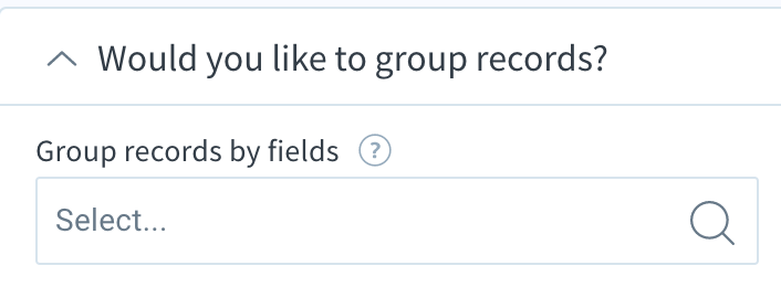

Would you like to group records?
You can group HTTP export or lookup records to aggregate your data based on your chosen field(s). The suggested list of fields contains the top-level properties in JSON fields.
integrator.io creates a new grouped record based on your chosen field(s). Select the fields you want to group, based on your sample response data. Fields other than basic data types (such as string and number) are unavailable. If the source application does not sort the exported data, then grouping may not work as expected. The order of each grouping is always respected.
Sort and group records provides more examples, though you should note that sorting is not available for universal HTTP exports or lookups at this time. Take the following JSON record:
  "page_of_records": [
      "record": {
        "NAME": "Sarah",
        "AGE": 97,
        "PURCHASE": "Beach towel",
        "CATEGORY": "Summer"
      "record": {
        "NAME": "John",
        "AGE": 98,
        "PURCHASE": "Ski gloves",
        "CATEGORY": "Winter"
      "record": {
        "NAME": "Ana",
        "AGE": 99,
        "PURCHASE": "Beach ball",
      "record": {
        "NAME": "James",
        "AGE": 100,
        "PURCHASE": "Snowboard",
Using the example JSON record, you can group by the Category field. Your data is grouped into Summer and Winter rows. Of course, a flow can handle more detailed groupings, say if you want to group records by Category and Purchase – or by Category, Age, and Purchase.
      "rows": [
          "CATEGORY": "Summer",
          "NAME": "Sarah",
          "AGE": 97,
          "NAME": "Ana",
          "AGE": 98,
      "rows": [
          "CATEGORY": "Winter",
          "NAME": "John",
          "AGE": 99,
          "NAME": "James",
          "AGE": 100,
Remember that the Page size property under the Advanced section determines how many records/groups can go into a page. If a single group exceeds the page size, that group is discarded from the export, and an error indicating this issue is reported.

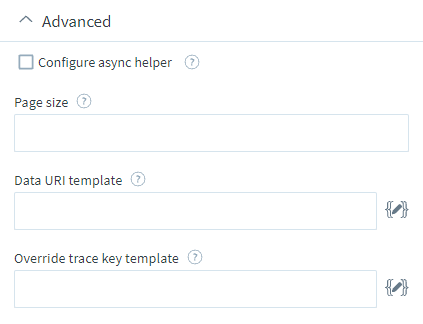

Advanced

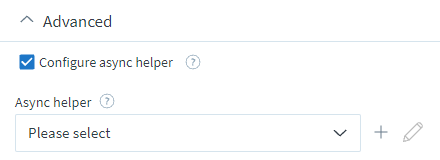

Configure async helper: If data is exported asynchronously, check this box to select the async helper configuration.
Page size: When an export runs in the context of a data flow (meaning integrator.io sends the data from the export to an import queue), integrator.io breaks the exported data into one or more smaller pages of records. You can enter a value in the Page size setting to specify how many records you want in each page of data. If you leave this field blank, the default system value is 20. There is no maximum value, but a page of data is automatically capped when it exceeds 5 MB. Most of the time, the application that you are importing data into will bottleneck the page size value. For example, NetSuite and Salesforce both document a maximum number of records that can be submitted in any single request, upon import.
Data URI template: When your flow runs but has data errors, this field allows you to verify that all the errors have a link to the original data in the export application. This field uses a handlebars template to generate the dynamic links based on the data being exported.
For example, if you are exporting a customer record from Shopify, you would typically set this field to the following value:
https://your-store.myshopify.com/admin/customers/{{{id}}}
Or, if you are just exporting a CSV file from an FTP site, then this field could be one or more columns from the file:
{{{internal_id}}, {{{email}}}
Override trace key template: Define a trace key that integrator.io will use to identify a unique record. You can use a single field such as {{{field1}}} or use a handlebar expression. For example, this syntax {{join “_” field1 field2}} will generate a trace key template field1_field2. When this field is set, you will override the platform default trace key field.
