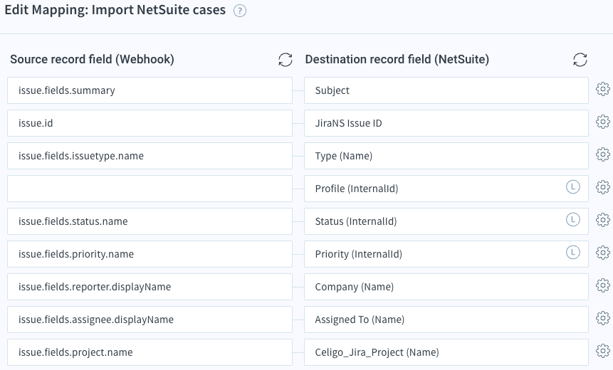

Jira Cloud platform issues to NetSuite cases
This flow syncs Jira Cloud platform issues as NetSuite cases. This flow creates cases in NetSuite only when a matching case is not found. When a matching case is found, this flow updates the cases in NetSuite.
Flow details
  • Export source: Jira Cloud platform
  • Built-in Listener: Get Jira Cloud platform issues - get all issues from Jira Cloud platform.
  • Built-in Import: Import NetSuite cases - add/update cases into NetSuite with the configured custom field as lookup identifier.
  • Built-in Import: Import NetSuite cases(for Message) - update cases into NetSuite with the configured custom field as lookup identifier.
  • Built-in import: Import Jira Cloud platform issues – store NetSuite case ID in Jira Cloud platform issues.
Before you begin
  1. Employees in NetSuite should be the same as Users in the Jira Cloud platform.
    1. Jira Cloud platform user ID should be stored in the custom field of NetSuite employees.
  2. Customers in NetSuite should be the same as Users in the Jira Cloud platform.
    1. Jira Cloud platform user ID should be stored in the custom field of NetSuite customers.
  3. Type in NetSuite should be the same as the Issue type in Jira Cloud platform.
  4. Projects in NetSuite should be the same as Projects in Jira Cloud platform.
    1. Jira Cloud platform project ID should be stored in the custom field of NetSuite projects.
  5. Create a custom field of type text on issues in Jira Cloud platform to store the Internal ID of NetSuite cases.
Setup instructions
  1. Create a webhook for Get Jira Cloud platform issues.
  2. Configure static mapping for Status (InternalId), Priority (InternalId) in Import NetSuite cases.
  3. Configure dynamic mapping for Profile (InternalId) in Import NetSuite cases.
New.pngField mappings: Import NetSuite cases

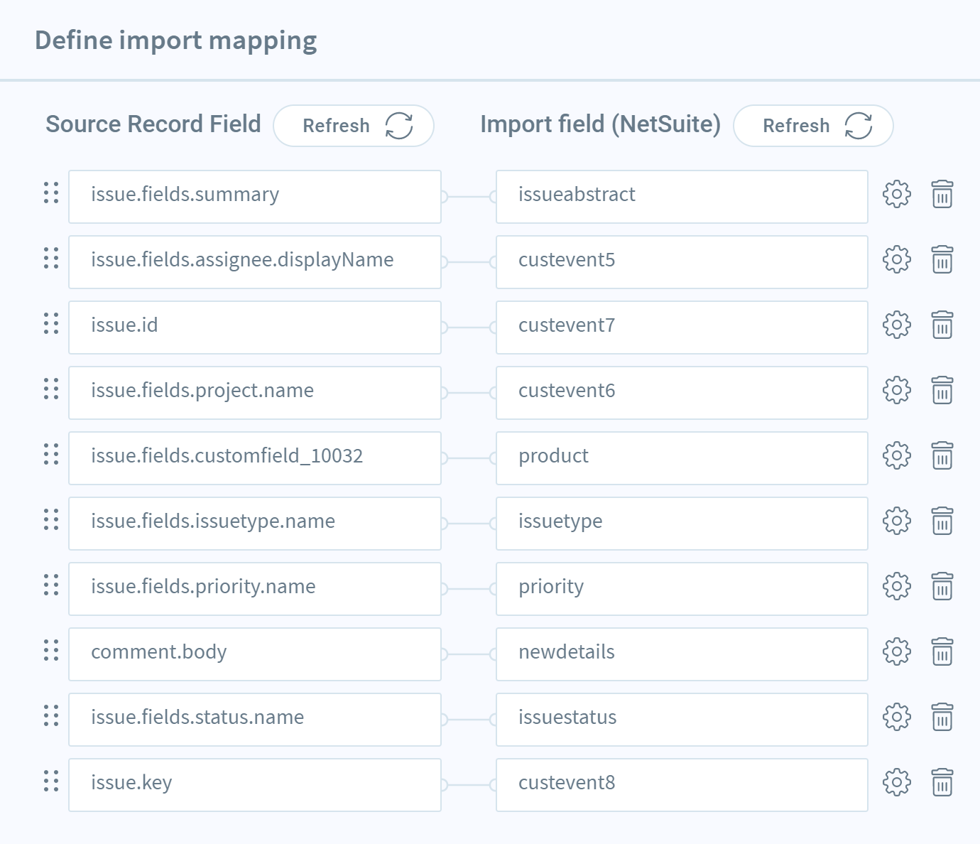

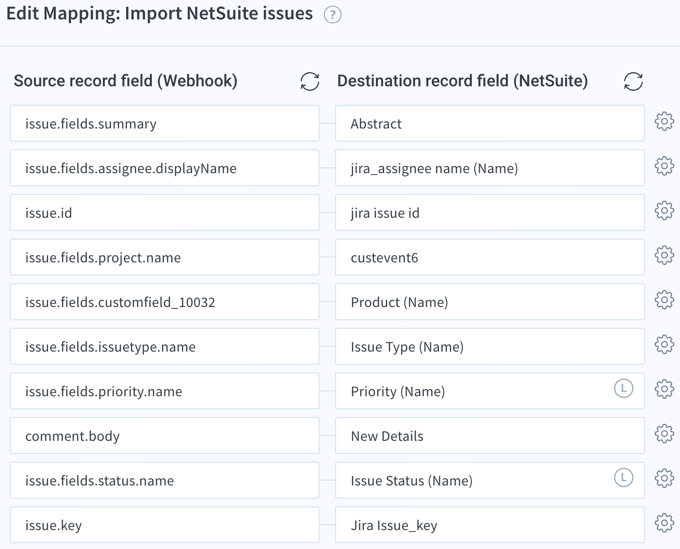

Jira Cloud platform issues to NetSuite issues
This flow syncs the Jira Cloud platform issues as NetSuite issues. This flow creates issues in NetSuite only when a matching issue is not found. When a matching issue is found, this flow updates the issue.
Flow details
  • Built-in Import: Import NetSuite issues - add/update issues into NetSuite with the configured custom field as lookup identifier.
  • Built-in Import: Import Jira Cloud platform issues - store NetSuite issue ID in Jira Cloud platform issues.
Before you begin
  1. NetSuite Employees should be the same as Jira Cloud platform Users.
  2. Projects in NetSuite should be the same as Projects in Jira Cloud platform.
  3. Create a custom field of type text on issues in Jira Cloud platform to store Internal ID and generate the product item of NetSuite cases.
Setup instructions
  2. Configure static mapping for Issue Status (Name) and Priority (Name) in Import NetSuite issues.
2.pngField mappings: Import NetSuite issues

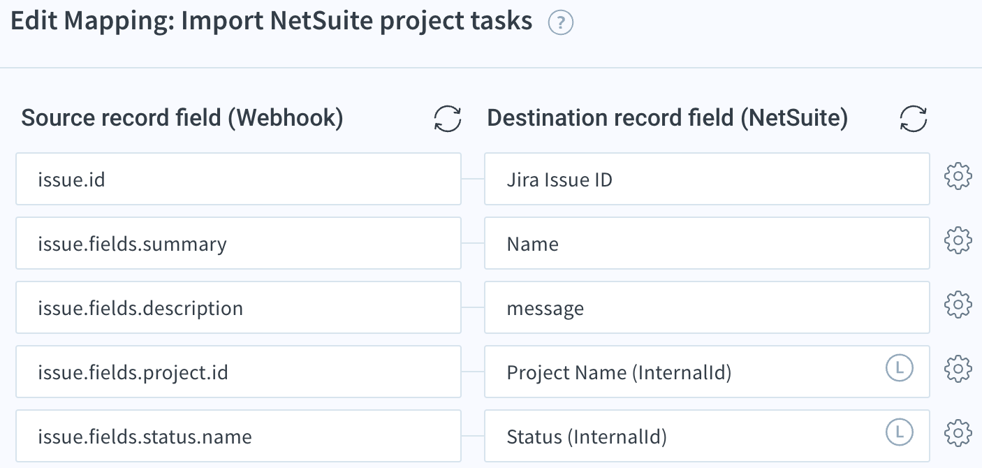

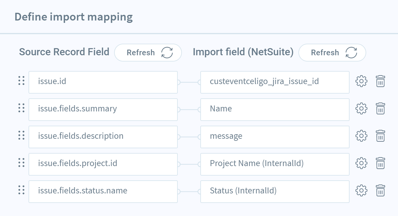

Jira Cloud platform issues of type task to NetSuite project tasks
This flow syncs Jira Cloud platform issues of type tasks as NetSuite project tasks. This flow creates project tasks in NetSuite only when a matching project task is not found. When a matching project task is found, this flow updates the project tasks.
Flow details
  • Built-in Import: Import NetSuite project tasks - add/update project tasks into NetSuite with the custom field as the lookup identifier.
  • Built-in Import: Import Jira Cloud platform issues - store NetSuite project task internal id in Jira Cloud platform issues.
Before you begin
  1. Projects in NetSuite and projects in Jira Cloud platform should be the same.
    1. Jira Cloud platform project ID should be stored in NetSuite projects custom field.
  2. Create a custom field of type text on issues (type task) in Jira Cloud platform to store Internal ID of NetSuite project tasks.
Setup instructions
  2. Configure dynamic mapping for Project Name (InternalId) in Import NetSuite project tasks.
  3. Configure static map for Status (InternalId) in Import NetSuite project tasks.
3.pngField mappings: Import NetSuite project tasks

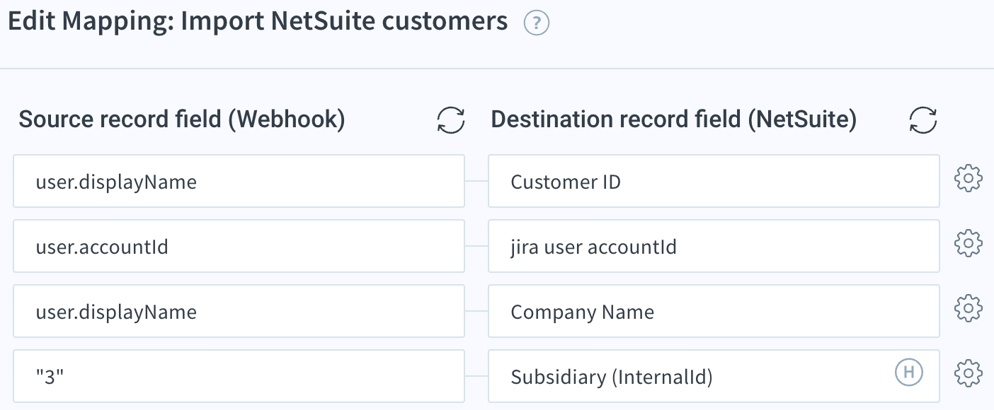

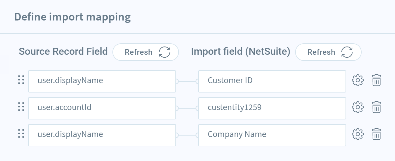

Jira Cloud platform users to NetSuite customers
This flow syncs the Jira Cloud platform users to NetSuite customers. This flow creates customers in NetSuite only when a matching customer is not found. When a matching customer is found, this flow updates the customers.
Flow details
  • Built-in Listener: Get Jira Cloud platform users - get all users from Jira Cloud platform.
  • Built-in Import: Import NetSuite customers - add/update customers into NetSuite with custom field as the lookup identifier.
Setup instructions
  1. Create a webhook for Get Jira Cloud platform users.
  2. Add Subsidiary mapping in Import NetSuite customers.
4.pngField mappings: Import NetSuite customers

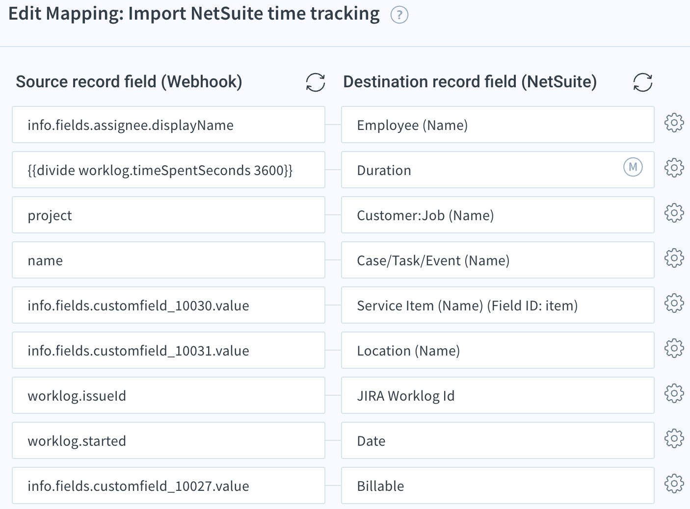

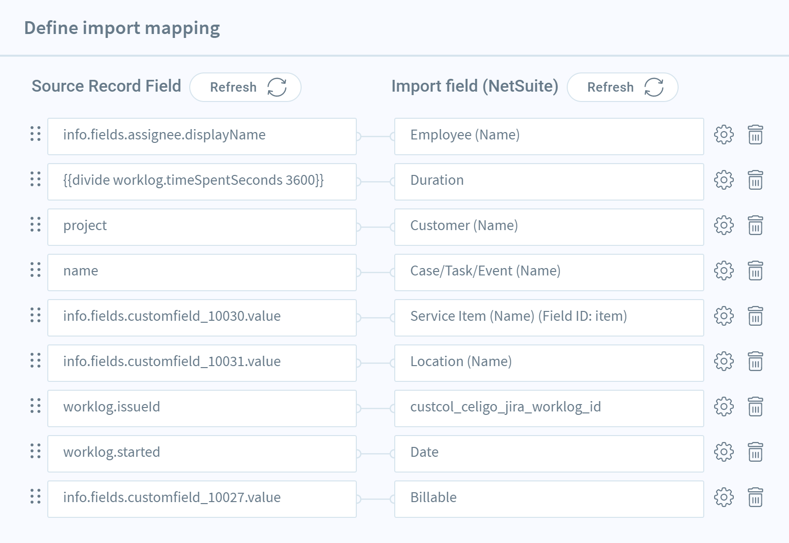

Jira Cloud platform time tracking to NetSuite time tracking
This flow syncs time logged in a Jira Cloud platform time-tracking record with NetSuite. This flow can be configured to sync time-tracking information to a NetSuite Issue, Case, or Project Task.
Note: Time-tracking information for Jira Cloud platform issue types task, bug, and story can be synced as NetSuite project task, NetSuite issue, and NetSuite case respectively. Other Jira Cloud platform issue types are not supported.
Flow details
  • Built-in Listener: Get Jira Cloud platform time tracking - get all time tracking from Jira Cloud platform.
  • Built-in lookup: Get Jira Cloud platform issues - get all the issues from Jira Cloud platform by issue ID.
  • Built-in Import: Import NetSuite time tracking - add/update time tracking into NetSuite with configured custom field as the lookup identifier.
    • preMapFunction hook: Processing NetSuite time tracking.js - normalize data for issue types.
Before you begin
  1. NetSuite issue, case, project task, the project must be in sync with corresponding Jira Cloud platform records.
  2. Create custom fields of type Select List (single choice) on issues in Jira Cloud platform to store Location, Billable, Service item of NetSuite.
Setup instructions
  1. Create a webhook for Get Jira Cloud platform time tracking.
  2. Make the appropriate changes in the script for issue type story according to your requirements.
5.pngField mappings: Import NetSuite time tracking

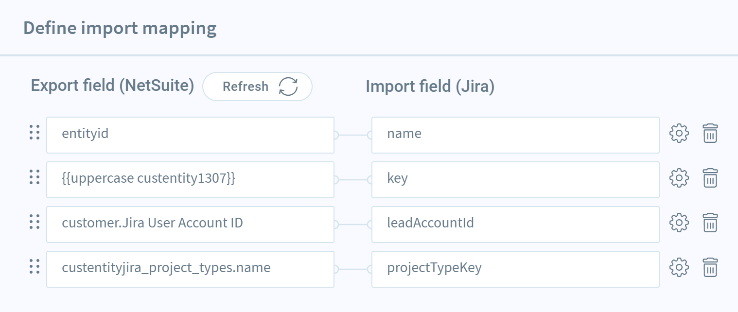

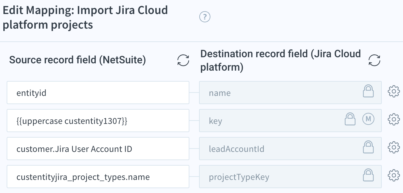

Jira Cloud platform projects to NetSuite (custom record - Jira projects)
This flow syncs the Jira Cloud platform projects as NetSuite Jira projects (custom record). This flow creates Jira Cloud platform projects in NetSuite only when a matching Jira project (custom record) is not found. If a matching Jira project is found, the flow updates the NetSuite Jira projects (custom record).
Flow details
  • Built-in export: Get Jira Cloud platform projects - get all projects from Jira Cloud platform.
  • Built-in Import: Import NetSuite (custom record - Jira projects) - add/update Jira projects (custom record) with project ID as the lookup identifier.

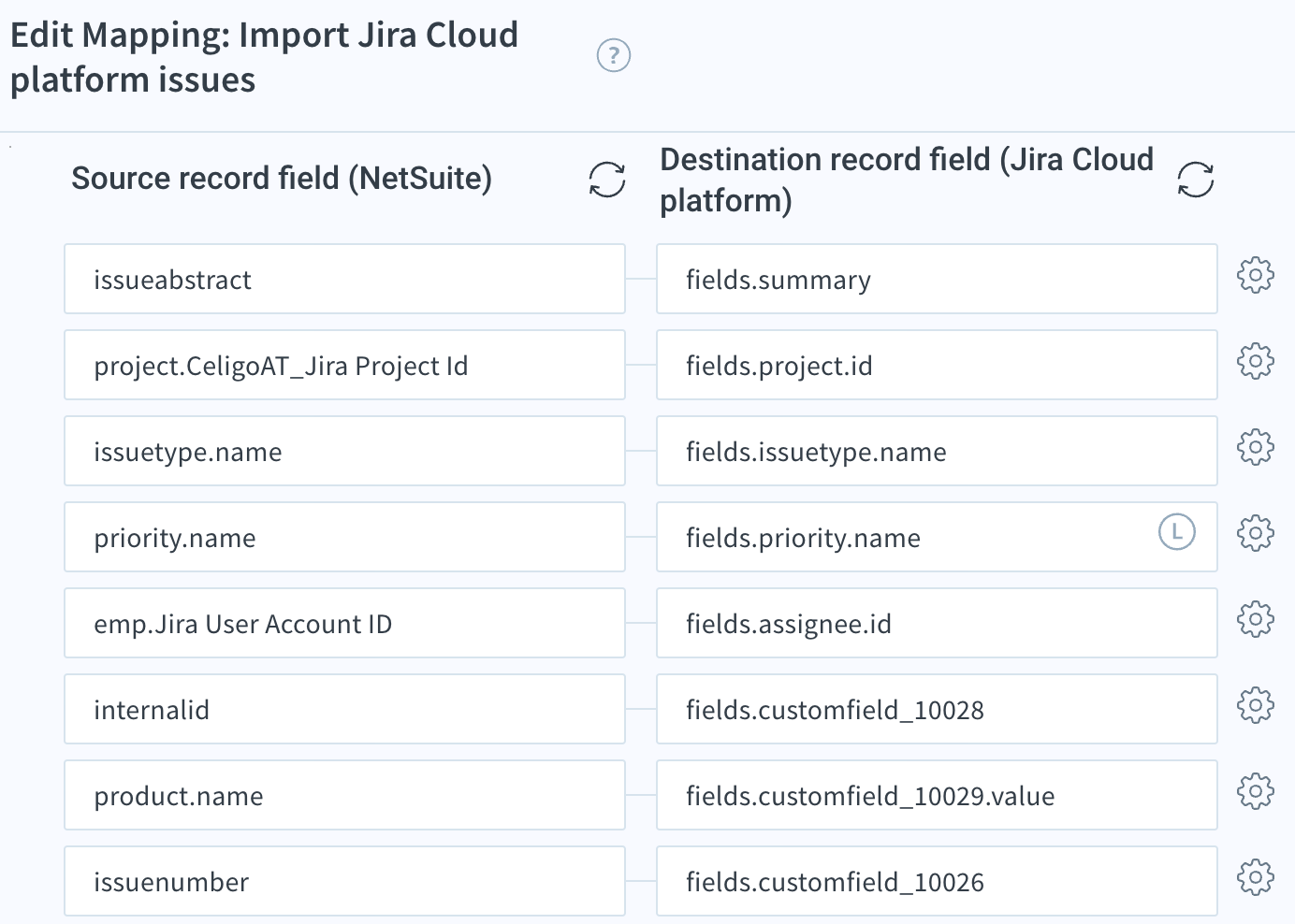

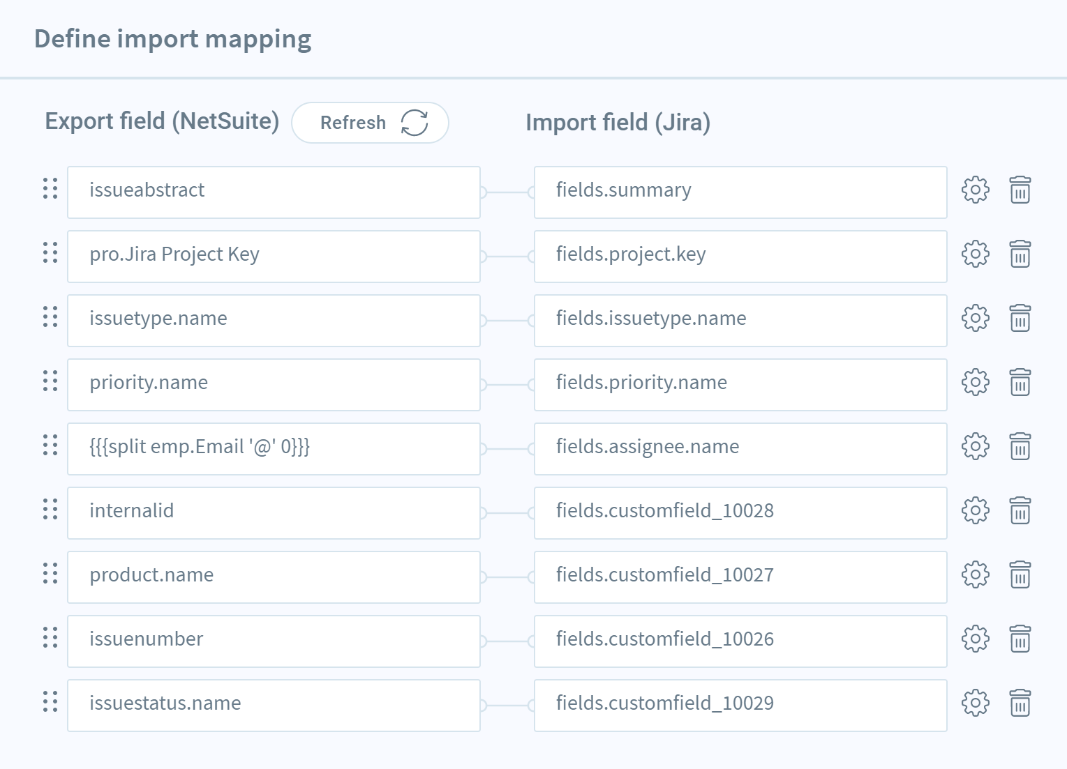

NetSuite issues to Jira Cloud platform issues
This flow syncs the NetSuite issues as Jira Cloud platform issues. This flow creates issues in Jira Cloud platform only when a matching issue is not found. When a matching issue is found, this flow updates the issues.
Flow details
  • Export source: NetSuite
  • Built-in listener: Get NetSuite issues - get all issues from NetSuite.
  • Import destination: Jira Cloud platform
  • Built-in lookup: Get NetSuite (custom record - Jira project) - get a Jira project (custom record) from NetSuite by ID.
  • Built-in lookup: Get NetSuite employees - get all employees from NetSuite by ID.
  • Built-in import: Import Jira Cloud platform issues - add/update issues into Jira Cloud platform with ID as the lookup identifier.
  • Built-in import: Import NetSuite issues - update issues into NetSuite by internal ID.
  • Built-in import: Import Jira Cloud platform comments - add comments into Jira Cloud platform by Issue ID.
Before you begin
  1. Employees in NetSuite and users in Jira Cloud platform should be the same.
  2. Projects in NetSuite and Projects in Jira Cloud platform should be the same.
    1. Jira Cloud platform project ID should be stored in the custom field of NetSuite project.
  3. Create a custom field of type text on issues in Jira Cloud platform to store internal ID and issue number of NetSuite issues.
Setup instructions
Configure static mapping for fields.priority.name and fields.issuetype.name in Import Jira Cloud platform issues.
6.pngField mappings: Import Jira Cloud platform issues

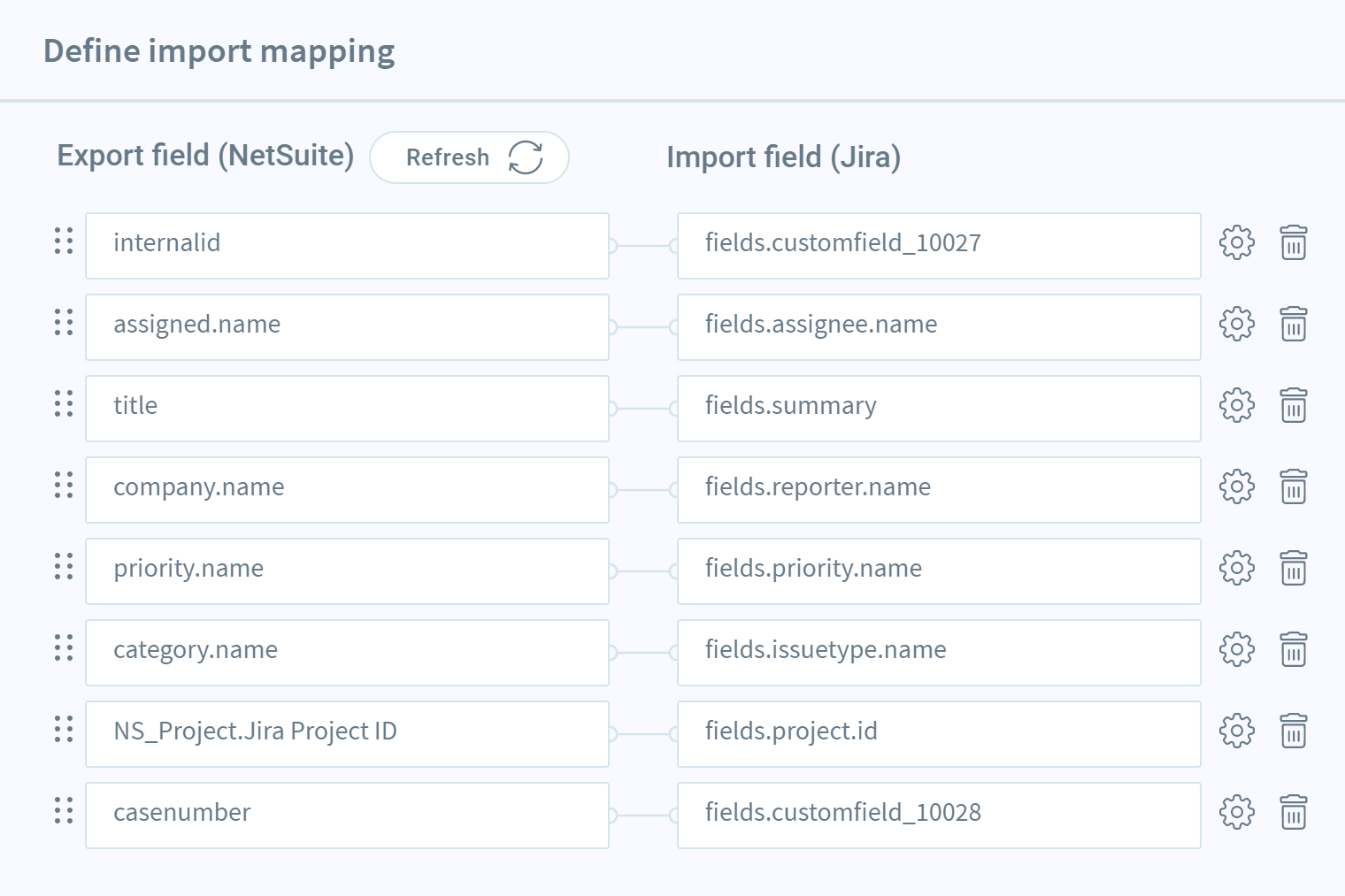

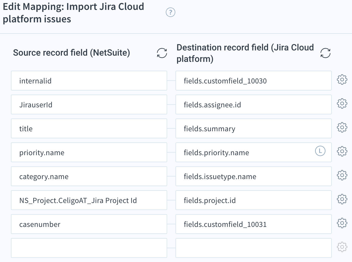

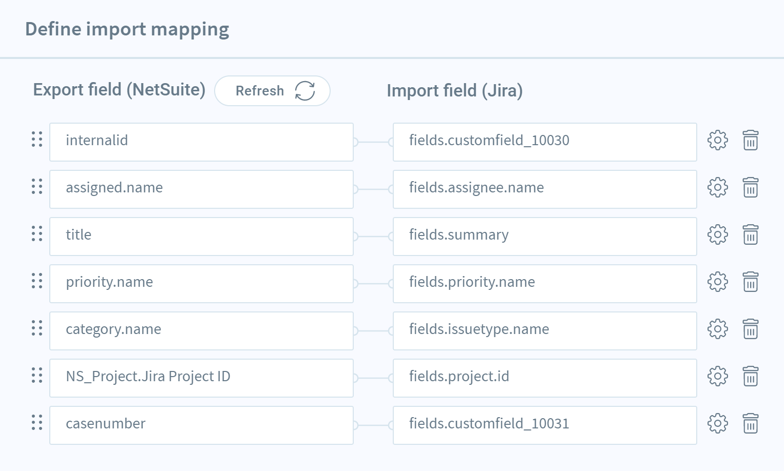

NetSuite cases to Jira Cloud platform issues
This flow syncs NetSuite cases as Jira Cloud platform issues. This flow creates issues in Jira Cloud platform only when a matching issue is not found. When a matching issue is found, this flow updates the issues.
Flow details
  • Built-in listener: Get NetSuite cases - get all cases from NetSuite.
  • Built-in lookup: Get NetSuite employees - get an employee from NetSuite by ID.
  • Built-in import: Import Jira Cloud platform issues - add/update issues into Jira Cloud platform with the configured custom field as lookup identifier.
  • Built-in lookup: Get Jira Cloud platform comments - get all comments from Jira Cloud platform by issue ID.
  • Built-in import: Import Jira Cloud platform comments - add/ ignore comments into Jira Cloud platform by ID.
  • Built-in import: Import NetSuite cases - store Jira Cloud platform issue ID in NetSuite cases.
Before you begin
  1. Employees in NetSuite and Users in Jira Cloud platform should be the same.
  2. Customers in NetSuite and Users in Jira Cloud platform should be the same.
  3. Type in NetSuite and Issue type in Jira Cloud platform should be the same.
  4. Projects in NetSuite and Projects in Jira Cloud platform should be the same.
    1. Jira Cloud platform project id should be stored in the custom field of NetSuite projects.
  5. Create a custom field of type text on issues in Jira Cloud platform to store Internal ID and case Number of NetSuite cases.
Setup instructions
Configure static mapping for fields.priority.name in Import Jira Cloud platform issues (add).
7.pngField mappings: Import Jira Cloud platform issues

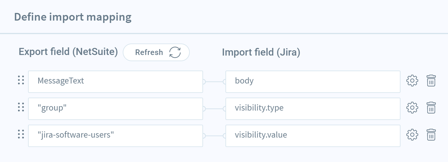

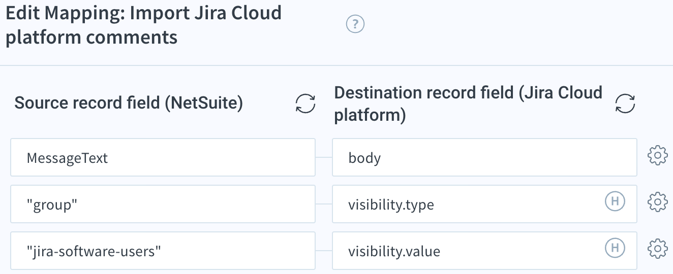

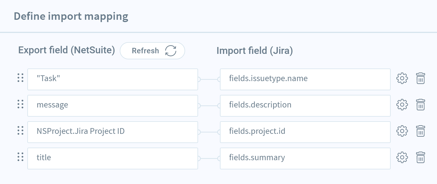

NetSuite case details to Jira Cloud platform issues comments
This flow syncs NetSuite case details as Jira Cloud platform issues comments. When case details are added in NetSuite case details, this integration flow exports the case details from NetSuite to Jira Cloud platform issues comments.
Flow details
  • Built-in export: Get NetSuite case details - get case comments only with visibility as internal from NetSuite that have been modified since this flow last ran.
  • Built-in import: Import Jira Cloud platform comments - add/ignore comments into Jira Cloud platform with ID as the lookup identifier.
    • preMapFunction hook: Processing Jira comments.js - normalize data for comments.
Before you begin
Run the flow NetSuite cases to Jira Cloud platform issues. The Jira Cloud platform issue ID should be stored in the  NetSuite cases custom field.
Setup instructions
Configure mapping for visibility.type and visibility.value in Import Jira Cloud platform comments.
8.pngField mappings: Import Jira Cloud platform comments

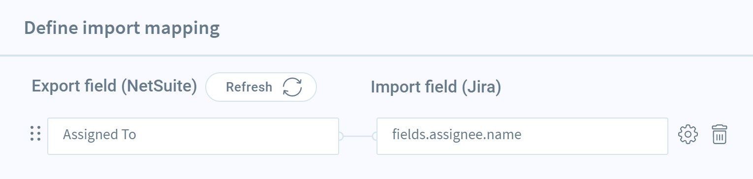

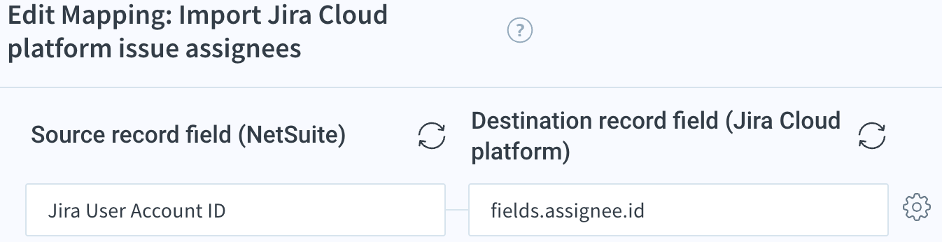

NetSuite case assignments to Jira Cloud platform issue assignees
This integration flow syncs NetSuite case assignments as Jira Cloud platform issue assignees. When case assignments are added to NetSuite case assignments, this integration flow exports the case assignments from NetSuite to Jira Cloud platform issue assignees.
Flow details
  • Built-in export: Get NetSuite case assignments - get case assignments details from NetSuite that have been modified since this flow last ran.
  • Built-in import: Import Jira Cloud platform issue assignees - update into Jira Cloud platform issue assignees with ID as the lookup identifier.
Before you begin
  1. Sync NetSuite cases with Jira Cloud platform issues.
    1. Jira Cloud platform issue ID should be stored in the custom field of NetSuite cases.
  2. Employee name in NetSuite and user’s name in Jira Cloud platform should be the same.
9.pngField mappings: Import Jira Cloud platform issue assignees
NetSuite customers to Jira Cloud platform users
This flow syncs the customers from NetSuite as users in Jira Cloud platform. The flow creates users in Jira Cloud platform only if a matching user is not found. If a matching user is found, the flow ignores the users. Updates are not supported.
Flow details
  • Built-in listener: Get NetSuite customers – get all customers from NetSuite.
  • Built-in import: Import Jira Cloud platform users – add and ignore user into Jira Cloud platform with accountId as the lookup identifier.
  • Built-in import: Import Netsuite customers – update customers into NetSuite with internal ID as the lookup identifier.

  • Built-in import: Import Jira Cloud platform projects – add or update projects into Jira Cloud platform with project id as the lookup identifier.
  • Built-in import: Import NetSuite projects – update projects into NetSuite with internalid as the lookup identifier.
Before you begin
  1. Project type in Jira Cloud platform and Jira Cloud platform project type (custom field) in NetSuite should be the same.
  2. Customer in NetSuite and User in Jira Cloud platform should be the same.
    1. Jira Cloud platform user id should be stored in NetSuite customers custom field.

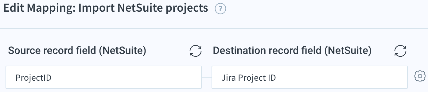

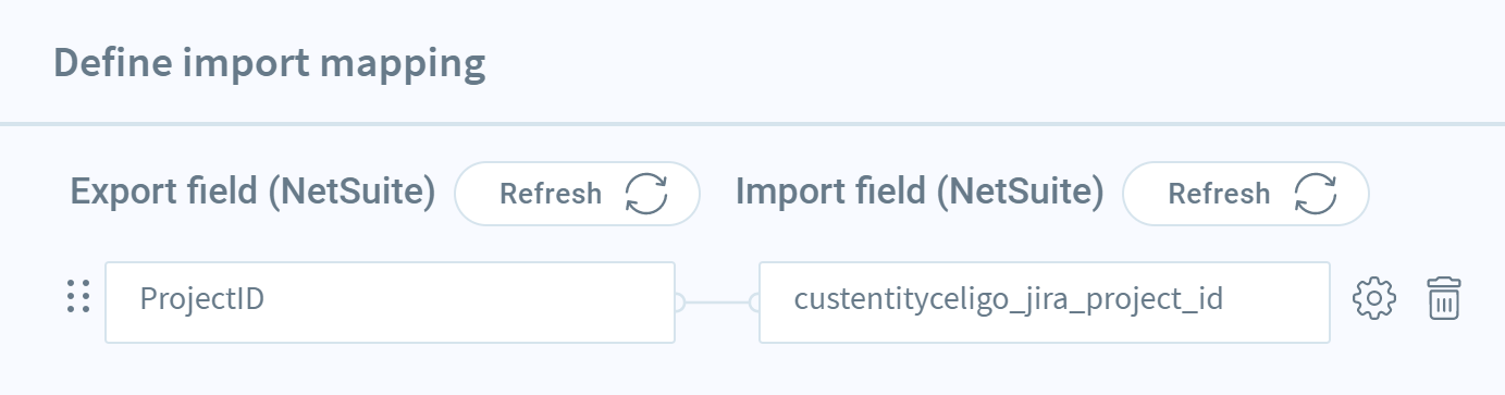

10.pngImport Jira Cloud platform projects
11.pngImport NetSuite projects

  • Built-in import: Import Jira Cloud platform issues – add or update issues of type into Jira Cloud platform with custom field as the lookup identifier.
  • Built-in import: Import NetSuite project tasks – update projects tasks into NetSuite with internalid as the lookup identifier.
Before you begin
Projects in NetSuite and Project in Jira Cloud platform should be the same. (Jira Cloud platform project id should be stored in NetSuite projects custom field).
Setup instructions

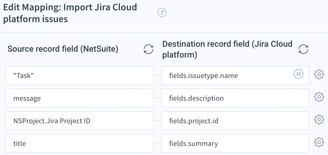

Configure mapping for fields.issuetype.name in Import Jira Cloud platform issues.
12.pngField mappings: Import Jira Cloud platform issues
