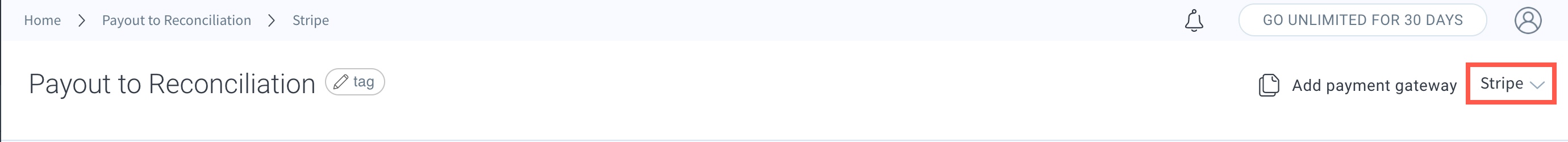

  1. In your integrator.io, click Payout to Reconciliation.
    Note: Make sure to select the appropriate Stripe account in the Payout to Reconciliation drop-down list at the top-right.

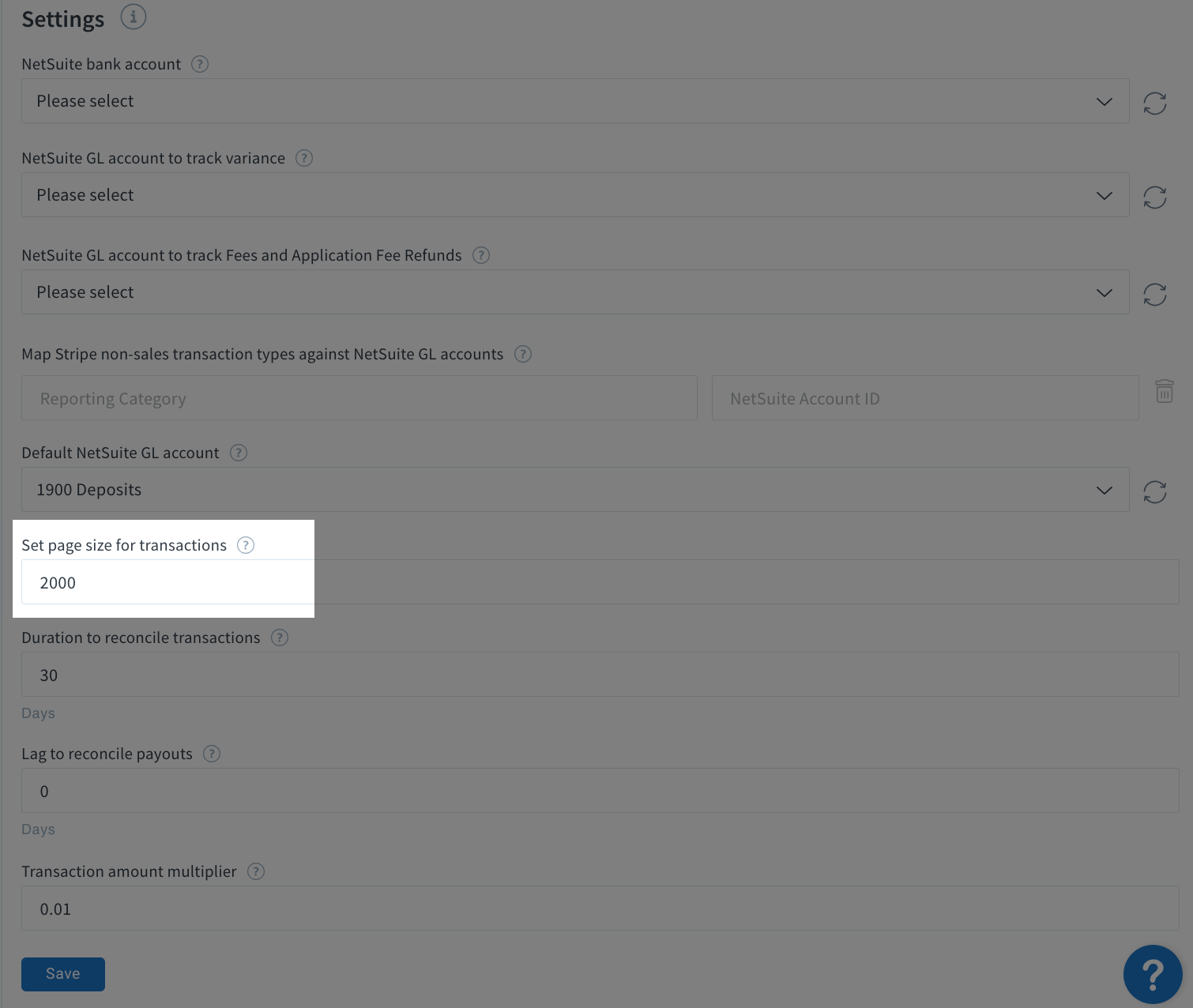

    • Enter the number of transactions to be processed per page in the Set page size for transactions setting. A single record will be created in NetSuite for the given number of transactions on a page. The maximum number of transactions that can be processed on a single page is 2000. If you do not enter any value in this setting, the default page size will be set to 2000.
      Notice
      If you set the page size as 20 and there are 2000 transaction records, there will be a total of 100 pages with 20 transaction records appearing per page. In NetSuite, 100 deposit records will be created with 20 transaction records in each deposit record.

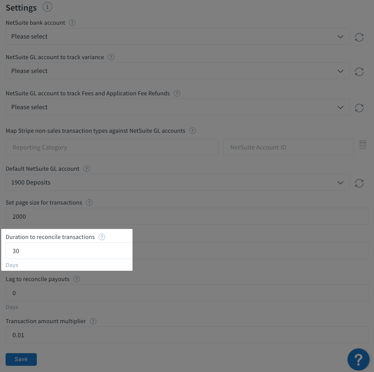

    • In the Duration to reconcile transactions setting, enter the number of days prior to the current date to reconcile transactions in NetSuite.
      Notice
      If the current date is January 30th and you want to reconcile transactions since January 1st, enter 30 in the setting.
      If you leave it empty, all available transactions are retrieved for reconciliation.
      Limitation: This setting only accepts natural numbers. If you enter values such as “3.5”, “-10”, or “ten”, you will receive an invalid error.

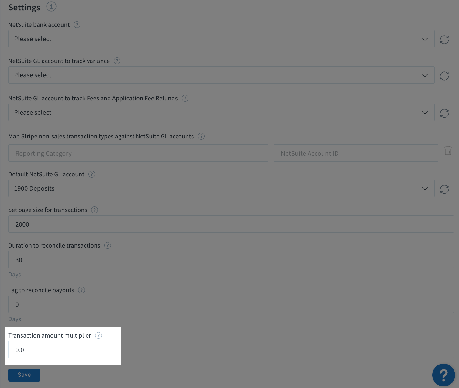

    • In the Transaction amount multiplier setting, enter a value of 0.01 or 1.
      For decimal currencies like USD, enter a value of 0.01. To get the settlement value, the transaction amount in the currency’s smallest unit is multiplied with the entered value.
      For zero-decimal currencies like JPY, enter a value of 1 as zero-decimal currencies have no decimal values. The transaction amount is multiplied by 1 to get the settlement value.
      The default value of 0.01 will be considered if you do not enter the multiplier value.
      Example:
      Decimal currencies: To get the value of USD 11.50, 1150 cents is multiplied with 0.01.
      Zero-decimal currencies: To get the value of ¥500, the amount value of 500 is multiplied with 1.

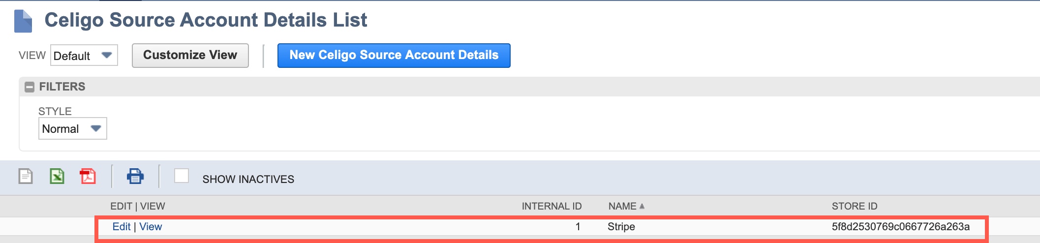

Celigo source account detailsFor every Stripe account that you configure in the Integration App, a list is added on the “Celigo source account details” page. Each record is added as a separate line with the connection name and store ID. The Integration App ID is treated as the store ID for now. Celigo Payout custom recordIn this record, you’ll find:
  • The summary record for each payout report.
  • Name
  • Payout ID
  • Amount
  • Payout Date
  • Currency
  • Memo
  • In the Deposits tab, the appropriate deposit record is attached.

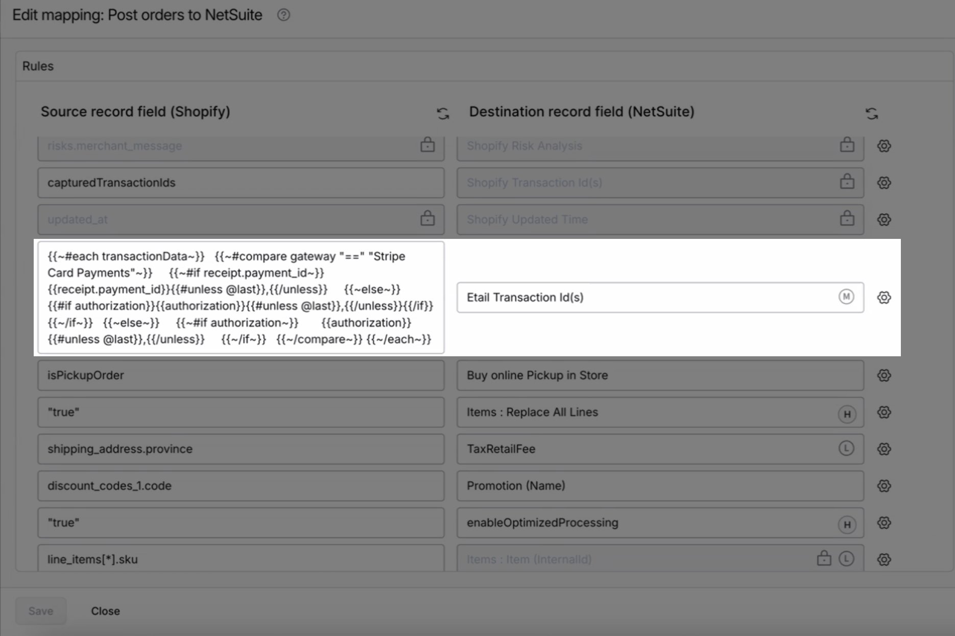

Stripe card payments in the Shopify – NetSuite integration app
Shopify has updated its payments platform, migrating from the legacy Stripe payment provider to the new Stripe card payments provider. Following this change, Shopify transactions now use receipt.payment_id instead of the legacy ch_ (Charge) ID, which may impact reconciliation with Stripe payouts. To ensure accurate transaction tracking and smooth reconciliation in the Shopify – NetSuite integration app integrated with the Stripe payment gateway, you must update the handlebar expressions in the following flows:
  • Shopify order to NetSuite order (cash sale or sales order) flow
    • Import: Post orders to NetSuite
    • Destination field: eTail Transaction Id(s)
    {{~#each transactionData~}} {{~#compare gateway "==" "Stripe Card Payments"~}} {{~#if receipt.payment_id~}} {{receipt.payment_id}}{{#unless @last}},{{/unless}} {{~else~}} {{#if authorization}}{{authorization}}{{#unless @last}},{{/unless}}{{/if}} {{~/if~}} {{~else~}} {{~#if authorization~}} {{authorization}}{{#unless @last}},{{/unless}} {{~/if~}} {{~/compare~}} {{~/each~}}
  • Shopify refund to NetSuite refund (add) flow
    • Import: Post order refunds (invoice or cash sale) to NetSuite
    • Import: Post customer refunds to NetSuite
    {{~#each transactions~}} {{~#compare gateway "==" "Stripe Card Payments"~}} {{~#if receipt.payment_id~}} {{receipt.payment_id}}{{#unless @last}},{{/unless}} {{~else~}} {{#if authorization}}{{authorization}}{{#unless @last}},{{/unless}}{{/if}} {{~/if~}} {{~else~}} {{~#if authorization~}} {{authorization}}{{#unless @last}},{{/unless}} {{~/if~}} {{~/compare~}} {{~/each~}}
    In each flow, locate the eTail Transaction Id(s) field under the Destination record field (NetSuite). You’ll see that this field is mapped to the sourceTransactionIds field. In the Source record field (Shopify), replace the existing value with the handlebar expression provided for the respective flow.

    • Ensures that the eTail Transaction Id(s) field in NetSuite captures the correct payment reference (receipt.payment_id for Stripe card payments, authorization for other gateways).
    • Maintains end-to-end transaction traceability between Shopify, Stripe, and NetSuite, ensuring reliable reconciliation within the Payout to Reconciliation App.
