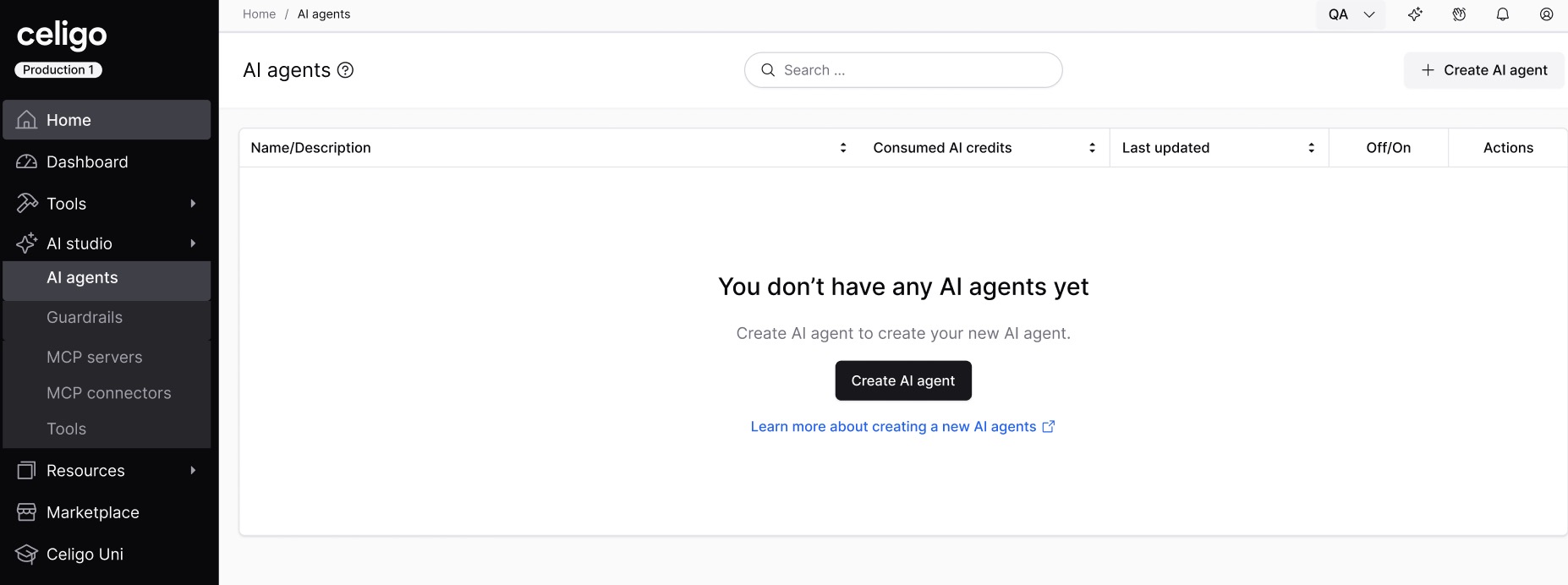

Navigate to your AI agents
Add the Celigo AI Agent import model type to run AI tasks on a per-record basis using standard import behavior and return a standardized response ready for downstream mapping.
To create your own Celigo AI agent as an import model type, navigate to AI studio → AI agent → Create AI agent.
If you have previously created an agent, select + Create AI agent at the upper right of the page.

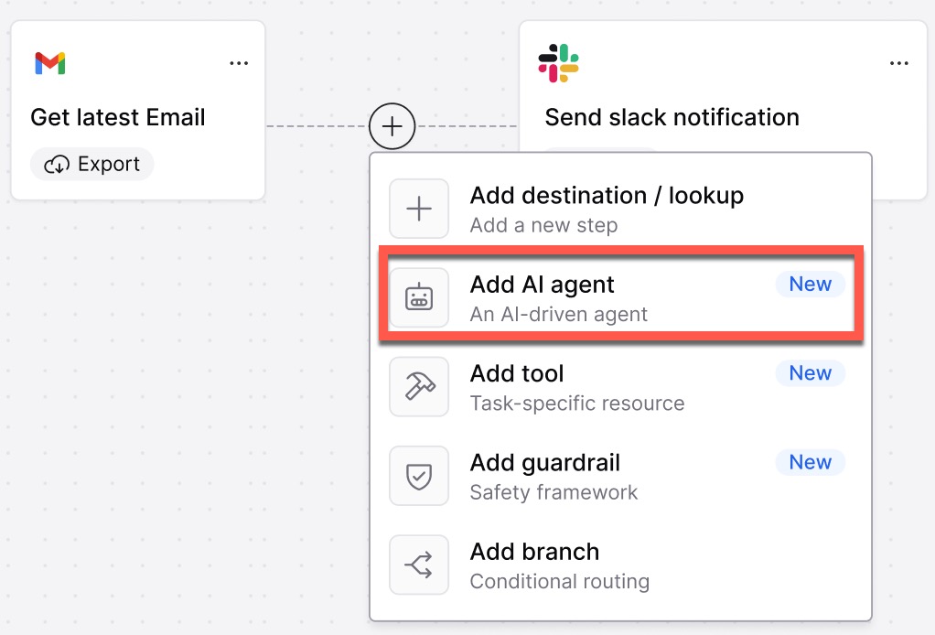

Alternatively, you can add an AI agent while working in Flow builder. From the left navigation menu, select Build → Flows → select + and then select Add AI agent.

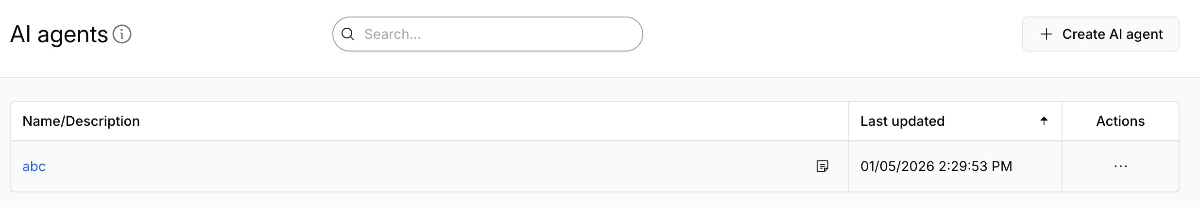

AI agents at a glance
Go to AI studio → AI agents to create or manage your agents and review activity.
The AI agents page lists every agent in your account so you can review status and key properties in one place.
- Name/Description – The agent's name and description.
- Last updated – Sort by newest or oldest.
- Actions – Select the Actions (...) menu for context-sensitive choices.
