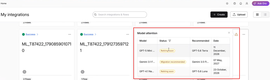

Review models that need attention
The Model attention panel lists models that need attention across the flows in an integration.
  1. Go to Home.
  2. Point to or select the warning or error icon for the integration. The Model attention panel opens.
  3. Review the following details:
    • Model - The AI model used by an AI agent or guardrail.
    • Status - The model's current lifecycle status.
    • Recommended - The suggested replacement model, when available.
    • Date - The model's retirement date, when applicable.
  4. Optional: Use the Status filter to view models with specific statuses.
