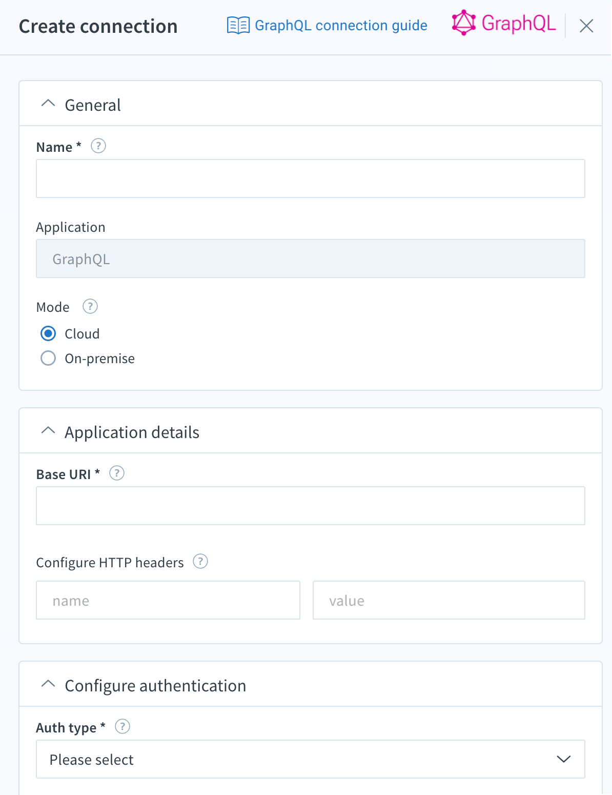

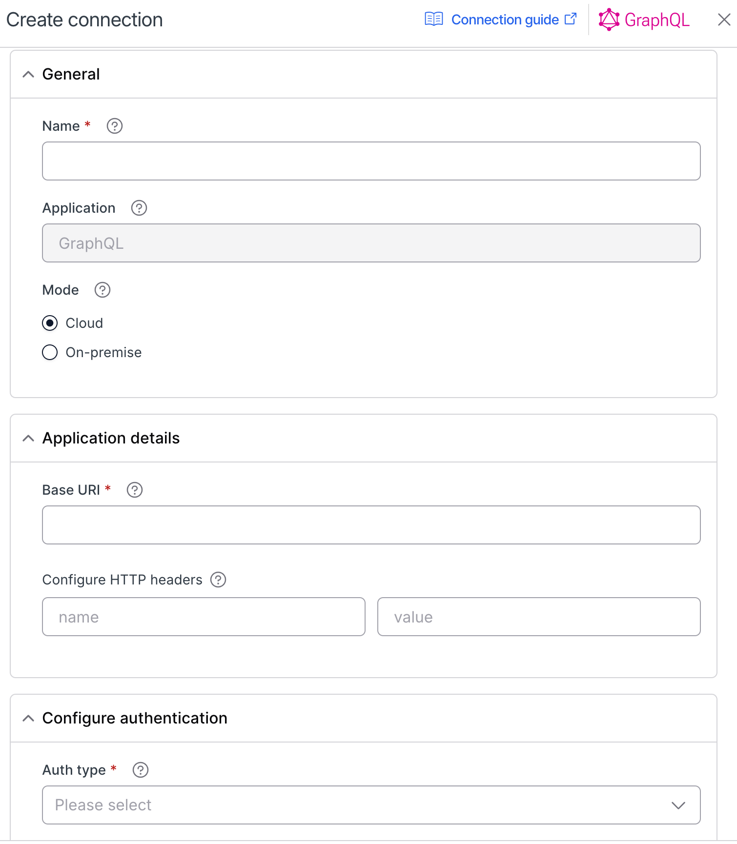

Enter your GraphQL endpoint details
At this point, you’re presented with a series of options for providing GraphQL endpoint authentication.
Mode (required): Select one of the following options
  • Cloud to connect to a publicly accessible server application.
  • On-premise to connect to a server that is publicly inaccessible and has an integrator.io agent installed on it.
Base URI (required): Provide the domain for your GraphQL endpoint. The application operates on a single endpoint (traditionally /GraphQL), and all requests are directed to this endpoint.
Authentication type (required): Select an authentication type from the list. Note that HTTP authentication types also apply to GraphQL connectors. Review the HTTP authentication type articles below to determine how to configure your authentication.

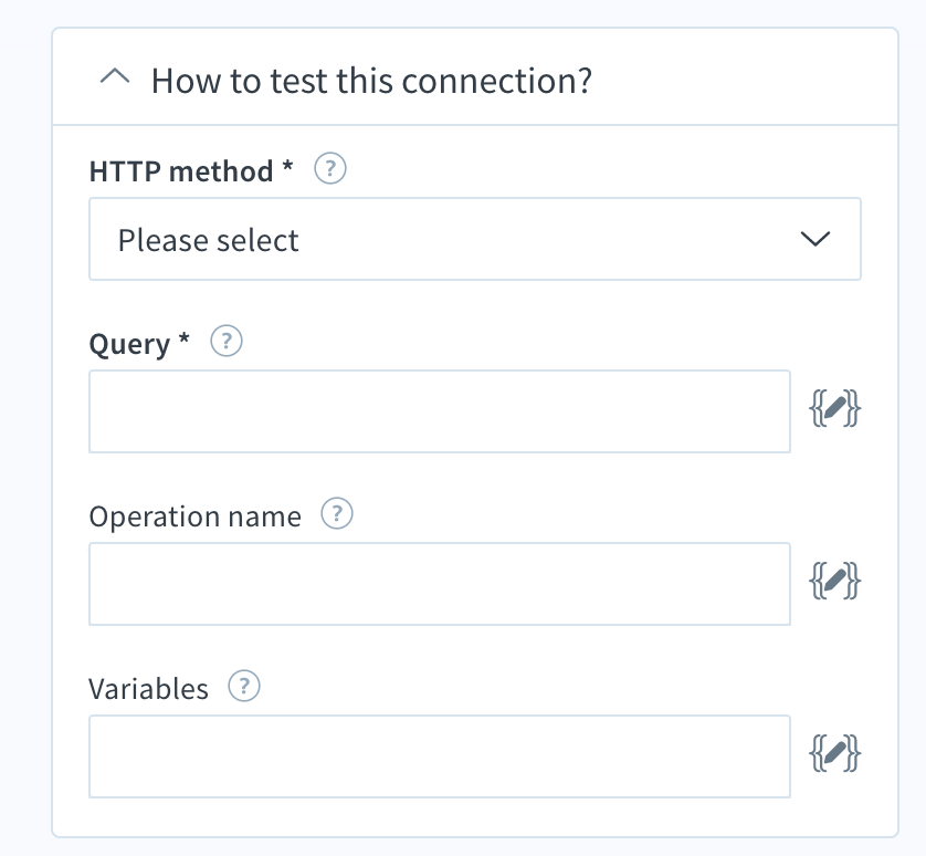

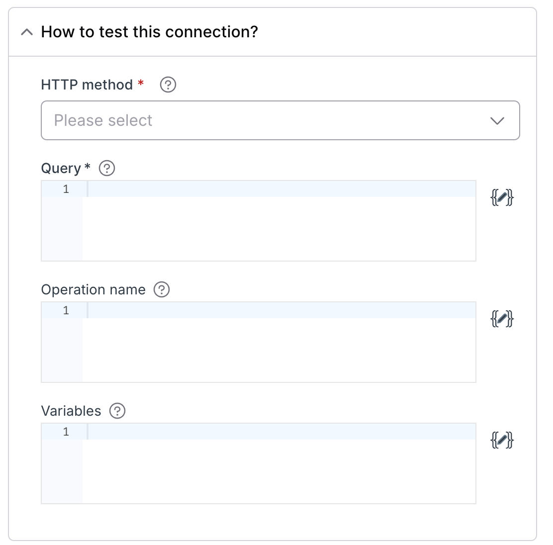

Test the connection
To test the connection, you must choose an HTTP method and send a request that the endpoint can process.
HTTP method (required): Choose between POST or GET. When you switch from POST to GET, integrator.io will build the query string from the body request content.
Query (required): Enter the query to be processed by the GraphQL endpoint. The supported operation type is either query or mutation. The operation type is required unless you're using the query shorthand syntax, in which case you can't supply a name or variable definitions for your operation. The query may also include an operation name, which is required for a multi-operations query.
Operation name: Only required if your query has two or more operations. A request can only execute one operation at a time.
The operation name is a meaningful and explicit name for your operation. Its use is encouraged because it is helpful for debugging and server-side logging. When something goes wrong, such as errors in your network logs or in your GraphQL server logs, it's easier to identify a query in your codebase by name instead of deciphering the contents. Think of it as a function name in your favorite programming language.
Variable: Defines the JSON variables used in your query. For example, if the query is query HeroNameAndFriends($episode: Episode) , define the variable as {"episode":"JEDI"}.
