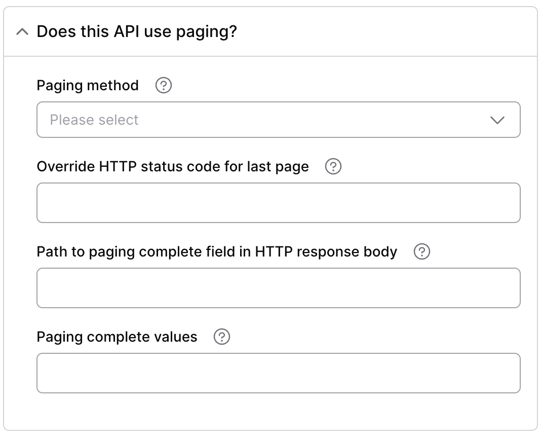

Does this API use paging?
See pagination for details on which paging method to use.

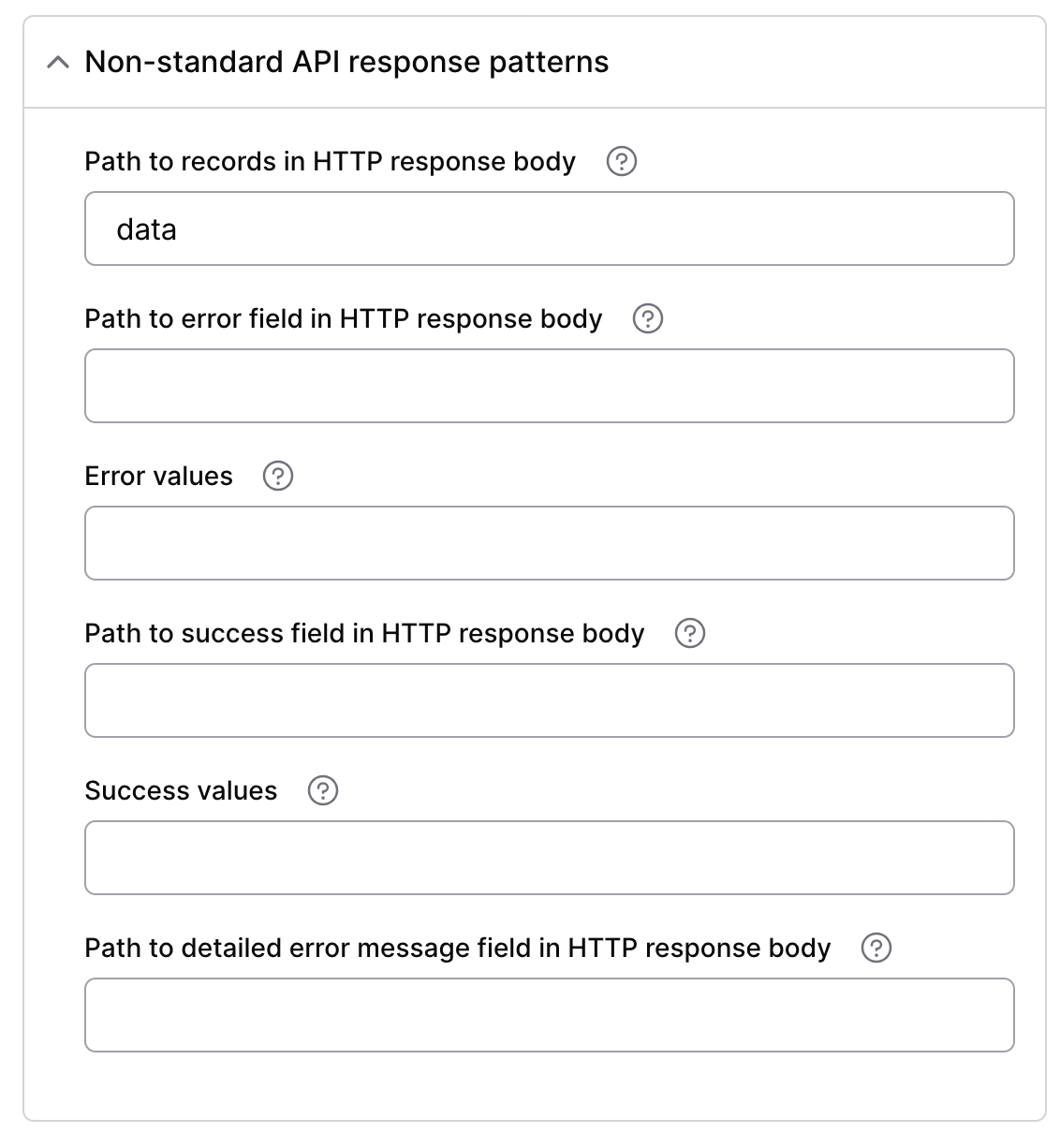

Non-standard API response patterns
Some APIs may have response patterns that are unusual when compared to most APIs. Use the settings below to accommodate outlying response codes.
Field
Description
Path to records in HTTP response body
Specifies where integrator.io should look for the resource (or set of resources) in the API response. Leave blank if resources are at the root. If the response has a nested structure, enter the path using dot notation (e.g., data.results).
Path to error field in HTTP response body
Set this only if the API always returns a successful HTTP status code but uses a response body field to indicate failure — for example, returning 200 but signaling errors via error.message.
Error values
Limits which values in the error field are treated as failures. To provide multiple values, use a comma-separated list.
Path to success field in HTTP response body
Set this only if the API always returns a successful HTTP status code but uses a response body field to indicate success — for example, returning 200 with a success boolean.
Success values
Limits which values in the success field are treated as successful responses. To provide multiple values, use a comma-separated list.
Path to detailed error message field in HTTP response body
Specifies which field in the response body contains the detailed error message shown in the error management dashboard. If left blank, integrator.io uses the full HTTP response body as the error message.

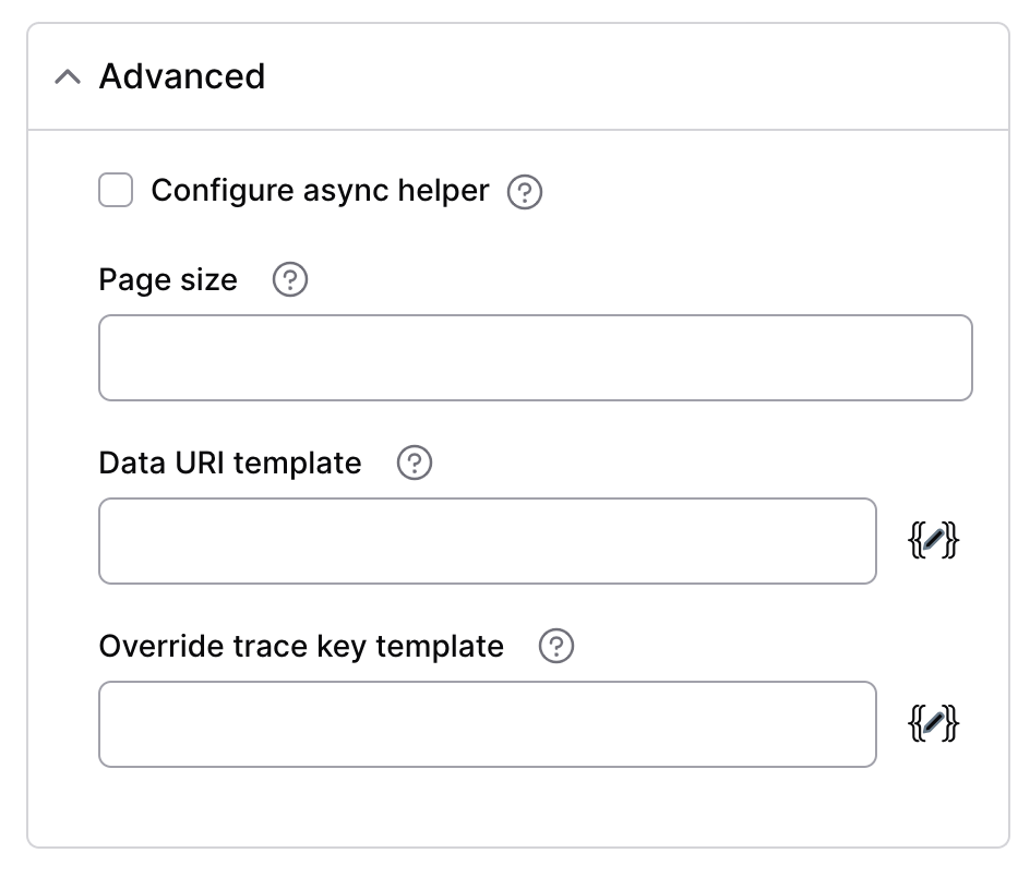

Advanced
Field
Description
Configure async helper
If data is exported asynchronously, select this checkbox to configure the async helper.
Page size
The number of records per page when integrator.io sends export data to an import queue. Default: 20. There is no maximum value, but pages are automatically capped at 5 MB. Leave blank to use the system default.
Data URI template
When your flow runs with data errors, this setting lets you verify that all errors have a link to the original data in the export application. Enter a Handlebars template to generate dynamic links based on the exported data. For example: https://your-store.myshopify.com/admin/customers/{{{id}}}
Do not store retry data
Select this checkbox if you don't want integrator.io to store the data associated with errors for this export.
Override trace key template
Defines a trace key to identify a unique record. Enter a single field such as {{{field1}}} or a Handlebars expression. For example, {{join "_" field1 field2}} generates field1_field2. Setting a value here overrides the platform default trace key.
