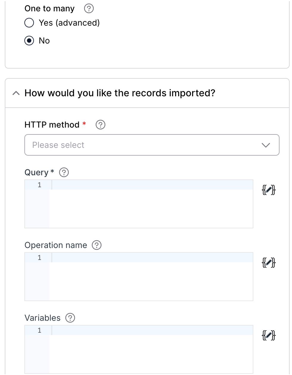

One to many
Use when a single source record needs to create multiple destination records — for example, when a parent record contains child records to process. Cannot be used when importing a CSV file.
Yes (advanced), No
No
Configure import settings
Field
Description
Accepted values
Required
HTTP method
Determines how records are imported to the destination application. Consult your destination application's API documentation to determine which method to use.
Composite, DELETE, PATCH, POST, PUT
Yes
Query
Defines the request the GraphQL server is processing. If you use the query shorthand syntax (omitting the operation type and name), you can't supply a name or variable definitions for your operation. You can build a query during a connection, export, or import — the query structure stays the same across all three.
GraphQL query string
Yes
Operation name
A meaningful name for your operation, required only if your query contains two or more operations (a request can only execute one operation at a time). Useful for debugging and server-side logging — it's easier to identify a named query in your logs than to decipher its contents.
Any string
Only if query has 2+ operations
Variables
Defines the JSON variables used in your query. For example, for query GetProduct($id: ID), define the variable as {'id':'12345'}. Use single quotes inside Handlebars functions to prevent parsing errors.
JSON object
No
Use single quotes for string arguments inside the Variables field when using Handlebars functions (such as dateFormat or if) . GraphQL variables are converted to JSON before being sent, so double quotes inside Handlebars functions break the JSON structure and cause a parsing failure. This requirement applies specifically to the Variables field. If parsing fails, the resource will return an error in the flow run history.
Fails to parse:
  "query": "updated_at:>='{{dateFormat \"YYYY-MM-DDTHH:mm:ss[Z]\" lastExportDateTime \"YYYY-MM-DDTHH:mm:ss.SSS[Z]\"}}'"
Parses correctly:
  "query": "updated_at:>='{{dateFormat 'YYYY-MM-DDTHH:mm:ss[Z]' lastExportDateTime 'YYYY-MM-DDTHH:mm:ss.SSS[Z]'}}'"

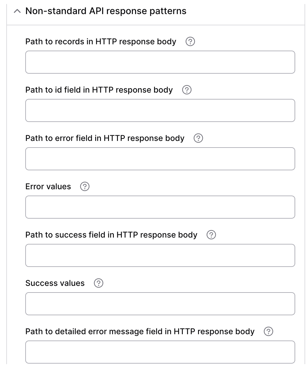

Non-standard API response patterns
Some APIs may have response patterns that are unusual when compared to most APIs. Use the settings below to accommodate outlying response codes.
Field
Description
Path to records in HTTP response body
Use this field if the records returned by the API are not located at the root level of the HTTP response body. For example, an API could return records inside a container object like results.customers.
Path to id field in HTTP response body
Specifies where in the HTTP response body to find the id field for the submitted record. For batch requests, this path is relative to each individual record returned. If left blank, integrator.io will automatically attempt to identify an id field.
Path to error field in HTTP response body
Set this only if the API always returns a successful HTTP status code but uses a response body field to indicate failure — for example, returning 200 but signaling errors via error.message.
Error values
Limits which values in the error field are treated as failures. To provide multiple values, use a comma-separated list.
Path to success field in HTTP response body
Set this only if the API always returns a successful HTTP status code but uses a response body field to indicate success — for example, returning 200 with a success boolean.
Success values
Limits which values in the success field are treated as successful responses. To provide multiple values, use a comma-separated list.
Path to detailed error message field in HTTP response body
Specifies which field in the response body contains the detailed error message shown in the error management dashboard. If left blank, integrator.io uses the full HTTP response body as the error message.

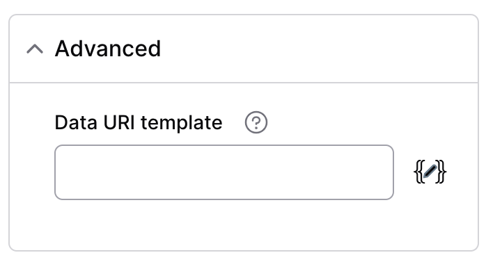

Advanced
Field
Description
Data URI template
When your flow runs with data errors, this setting lets you verify that all errors have a link to the original data in the import application. Enter a Handlebars template to generate dynamic links based on the imported data. For example: https://your-store.myshopify.com/admin/customers/{{{id}}}
