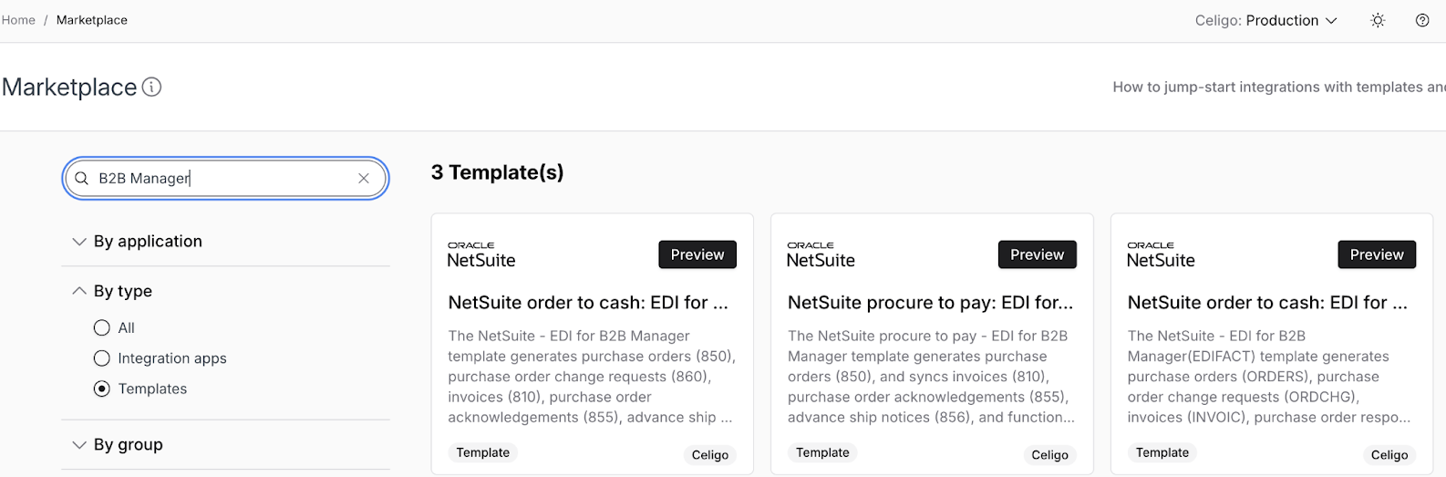

Celigo B2B Manager provides pre-built integration templates through the Celigo Marketplace to accelerate common B2B business processes.These templates support multiple EDI standards (X12 and EDIFACT) and are tightly aligned with NetSuite data models and best practices.
Where possible, start with a pre-built template rather than build an integration from scratch. These templates are designed using Celigo-recommended patterns, can seamlessly integrate with the Celigo B2B Manager NetSuite Suite Application and significantly reduce implementation time, risk, and maintenance effort.
The following templates for common NetSuite scenarios are available in the Celigo Marketplace (select By type as "Templates" and use search term "B2B Manager" :
NetSuite Order to Cash: EDI for B2B Manager (X12)
Supports inbound and outbound X12 transactions commonly used in the Order to Cash cycle (for example, 850, 855, 856, 810 docs).
NetSuite Procure to Pay: EDI for B2B Manager (X12)
Supports Procure to Pay scenarios, enabling inbound and outbound purchase-related EDI documents aligned with NetSuite procurement workflows.
NetSuite Order to Cash: EDI for B2B Manager (EDIFACT)
Provides EDIFACT-based Order to Cash flows tailored for trading partners operating in regions where EDIFACT is the preferred standard.
- Faster implementation: Core flows, mappings, and EDI structures are already defined.
- Standards-aligned design: Templates follow EDI best practices and Celigo recommended architecture.
- NetSuite-ready mappings: Common NetSuite records and fields are pre-mapped, reducing custom work and can seamlessly integrate with the pre-built NetSuite Suite Application from Celigo.
- Easier extensibility: Templates can be configured and extended to meet trading-partner-specific requirements without re-architecting the integration.
- Lower long-term maintenance: Updates and enhancements are easier to manage compared to fully custom flows.

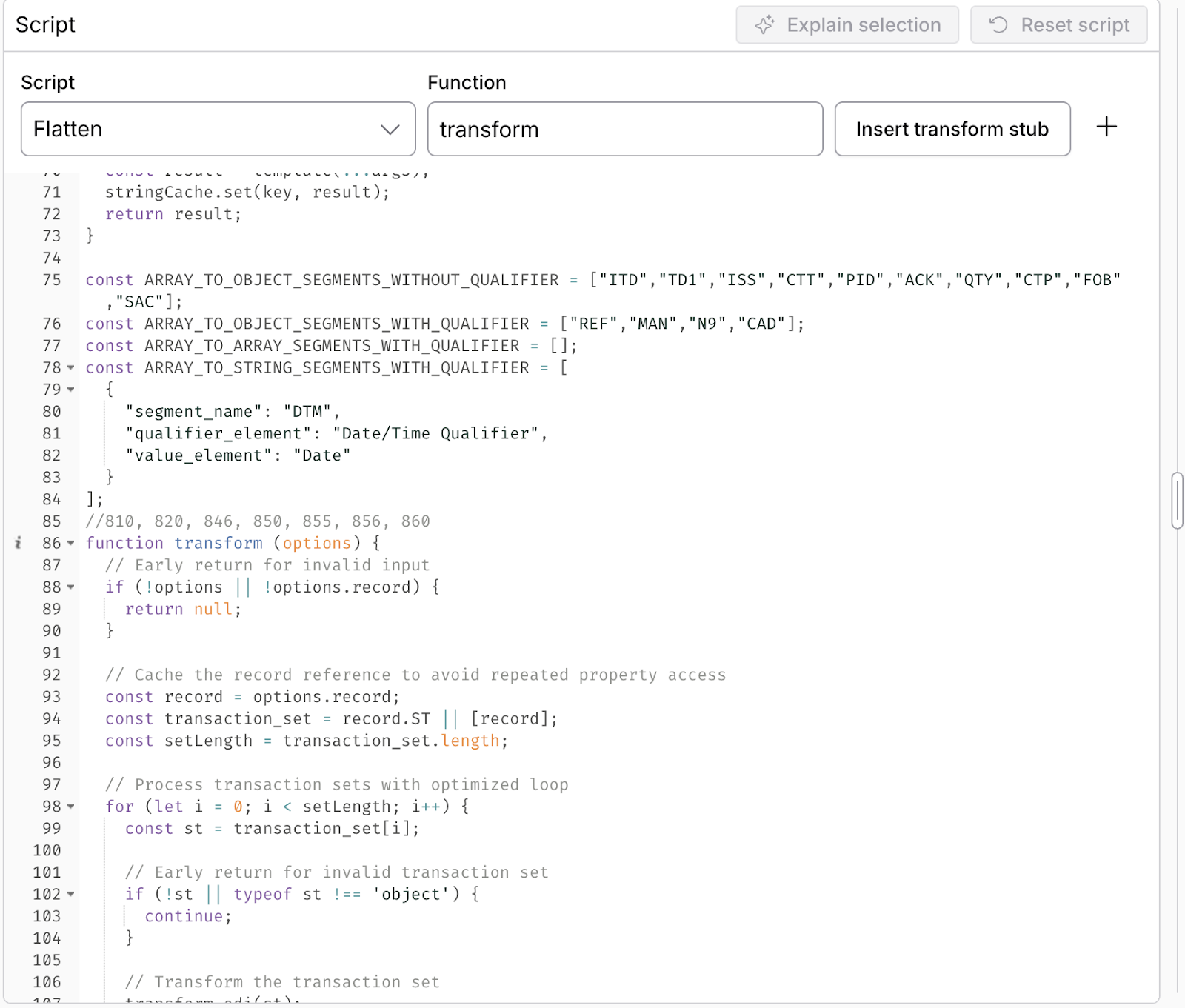

Inbound EDI documents often contain repeating segments, qualifier-driven data, and hierarchical structures that are not immediately suitable for ERP consumption. Transformation scripts are used to normalize and flatten the parsed EDI JSON into a predictable and mapping-friendly format.
The provided transformation script in the templates follows Celigo best-practice patterns and focuses on performance, reusability, and clarity.
Segment normalization patterns used in the script
The transformation logic categorizes segments into specific handling patterns based on how they appear in EDI documents.
A. Array to object (without qualifiers)
Some segments may repeat per the standard but are typically sent only once by the trading partner. In such cases, a single-element array is safely converted into an object.
Segments
- ITD (Terms of Sale)
- TD1 (Carrier Details)
- PID (Product Description)
- CTT (Transaction Totals)
Example
"ITD": { ... }
instead of
"ITD": [ { ... } ]
This simplifies NetSuite mappings by removing unnecessary array handling.
B. Array to object (with qualifiers)
Qualifier-driven segments require special handling. Multiple occurrences of the same segment are grouped and flattened using the qualifier value as part of the key.
Segments
- REF (Reference Identification)
- MAN (Marks and Numbers)
- N9 (Extended Reference Information)
- CAD (Carrier Detail)
Example
"REF_DP": { ... },
"REF_IA": { ... }
Always validate which qualifier values are actually used by the trading partner using sample files. Specifications alone are often insufficient.
C. Array to string (with qualifiers)
Some segments are best represented as simple key–value pairs rather than objects, especially when only one data element is relevant.
DTM segment
- Qualifier: Date/Time Qualifier
- Value: Date
Example
"DTM_011": "20240115"
This approach reduces mapping complexity while preserving semantic meaning.

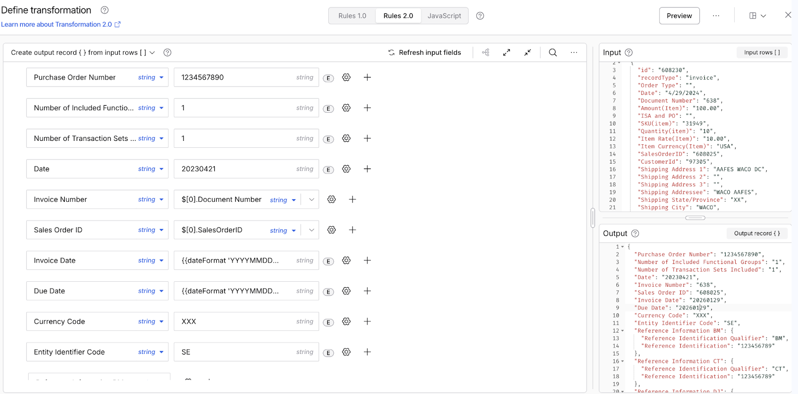

Outbound EDI configurations (Imports in Celigo terminology) are responsible for transforming ERP data into partner-compliant EDI documents. A consistent outbound design approach ensures that integrations remain reusable across trading partners while still allowing for partner-specific customization where required.
When setting up outbound flow step (import):
- Reuse existing Trading Partner (TP) profiles and File Definition Rules (FDRs) whenever the trading partner is already available as an endpoint connection in Celigo.
- Avoid duplicating or heavily modifying existing FDRs. Existing outbound definitions are pre-aligned with partner-specific segment ordering, required fields, and validation rules. Reuse enables consistency, reduces errors, and simplifies long-term support and upgrades.
If a trading partner–specific outbound document definition does not exist:
- Select the generic document definition for the applicable EDI standard (for example, Generic X12 or Generic EDIFACT).
- Start with a generic definition and introduce partner-specific requirements through mappings or transformation logic rather than creating custom FDRs prematurely. Generic definitions provide a stable, standards-compliant foundation that can be extended through mappings and conditional logic.
Outbound data should be designed to maximize reusability and clarity while allowing flexibility for partner-specific requirements.
Use generic object names
- Design outbound data using generic object names instead of partner-specific labels.
- Reuse data across multiple trading partners with minimal changes.
Customize mappings, not flow structure
- Update field mappings, qualifiers, and conditional logic as needed to meet partner requirements.
- Avoid changing core flow logic unless absolutely necessary.
Example
- A generic ShipTo or BillTo object can be mapped differently for each partner without modifying the overall structure.
